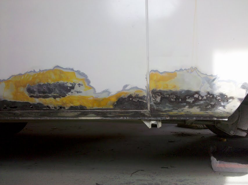

Got started today with some paint removal on the driver rocker:
Any suggestions on fixing up these rockers short of a complete replacement? As I said, this is going to be a budget bus. However, I'm buying a new mig welder and plan on doing the best I can do in an attempt to repair the rust. I'm just hoping to avoid what I fear will be my largest expense...body panels.
It is hard to tell in those pictures, but there are a lot of pinholes and also about a 6 inch section in the middle along the seam that is rusted through. Also found some bondo and some bodywork. The work wasn't horrible, but the bondo was probably about 1/4 inch thick in one spot.
If you want to keep it in budget you can patch with new metal those areas, if you do it well you should not have any problem for a long time, just use some good quality wire for the mig and don't miss any rust spot before next step.
Good luck!

I'd go to a scrapyard with a sawzall and cut a sizable chunk of metal off a VW. Use that metal to make patches, MIG weld into place.

congrats on the bus! nice starting point. i too am building on a budget, mine is a 1970 deluxe. i have a thread on here too.
good luck! Very Happy

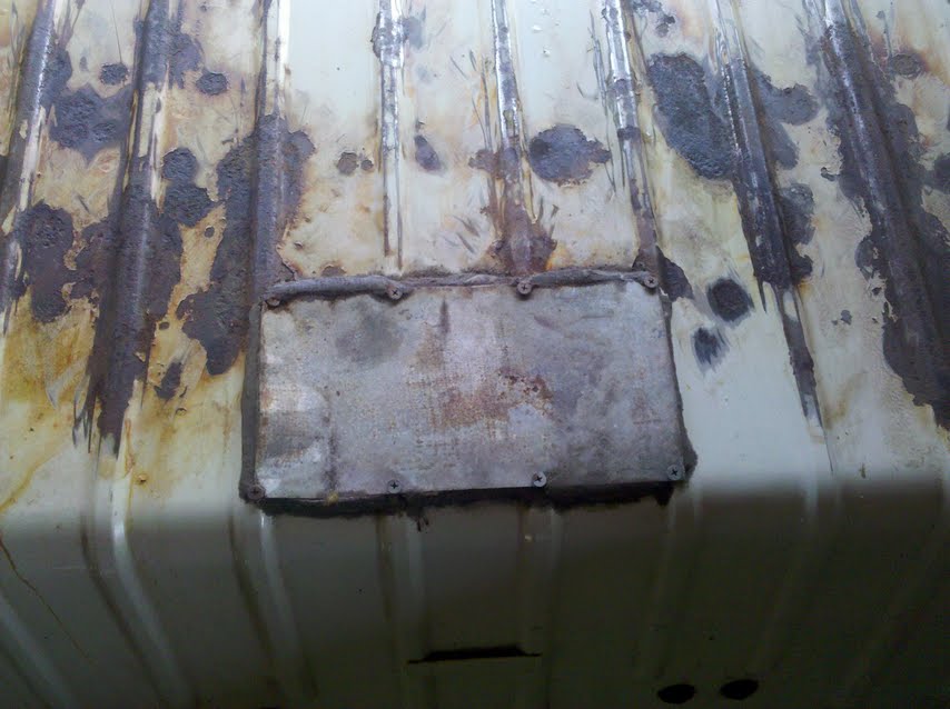

I also found where the PO had cut an access hole for the fuel tank in the hatch area. Looks like I'll need a piece of sheet metal to weld in here too.

Here is a pic of the PO fuel tank access hack that I mentioned before:
*IF ANYONE HAS PANEL FROM A PARTS BUS THAT I COULD USE TO WELD IN THIS AREA, PLEASE PM ME. THANKS.
