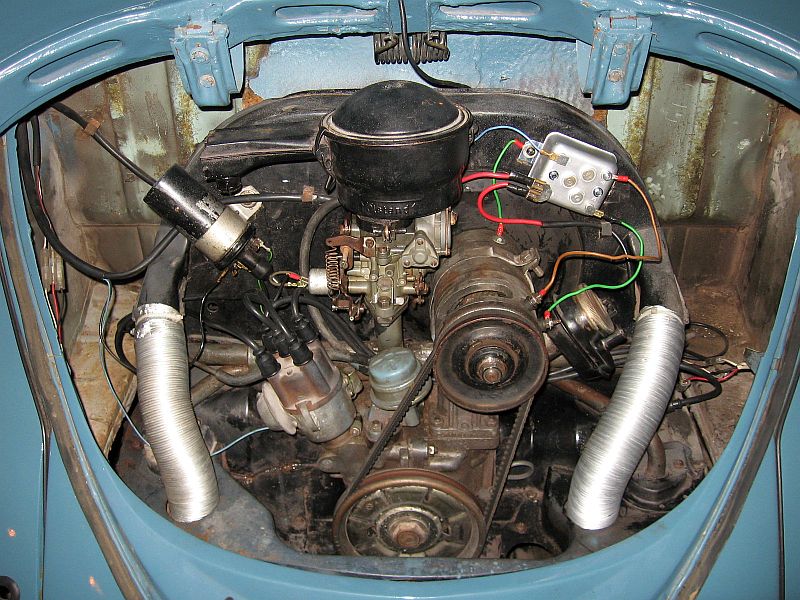

Could you please send pictures of generator & regulator with wires already hooked up.

I still have some consern about your wiring of the gen & reg .Can you send a photo.

Here's some photos I just took.

I like mine better... Wink

I don't understand how the car either ran then on positive ground or runs now on negative ground. One way or the other, the starter's turning the wrong way.
