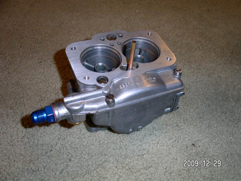

The problem with the DCNF design is that when cornering hard, fuel spills out of the float bowl vent and drowns the air corrector jets. This totally wanks the fuel mixture ant two cylinders don't fire.
I made these vent stacks from .219 and .188 brass tubing silver soldered at 20°. I had to slightly enlarge the 5mm vent hole to accept the .219 tubing. I also had to slightly reduce the O.D. of the air corrector jet to clear the .188 stack. I then flared the end inside the float bowl so there is no possibility of it coming out. Lastly, I JB Welded it in place so there is no leakage or wiggle.

Very nice modification! If only that was an availiable mod for everyone. You should be extremely happy with the results. Please post an update after you run them for a little bit.

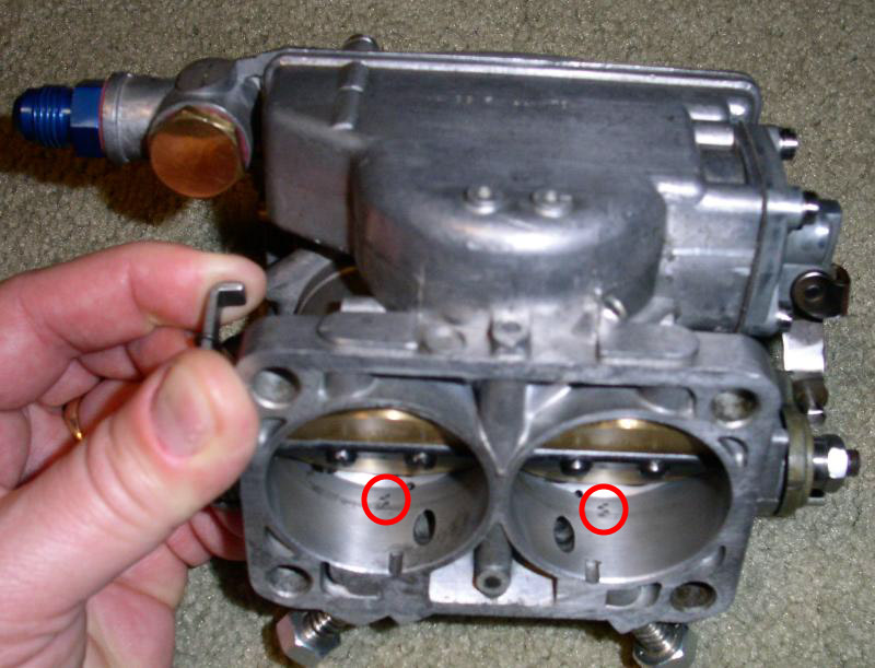

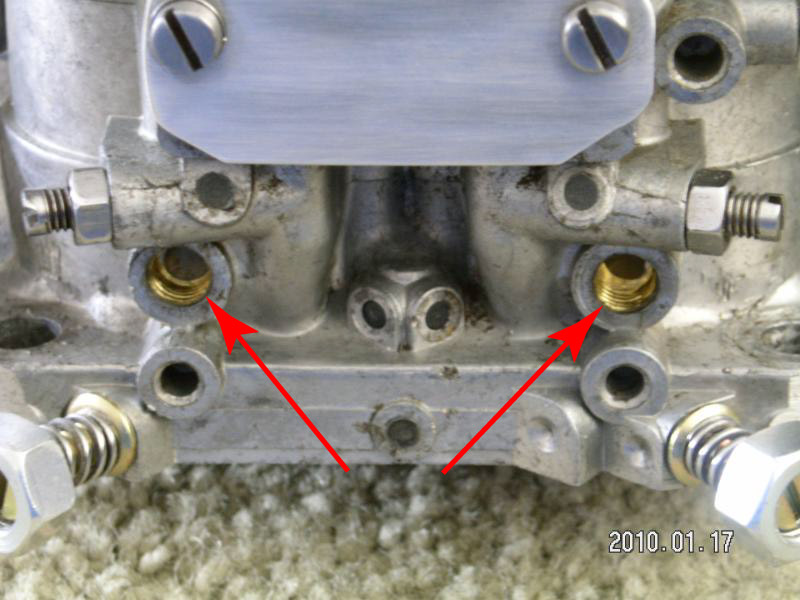

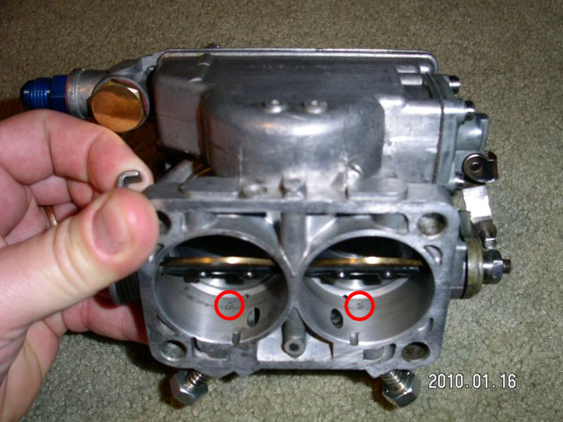

DarthWeber wrote:
Eric, In the Berg catalog they said their carbs were redrilled and circuited to match specific VW engine applications. Since you have the Berg 44 specials I was curious if you could see and describe any modifications they actually did.
Here you can see where they drilled in from the outside to drill the progression holes. You can also see the nuts they put on the mixture screws to make them easier to turn.
I don't remember how many there were before but there are 4 now.
They drilled out the air cleaner mounting holes to take 6mm hardware and cleaned them up real nice. They also removed the enrichment valves and put on these kinda home made looking covers. All in all, a real nice job.

Mine have obviously been tampered with...drilled and filled with lead. Don't know if it was for cleaning, enlarging passages or what.

1. Yup.
2. Yup...it looks a bit home made to me but I think it'll work well. Kind of Berg Special indicator to look for when buying though.
3. Didn't happen. The "W" logo got slightly ground off when they surfaced the tops. They lightly surfaced the bottoms too.
4. Yup. But again, for looks, I think I'll shop for some stock Weber ones.
5. I did that. I got lucky and got some here in the ads.

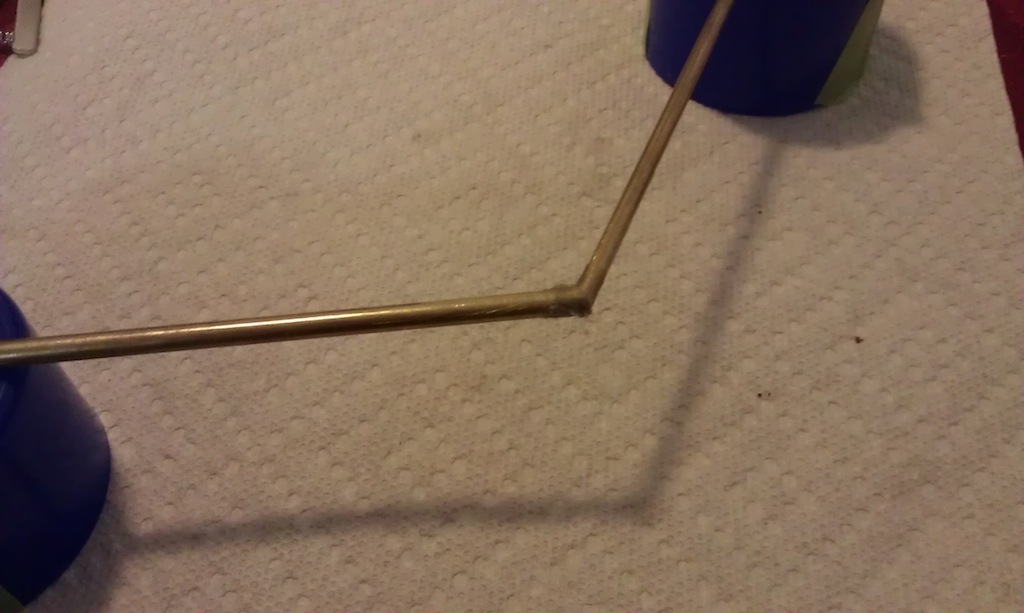

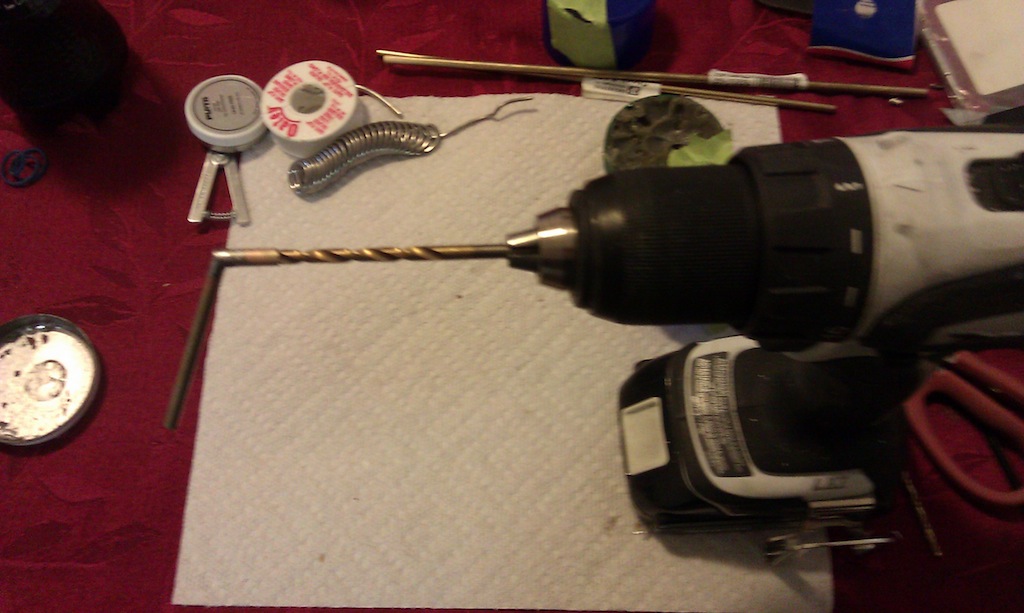

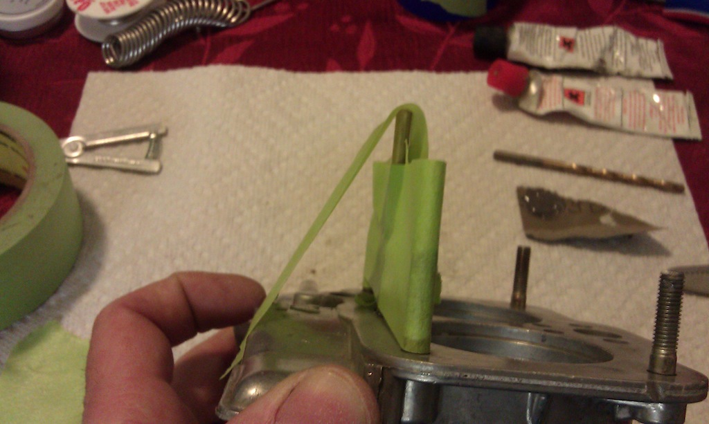

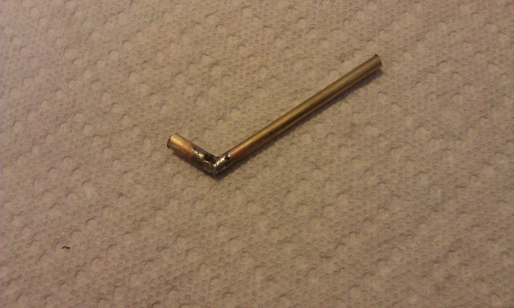

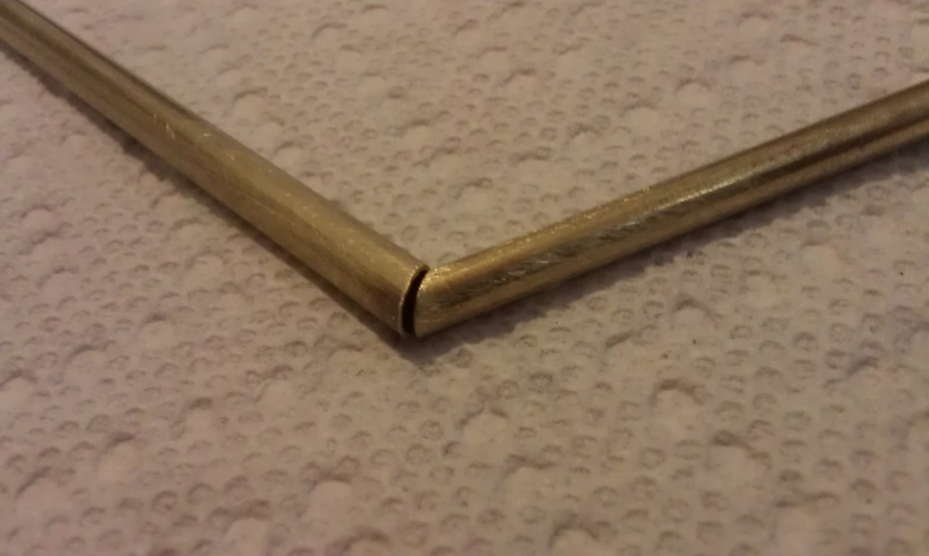

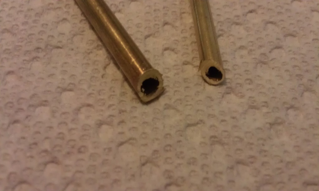

I've done the bowl vent mod to a couple of these now and took pictures all along. Thought I'd put them up.
Here goes. I'm starting with 44's here. The vent hole is a little bigger, so I used two sizes of tubing. Larger one for the hole, and the next size smaller for the stack. Doing it this way there is no need to shave the air correctors down. I also get the right size drill bits for use later.
I'd say the angle were looking for here is about 135*. I keep the tubes long, then just grind them on the bench grinder until they fit right. After that I clean them up with a drill and a little emory cloth.
Next, I mock them up using some brake cleaner lids and a bit of flux on the ends.
And solder them.
Now cut them a bit shorter with a Dremel cut off wheel. We want them a little long and will trim later. Very carefully run the bits through both sides to clean out any solder on the inside. You can see what came out. Blow through it and check the seal by blowing with a finger over the other end too.
And then clean up any remaining flux that's burnt. I just used a green scrubby pad.

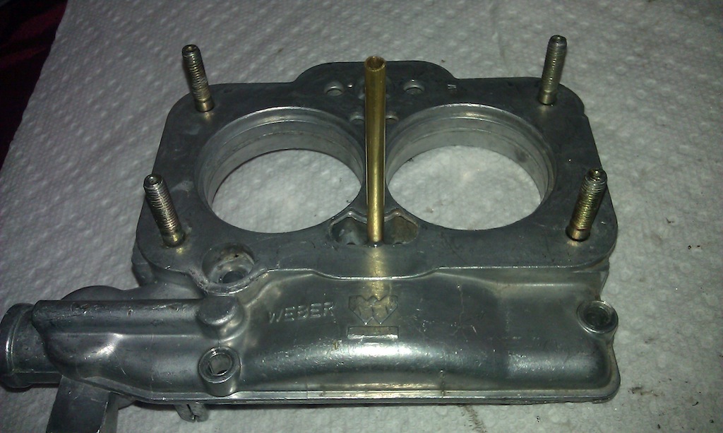

Then test fit and cut the bowl side a little shorter, but you still want it to be a bit long on the inside to cut later.
This ridge need to be shaved down a little. A little grinding stone on a Dremel works great.
And final test fit.
Just a little JB weld under the stack, along the sides, and around the bowl penetration. I like to use a toothpick and swirl it on to work out any air bubbles. Some tape to hold it overnight for JB to cure.
Next morning we're here. The stack is still to long, so cut it down. These particular carbs are going to be uses with rather thin air cleaners so it needed to be short enough to fit under there; for use in a Type 3, woot!
The inside will look like this. We need to trim it down with that cutoff wheel.
And finally a bit of JB applied the same way to the inside.
I put a little silver Masterseries over the inside, but it's probably not necessary. And that's it.

Great wright up I have some 40's, 42's and 44's I am going to be modding something like this in the future.
But it is curious that for the Berg mod that they didnt grind off the stamping of the 44 dcnf from the float casting.

One mod that hasn't been mentioned is cutting off of the pointy nubs next to the mixture screws.
When I put the carbs back together, I'll post more pictures of the modifications. They'll be the [almost] Berg specials. Smile
