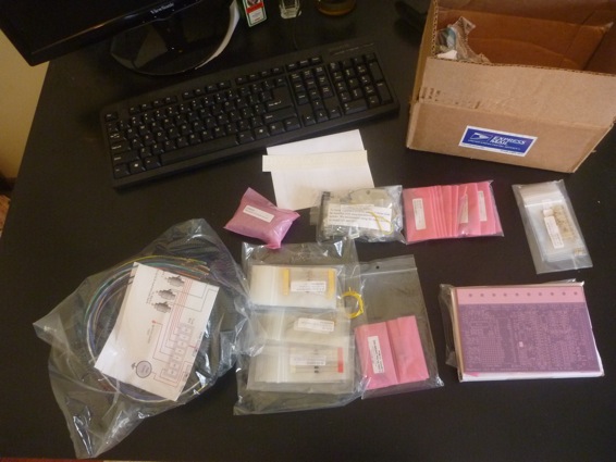

Today i received my MS-2 kit and i have trigger wheels (supersuk) and COP in the mail.

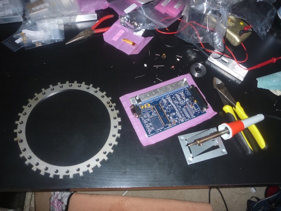

Got started on the soldering today. i made the power circuit (i think) then i got the shakes so thought i should stop for tonite.
had a package on my doorstep when i got home tonite as well
ooooh that trigger wheel is super smooth. i love me some lazar cutting

I'm mostly a stock guy myself, but have always been a little interested in a Megasquirt conversion of a Type 3 engine. Will you use the stock Type 3 FI intake?

Here is what i know about MS...   I have s 95 golf with an added turbo on ms1v3.   Timing alone wont necessarilly kill the engine but it can lead to hot spots and pinging if your mix is on the lean side.  Just be conservative on your timing and use all of your map.  Set some timing a little high below your idle to help recover from a stumble.  A good start would be 10-12 deg to start to about 28-30 at wot.  You can set less timing at idle but a/c motors like a little more timing down low. I also like to set my idles at 950 to 1000 the off idle starts are a lot better and the milage lost is nothing significant. If you wire in your O2 sensor you can monitor your current mix and get an idea of what your engine is running like so you will have a general idea of a good starting mix. Keep your maps smooth...
Remember all grounds go to the motor and it is a good idea to add a second ground to the engine.
Pm me if you have any questions on ms. Supaninja knows a thing or two as well and if you talk nicely to him he might share his msq. Then you will have a ball park tune to play with as far as your ve and timing tables.

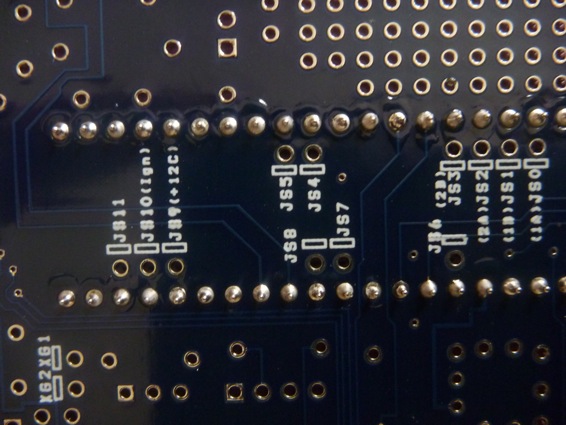

Yeh Ninja i was talking about those tiny little transistors Q14,20 ect but i finished the board off today and tested some things with my multimeter and i think they are ok.
here is my board at the moment. I find the MS extra manuel is a bit slap dash. so i have a few questions to anyone who may know.
do i need to install a jumper (Link) across R43 (red circle)
Ms-extra manual tells me to link it but does not show it in the picture of the finished board
do i need to install the LED's (purple circle)
what happened to Q16 (green circle) (isnt this the ignition transistor?)
the ms-extra manual tells me to keep them safe but then doesn't say to install them.

i would really appreciate some input as im finding the ms manuals a little confusing,

this might clear things up a little more.
http://www.diyautotune.com/tech_articles/using_bosch_bip373s_with_megasquirt.htm
msextra explains it pretty good here http://msextra.com/doc/ms1extra/MS_Extra_Ignition_Hardware_Manual.htm#groundpull
scroll all the way down to the bottom "Driving two coils from the same spark output e.g. wasted spark coil on plug (COP)"
I need to open mine up to see is if jumpered r43, I have a transistor in the q16 slot but I can't remember what I added. I do know for a fact that it hasn't been there the whole time. MS1 comes with a bip373 to power one coil, but you got 4 coils now Smile

yes, you need to jumper the resistor. most people place a substantial wire under the resistor so it will not be seen from above. also you do not need to install the LEDs. as the outputs from MSNSe take them over and you will just end up desolding them anyway.

Thanks guys, That confirms my thinking, also i did a bit of searching on the net and found that people have done it that way and some in even stranger ways but it all seems to work.
