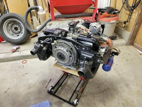

So today ...
As I've been reconnecting the FI harness I've been checking each function and sensor. It all worked before I pulled the engine to fix some things. But now the TPS isn't working. I don't think I pulled anything loose but wiring is the prime suspect. I've posted it up on msextra to see if it rings any bells.
https://www.msextra.com/forums/viewtopic.php?t=76463

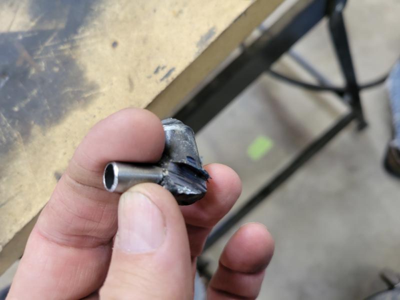

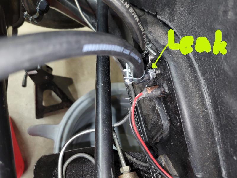

Next thing this morning was to test the fuel system. There's a leak.

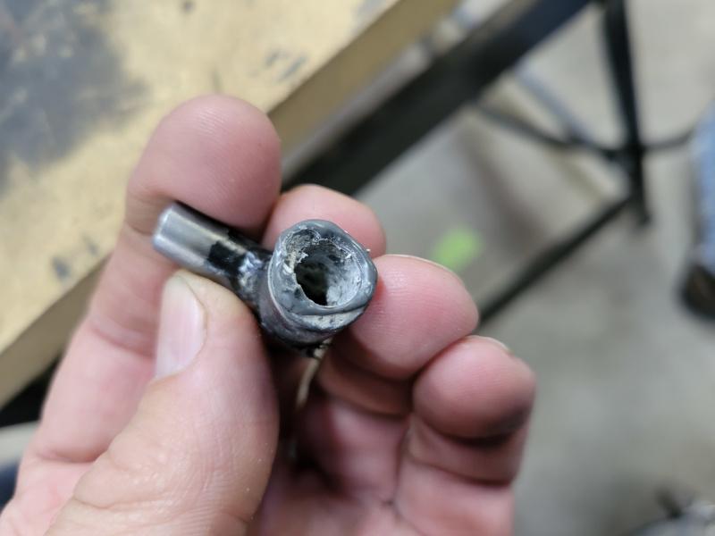

Background: When we did the chassis I asked for two 5/16" tube to be run down the inside of the tunnel to support the FI. One for fuel supply and one for the return. Unfortunately both tubes exit directly into the space needed by the right tie-rod. My answer to the problem was to construct these fittings that could be placed over the tubes where they exit, securing them with seam sealer. It's a high-risk approach in that there is no easy way to get them off and try again.
And the return fitting leaked. The fit of the supply side was very good but the return side was less so. It's leaking where the seam sealer is.
So now I have to find a way to get that thing off so I can make another fitting that works better.

I've heard that. They use they word "resistant".
The sealer in question is the POR 15 product. I already used it on one of the earlier iterations of my in-tank pump idea. There were other problems there but the sealer worked as advertised. Theirs is also the only product I found that "dries as hard as a rock, remains flexible, and once dry is totally impervious to fuels and solvents." Their lawyers let them say that. Wink
The fitting that leaked had other problems. I originally didn't like the fit to the tube. The other one was a nice press-fit. I unwisely drilled the second fitting one drill size bigger, making it loose. My mistake. I tried to compensate with some JB Weld. The JB Weld is what failed, possibly failing to bond with the sealer that was already there. Basically a mess of my own making.
Turns out the JB Weld was also the key to removing that fitting. As soon as I began grinding the epoxy softened and I could easily just twist it off. Now I can make a new fitting and throw this "prototype" were all prototypes belong.

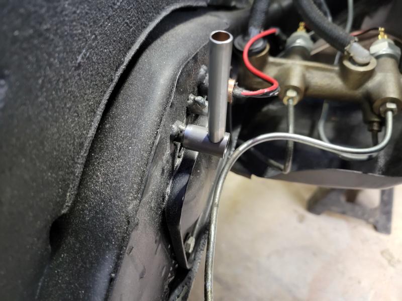

New fitting made. Now I wait to hear back from my TIG guy.

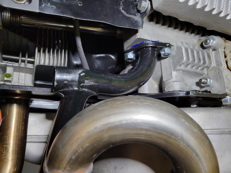

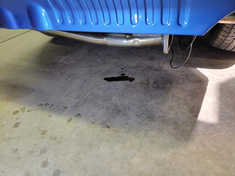

So while I was under the rear blowing out the return line, I noticed this.
Dag Nabbit! I hope it's something easy like an AN8 I didn't snug down. So the engine is coming out again. On the plus side, that will make it easier to trace out the wiring to the TPS. No response on msextra on that problem yet.

So the leak turned out to be from the dipstick to case interface. I gave each nut an extra tug and mopped up. I'll see how it looks tomorrow.

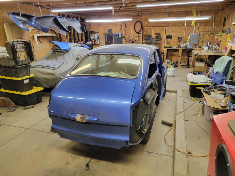

My niece dropped by today on her way home from work and helped me get he other three fenders down from the rafters.
Tomorrow I will hang the muffler and hopefully make some noise.

Well crap. Oil leak. From the location, it's the main seal. Sad
Dam engine is coming out again.

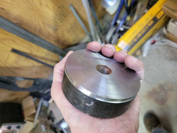

I've been trying to use this round piece as a seal driver. A local friend made it for me on his lathe. But it's too hard to control and I'm pretty sure I got the seal in crooked. Probably what happened the first time.
So I've ordered up the proper tool from CB. While that is on the way I'll be installing fenders and getting all the lights working.

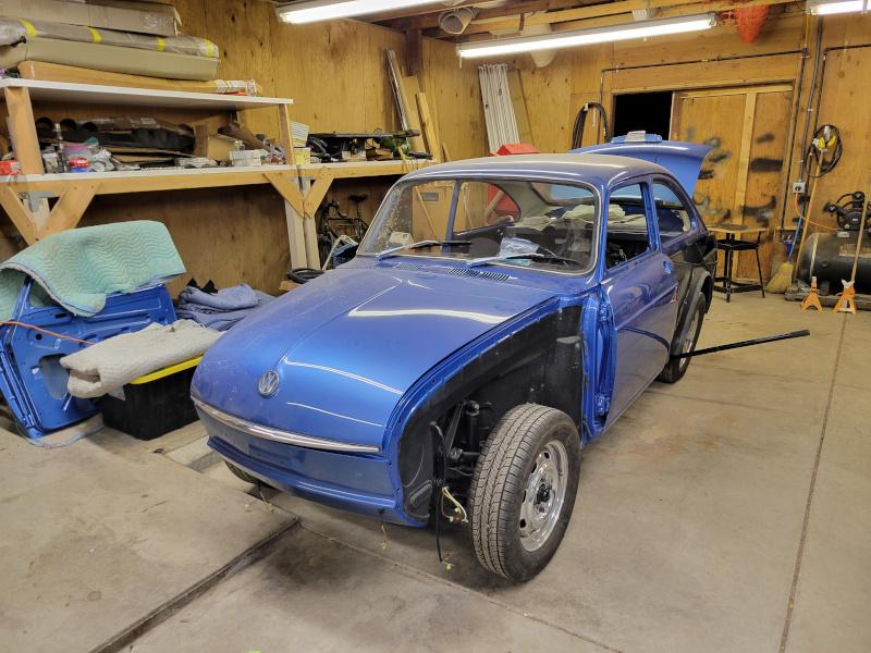

PostPosted: Wed May 11, 2022 8:28 pm    Post subject: Re: Home Stretch Reply with quote

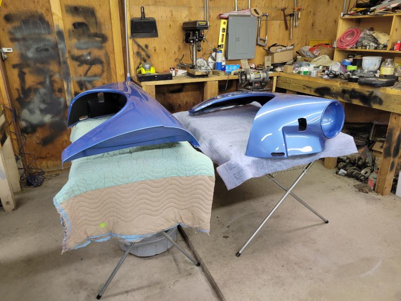

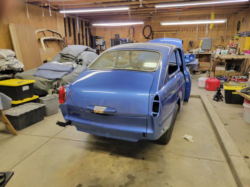

Trial fit of right rear fender.

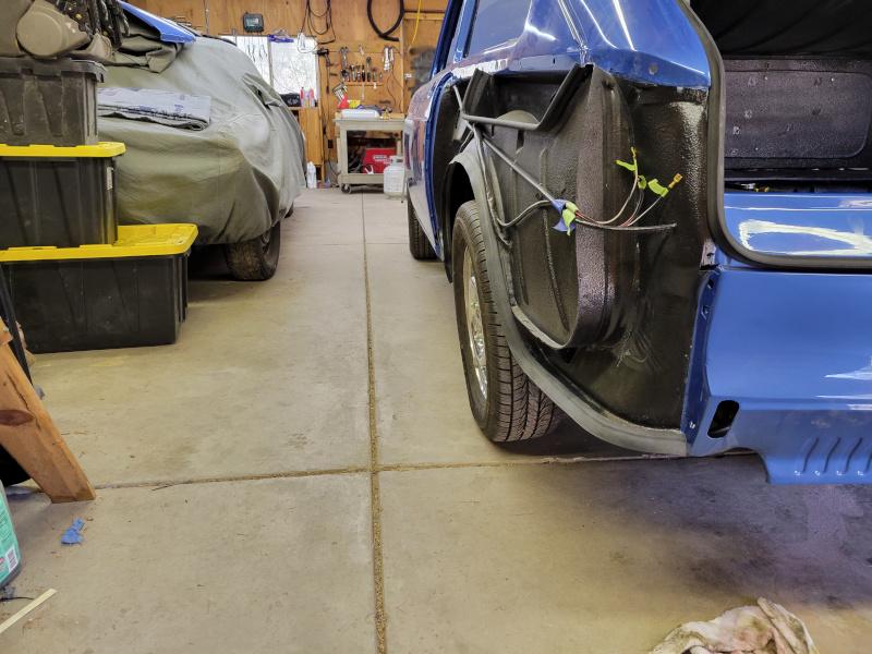

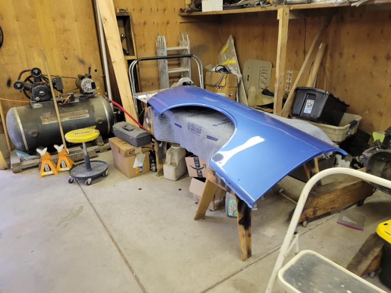

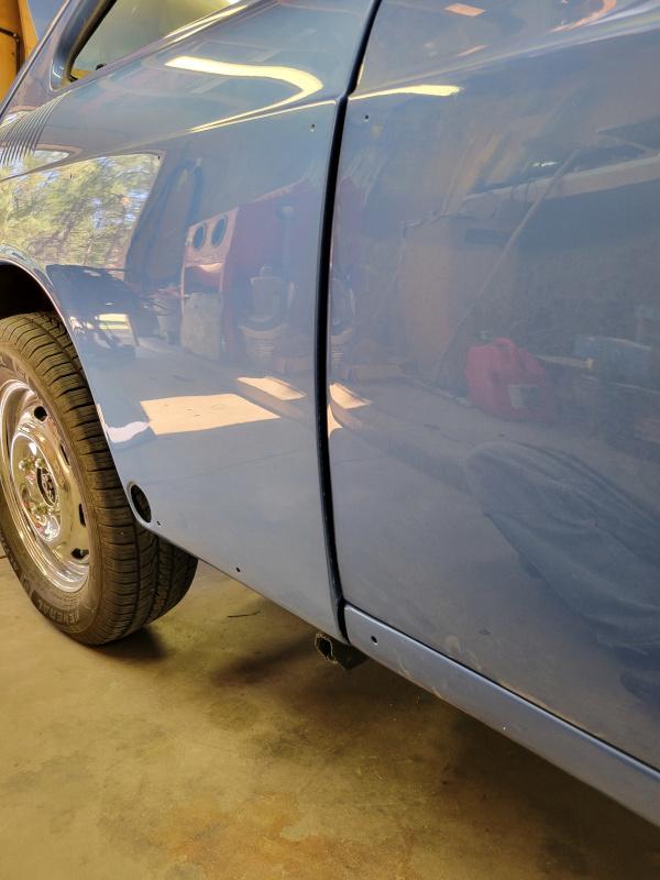

I'm not going to stop and fix this right now, but both rear fenders are sitting proud with respect to the doors and rockers. If anyone has suggestions, I'm all ears.

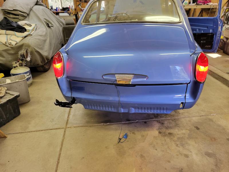

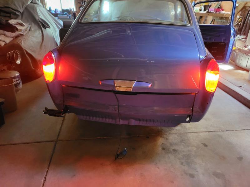

LED tail lights. These are white. I think I need red.
