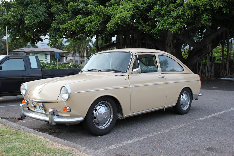

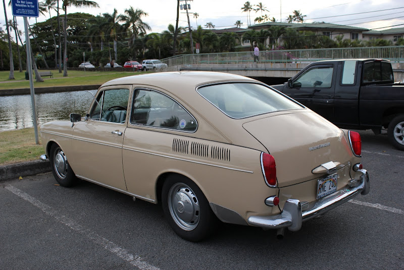

Hello ladies and gents. I've been lurking here for a while and been gathering as much information as I could before I purchased my new to me Type 3. For a while now, i've been searching for an early notch. However, in Hawaii it has proved to be an impossible task...Recently I made a trip to California to check out many notches, but I felt that it was not worth purchasing and shipping it back to Hawaii for restoration. I just can't justify purchasing a notch for 5k+ that need a lot of work, especially rust work. Purchasing repair panels and having them shipped to Hawaii would cost me a small fortune. After about two weeks, I went home empty handed. A couple days later, a 68 fastback turned up at home. I went to see it and to my surprise it was a nice rust free Cali car that was brought over in 2010. I picked her up on Monday June 13th and drove her home. She does need a lot of work, but she is complete and rust free.
Now onto the pictures:
Accident Free!!

That thing is spotless compared to mine. I will be a gentleman and attempt to set aside my shameless jealousy. I'm not promising anything though. Very Happy

great looking car! doesn't look like it needs too much. those gravel guards are sexy Cool
what are your plans for it?

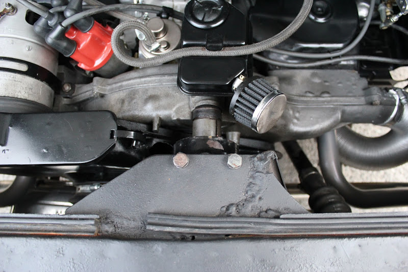

The main issues with the car is the following:
1. The front fenders have been blended in with only the front apron. Hopefully this will be an easy fix.
2. The engine mount at the rear was cut off and some hack tried to fix it by making their own with some sheet metal and square tubing. It is too short for the arm that hangs off the engine fan housing and serves no purpose at the moment. Hopefully i'll be able to source out a new/used rear portion and have it rewelded back to original. Can anyone help me find one?
3. The engine seems to hang a little low. I'm assuming its because the rear most engine mount is bearing no load. Can any of the type 3 gurus confirm this? In the picture below, you can see the gap between the firewall and the engine tin. I'm hoping that once I get the engine mount fixed, then the motor can be raised to attach the arm on the fan housing to the engine mount.

Does anyone know if it is ok to run the engine without using the rear engine mount? I see that bugs didn't have it...It doesn't seem like the engine and transmission is supported any different from the bugs. Am I missing something?

SA cars have a rear engine hanger, IRS cars just use the mustache bar. I think the PO tried to make a home made rear hanger, which makes no sense. It looks like you have IRS from the pics of your car, factory that thing came with IRS.
Take some pics from the underside of the engine.

68 was still swing-axle, not IRS.

Very clean looking car WOW . Congrats
That hanger is easy to find. You will love the popouts I call it the incredible bending glass.

Wow it's like a twin of my car, especially with the rear gravel guards, but it much better condition. Very nice car!

The car is def a swing axle. A piece of the original rear hanger is there. I dunno why they cut it off in the first place... Still safe to drive?

Fastbackdon: could you lead me to a source of the rear hanger and sheet metal back there? I looked behind there and found that a small piece of the sheet metal is missing too, most likely letting hot air into the cool air stream.

I would check with Mie Fisher here on the samba that is his screen name. He is a great guy and he will do you right.

That would be Mike not Mie, Don! Sorry supersuk, but I've already cut off and sold the only early rear engine hanger I had to sell. Tram might have one?

I'm diggin' the curb feelers!

Thanks for the contacts Don! BerT3 contacted me and he had an entire NOS rear apron w/hanger that I will snatch up! Once I get this, I'll begin the tear down and send it to the body shop. Hopefully I won't find any surprises lurking behind all the fenders and carpet.
I like those curb feelers too! Those will def save my rims. hahaha

If i'm remembering correctly, 68 is the first year for irs if the car is automatic trans. but manual trans is still swing axle. One of the seasoned type 3 mechanics confirm or correct please.

You are correct !
