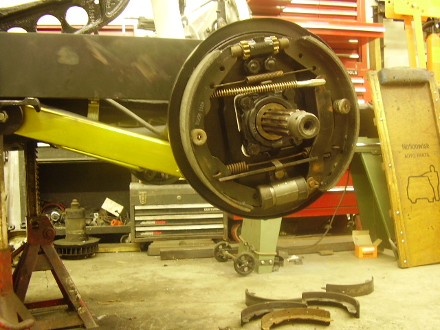

In my hunt for a JJ No Hop kit, I came across two NOS (New Old Stock) kits that had not been used. Both were JJ manufactured kits, but they varied in some dimensions.
Varations in dimensions
The lower strut bar varied in center to center length by 3/4 inch. The plate thickness varied from 1/4 inch thick to 5/16 thick. The forward strut bar mount varied how much it stood off the torsion tube by 3/8 inch.
These kits are not rocket science to build and do not have to be dead on to work. They just have to match side to side and be made of good quality parts. So, you can build the lower strut bar out of boxed tubing, rectangle tubing or round tubing. You can use urathene sleeved ends, uni-balls, solid mounts (will transmit vibrations/noise and wear quickly), rubber sleeved ends or hiem joints. Just use quality parts and good construction for your safety.

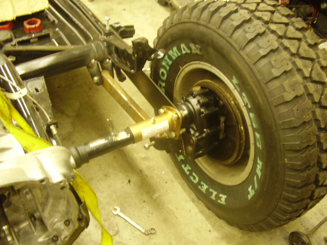

Basics on how the JJ No Hop Kit Works
The axle on a RGB transaxle rotates backwards compared to a Type 1 transaxle axle so it can drive a smaller top straight cut gear that drives a lower larger gear. This reverse rotation and two gear stack on the end of the swing axle tube returns the lower stub axle to a standard forward rotation. The smaller drive gear compared to the larger driven gear affords a gear reduction at the wheel. This reduction of either 1.36: 1 or 1.26:1 (there is another rare mountian ratio that was used in Germany, but not imported for sale in the US) gives a torque multiplier that helps make creaping over rocks, hurdles, and climbing steep grades much easier.
Because the top gear rotates backwards, under power, it tends to want to climb around the lower stub axle gear. This action will produce a wheel hop that can drop the filings out of your wisdom teeth that you had pulled when you were young. It can get so violent with big horse power pushing it that it can split a transmission case, bend the transmission cradle forks, break the gear stack, warp spring plates, separate header tubes, disconect wiring, loose your glasses off of your nose and other bad stuff.
Here is a transaxle that suffered badly under too much power and a bad case of hopping. Note how the ring gear is on the passenger side of the pinion to make the axles rotate backwards.
This brings the question, "how to stop the hop". Since the stock setup tries to wrap up the spring plate and climb the gears over one another, the force of the "push" the lower stub axle gives has to be re-focused to the chassis. The spring plate has to be disconnected from the axle tube end and allowed to pivot. This will allow the spring plate to just act as the suspension spring and hold the car up off of the ground, but not locate the axle and "push" the car forward. The alxe tube pivot is a close fit over the stock axle tube and has a grease zerk fitting because the axle tube piviots inside this flanged over tube. The pivot tube bolts to the spring plate and allows the axle tube to rotate inside of it.

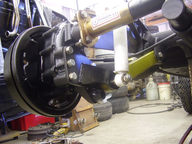

Now, since the axle tube can rotate freely inside the tube pivot, it has to be fastened to the chassis with the lower strut bar. This strut bar focuses the push of the power from the tranny to the chassis. Focusing the power transition down low takes away the tendency to hop.
No Hop Dimensions
The strut bar I have measures 12 1/2 inches center pivot hole to center pivot hole. The strut bar measures 2 inch X 1 inch rectangle tubing with sleeved urathene bushings on the ends. The width of the sleeve in the bushing is 1.550 inches. This is also how far apart the rear pivot and the front pivot mounts are to accept the strut bar in and slide a 1/2 inch bolt through.
The front strut bar mount is stepped off the torsion tube 2 1/4 inch. These front mounts use a slightly different outside mount than the inside mounts to account for the inward angle that the bar is installed on.
The strut bar is located 7* angle from the spring plate. The reason is if it ran parrallel to the spring plate, it would hit the bottom of the spring plate. It is angled inward to bring the front pivot mount inboard just enough to clear the bottom of the torsion tube ends and weld to the torsion tube.
The rear lower mount is kind of self explained in the photo's. It is hard to give a measurement other than it has to pick up the four bolt holes and cant 7* inward to point the bar inboard of the torsion tube ends. It also picks up the lower shock mount.
As I stated early in this thread, these kits are not hard to make, just make a mirror image for the other side. The lower strut bar can be another inch longer and still be fine. The rear bottom mount can be slightly lower to accomodate a longer shock if desired.

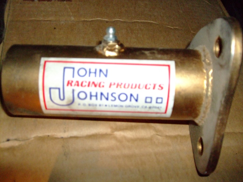

I drove my "TRUG" Truck/Bug from 1978-1986 and have parked it in my barn ever since. It was my daily driver with a 1835cc, I used street tires that were 50x15 and they road nicely; no camber wear. I just pulled the transaxle to install it into my 1961 double cab and then sold my TRUG. I sent the transaxle to a VW Shop called Crossroads in Stockton, CA. to have it completely gone through. All the internals checked out ok. The outer tubes were polished from use/wear but there was no significant damage.
The photos posted in the above link showing the tubes… These tubes look shorter compared to mine. Mine are 10” long, with 3 zirks, and my struts came out of a early corvette.
I did see an unexpected wear pattern from the zerks being too long, as they protruded pass the Johnny tubing. I would suggest you weld a small nut on the outer part of the Johnny tube where the existing zirks screw in; then drill them to except new zerks. Also you should take a rotary file and grind down the ID area around the zirks to make them smooth.
With that said: I would expect that yours will last 20+ years with no sighs of damage.

How thick is the tube that is used for the pivot?
How thick is flange that is welded to the tube?
I bought some 2" x .095 wall DOM tube, the fit is perfect but im wondering if it might be on the thin side.

Flanges were 3/16"
Tubing 1/8" .125
You could use what you have, If you add some 1/8 gussets.
Try using three each, per side; 1-1/4 inch by 4 inch triangle gussets.

What is the purpose of the additional tube over the axle tube? It doesn't appear to tied into anything else associated with the No-hop kit?
oldschool5er
Joined: May 28, 2007
Posts: 804
Location: Ohio
oldschool5er is offline
PostPosted: Tue Mar 05, 2019 8:04 am    Post subject: Re: John Johnson Nop Hop Reduction Gear Box Setup Measurements Reply with quote
Tube stiffeners which were common to put on even in non-redux swingaxles back in the day to try and prevent tube bending. In this case it also offered support to the tube because of the added weight of the Redux boxes. Most people would just put in thicker wall cro-mo axle tubes. Johnson added the grease fitting which most tube stiffners did not have. This is an example of them on a non-redux swingaxle.

The sleeves are not tube stiffeners. They are the pivots to allow the RGB to rotate instead of bind up. The Spring Plate bolts to the pivot tube and the RGB spins freely inside of it, that is the reason for the zero grease fittings.

My Hi Jumper in my avatar has always had axle tube stiffeners without RGBs.
But yes, in a Johnny Johnson No-Hop kit, the axle sleeves ARE pivot tubes. The regular axle tube rides inside of the sleeve to rotate (I think that's a more fitting word than "spins") and thus let the 2nd link take up torque thrust to eliminate "hop" as one reduction gear tries to climb the other when power is applied.

Maybe I'm missing it, but I don't see hope the tubes tie into the lower stiffener bar?
