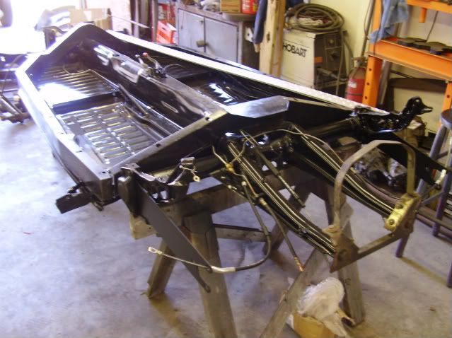

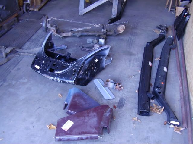

The Foundation of the Pan I have a almost completed pan ready for this build that will help me leap frog forward in a hurry. It is a nice '67 pan rescued from the rust devil. I put a new front "hat" on it, new "batwing" and new pans. I have already installed all new cables for the E-Brake, heater controls, accelerator cable and flushed the fuel line. I installed a new shift rod bushing and new shift coupler. I have welded the seams of the trans forks and installed new rubber spring plate bushings. I have even coated the bottom of the pan in smooth bed liner material. This has all been done for over 2 years awaiting a project to put on it.

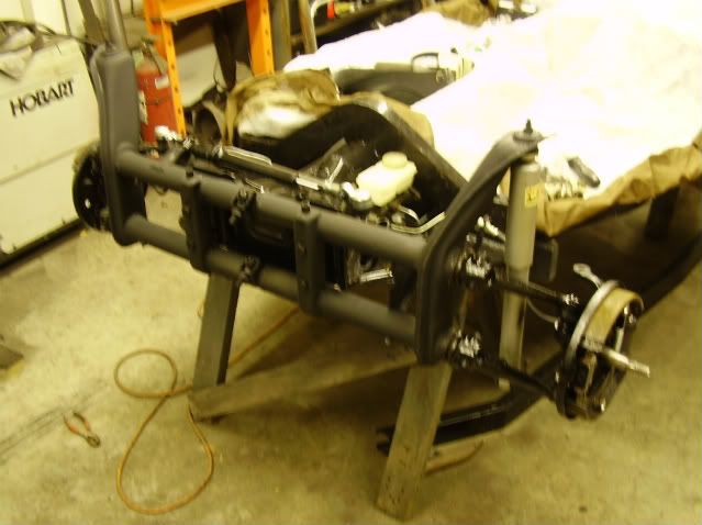

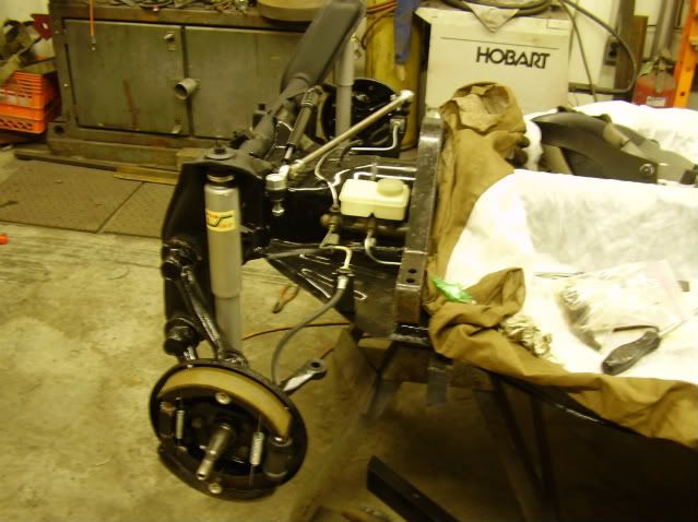

The front suspension The front beam was a real nice German BJ unit that I welded in adjusters set at just below stock in the lowest position so almost all adjustment is up. New KYB's, New German BJ's, New FAG nos bearings, New Seals, New Wheel Cylinders, New Brake Shoes, New lines. Welded the shock tower seams and rebuilt the steering box. Installed new tierods and ends. This also has been done for 2 years.
Now to take some of it back apart. Thing trailing arms I bought 2 years ago at a swap for $ 100.00 will get new German BJ's and the Thing spindles will get installed and the stock front parts boxed up for another project. I have purchased brackets that will allow disc brakes to be installed on the VW stock Thing spindles. The new tie rods will get removed and DOM tubing will get tapped and Hiem joints will get installed. I have also installed Camber shims to help the front handle a little better.
Rear suspension and trans I will be using a large nut bus trans in the swing axle rear suspension. I found a set of NOS John Johnson No Hop bars and will be installing in the upright position. The trans appears good, but I will be going through it just in case. Since I have to remove the RGB boxes to install the JJ kit, they will receive new bearings and seals I bought this spring from member Hazetguy. I will be using the stock bus 1 ton rear brakes, just re-newed.

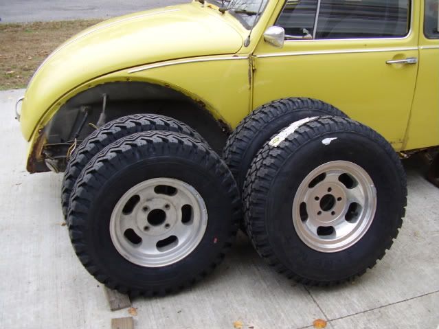

Tires and rims Old school here. Ansen Aluminum slot rims, polished. 700 X 15 front tires and 31 X 10.50 rear tires. Bought these last year.
4 lug front and Chevy rear with adapters.
Engine I had purchased these engine parts starting about 4 years ago up to just recently. A 2165 (78 X 94) is about ready to go together. I have already clearanced the rods. Clearanced, cut, welded, bored, full flowed the AS41 case. The heads are new 041's that I traded for a few years ago that I will port slightly. The pistons are a left over new set of forged Wiseco's with valve reliefs and tool steel wrist pins. I am still debating cam choice. W-110, FK-41, FK-7 are my current choice leaders. It will be topped with either 44 IDF's or 45 DRLA's, (have had both for years now, will need rebuilt). Stock cooling tins. Ceramic 1 5/8 exhaust with self modified high flow 1 5/8 heat exchangers. A Glenn Ring rebuilt 019 or 010 distributer (had Glenn rebuild one each last year for me).

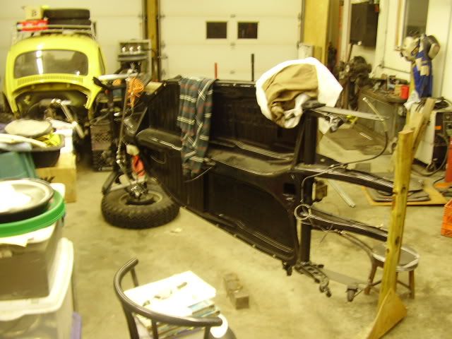

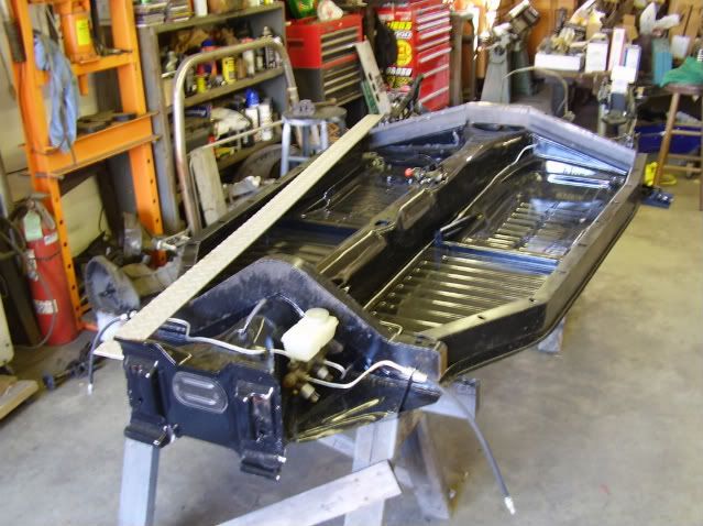

The body lift in the above picture will not be used. It is a POS that I bought a few years back and have determined I do not want to use it. I will instead fab a lift out of 2 X 2 boxed tubing, welded solid around the paremeter.
I want this strength so I can weld in rock slider style bars to protect the body/pan and give a slight running board for my wife to get in and out of with.

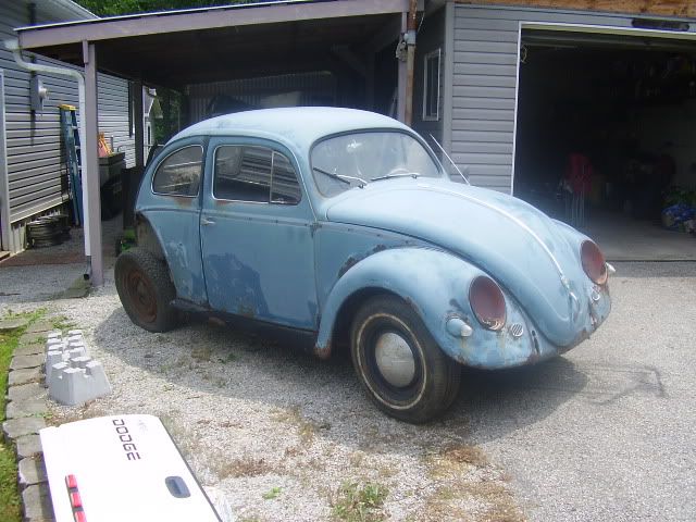

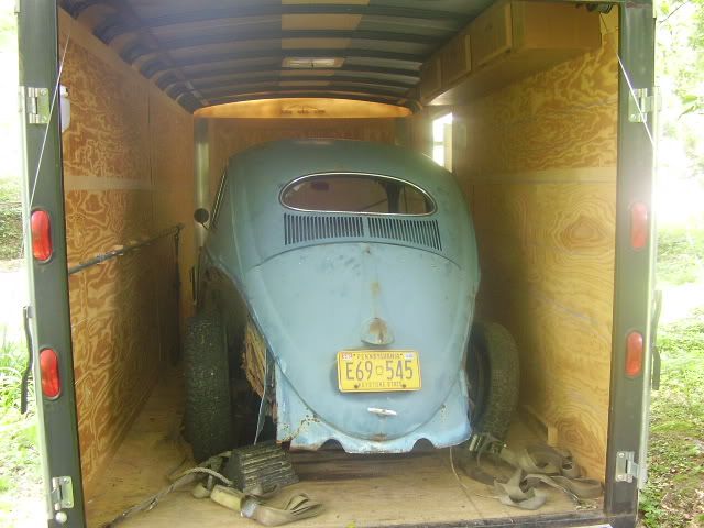

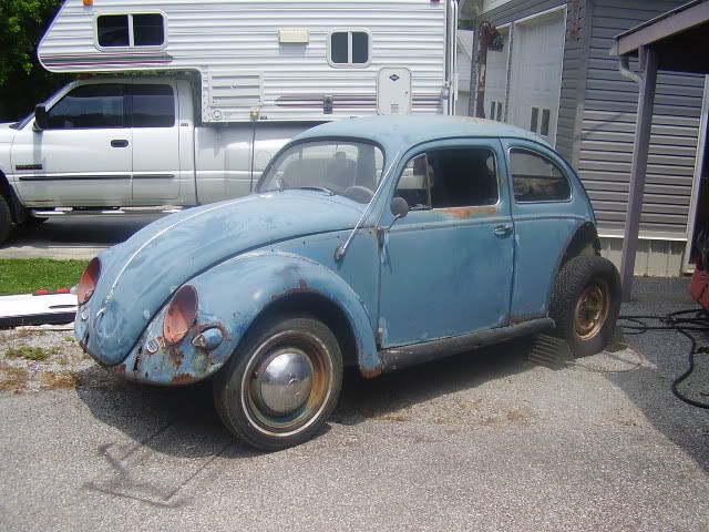

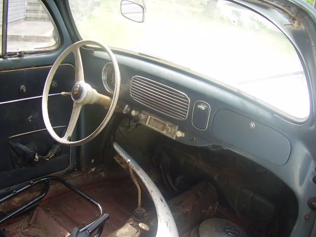

The Body I watched the Oval body for 6 months until the price matched the quality and was lucky to get it before the crusher ate it. It is a '56 with a perfect dash. The doors shut nice and the roof is in great shape. All glass is there and the windows roll up nicely. The heater channels need de-rusted with a sawzall. The front apron and rear apron are just about non existant.
It is rougher than what the picture lead to believe.
A shot of the pan on my home made stand

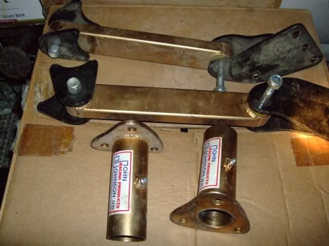

NOS John Johnson No Hop Kit I found after searching for 1 year

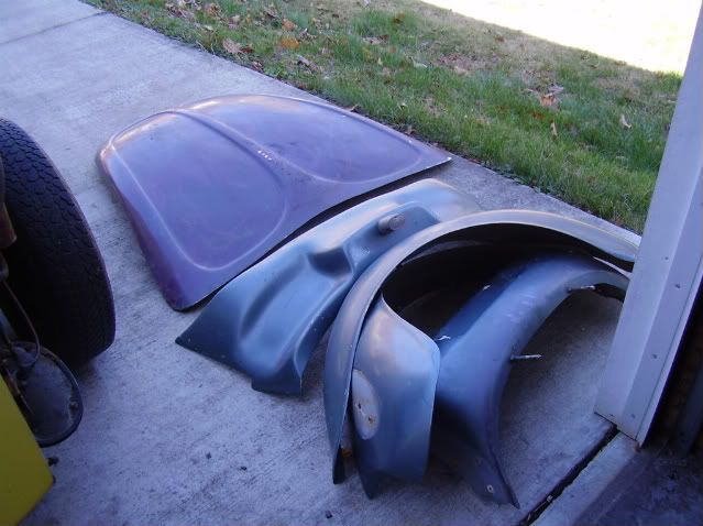

Last fall I purchased a set of high style rear fenders from Dubbers Toy box. Not only are they cool looking, they look serious.
http://www.thesamba.com/vw/classifieds/detail.php?id=793537
The front fiberglass is picked over used pieces that I have gathered during swap meets over the past few years.

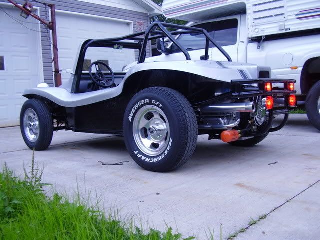

The rims, (and most of this build) are left overs from another build. I am not using them just because they are there, but also because I really like the old slot rims.
I had built a FG buggy three years ago and wanted big's and little's on it. I bought 4, 4 lugs and 4, 7 inch wide 5 lug rims for the buggy to get the big and little treatment.
These left over rims are now going to get their fair share of use on the Baja. The buggy was built to sell. The Baja will be my keeper.
Here is the street buggy I built.

My first thought too was 4 down and 2 up for the same reason. I then started tothink about the weight I was adding. I came up with using the 2 X 2 and where the cage mounts, welding a 2 X 2 X 2 extensions to the body lift to pick up the roll cage legs/mounts.
This would still have the strength I was looking for, but be lighter and have less interior room taken up by the boxed tubing like around the seat sliders where room is tight already.

How in "H" did you find an un-used set of JJ's No-Hop bars. I hate you! Evil or Very Mad Laughing By the way, I stole a copy of the photo.
I searched high and low for them. After about one year with a add on this site, I got an email from a non-member who had a set. They were installed on the axle tubes and the brackets tacked onto the torsion housing, but never used. He wanted a small fortune to ship them from CA to WV. I told him I did not want the RGB boxes, axles and tubes, but I would purchase them if he removed them. He said OK, would take a week and then get back to me with a total price including shipping. They looked sharp and in great shape. So, in dealing with him for over a month to get pictures and come to an agreement, I committed to a purchase.
One day after that email, another non-member sent a email that he had a set that also was NOS and had stickers on them, still somewhat in the OG box. His price was 1/2 of the first guy.
Crap! I REALLY wanted the second cheaper set over the first set, but I made the committment and I stood by it.
I bought both NOS sets. These pictures are of the second cheaper NOS set that have the stickers on them.
There is a slight difference in them. The first set has a longer bottom strut bar than the second sticker set. Otherwise, they are identical.

The difference in length must be for a purpose. Are you interested in re-cooping some of your investment?
I will post up dimensions and detailed pictures of the JJ No Hops in the reduction thread in a couple of weeks when that part of this build starts. That thread is:

what do the no hops do and where do they go?

As the owner of a '57 Baja Bug with reduction boxes, I approve of this build.
