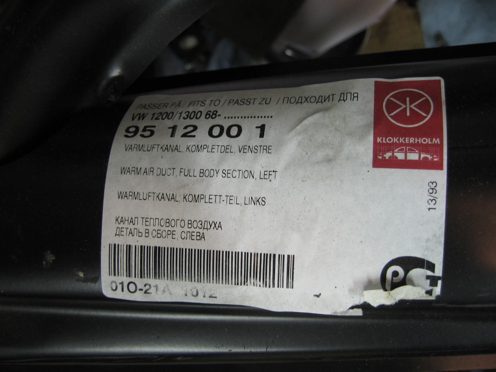

Alright, this may not not be a very exciting update, but I believe it will at least be informative. If you have followed this thread at all you are aware that last summer I purchased some heater channels from a very well-like supplier for my '73 standard build. The quality of these heater channels was so poor that it stopped my project dead in it's tracks. I absolutely refused to weld them into my car. So I reviewed my options, and had hoped to procure a set of OG heater channels cut out of a donor car. There were a few available, but the shipping cost I was quoted was ridiculous. So I did some reading, and found a number of people who had said Klokkerholm heater channels were very poor quality, but a company named Dansk made some that were better. I located them at CIP1.com, and when they went on sale I ordered a pair. They arrived today & I am very happy to report the quality is much, much better than what I had. Let's start with the metal thickness. The Klokkerholms' top section measured in at ~.032" thick:

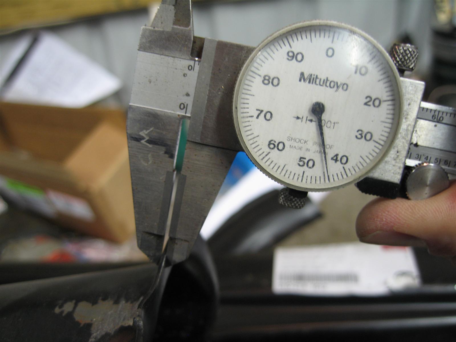

The Dansk however measured in at the OG thickness of ~.045":

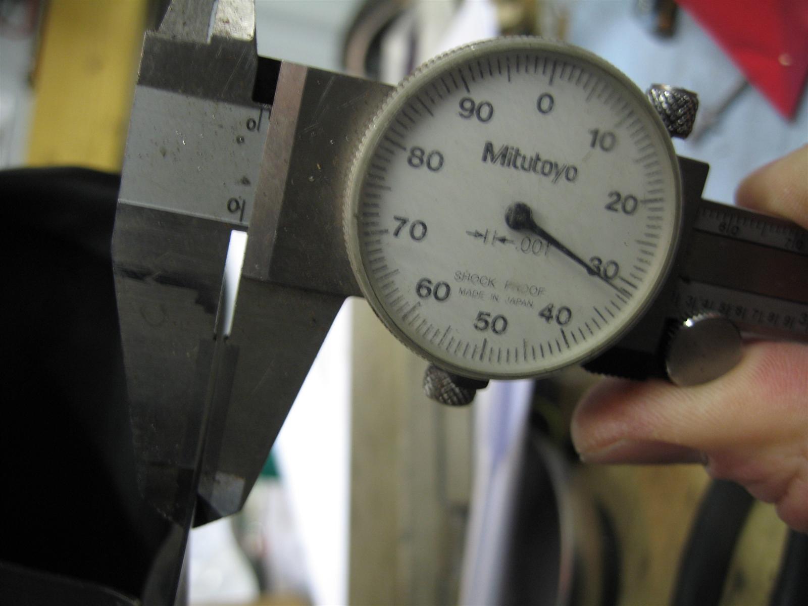

The bottom plate of the Klokkerholm measured in at ~.032":
While the Dansk bottom plate is a very impressive ~.055"!!:
The difference in thickness of these parts was impressive. But the difference in total weight was borderline shocking. The Klokkerholm channels weighed in at 11 lbs:
The Dansk however weigh in at an impressive 15.5 lbs! That's 41% heavier!!!
That translates to 41% stronger.

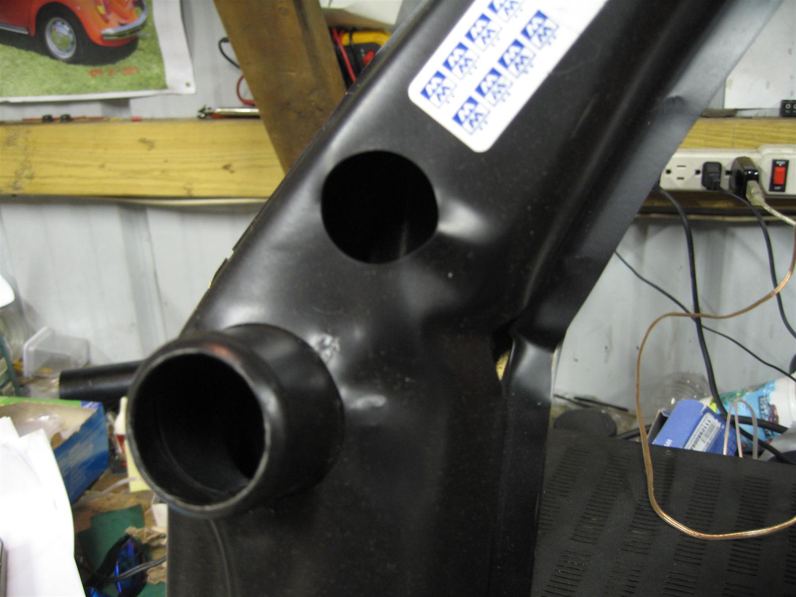

Take a look at the difference in the stamping quality:
I doubt I have to say at this point which is which.

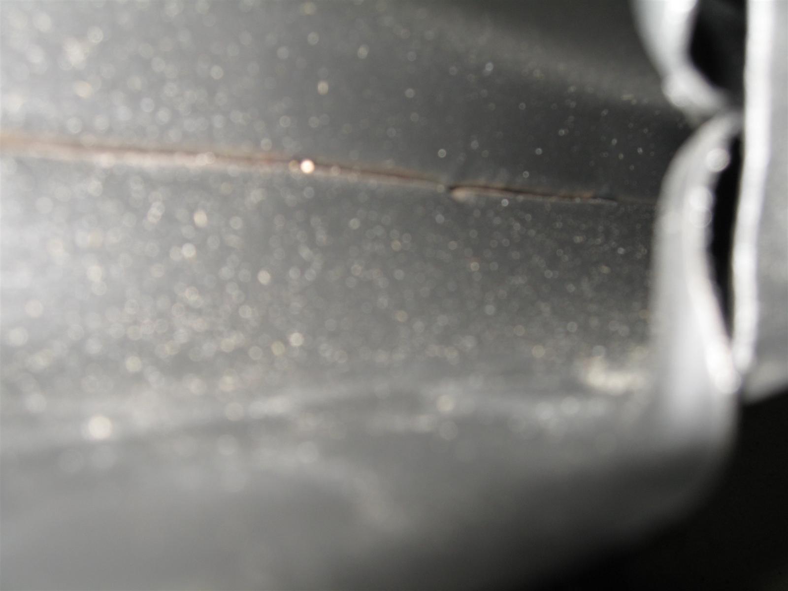

I've saved what I believe to be the most important for last. Take a look at this:
That's is the inside of the heater channel pictured from the back. Notice it's bare metal. How long till it starts to rust from the inside out? Not long. Now look at this one:
It's been E-coated. (read about it here: http://en.wikipedia.org/wiki/Electrophoretic_deposition)
Bare metal, only sprayed from the outside:
E-coated:
Bare internal metal:
E-coated:

I was only able to find info one these two manufacturers for late model beetle heater channels. I know Gerson is working on earlier beetle heater channels, but I don't know of any other manufacturers for the late models. If there are in fact others, feel free to share that information. I look forward to finally restarting my project with these heater channels. Thanks for looking.
