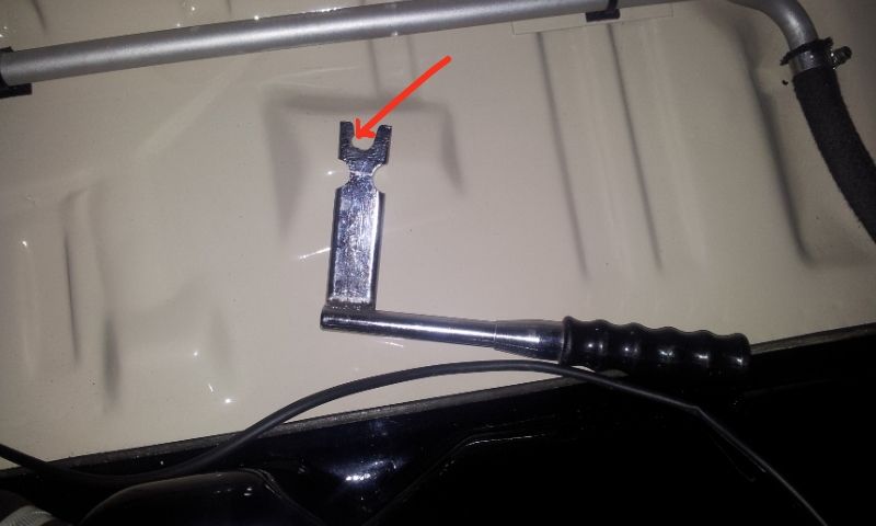

Mark - Could you post a pic of the tool you used? One side of the hood spring popped out of the bracket and i'm having a hell of a time trying to get that bitch back in!

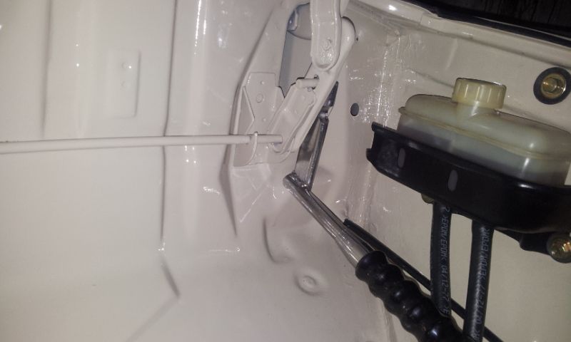

PostPosted: Wed Apr 03, 2013 11:43 am    Post subject: Reply with quote
that spring was an absolute nightmare to get in but once I modified this tool it popped straight in! no idea what this tool was originally but I think it has something to do with brakes? you can just see where I filed a notch in the opening to grip the spring, this is the key making the tool work!

PostPosted: Wed Apr 03, 2013 1:37 pm    Post subject: Reply with quote
Sweet! Thanks Mark!! I was thinking of something similar to that, just wasn't clear on how big and the exact shape. I'll be making something similar tonight. This whole time I was using a large screw driver and it kept on slipping. Notching it should make it super easy!
