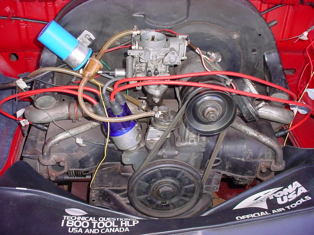

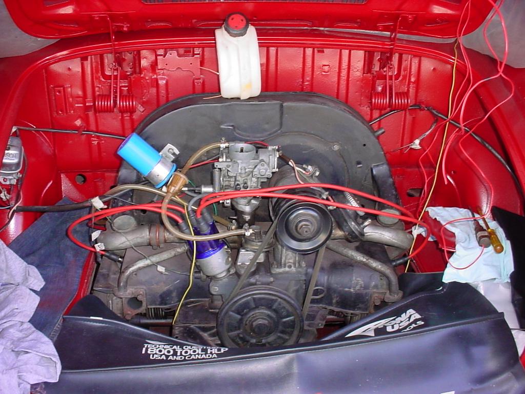

here are the pictures of my engine setup:
and
Questions? Email me, I always answer all emails, same day or next.

Don't run your Ghia on the road with all the wrong and missing parts in your engine compartment. Too cold? your engine will be frying without the engine tinware...here's what your 1600dp should look like...
Number one replace your fuel lines with the proper fuel hose and place the fuel filter outside of the engine compartment!
The carb you have is too small for the 1600dp...you should have a Solex 34pict and a stock vacuum distributor.
You need the fanshroud to heat exchanger hoses and an air cleaner set-up. Engine tinware is an essential for the aircooled engine...it separates the cooler top half of the engine from the hot bottom end. Take away the separating tinware and on even a warm day your engine will grind to a halt in a shimmering blue haze...not nice.
You can't tune your engine without the exhaust and aircleaner assembly get it in a state ready for the road and then get the engine running.
Others more knowledgeable will be along shortly to expand on these general observations.
John.

Try swapping plug wire places 3 and 4 on the distributor cap. Right now you have them on the wrong spots.
WOW!, Really?? I do not have any miss fire...
is any map, plan, picture on where the wires are supossed to be??
or can you send me a picture of yours working OK?? to [email protected] thank you!!!

typically the distributor sits so that #1 is closest to the crank pulley. That is #1 cylinder then going clockwise it goes 1,3, 4, 2. It looks like all your wires are out of place
Close, but no cigar.
The firing order is 1-4-3-2.
#1 & #2 are reversed from what they should be.
It is no wonder that the engine "shakes".
OMG.. thank you... Iwill try that tomorrow..
the engine can be damaged because of my error wiring the spark plugs???
idling was ok,,, that is what I questioning... waiting to test that tomorrow
thank you again.!!!
