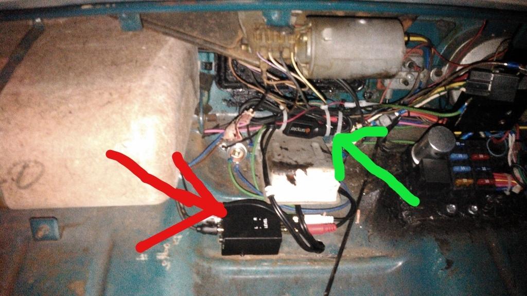

Here is the iSimple ipod-to-rca adaptor installed in the car. I tapped into the dome light power so I would be able to charge the ipod all the time. I put the ipod plug in the glovebox so it could be hidden when not in use. The rca out goes to a volume control placed unobtrusively under the dash, then to the linear amplifier box to boost the ipod signal. I have to split the rca to send input to subwoofer and speakers, so I put in the linear amplifier. If you were just powering a 2 channel amp and a couple of speakers, or perhaps one of those dual voice coil speakers that go in the stock location, I don't think you'd need the amplifier.
adaptor is green arrow; line amplifier is red arrow:

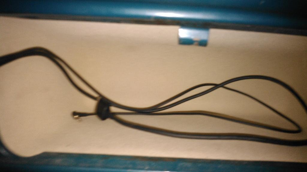

ipod plug (and aux plug for android users) in glovebox:

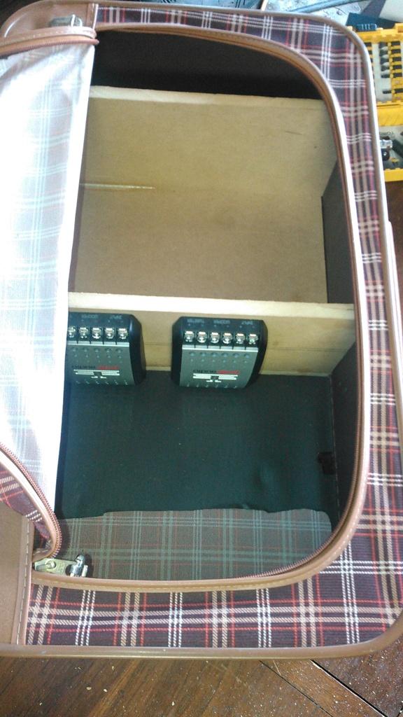

Here is inside of suitcase. The upper is the subwoofer box, the tweeter crossovers are mounted to the side of it. Sub is an 8" Rockford Fosgate punch; mids/tweets are Polk audio db5251's.

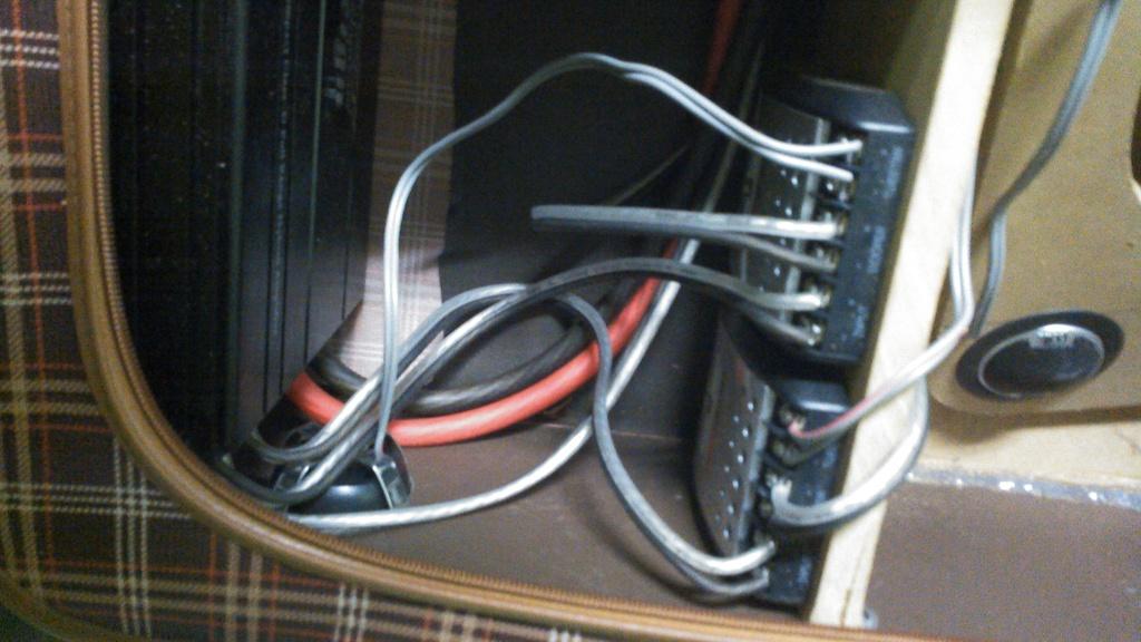

This pic shows the amp (on the left) and the crossovers for the mids/tweeters all wired up. I'm using a Lanzar amp, which isn't the best, but this ain't no show car. Should be enough to push the speakers I have.

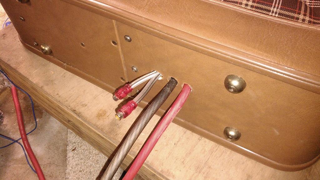

Here's the rca and power coming out the bottom of the suitcase. I plan on leaning the suitcase back to point the speakers up somewhat. These will be hidden under a mat. 4 gage wire is probably overkill for this application, but the first rule of overkill is YOU CAN NEVER HAVE TOO MUCH OVERKILL!
