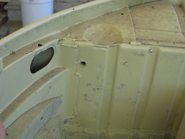

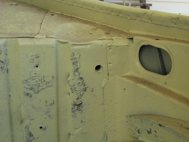

My '69 has what look like seat belt mounting points high up on the rear firewall, but I have not tried to put anything there. For some reason I think it used to have plastic caps over the holes, but it's been so long since I stripped the car that I don't exactly remember. Seems like a non-retractable seat belt would work in the rear, but I haven't tried ... yet.

Just took some pics:
Right rear
Left rear
