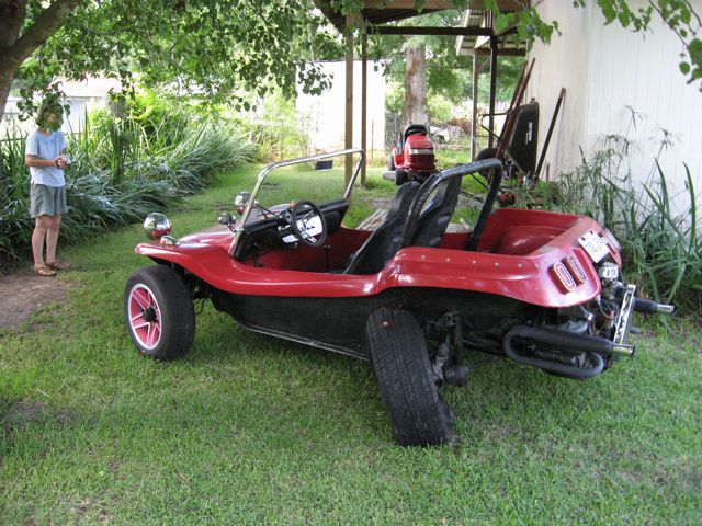

After 3 months of driving the buggy almost every day, disaster struck last night. I went out for a late night drive, just to enjoy some cool night air and came across an accident. A young man drove off the interstate and rolled his SUV. I was the first person on the scene and immediately called 911. While still on the phone with 911 and waiting for help, another vehicle hit my buggy as it sat next to the accident scene. The road had no shoulder so I had pulled off as far as I could.
The driver that hit me was arrested for DUI. Troopers wanted to ticket me for obstructing traffic, but I convinced them there was really nowhere else for me to stop and they decided not to cite me.
The buggy was hit in the left rear wheel. I really expected to see shattered fiberglass everywhere, but the body has only minor damage ... a couple of cracks and some damage near the left torsion cover. The pan however may be unsalvageable. The torsion arm is severely bent and the torsion housing also has a bend in it. The wheel is broken and at least one CV came apart. The transmission mounts sheared off and the trans ground strap broke loose. The pan does not look it buckled and the frame horns seem OK, but I won't know until I can get the thing apart and do some measurements. All welds in the pan where it was shortened seem to have held, but this is just from a quick look over. I'm too upset to really give it a good going over.
I'm so disappointed in what happened, because I just wanted this car to be a driver and not have it turn into a long-term project. I'm lucky no one else was hurt, but this just sucks.
I just got the car into my storage shed and talked to my insurance agent. He says he'll help as much as he can, whatever that means.
So, can I straighten a torsion housing?

That is such a bummer dude. No, i dont think i'd attempt straightening a torsion housing.

That sucks man. While I am sure it could be fixed I am not sure I would try it. You could maybe get away with just back-halfing your current pan instead of doing a while new one. Until you get the body off and can really measure to see how far things are out of whack you won't really know.

So sorry your car got hit I switched my rear from swing to IRS was a faily easy job and the IRS rear section cost me 100.00 so not that big of a deal in my opinion.
Just sucks you have to tear it all down again.

Put you a Berrien Frame under it. There is a dealer in Mississippi.

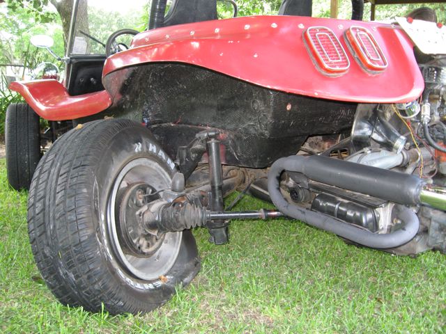

A closer view. Hard to see in this picture, but something from the other vehicle went through the tire and punched a hole in the wheel.

Man, that must have been a horrendous impact. How far from the buggy were you standing? That must have been heart stopping.

I was about 12 feet away, on the phone with 911. Sounded like a small explosion to my left, then I saw my buggy take a hard right turn and run down into the ditch. Other car's passenger side air bag went off.
