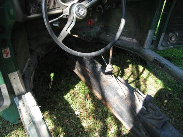

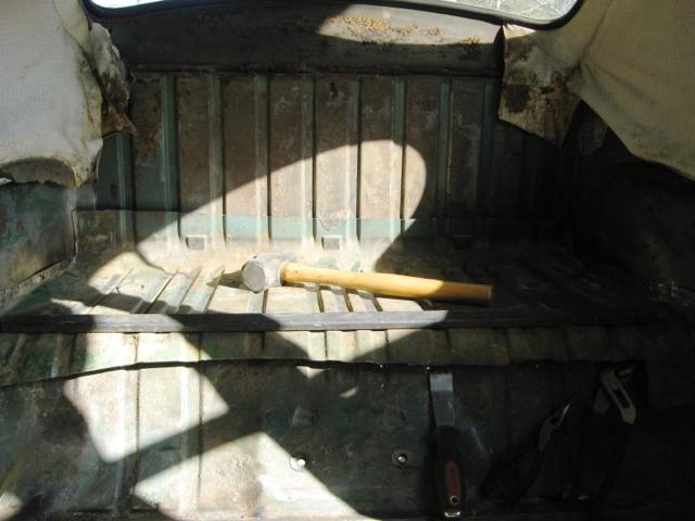

Went to look at the wheels and took the entire car home. At first I thought it was going to be parts, but the car is pretty solid ... and it has a title. Engine is in a box, and there are a couple of trash cans worth of parts that came with it. It looks like most of the car is there. Paint is a poor respray in the original color. All 4 fenders have damage from tires rubbing the wheel arches. Some rust in both front wheelhouses, but heater channels appear solid. Floor pans and rear package tray were cut out with a torch. So far I see nothing that can't be fixed. Sooooooooo, what to do with it?
US Indy 4 1/2" X 15"
Hood had some ripples in it, so it was filled with bondo that is failing.
Doors close well
Heater channels are solid
Package tray removed, but solid under the rear window.
Floor pans removed with a torch. Napolean's hat is solid.
Original Radio
Right now, I'm thinking of a quick and dirty reassembly. First I need to inventory what is there before I make a decision.

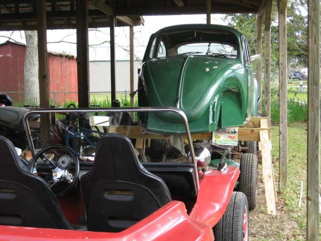

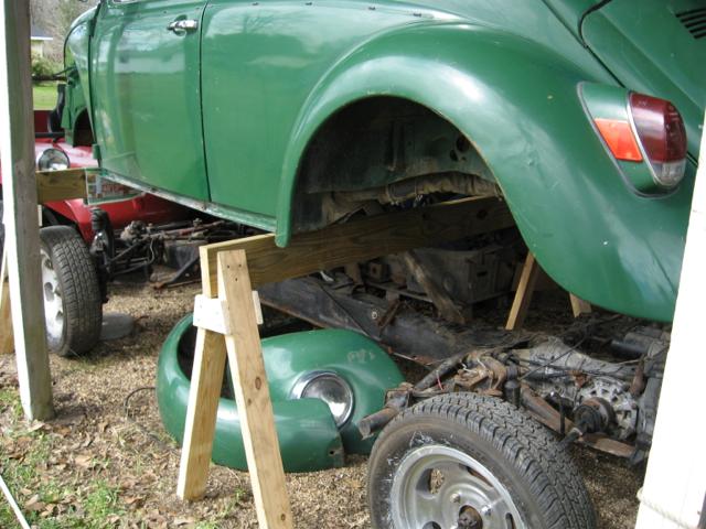

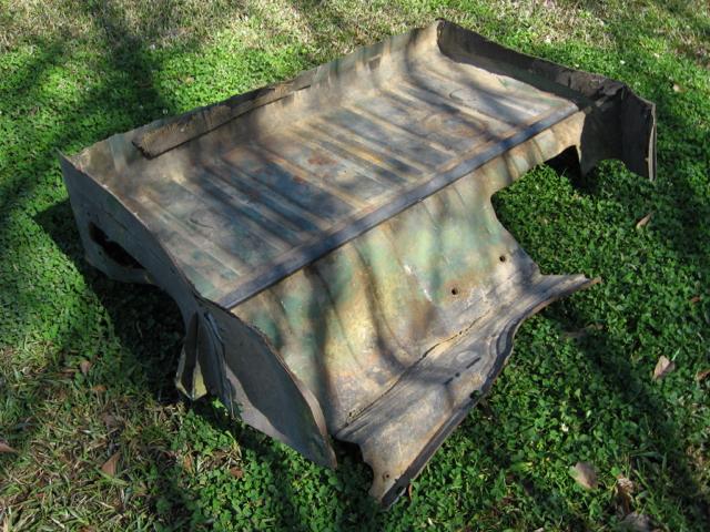

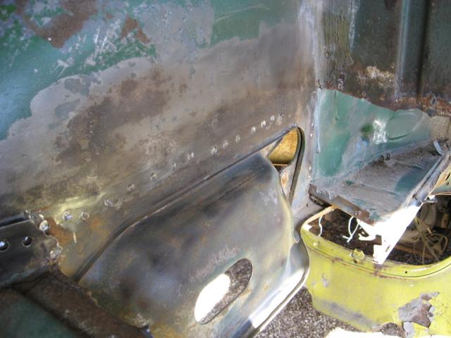

Pushed the car under my shed and lifted the body off. The pan will get moved in a couple of days but the body is gonna live here while I work on the pan.
Rear wheelhouse looks good.
Getting a little crowded in here.
This is supposed to be a quick and dirty build. I wasn't gonna do any body work yet, but I couldn't help myself. There was a patch here, so I sanded it smooth, primed it and shot some rattle can green on it to test the match.
The match is close enough that I'm thinking I'll do under all 4 fenders. No one is gonna notice under the fenders if the match isn't perfect. And I may undercoat the car anyway.

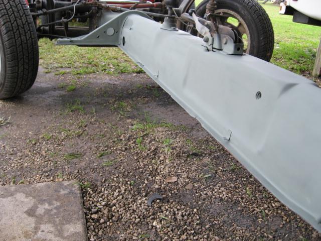

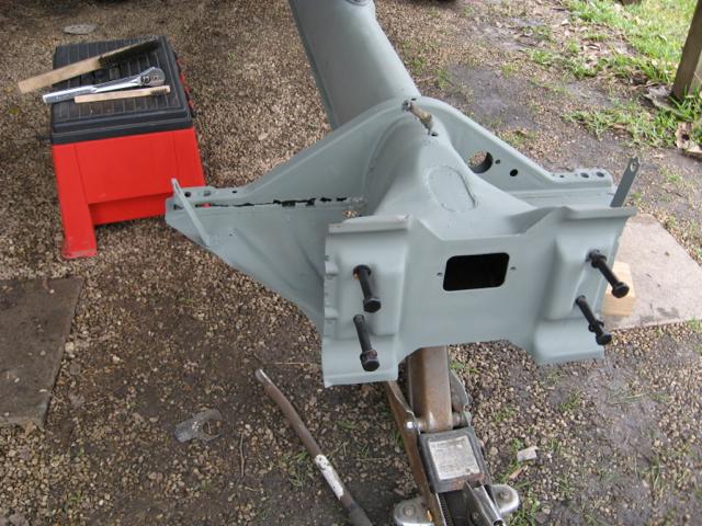

Started getting the chassis ready for new pans. Cleaned off lots of rust, paint, tar, slag and grease.
Shiney!
The remnants of the old pans.
Framed head is solid ... except for this. Cut with a torch.
Need to order parts soon.

Did a bit more cleanup, then shot some rattle can primer on the tunnel to cut down on any flash rust.
We're supposed to get rain this evening and I won't start welding for at least a week.
Also, I went for a ride in the buggy late yesterday afternoon and came home with a nice, solid package tray.
No rust, just a couple of very small holes drilled in it.
Now I need to clean and prep the tray ... and order pans and brake parts.

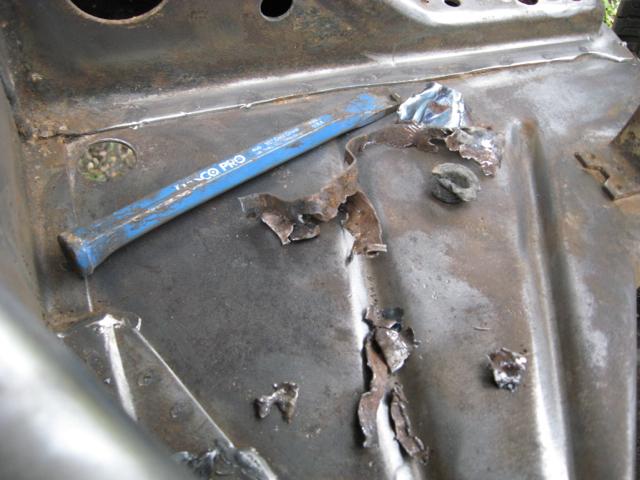

Well, I've been down with a gimpy leg but I was able to do a little more work today. Time to prep the donor package tray.
Wire wheel quickly removes paint and seam sealer. Look at those spot welds.
Use a sharp punch and a hammer in each weld.
Pry the pieces apart.
One package tray, ready for trimming.
Not as clean as drilling out the welds, but much faster.
I'll drill the welds on the car when I get there.

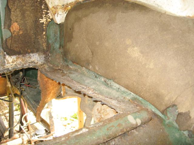

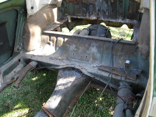

Got a little more done today.
Started with this, that the PO cut out with a blowtorch.
Removed the old seam sealer to expose the spot welds, then drilled them out.
The remnants almost fell out.
Metal is really solid under here. Should weld up nicely.
Drop in the donor.
Still need to do final trimming, but I'll wait until I start welding.
I wish the donor had a little more metal on it. As it was cut, I will need to patch a couple of small holes after the large part is welded in.
