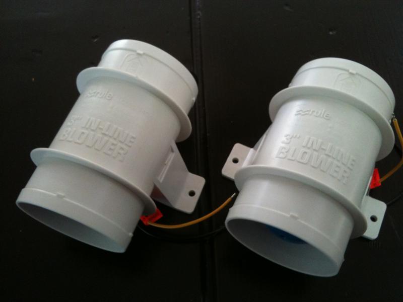

I ordered two marine bilge fans for an experimental heater air augmentation system.....a little "boost" if you will for defrosting and general heating of the car during the winter months. I've read a few articles about these and the folks who use them swear by them. I will make my own housings and get them installed. More pics to come of that creation as well.

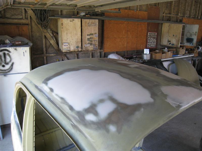

PostPosted: Tue Nov 08, 2011 5:55 am    Post subject: Reply with quote
I received a text from my painter yesterday. The photo is not the best, but he got the 2K build primer sprayed. From the pic, it looks great. I'm happy with the way the rear apron turned out. I’m hoping to get by there tomorrow to get an up-close look. Exciting!
More to come

PostPosted: Wed Nov 09, 2011 5:04 am    Post subject: Reply with quote
Thanks Greg. They always do in flat primer, don't they??? Laughing I feel sure it's as smooth as it looks. I hope to get by there today and see for myself. Can't wait. Thanks for checking in and I'll post more pics as I get them.
Moto

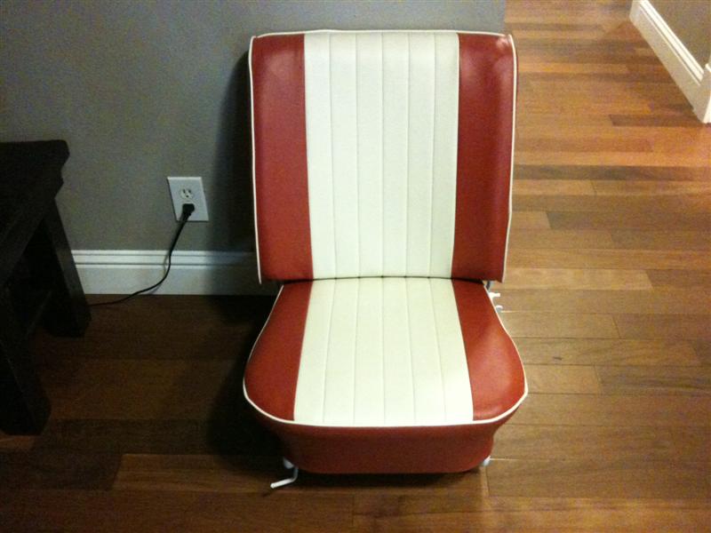

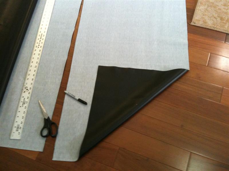

Well alright.....got a little seat upholstery done. It went pretty well, I'd have to say. I had to do a few little things here and there to make it all work, but I think these will be great seats for years to come.
I first started with a roll of vinyl to cover the seat springs.
Here is the vinyl, smooth side down hog-ringed to the frame. It really didn't matter which way this was facing, I suppose, but in the Wolfsburg West video I was provided with the seat pads they mentioned this layer functioning as a type of moisture barrier. The vinyl had a mesh layer adhered to one side (grey looking) and it was smooth on the other. So I put the smooth, black vinyl facing the "elements". I had to pick an orientation and that's what I came up with. You have to make the stuff up as you go, Laughing .

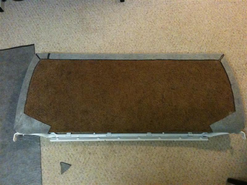

I went with the WW Coconut Hair seat pads based on many of the threads I read here. Although I have not used anything else, I would have to agree with the others in that I least I can say these things are top-notch. I had no complaints.
I purchased the cotton batting material from WW for the seat perimeter, just like VW used to do. Here it is cut and adhered to the seat with 3M spray adhesive.

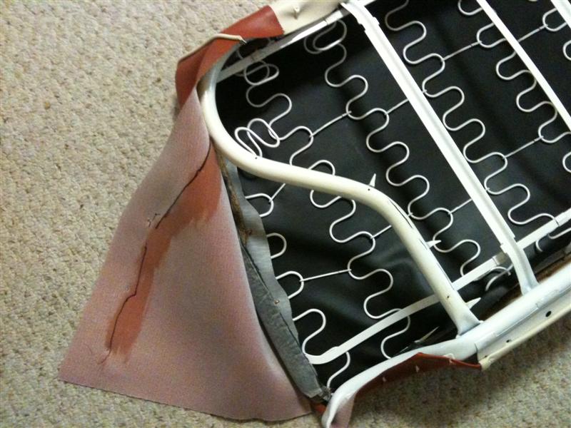

I noticed on the side rails of the rear seat back rest, it appeared the OG seat cover was held in place with upholstery nails. I opted to go with commercial contact cement here. The main reasoning is because I knew this would be supplemented with the installation of the fiber-board seat back installed with screws later. I just needed something to hold the vinyl in place until I could get to that step. It worked great.
Here is the side piece before synching down at the bottom.
At this point, I put down my conventional tooling for something a little more "delicate". There were some areas of the upholstery that I just wasn't happy leaving alone. I wanted these covers to last for the long haul. I stitched up a few places to give a little strength and to complete the overall look of the covers. Here were the tools of the trade I used (sorry for the crappy pic. I could not get my camera to focus).
Not the best pic, but here is the first area I sewed. The metal hooks from the seat frame were present, but I just couldn't see the vinyl holding up over time on these hooks alone. Also, the gaps between the hooks left a very "unfinished" look to the seat cover. So, I sewed everything up tight. I used an ivory-colored upholstery thread to match the piping here because I could not find red. I later switched to a red-colored yarn-type thread on the front seats. Also, notice the weight rack in the background of the photo. I found it made me feel better about sewing if I leaned the seat up against my weight rack in the workout room Laughing

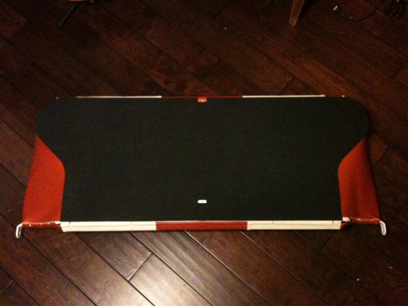

Completed rear seat back, front-side.
Here is the back-side, before I screwed the back panel down. I just rattle-canned the fiberboard (also purchased from WW) Krylon flat black.
Before I move to the front seats, let me just say that during this process I discovered that my local VW shop sold me an incorrect year model rear seat, seat bottom. This is AFTER I had it powder coated, hog-ringed the vinyl down to the seat bottom, and attempted to stretch the seat cover over the frame. Evil or Very Mad Evil or Very Mad Evil or Very Mad Evil or Very Mad Evil or Very Mad Then I got over it. Rolling Eyes
I read several threads and I saw one guy who had increased the padding where the seat springs had gotten a little worn by adding pipe insulation. I did this as well and it worked GREAT! I just weaved the pipe insulation up and down between the springs, as equally as I could.
And the same process as before.....
Cotton-pile cut to fit and seat marked for location.
Test fit
Adhered
Installed

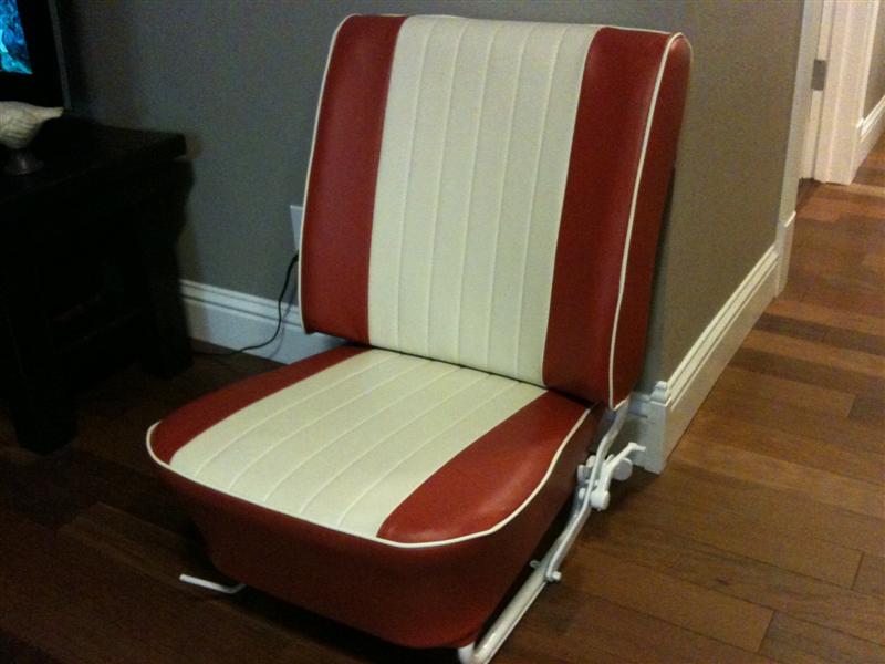

Now, about the seat backs......let me just say that I probably could have used a new seat back on the driver's side. The seat springs had broken years ago and had been re-welded to the seat frame, yada, yada. And yes, I should have noticed all this and spent a little more time with the seat frames before I had them powder-coated. They were superbly upholstered before so I didn't think twice about it. But what I didn't think about was that they were upholstered in a custom, non-OG fashion. When I began to use OG material, I started seeing where the old "fixes" on the seat were masked by the foam padding and custom upholstery work that were done before. Oh well...learning lesson. I had to make some things work for lack of a better way of saying it. So, I didn't take as many pics mainly because I was busy and very frustrated. I had to really work to get the fiberboard seat back in place and it was definitely a "custom" installation. Here is a pic of that.
Once the seat cover was slipped over the pad and cotton, I elected for my own custom upholstering technique for synching the bottom down. I basically laced the two steel rods in the front and rear seat covers together with stainless steel safety wire. It started to look like a scary dental project....
Here is the cover laced together with the "pig-tails" sticking up. Those of you familiar with aviation know what I'm talking about here.
The pig-tails where then folded and tucked back in between the two metal rods and into the inside of the seat. I've been thinking that I may purchase a piece of the brick red vinyl and bond it across this seam, but it's probably not necessary. I haven't decided yet.
Here's an example of what I was left with and how I fixed it. This is the remaining seat cover material with no where to go...
And here it is after I sewed the snot out of it. MARTHA STEWART AIN'T GOT NOTHIN' ON ME, HOLLA!! Laughing Laughing Laughing
And the driver's side seat complete.
