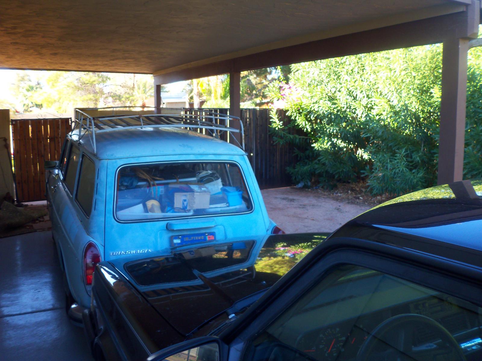

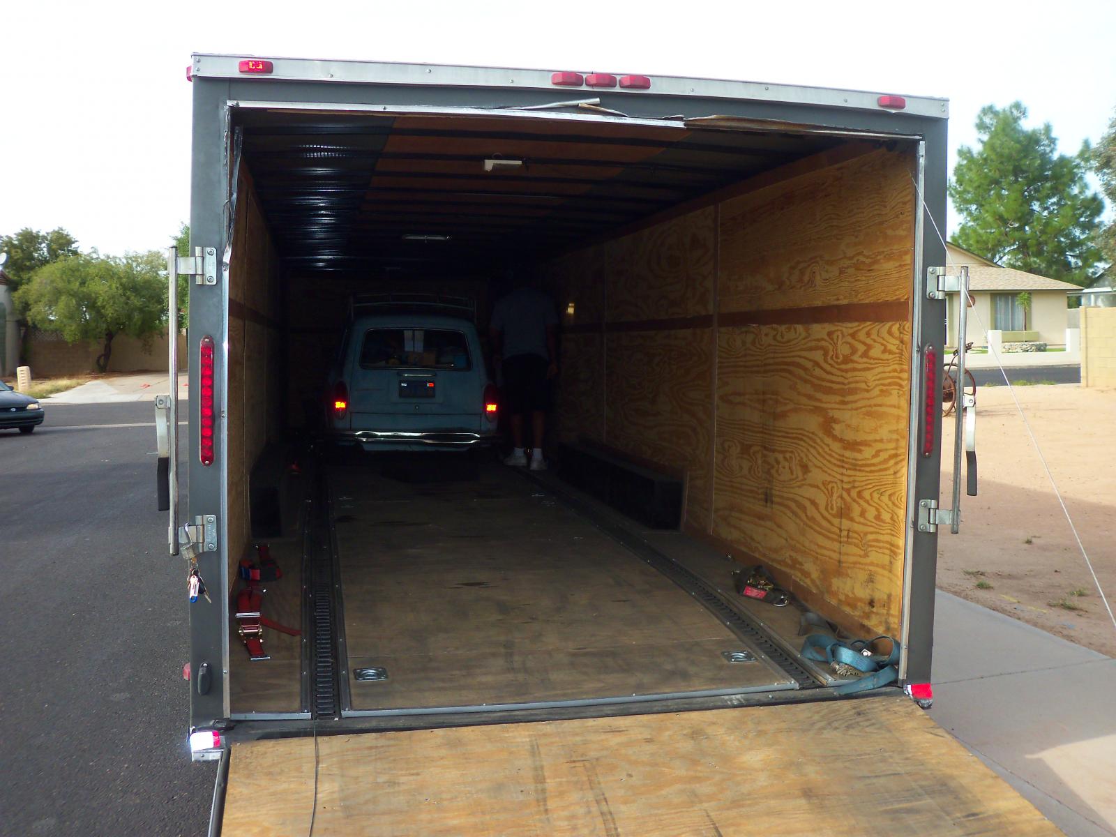

Well, a miracle happened! Wink
Coming off the trailer yesterday at 14:00:
No extra charge for inclosed.
And home in the carport:
For now, that is it...

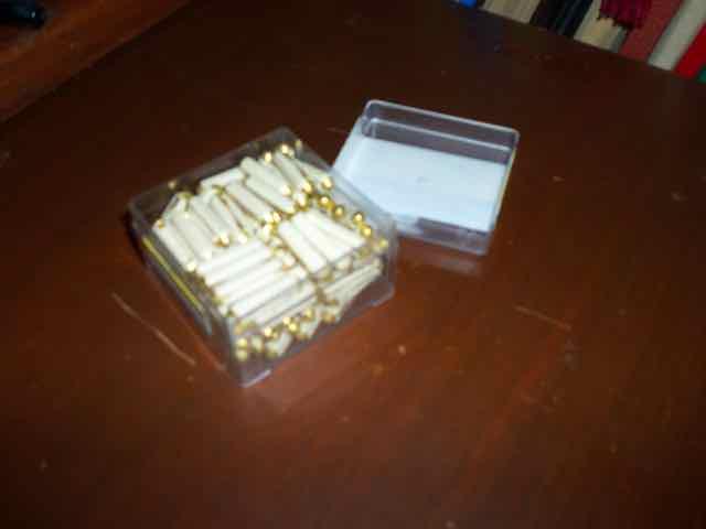

Calling in the morning and see if the local German F.L.A.P.S. is open. If so, can get fuses and a fuel filter ordered and filled for Mittwoch. Got a lot of electrical to sort, but I took Bob's suggestion and been using 16' leads with alligators. But, no progress there either since not getting power to the box and now my meter seems to be going on the fritz. Worst case, got a Harbor Freight.

PostPosted: Fri Jun 03, 2016 6:59 pm    Post subject: Re: Squareback Rejuvenation - A Soap Opera Reply with quote
Picked up the fuses today that the oder filled yesterday. In nice hard plastic boxes with full lids. Doesn't say where made, but supposed to be Germany. These are brass and the 16 and 25 amp fuses look to be copper. Next week got me down for Wednesday only, so give me a chance to make time to spend with the Squareback.
Also picked up something else along the way... Made such a thud that thought had lost a significant part of the engine. Laughing Little bolt smaller than a quarter, solid brass it looks like.

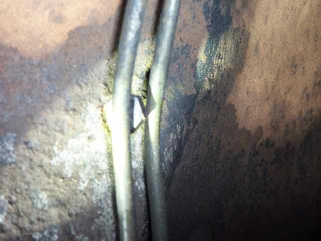

Got a bunch of cores done, burned out, and ended up going back to the hood. Bob was right: thinking is working. Thank you Bob for all the help and getting me to get back again. I sadly forgot how great and sweet Volkswagens smell and breathed deep while was under and in the front trunk area. Laughing
Got inside the spare tyre well (nice fit, though with so high up on stands, bit of a long reach) and realized what was catching was not the release, but the pointy end (I refuse to call it what Joe calls it Razz ) was sitting so the upper flat was caught. Got my flare wrench and loosened the latch enough to get the hood loose.
Turns out the "new" upper latch helps, but the major issue is the apron and the hood positions. I got good and frustrated with fiddling with the hood and latch, so got out the B.F.H. (dead blow from Harbor Freight) and gave the apron a few good whacks. Helped actually. Cool
Then thought some more. Think Realized that the hood could go ever so lightly back. With a lot of fiddling, realized again I could take the same hammer and give very, very, light taps and get the gap and height of the rear edge close as possible without scraping the paint or the washer nozzle. But, the latch still needed to be adjusted as not 100 percent right.
Idea
Got my white grease pencil (if any one knows what those are Razz ) and put on a good layer. I then set the latch all the way back and checked. Perfect! Dancing
Now the issue is the pointy thing not fully getting engaged unless press hard. I tried unscrewing, but was too tight. Am I right that it is the pointy thing? If so, any tricks on getting it loose?
Oh, and no pictures as the humidity is terrible and didn't want y'all to smell me, so by the time showered and caloried, got dark. Razz
Thank y'all in advance! Very Happy

PostPosted: Sat Jun 11, 2016 11:08 am    Post subject: Re: Squareback Rejuvenation - A Soap Opera Reply with quote
There should be a jamb nut on the latch pin stud. Loosen the jamb nut, and you should be able to lengthen or shorten the pin length.

PostPosted: Sat Jun 11, 2016 7:16 pm    Post subject: Re: Squareback Rejuvenation - A Soap Opera Reply with quote
Bob, thank you so very much for pointing out the obvious. Very Happy Duh! d'oh! Should have gotten out the manual, but my brain has been missing the last couple days. Rolling Eyes
Decided after dinner and work, to not be lazy and get something done. Now finding two other issues. No matter what, the safety catch gets caught on the release cable and/or its housing. The other is the receiving latch is corroded, so good bit of resistance, even after adjusting the pointy part.
Why is the first happening? Didn't happen when new, correct? So, why now?
So, thinking of a way to rid both of these issues: drilling out the rivets, put in a replacement latch, use bolts, and on one put a bracket to keep the cable out of the way. What do y'all think of this?

PostPosted: Sat Jun 11, 2016 8:40 pm    Post subject: Re: Squareback Rejuvenation - A Soap Opera Reply with quote
I don't recall anyone else ever needing to drill out the rivets & replace the latch assembly. I do need to lube mine regularly as they do seem to get sticky. Use your BFH & grease etc to keep your present latch lubed,adjusted & functioning. I dropped off some beam hardware for you at Trams & he's gonna add to your care package after he gets back from his Dad's funeral in Ohio.

PostPosted: Sun Jun 12, 2016 12:32 am    Post subject: Re: Squareback Rejuvenation - A Soap Opera Reply with quote
However, has anyone had there hood sit proud of the seal so salt water corroded the latch? Just hashing out. Cool
B.T.W., sitting proud is why the hood completely rotted out from the inside out and has been replaced.
Yes, didn't ask since knew Tram was going to Ohio and plan to wait until ready.
