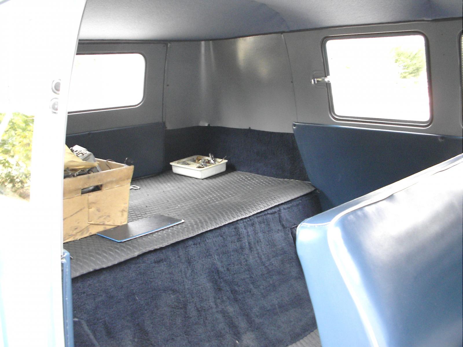

Well I decided not to cut a hole in the dash for the fuel guage.. I was pretty excited this morning to drive the bus out of the garage for the first time. I wanted to get some outdoor photos in the sun but the snow was starting by the time I walked over. I gave the inside a good first cleaning but will go over the floors again. As soon as today's snow melts enough and it warms up again I'll be cleaning the wheels and tires. I hope the colors are more accurate in these pictures than in the inside ones I took before.
Please let me know if I'm posting too many photos.
-Rich

That is a "to die for"barn find Rich. No you can never post too many pictures, keep them coming Very Happy

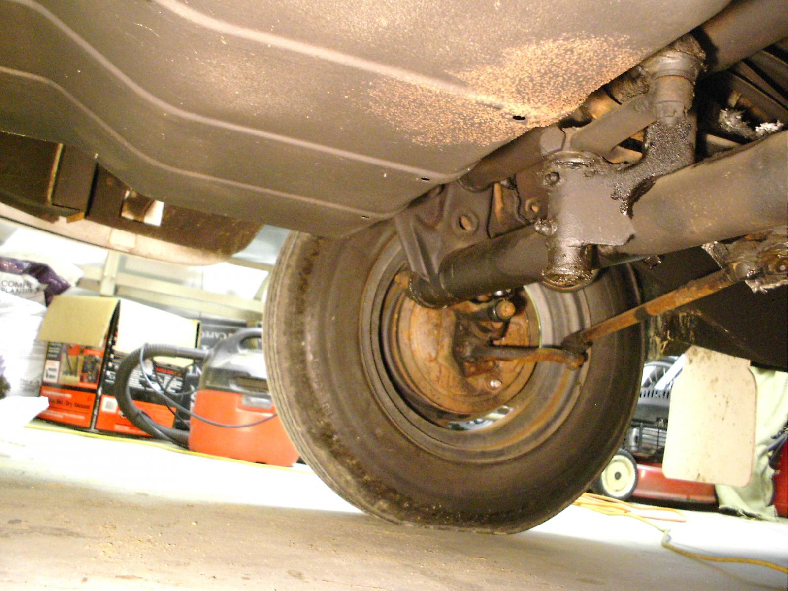

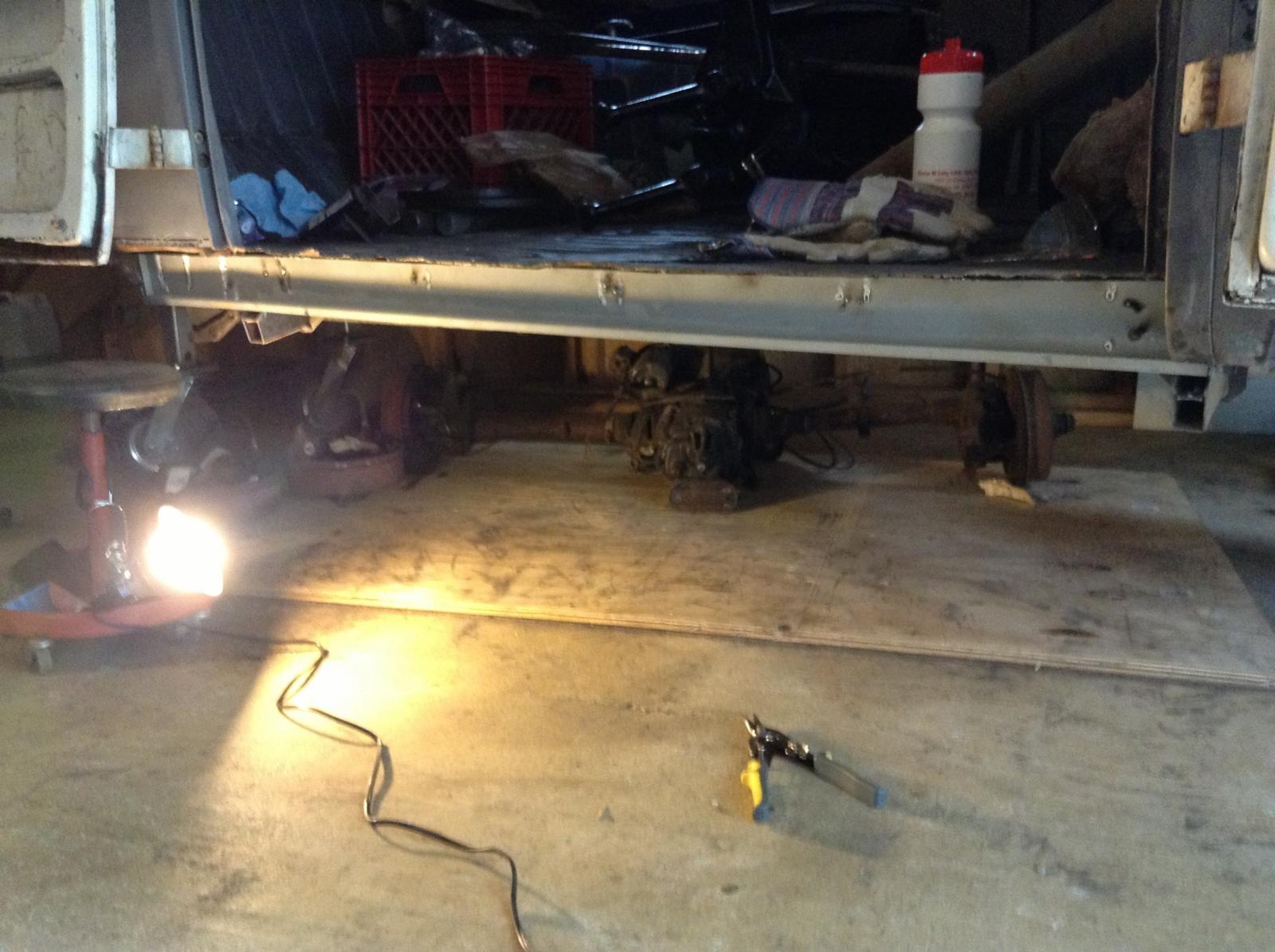

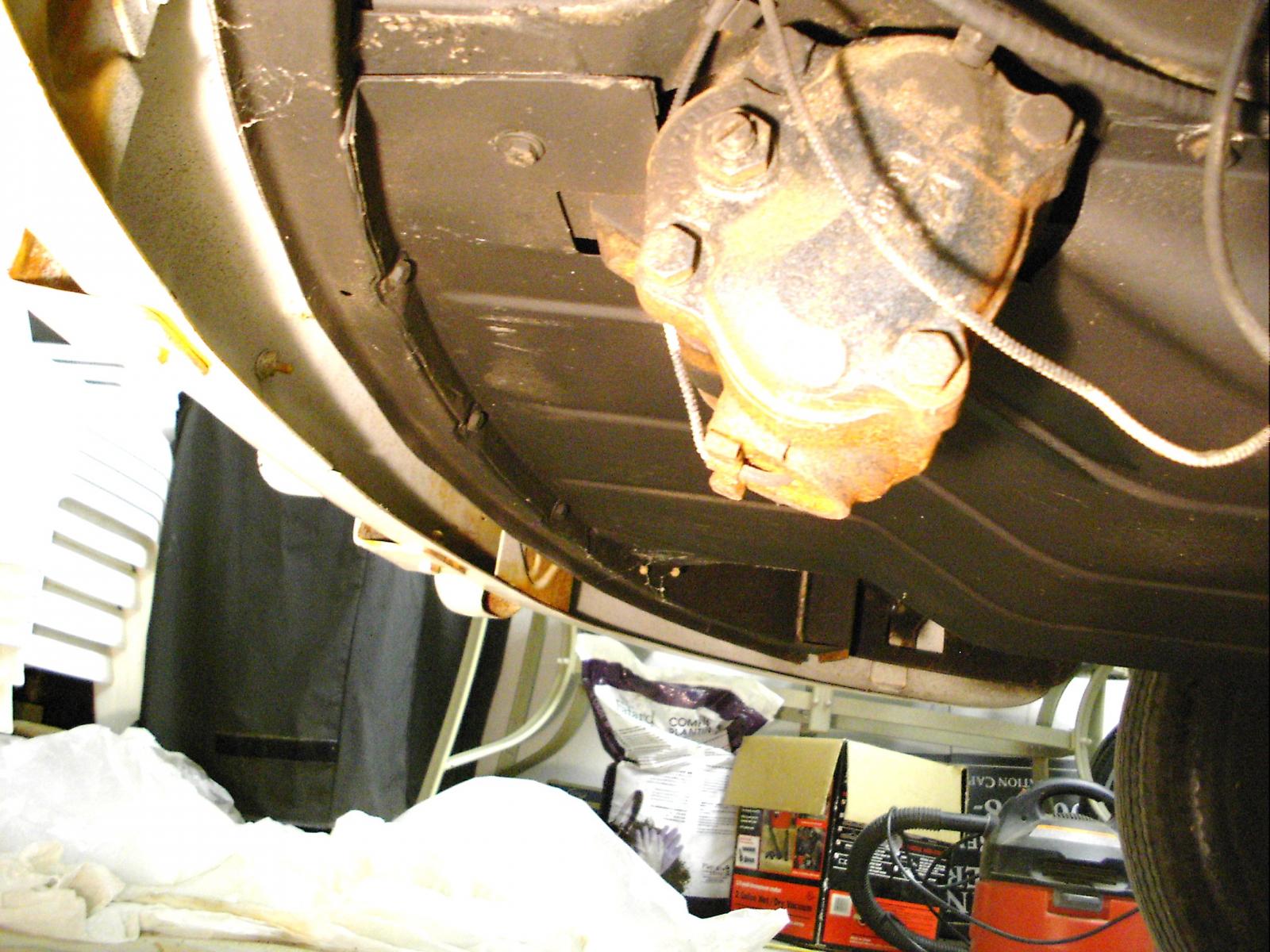

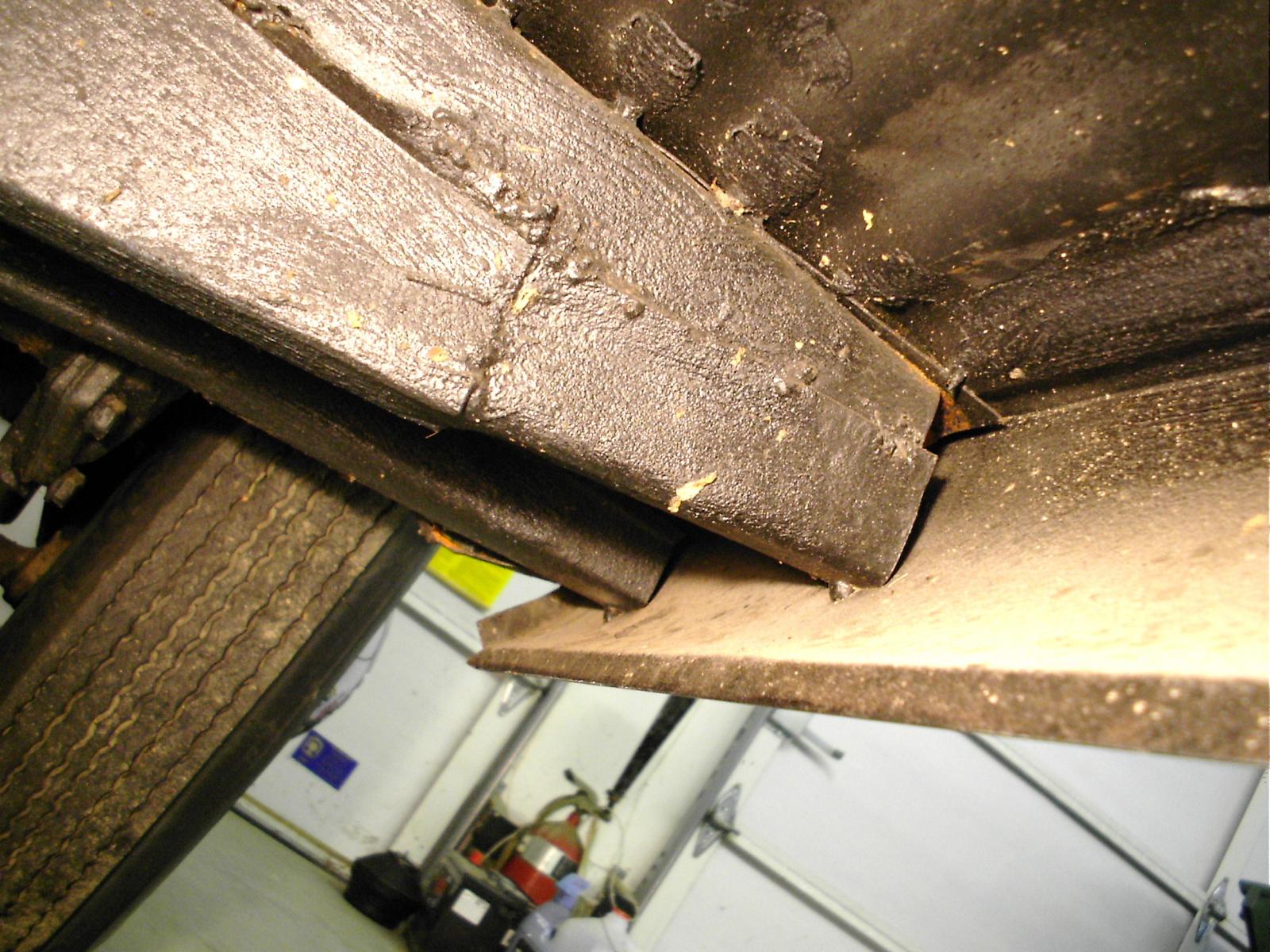

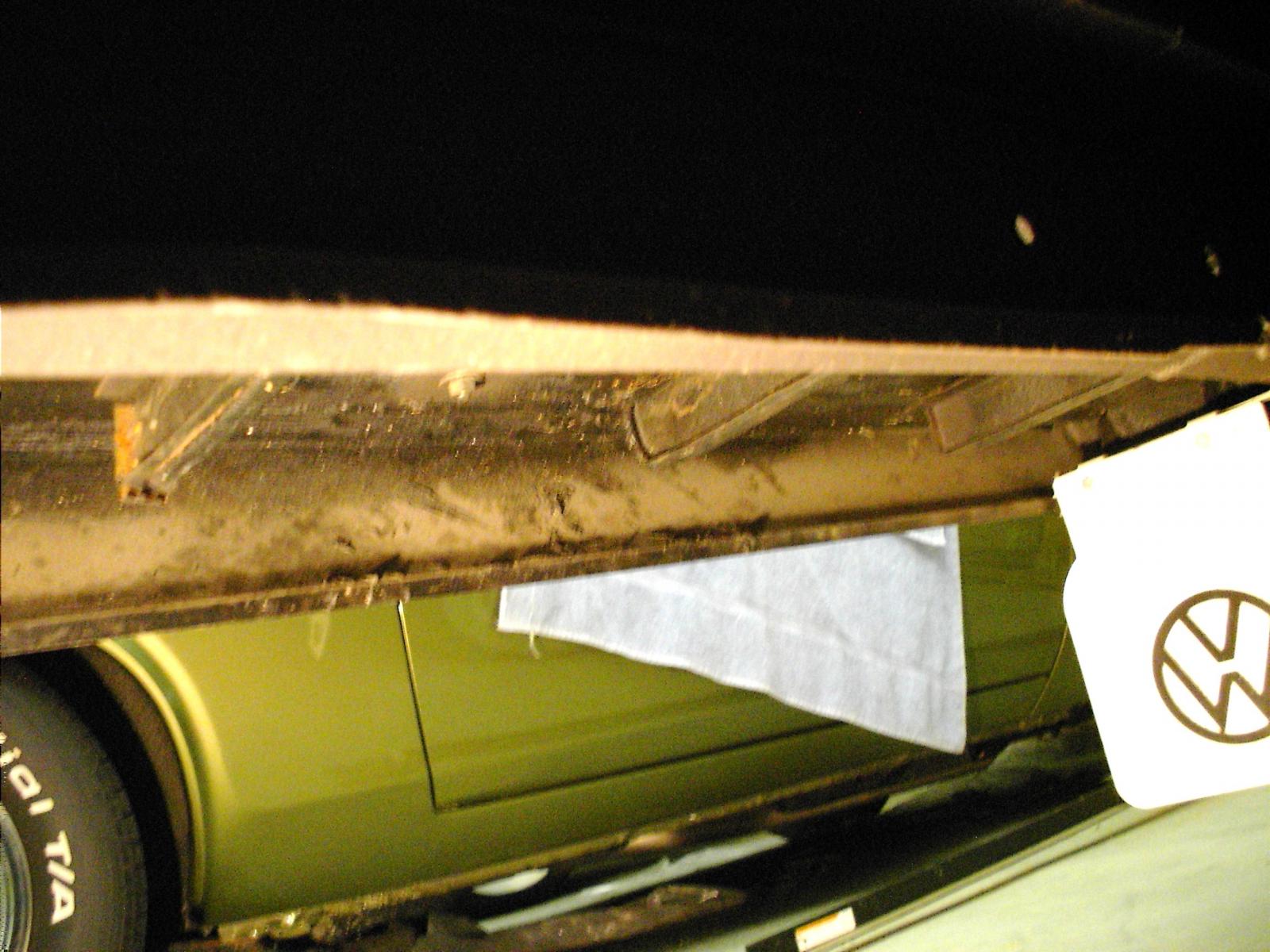

PostPosted: Sat Mar 01, 2014 7:18 pm    Post subject: Underneath photos-no side rails Reply with quote
Well I finally got under the bus to take some photos. I feel kind of stupid because I knew one front jacking point was loose and was going to check the rears at a later time. I've been working on the bus in the garage for a while now and it wasn't until 2 days ago I noticed the rear jacking points were not there.
Now I know why. Both outboard side rails are also gone. The cross members for the most part end an inch or 2 from the rockers which were replaced along with some sheet metal. I think the rest of the underside looks good but am not sure if it's safe to be driving the bus like this. I'm looking for advice and also wondering how much it might cost and whether it can be repaired without wrecking the rocker panels. Whoever did the work certainly did not do it well.
I've been in contact with the original owner and she knows little about what was done other than the paint job. It was her husband's bus and was bought in Arizona and I was led to believe it had little to no rust so am a bit surprised with what I found. I'm wondering how much the value of the bus is affected.
I'll appreciate any input.
Rich

PostPosted: Sat Mar 01, 2014 7:47 pm    Post subject: Reply with quote
that will be alot of work to correct. The outriggers need to end into the inner rocker so the Inner would need to be welded to the floor and the outer rocker which would require some refinishing even if you had a spot welder for the lip.
If you are worried about the hit on value, anyone who knows what they are looking at will certainly spot the quality and will be far more concerned with what they can not see.
Someone who just wants a bus may not care.

PostPosted: Sat Mar 01, 2014 8:38 pm    Post subject: Reply with quote
Wow, that's a first. Installing nice outer rockers without the inners.
That's going to take some work to sort out!
The rockers normally form a pair of boxes in parallel to the long frame rails, tied together with the floor, outriggers, side walls and roof to create a stable mechanical structure.
Without any one of these elements, you seriously compromise the integrity of the vehicle.
This is why all sunroof and double door buses had belly pans, to compensate for the structural loss.
In other words, I wouldn't drive that bus much at all until the rockers are restored.

PostPosted: Sat Mar 01, 2014 9:04 pm    Post subject: Reply with quote
Your missing the inner rockers. Normally, they would be welded in first then the outers. You could remove the jack points which looks like they have been modified, slide in the inner rocker, weld it to the existing cross braces from the back side (not correct, but to prevent removal of the outer rockers), and then weld in the new jack points, and spot weld to the bottom of the outer rockers. Little touch up for the weld burns, and good to go.
I don't see why you can't drive it as is for a period of time. The frame is still there, and the floor is supporting your pillars, etc... many busses inner/outer rockers are rusted away and still are being driven. The outer rockers will be soft and potential for easy dents, etc... so do the repair.

PostPosted: Sat Mar 01, 2014 9:06 pm    Post subject: Reply with quote
I was in the middle of a long response saying what j. said above.
I see what appears to be seams in the cargo floor, both top and bottom. I'm guessing it was a really clean bus, with rusty rockers and floors, 'fixed' by someone...less than reputable. Hard to imagine the work it took to do it that way being any easier or faster than doing it right.
Still a really nice bus, but I'd get it fixed right before I drove it much at all.

Like the other guys have said a bit of work to get it correct, but that bus is worth it. One other thing I noticed was that the rear brake line on the reduction box is missing its rubber protector in the bracket it runs thru. I think the one on the other side(passenger) is missing all together.
I'm with EDragendean on this one. I have seen so many busted out, rusted out inner and outer rockers on driven buses. Cargo floors are under rated how well they hold structure together. Pretty paint and white wall tires tells me he's not going to take this beauty on the beaten path anytime soon.

Very cool bus! I have a 1959 as well! Also, a split window bus on cape cod is a must! I'm from western ma, and my girlfriend is from you neck of the woods, Brewster! We visit the cape 2-3 times a year! We'll have to meet up and check out the your bus sometime!
I would recommend what every one else is talking about! The inner rockers must be addressed before you start trekking around in this awesome bus. I've replace mine, see photo:
It is structurally needed, please do not skip doing this body work. Here's another photo while I was fitting the pillars:

I disagree with this, just because people do it doesn't make it right. These buses are engineered to have all their pieces solidly joined together. How do you know the floor is good at the pillars or hasn't also been improperly replaced? The inner rocker is an integral piece that joins all the I beams to the outer structure, pillars, I would expect not having them, particularly on both sides, would allow alot more flex on the structure/body. No the bus might not fall apart but it would make good sense to replace them, despite it being a bit of a job.
Its too bad it was done this way as it would have been less work to repair everything correctly.

For Sunday driving and general around town with little to no payload that bus is fine. If you have the money and interest in fixing it then do so. It sucks but it isn't any real hazard for recreational use.

I completely agree. I've rocked buses WAY more trashed than what most would even drive, and that right there? That ain't gonna' effect anything except your psyche. VERY nice bus... with a little unfinished business. Cool

Agreed, the repair needs to be done. The pillars to Z s point need to be explored. But.... it can be driven, or be afraid to drive it, and 20 years from now it may be another barn find.

My friends DD panel is like that, no inners, only outers. As you can imagine the cargo doors are a pain in the ass to operate and are not as secure as they should be. It's also missing the outer belly pans. It goes down the road just fine though...
