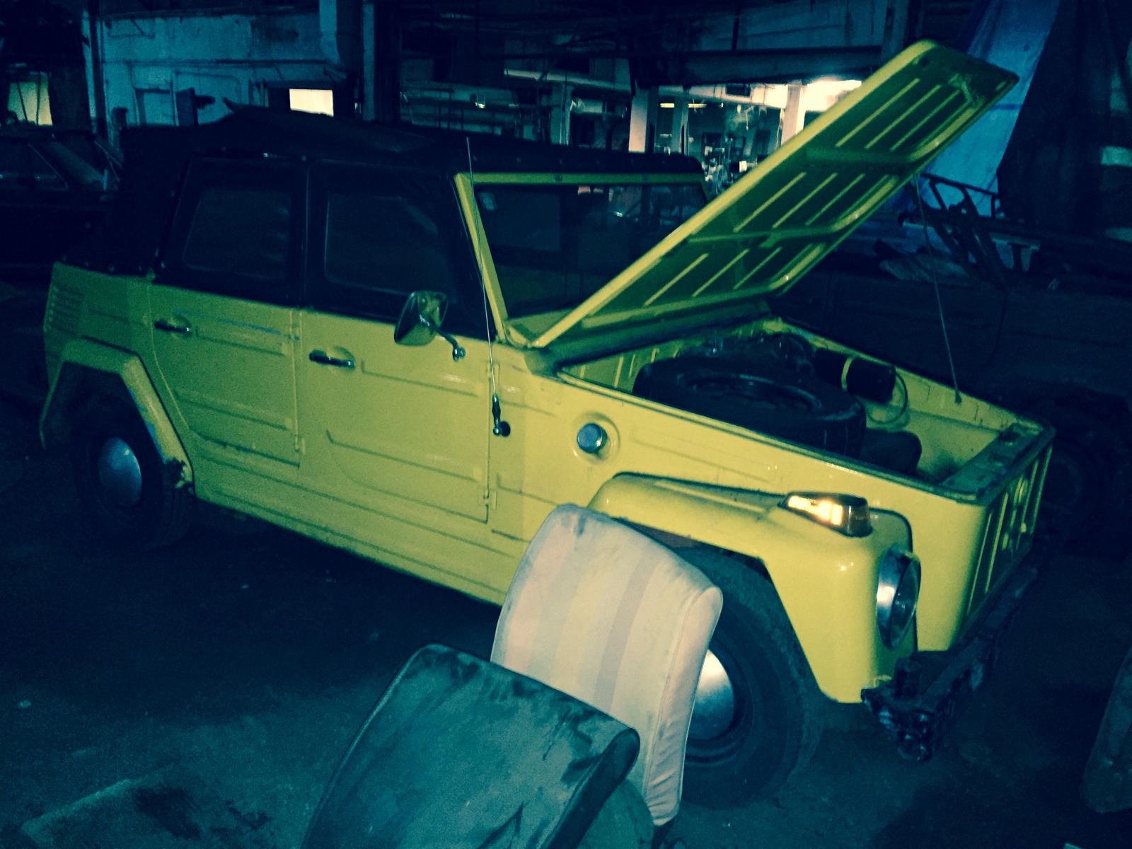

Scored a 73 Thing project. Plan is to wrench on it with the middle daughter. Needs work, my plan is to replace the floors, and redo all the mechanicals, basically "daily driver" status (I may need intervention as I tend to go all in... call me out if I start to falter...).
Floor was toast at some point, and some PO welded in flat sheet metal, which also then rusted... PO should be a swear word! Motor needs a rebuild, brakes, etc... Last on the road in 2005.

PostPosted: Sat Jun 11, 2016 7:07 pm    Post subject: Re: 73 Thing for the middle Daughter Reply with quote
Looks like a Great start! She appears Very solid...
And do I see adhesive ALL over that interior(doors, rockers, etc??)..... Rolling Eyes

PostPosted: Sat Jun 11, 2016 7:24 pm    Post subject: Re: 73 Thing for the middle Daughter Reply with quote
PO glued on carpet?!?! And hacked holes in the middle of the inside rockers, arrrg!

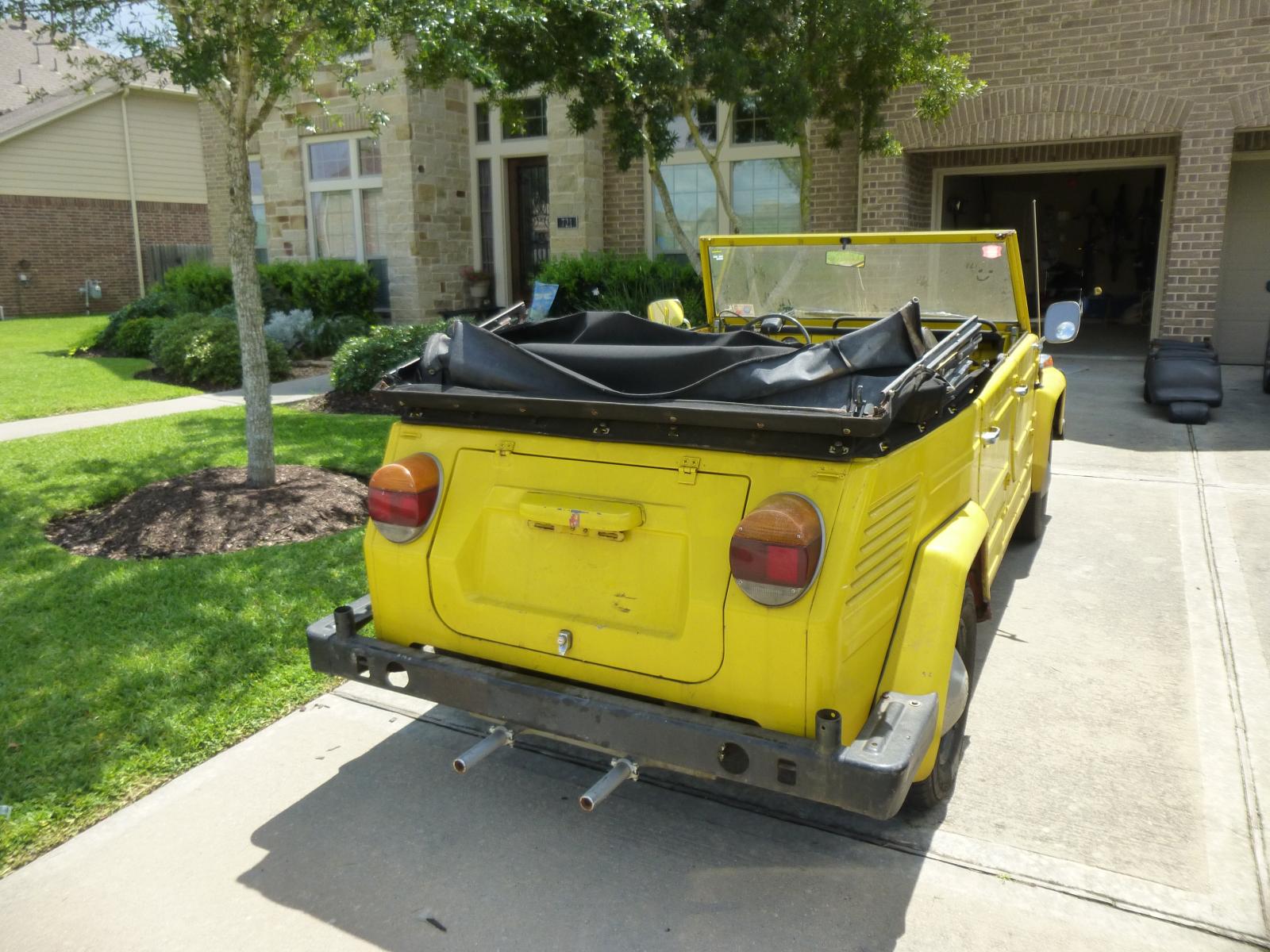

PostPosted: Wed Jun 15, 2016 12:56 pm    Post subject: Re: 73 Thing for the middle Daughter Reply with quote
what's with the four things on the bumpers?
like they had a over the roof rack or were feet for a tent maybe?
Neat idea, tent feet for a popup over your THING! LOL

PostPosted: Wed Jun 15, 2016 6:21 pm    Post subject: Re: 73 Thing for the middle Daughter Reply with quote
T
Hippie "roll bar" ??? What they are is a collection point for water, therefore rust issues inside the tube. I will be removing them.

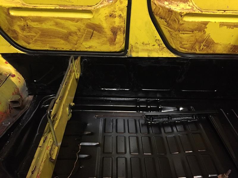

PostPosted: Mon Jul 04, 2016 7:01 pm    Post subject: Re: 73 Thing for the middle Daughter Reply with quote
How I spent my Sunday. Finally got the last of the triple layered, welded, angle iron floors cut out, lots of careful surgery removing the welds without damaging the tunnel/rockers. Frame is in great shape, inner driver rocker needs some rust repair (beyond the hacked out hole to clear the custom seats).

PostPosted: Mon Jul 04, 2016 7:03 pm    Post subject: Re: 73 Thing for the middle Daughter Reply with quote
Worked the passenger doors, hinges were rusted, now they open and remove as they should. Replaced the seals on the top and bottom of the windshield, and windshield to dash seal. Replaced the missing pad below the glove box. Replaced the connection bar and lubed the pivots on the wiper arms. Making progress slowly...

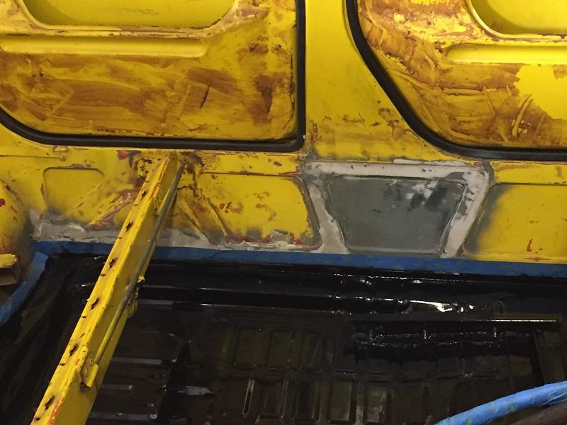

PostPosted: Sun Nov 20, 2016 8:18 am    Post subject: Re: 73 Thing for the middle Daughter Reply with quote
Making progress.
Separated the pan from the body, trimmed and welded all the necessary attachments (seat tracks, battery mount, seat belt mount, pedal stop, jack points, jack support braces).
Three rims/tires stacked on top of each other make for a good body holder over the pan... wish I had taken pictures of my getto stand... Laughing
Driver side rocker needed rust repair lower three inches inner/outer, and repaired holes on both sides.
Put POR 15 on outer edges of the new floor pans, installed new floor pan seal, then bolted pan halves to body. Dropped body back on the chassis and bolted everything up before welding pan halves to tunnel so I wouldn't have any issues with alignment.
POR 15 with Chassis Black Top Coat.

PostPosted: Sun Nov 20, 2016 8:25 am    Post subject: Re: 73 Thing for the middle Daughter Reply with quote
if you have not already, pull that tape line. Por-15 dried will give you fits removing the tape in crisp line.

PostPosted: Sun Nov 20, 2016 8:31 am    Post subject: Re: 73 Thing for the middle Daughter Reply with quote
Thanks. BTDT, I removed the tape while still wet.
