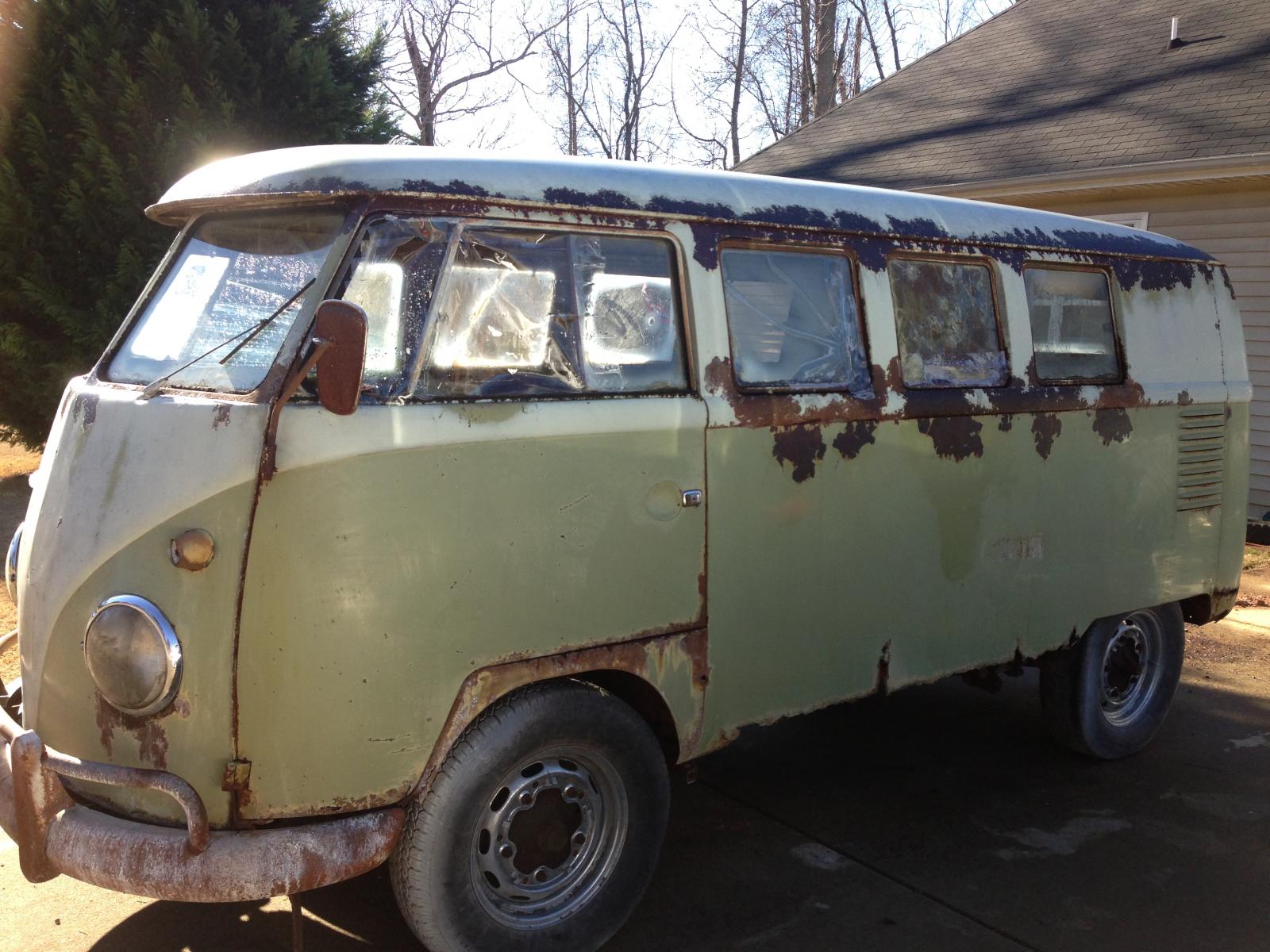

Over the past weekend I told Grayson I was looking for a Mango and had several parts to replace with so it did not have to be a perfect bus.
While on a Conference call Tuesday Grayson texted me saying hey think I found your Mango. Since I was on the never ending call, Grayson started working the deal and started getting pics and shooting them over. Grayson said can you get it today? Seeing as I was in my company car and scheduled for meetings the next two days that was a no go so I reached out to my buddy Josh (poor Josh) and asked him what he had going on. Once Josh said he could drive up (4 hours) and grab it Grayson put me in touch with the owner and the deal was done. I was going to be stuck in Winston Salem and the seller wanted it picked up by Friday so I was only going to be able to pay for it and not help extract.

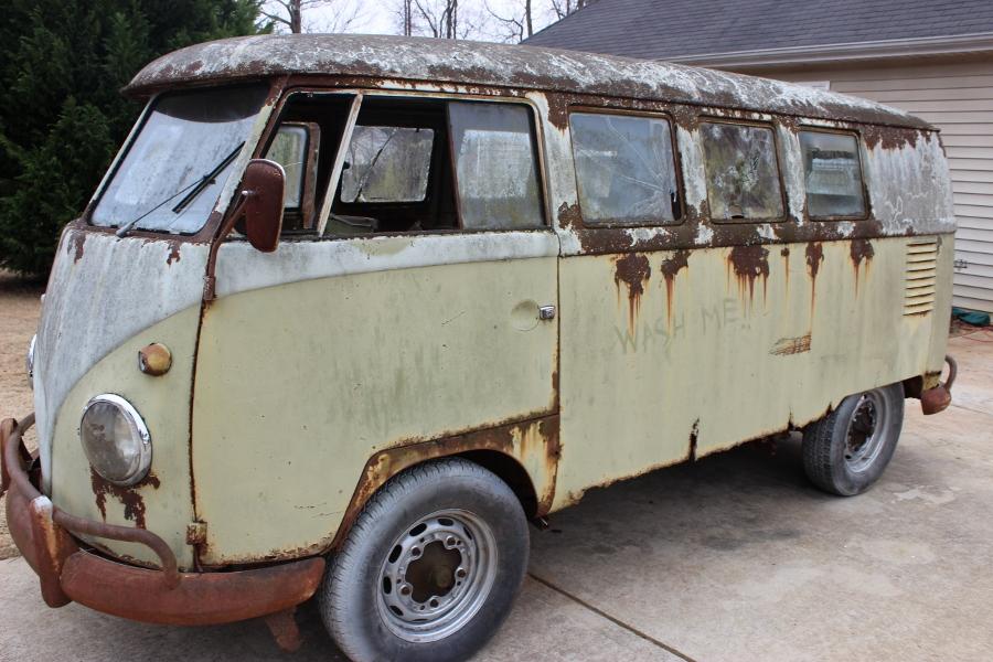

Josh went by my house and grabbed the extraction kit and some wheels and hit the road to scoop it up. Once he got there he called me and said, yep it is a project but not as bad as we have seen. I asked if it had the front seat in it and he said, no only the drivers top frame. So even though we thought it had the "front seat" it turned out to be a Walk Through so even better. Josh actually said the wheels broke loose and it rolled on it's own which is a first for me.
So I had to wait until the morning after I got home to even lay eyes on the bus since Josh took it to his house. While on the trailer I was happy to see it but did see some things the seller failed to mention such as a pretty crushed passenger corner, but all in all it was in the condition I expected.

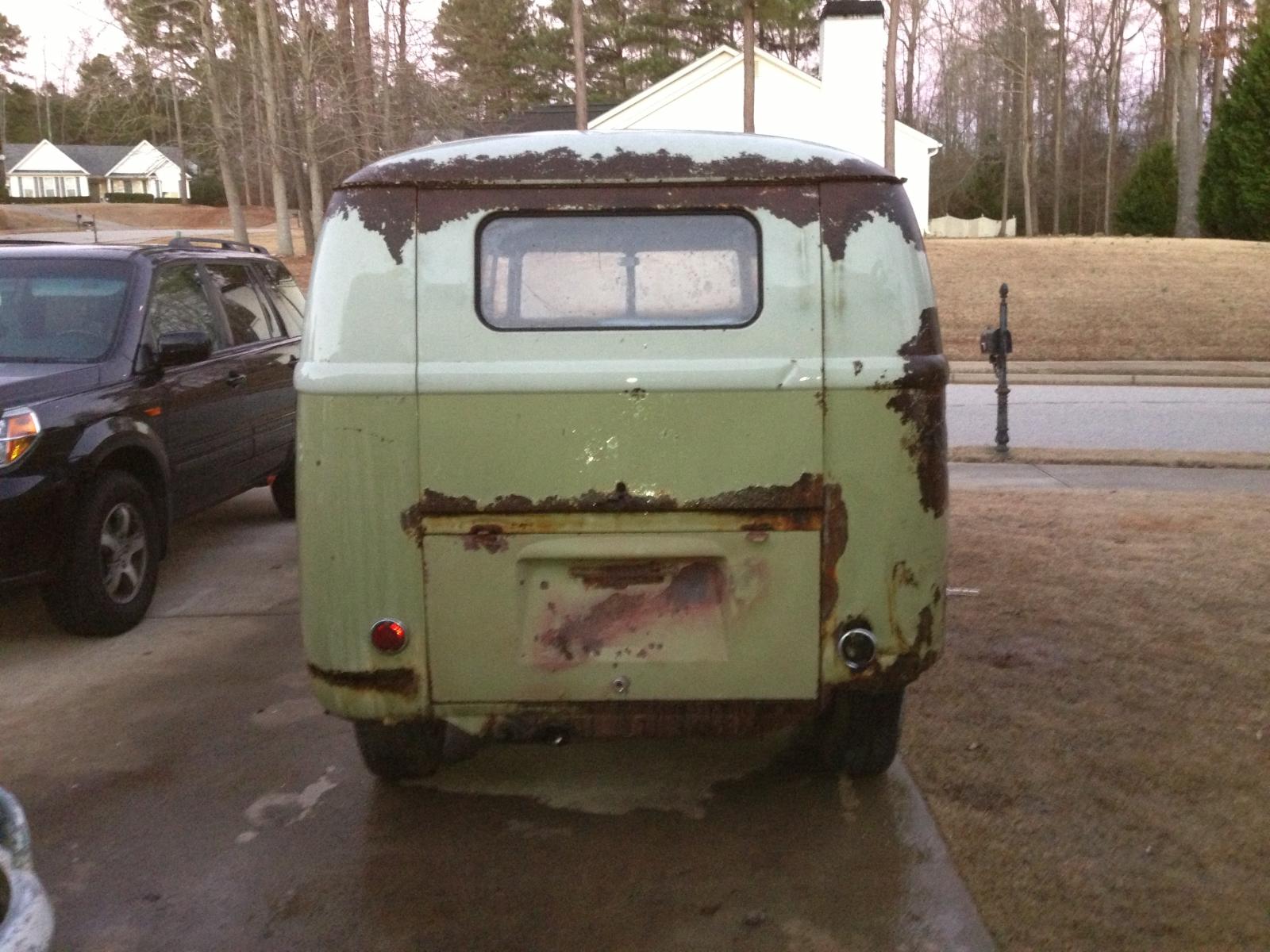

It was built on January 5 1960 and was pulled out of the woods nearly 54 years to the date. It was delivered to Washington DC. It is MCoded for a full length middle seat and Ambulance step. The seller mentioned it had been in the same family since new.

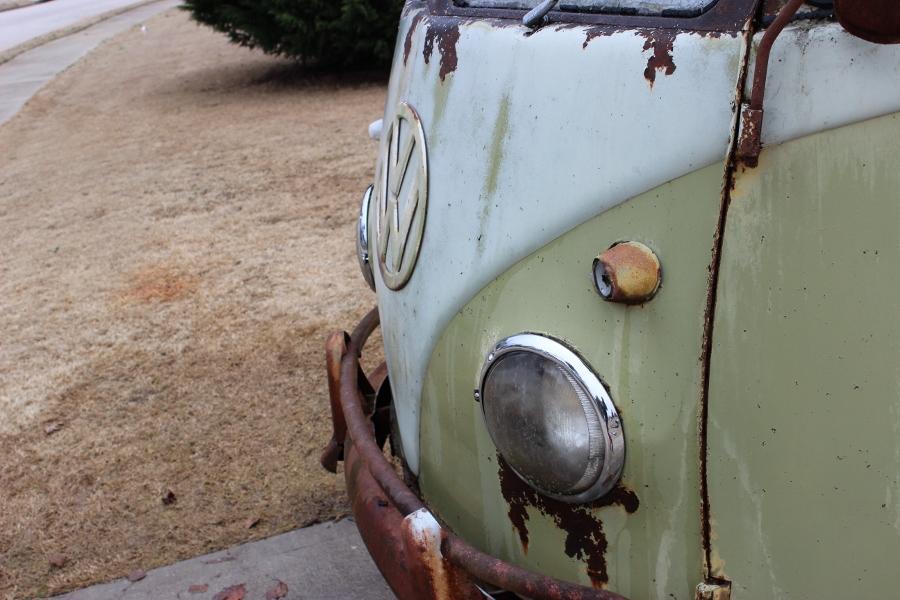

It has one of the nicest noses I have seen on it, it had one football size dent that pushed right out once the kick panel was removed.
The speedo is in incredible shape although the dash has lost a good bit of paint.
The roof is very solid with maybe 2 dings up there.

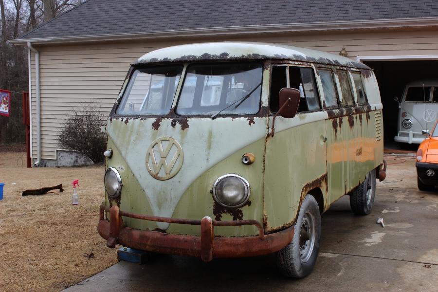

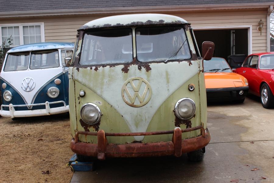

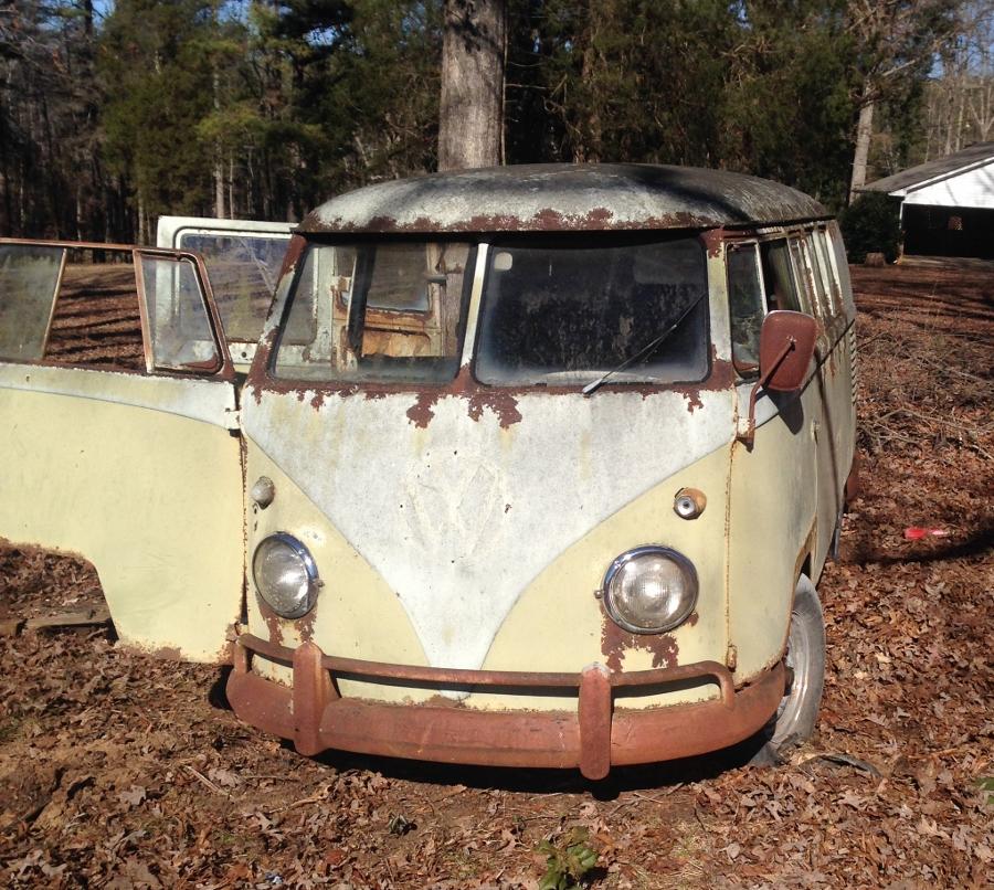

This is the first picture of it its resting place since Hurricane Hugo with the patented Beetle rescue wheels mounted for trailer loading.

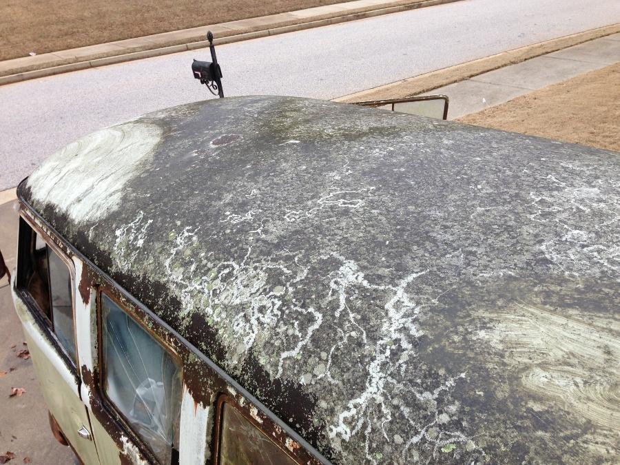

The Bus was wearing about a 1/4 inch of moss and grime and looked nearly yellow. Here it is finally in the driveway.
And after a quick trip to the basement a nearly patina matched emblem.
Nose with the dent showing.
And pushed out by hand.

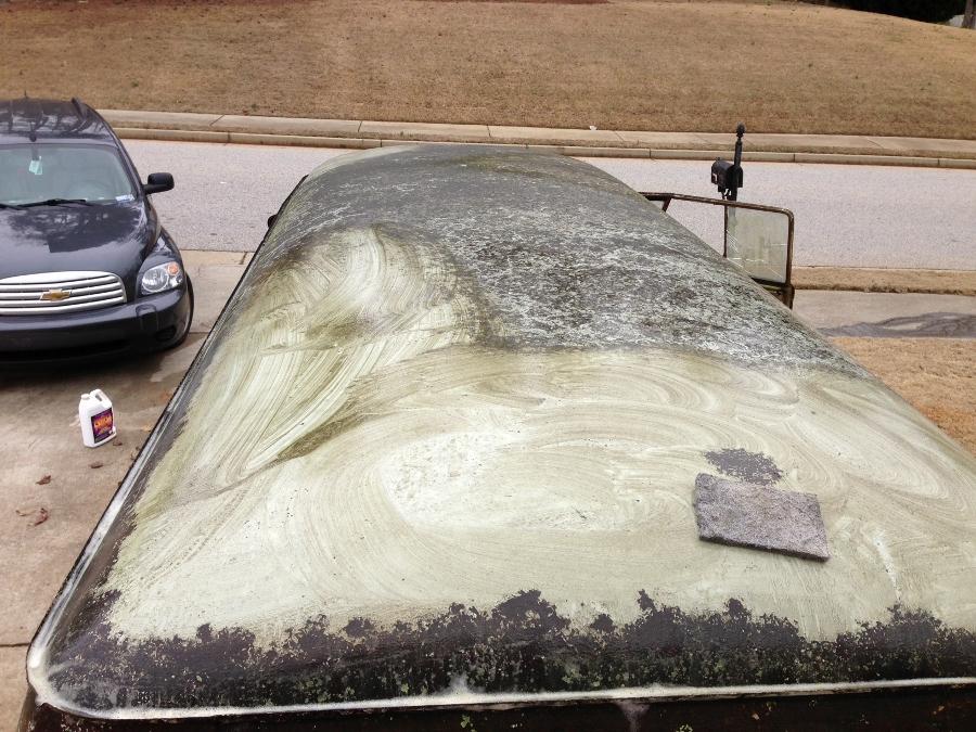

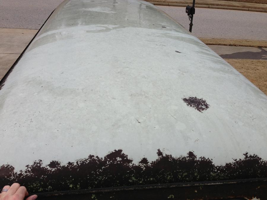

Cleaning begun on the roof.
And one full pass, will get a couple more but for now.

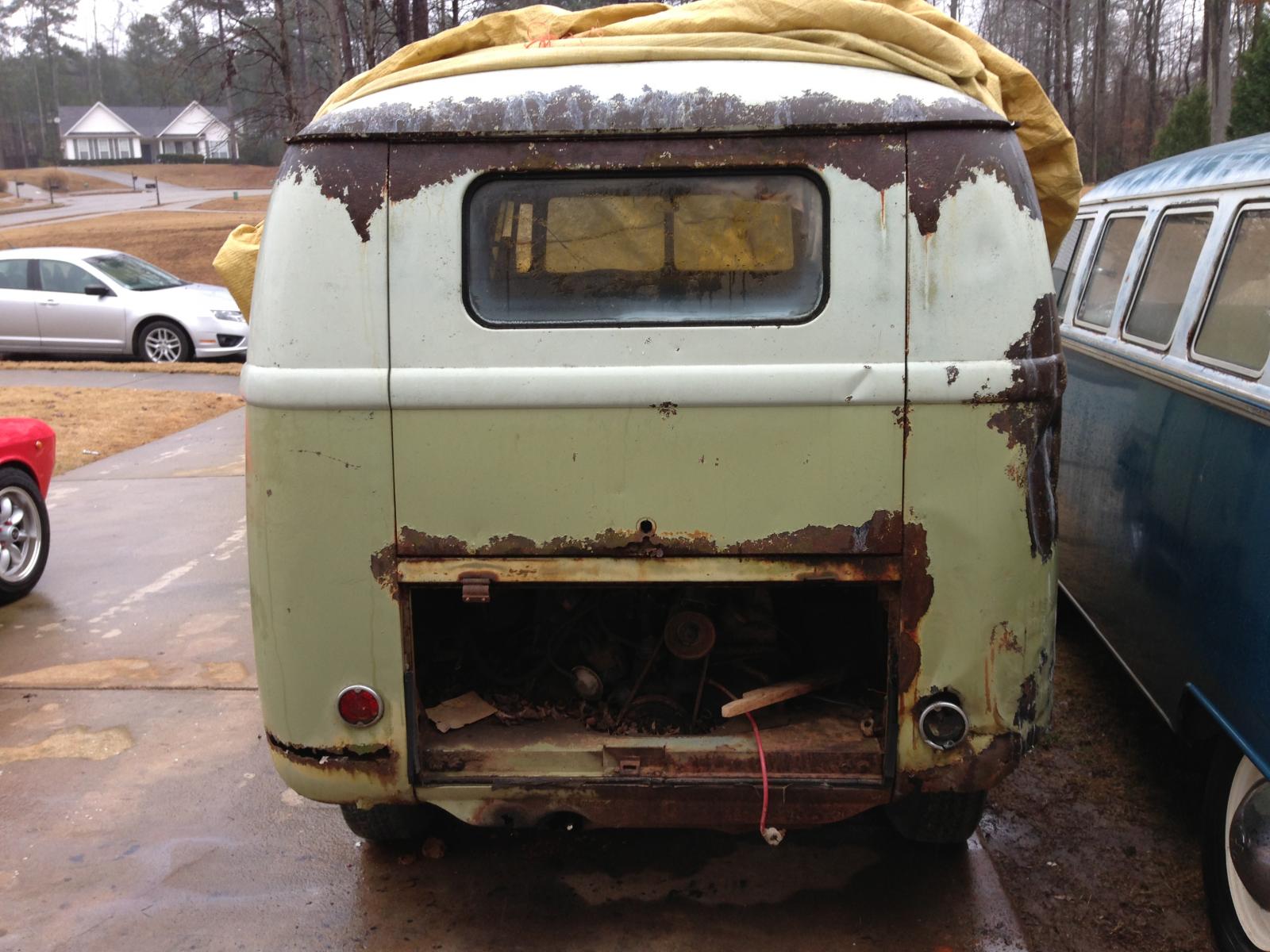

OG engine lid removed itself just before loading.
It will be a wall hanger and this one will take it's place on the bus.

Did 2 more CLR baths then a pass with 2K wetsanding. Have the metal order list going. Long rocker is bugging me more than anything so I want to fix it fast.
