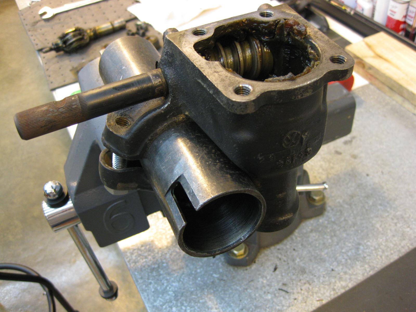

So, moving the disassembly/rebuild into this thread:
Earlier I had posted that I had several units to disassemble.
But, for clarity I'll back up and start over with an additional steering box unit that I've aquired.

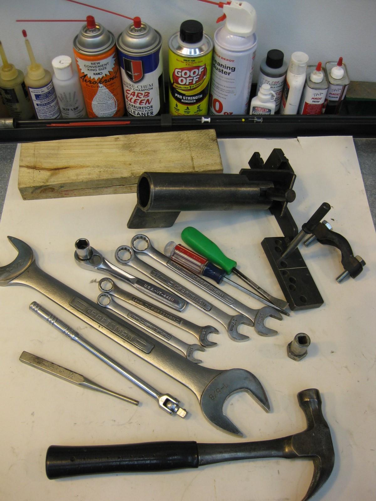

But first to document what tools are useful/needed to complete the project:

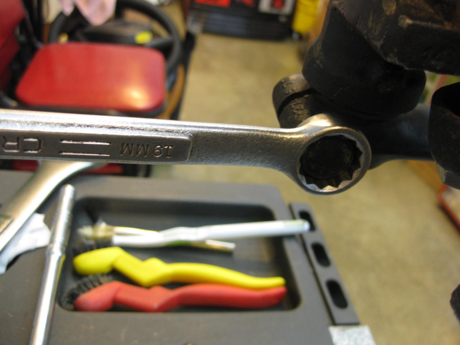

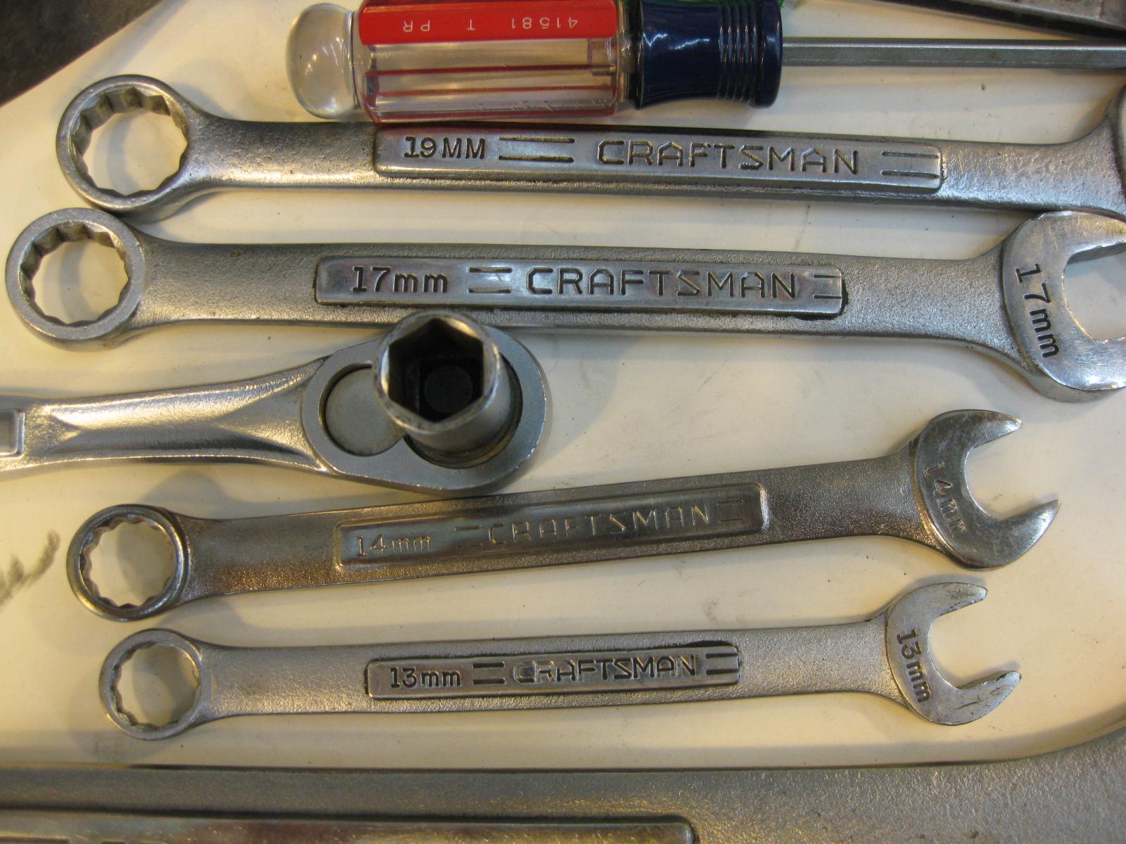

13mm, 14mm, 17mm, 19mm, wrenches, 14mm socket, screwdriver all pretty self explanatory:

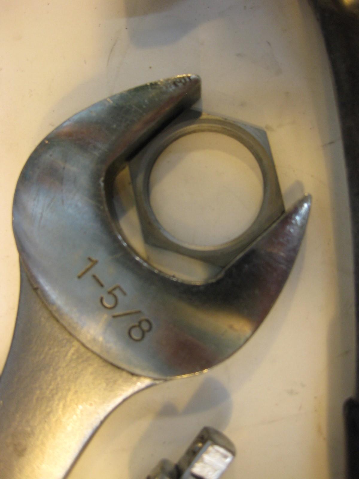

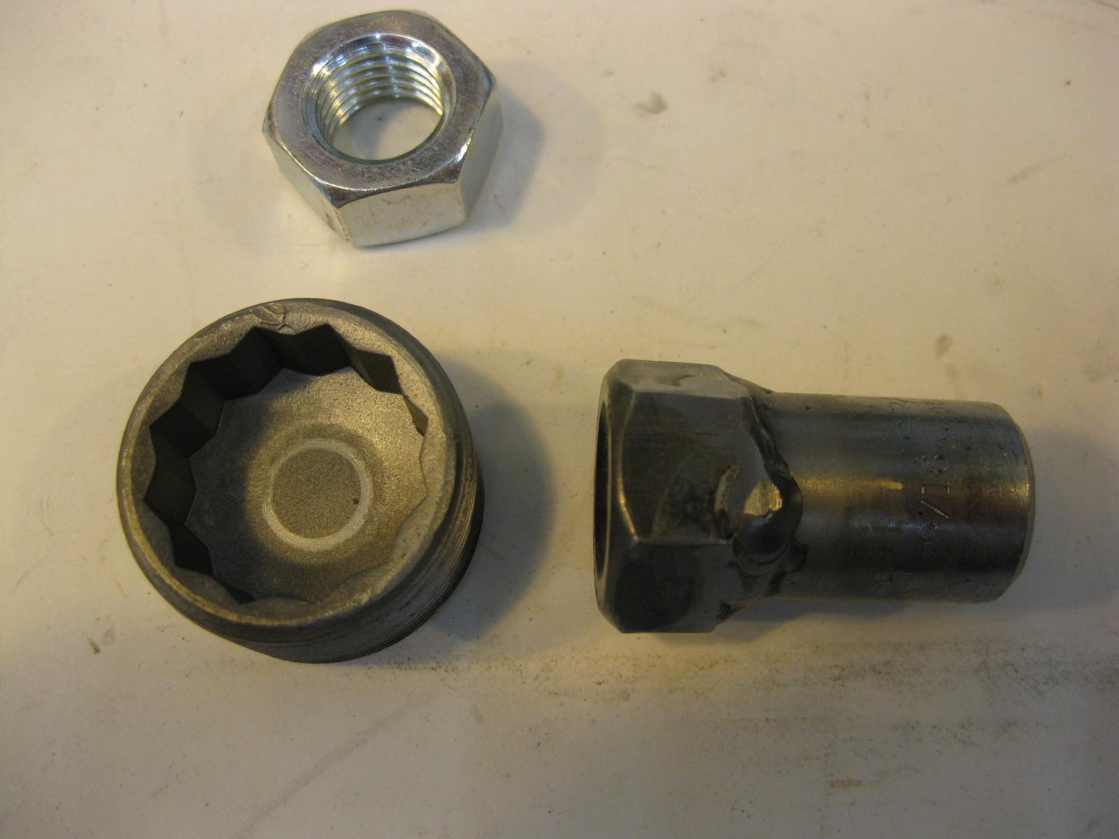

The big locknut for the worm adjusting screw is 41mm. A 1-5/8 wrench is 1.625 inches, which is 41.275mm. Just slightly large. I was able to pick up this wrench for $12 at a local flea market.
To turn the worm adjusting screw itself, I made the tool. A nut for a 16mm bolt (which is 14mm across each flat side), tigged to a throw-away 9/16 socket. A few cents for the nuts at "The Rule Company" here in Tulsa, and the socket from one of my garage friends junk-socket-bucket.
Fits just right:

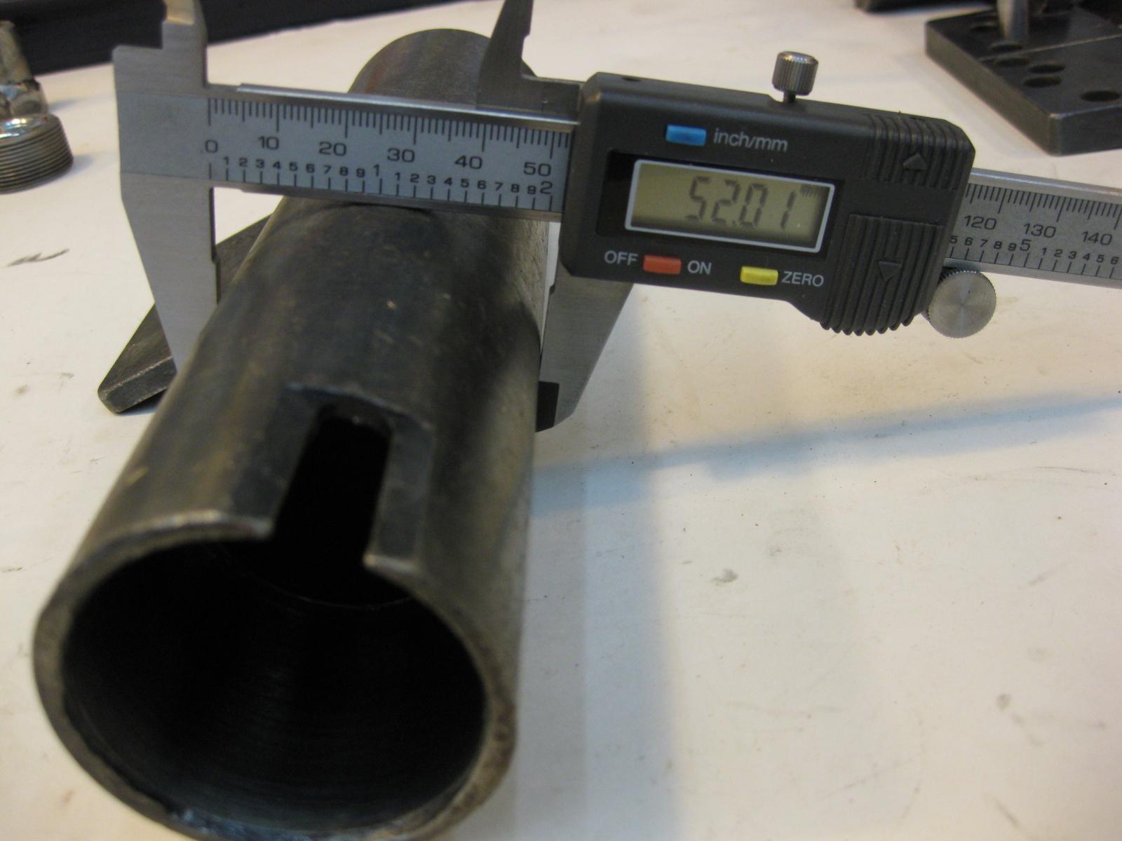

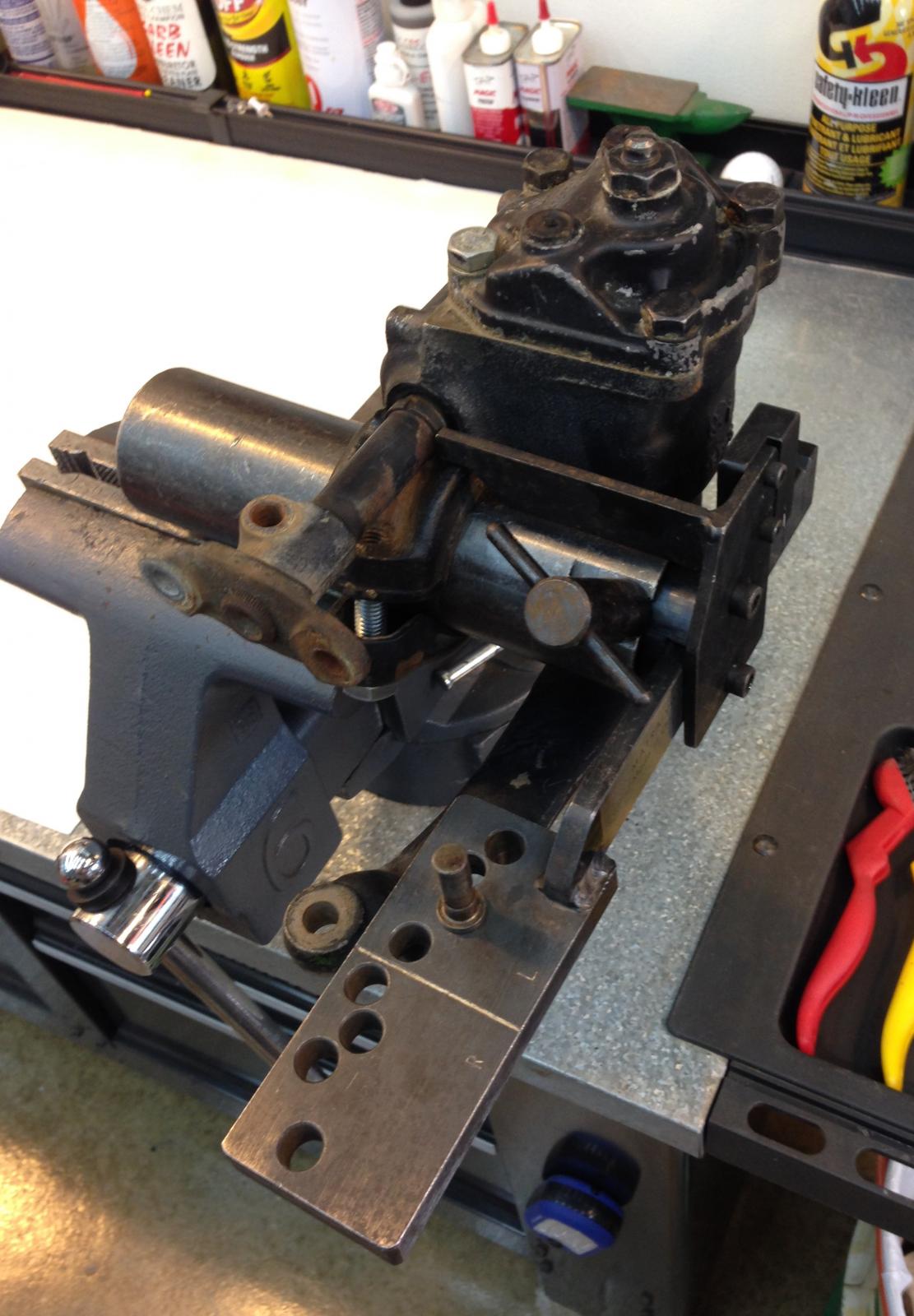

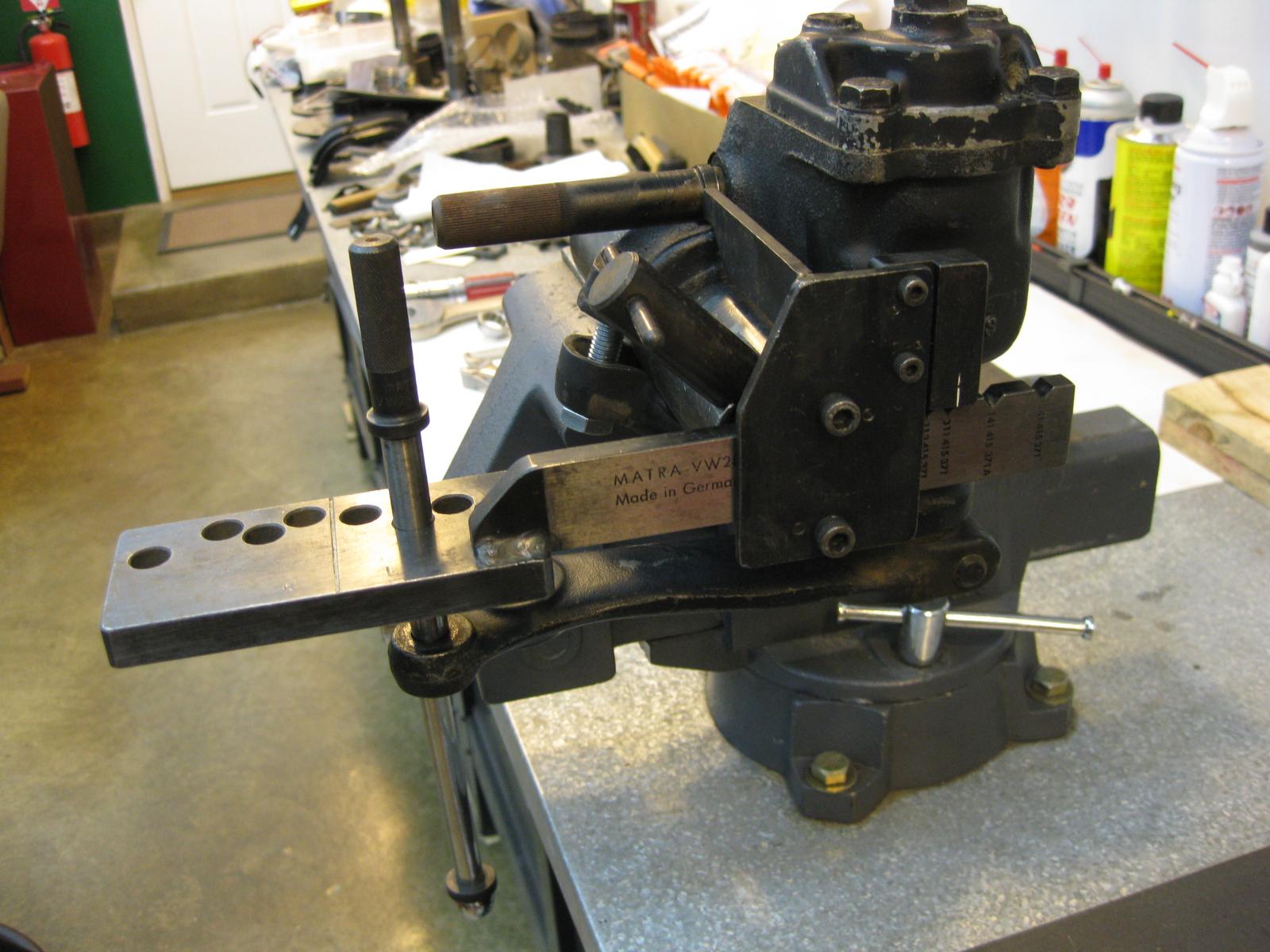

I was able to obtain a VW280 tool and it really helps to have the tube section to hold the unit.
(But... I've also accomplished the task by clamping the steering box into the vise, using two blocks of wood to face between the vise and the sides of the steering box.
The tube is 52mm in diameter.
and has this tab welded on the back side for the steering box to set down against.

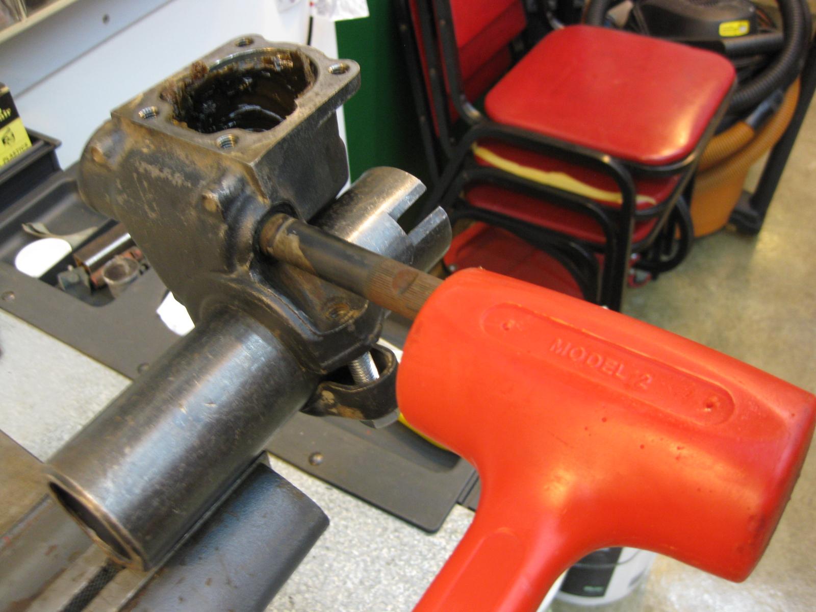

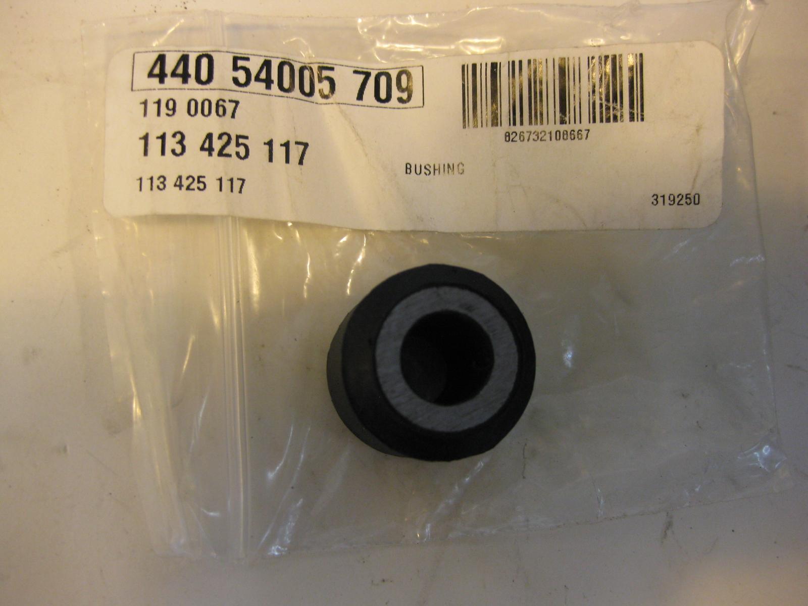

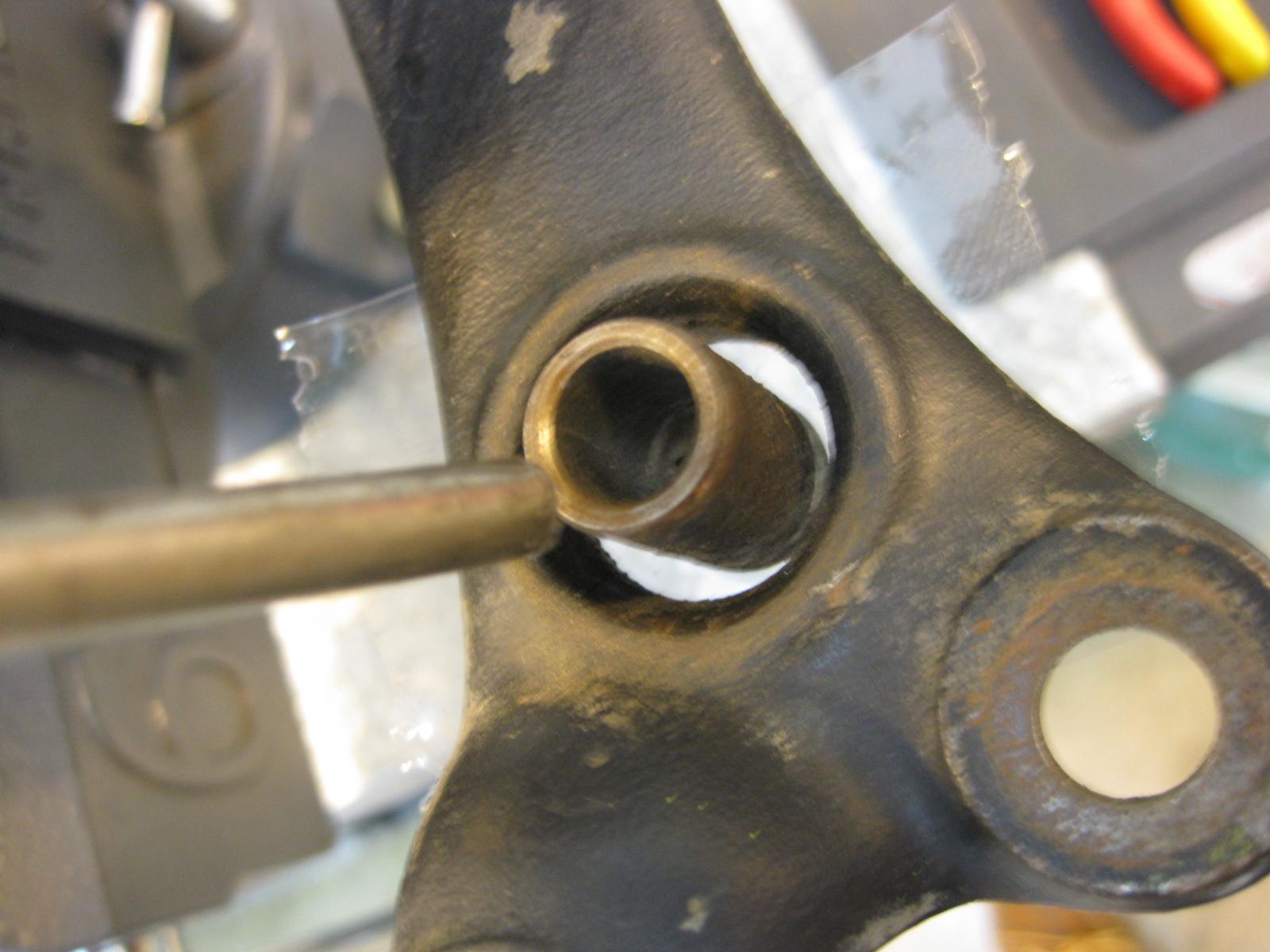

prior to taking this set of pictures, I removed the steering damper bushing from the drop arm by tapping the center metal sleeve out with a punch and hammer.
Then pushed out the old rotten rubber bushing.
The replacement bushing has a bonded steel sleeve so it's removal or installation will be different.

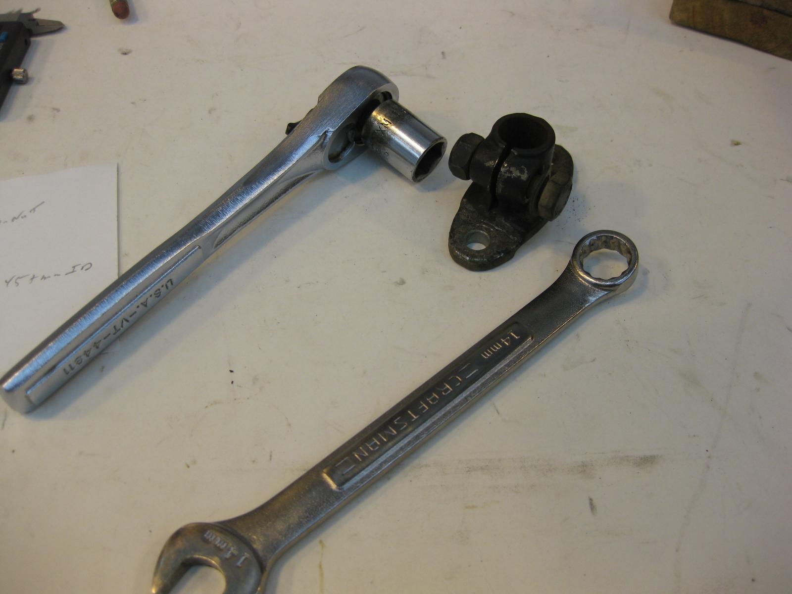

I also removed the Steering Worm Flange. Taking the bolt out is the easy part. Kroil, heat, more Kroil, sharp raps with a punch and hammer.... Then to the press! After all the preliminaries, this unit still required some pretty good pressure from the press to get the flange off of the steering worm shaft.
With the unit mounted on the tool, I wanted to check the play before disassembly, as the adjustment seems to be pretty well used up. (Note, there are no threads left exposed on the Roller Shaft Adjustment Screw.)
Setting the drop arm part of the tool up, the unit had a small amount of wiggle all through the range of motion. The good part was that the wiggle was consistent through the range of motion. But, still there was wiggle at center position.
(Note that I don't have the "280-?" pin for the early drop arms which have a smaller tie rod end hole. But the larger pin still provided enough guidance to know where "center" is located.)

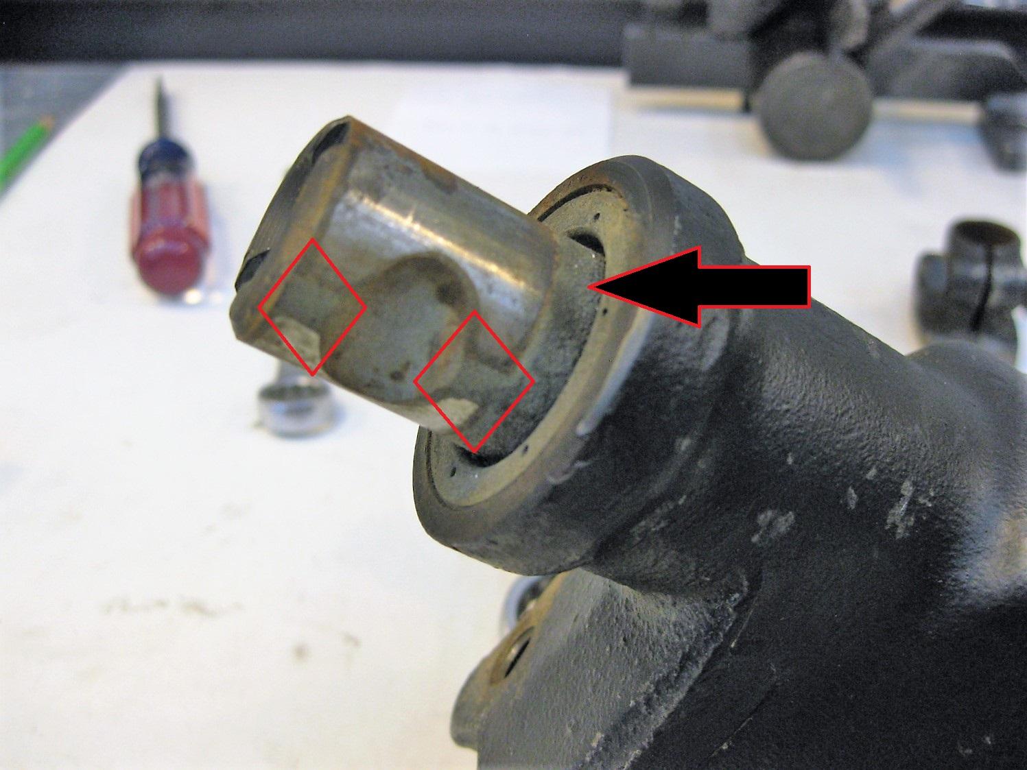

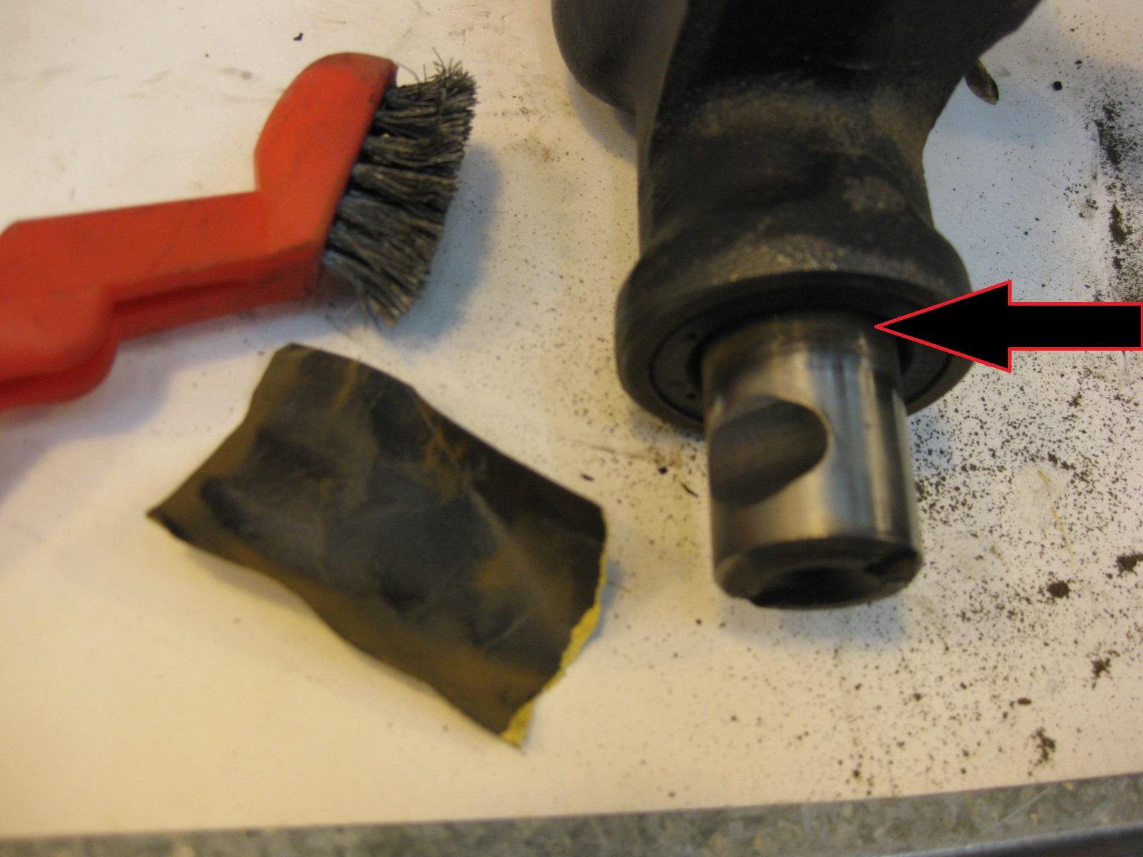

Then I removed the unit from the fixture so that I could clean up the bottom of the Roller Shaft. This shaft has to slide up through a bronze/brass bushing. Any dirt, paint, or imperfections can block the removal or damage the bushing.

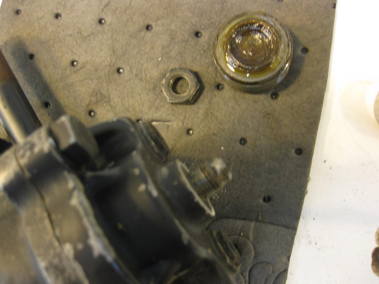

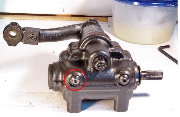

Pay particular attention to the places marked in the picture with the red diamonds. The pressure of the Drop Arm, through time, can create a metal ridge in these areas. If there is a ridge, carefully file it down to avoid damage to the bushing. It takes patience to get the paint off the shaft, up under the seal. I almost have it clean enough in this picture.

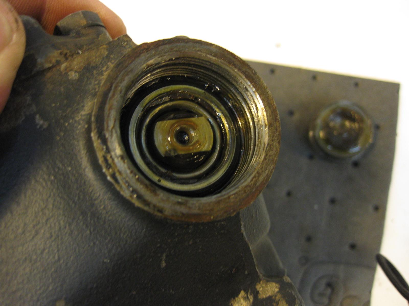

With the Steering Worm Adjusting Screw already loose, I removed it for a first look at what I was going to find inside.

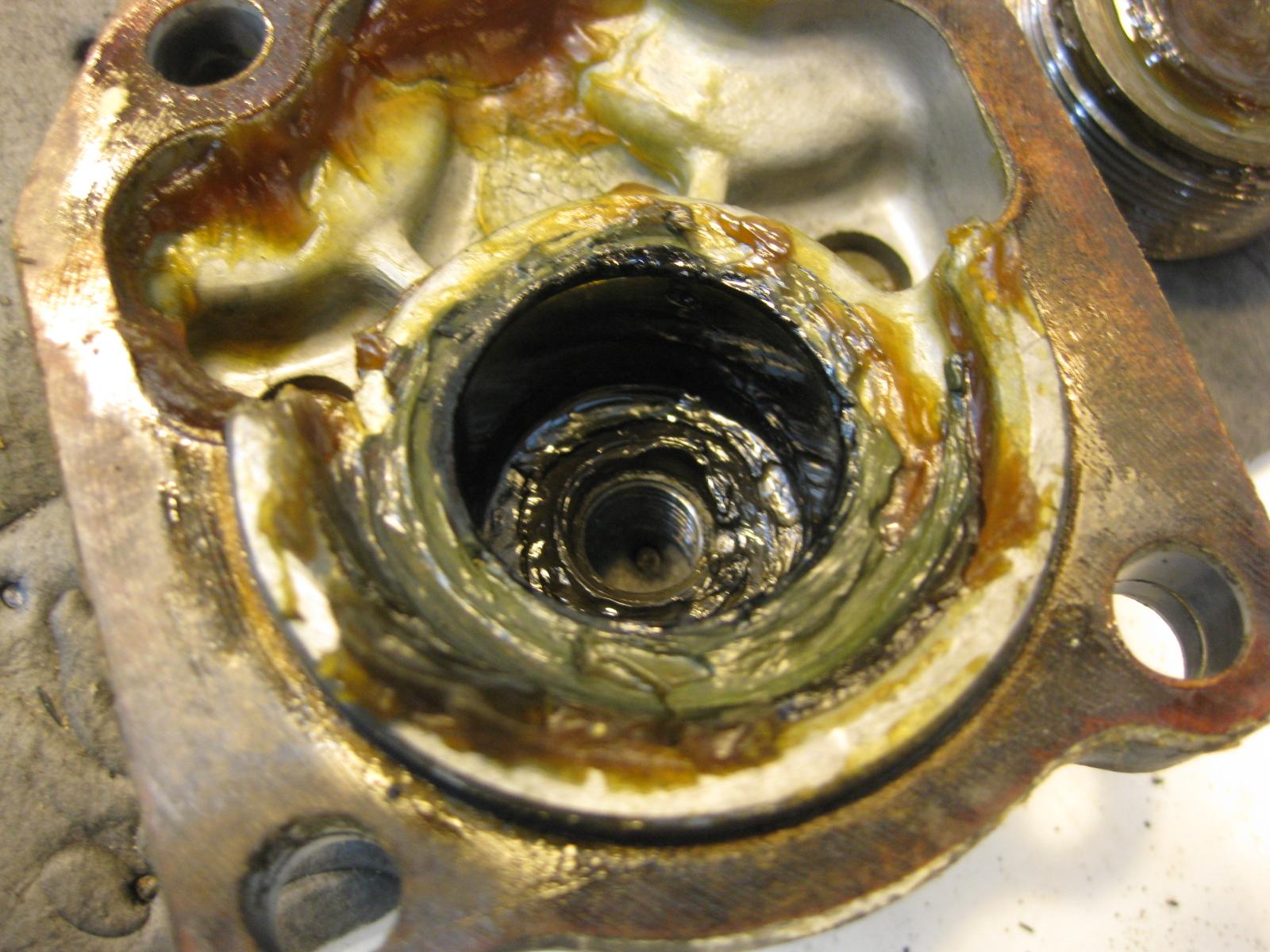

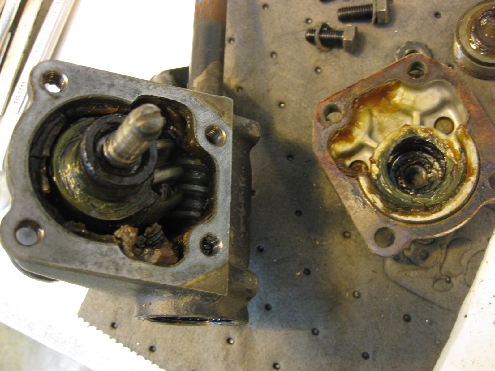

Removed the cover plate bolts. Then carefully, slowly, start screwing in (clockwise) the Roller Shaft Adjustment Screw. This will start to lift the cover plate from the housing. Be careful to make sure that you get the gasket completely separated from either the housing or the cover plate. This so that you don't tear the gasket.
The gasket stuck to the cover plate. With some careful work, I should be able to get the gasket loose from the cover plate and reuse it.
I don't like what I see here. Two different types of grease, and the bushing is black, black, black. We will see what it looks like when everything is cleaned up.
Centered the Roller Shaft,
Then remounted the unit on the fixture and tapped the Roller Shaft up and out of the housing. It was tight, but ok.
Just a little, little bit more work on getting the gunk off the Roller Shaft would have been better.
Now the Steering Worm Shaft can be removed. Gentle taps, will push the bottom bearing race out,
along with the Steering Worm Shaft and everything except the upper race and the shim.

Earlier, there was a question about using a set screw to replace the plastic plug in the cover plate. I haven't done this personally, but can provide the following information:
The holes for the plugs in the cover plate are "cast", and then "machined" on the inside. So the diameter of the hole on the outside of the cover (the cast side) has some variability. I have 3 VW covers and 1 TRW cover that I have removed the plugs from. I have measurements from 8.1mm diameter to 8.4mm diameter for the outside of the hole.
The diameter on the inside is consistent at 9mm. 9mm is the correct tap drill size for a thread size of M10X1.0. That would be in the "Fine Thread" category. Fastenal has "M10-1.0 x 10mm Hex Drive Flat Point Black Oxide Finish Alloy Steel Socket Set Screw":
https://www.fastenal.com/products/details/11506451
If I was going to use this approach, and I may have to, I think I would: Finish drilling out the hole with a 9mm drill (drill from the inside to outside), and tap for M10X1.0. I already have both the drill and the tap in these sizes.
SAE (Non-Metric) Approach:
The 9mm hole is already slightly over-sized for tapping a 3/8-24 thread. (correct hole size would be .332 and 9mm converts to .354) You could go up to a 7/16-20 set screw which uses a 25/64 drill. This would mean drilling the hole all the way through the cover thickness. I have the drill bit and using this would not be removing all that much additional material. But, I don't have the 7/16-20 tap in my set so I'd have to acquire that. Fastenal has the 7/16-20 set screws available in both steel and stainless steel.
A final thought: I looked at the option of using a bolt or socket cap screw, but you can't get these in the short length that is needed. 10mm length is just right and bolts that short will require a different combination of hole size and thread pitch from what I've noted above. _________________ '69 Squareback restoration
'69 Fastback restoration
'66 Type34 |

Forgive me for any type 3 ignorance. But...this is a every interesting thread to me because I rebuild type 4 steering boxes...very different in layout but with a lot of similarity (same bearings, same grease plugs, unique seals, unique oiling needs and somewhat similar adjusting issues).....
So....those nylon oil fill plugs are largely the same on my boxes. The first type 4 box I rebuilt I used M10 set screws 10mm long.
The problem(s) with tapping and using set screws are:
1. These are cast iron cases. You will need carbide taps...no big deal...with as short of a thread depth you can get away with a TiN coated HSS tap.
2. The issue is that you will need to carefully tap only deep enough that the final thread on the inside does not get formed.
If you do not only partially tap the holes....the set screw either has a habit of screwing all the way in and dropping into the box or ...and this happened to me....on the first top up a couple years later the set screw cracked off that final thread and the metal from it dropped into the box.
Nothing hurt....but I had to pull it and disassemble and clean it because you cannot risk debris jamming your steering.
So I went to this on the last build:
Button head/low profile stainless steel 10mm X 1.5. You could use 7/16" x 20 as well.
I would not worry about finding the exact bolt length. Just cut or grind it to length.
Here they are installed in the top of the last steering box I rebuilt. There is one on the left and right.
Question:....and this is where I am ignorant. What is the problem with finding shims for this steering box? Is it the thickness or the ID and OD?
The shim is nothing but a hardened ground bearing shim. You can get those in hundreds of variations from most bearing dealers in a HUGE range of sizes and thicknesses including metric.
If you find one in the right thickness and its only an ID or OD issues and its close....just clearance it with a die-grinder or tapered hand reamer and e-burr it.
1. These are cast iron cases. You will need carbide taps...no big deal...with as short of a thread depth you can get away with a TiN coated HSS tap. |
Not a problem because the lid is not cast iron.
raygreenwood wrote: |
Question:....and this is where I am ignorant. What is the problem with finding shims for this steering box? Is it the thickness or the ID and OD? |
I'm receiving NOS shims from Germany in a few weeks - then I'll measure them and source stateside...it's a flat round piece of metal with a hole in it so it shouldn't be hard to find. |

Ah...just realized from the pictures....your steering box tops/lids look to be aluminum?...or are they steel/cast steel?
Yes....I find most of the larger bearing dealers that sell ball and roller/needle thrust bearing sets can provide a a huge range of ground and hardened thrust washers in metric and standard sizes with thickness increments in .001". Ray |
