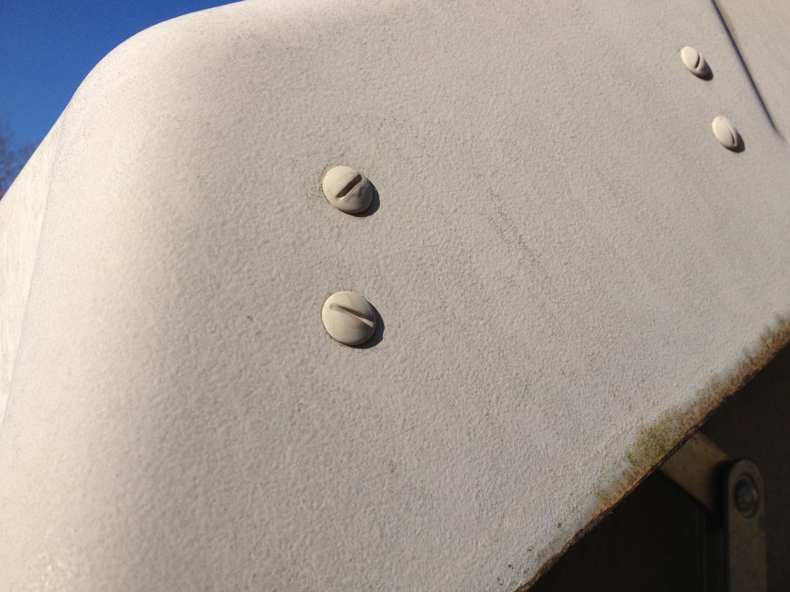

BTW, a view of the top showing the latch fasteners, these appear to be carriage bolts, any clue why? Simple assembly speed? "Antitheft" properties? Laughing
I'm going to use my 14mm Slotted Truss Headed ones here.

I think the carriage bolts on the top are used for ease of assembly. Even with mastic (don't forget it!) under the head, the head could/will rotate as you do up the nut inside.
Mind you, I've seen examples where the square hole in the top was rounded out and the anti-rotation feature of the carriage bolt useless.

Interesting, as I've read I keep reading "gelcoat, Gelcoat, Gelcoat.........."
Well mine is PAINTED!
There is no reason to believe my PO painted it. He was owner #2 of an 86 in 1990. He didn't do much of anything......why paint the top?!?!
Dealer painted it?
There is over spray around the lift mechanism fastening points, there is also a paint line above the Top Seal.
Under the top seal you can see fiberglass strands!
Makes me wonder if this was a replacement top or ?????
Why the clearly defined paint line around the unit? Wouldn't the factory paint the entire top and then install the seals?
Did VW deliver these in other colors besides White?
Hmmmmmmmm...........
Paint line........
Fiberglass strands....... You can see the individual fibers shining in the light......
Over spray.......
Dave
