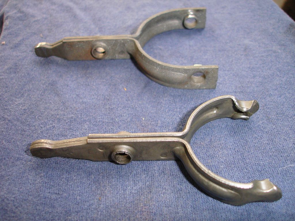

I was successful in swapping a 6v drive pinion assembly onto a 12v armature. Although I found that there are at least 2 different drive pinion assemblies and shift levers in 12v starters.
The first picture is my 12v starter with the 6v drive pinion and stacked bushings. I only used it a few times while trying to bench start a 40hp engine, so I won't be able to provide any info towards real-world use. The starter worked like a charm for the short amount of time I used it.
The last 2 pics show 2 differences I found while dismantling extra 12v starters that I had laying around. I'm not sure if 6v starters vary like this or are of one style. I guess I was lucky that I had extra 12v starters laying around and one matched up with the 6v style. To clarify, the pics below show 12v drive pinion assemblies and shift levers; don't mind the damage to the shorter drive pinion on the right.

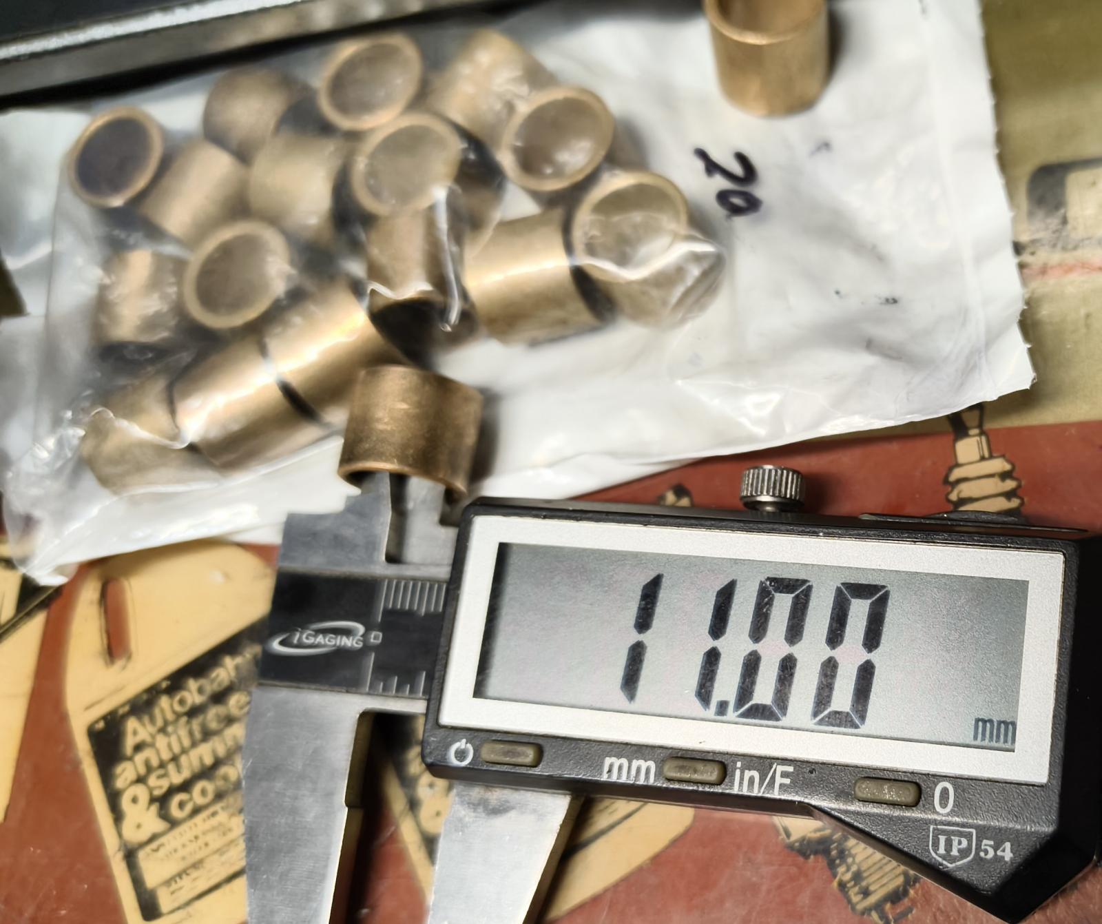

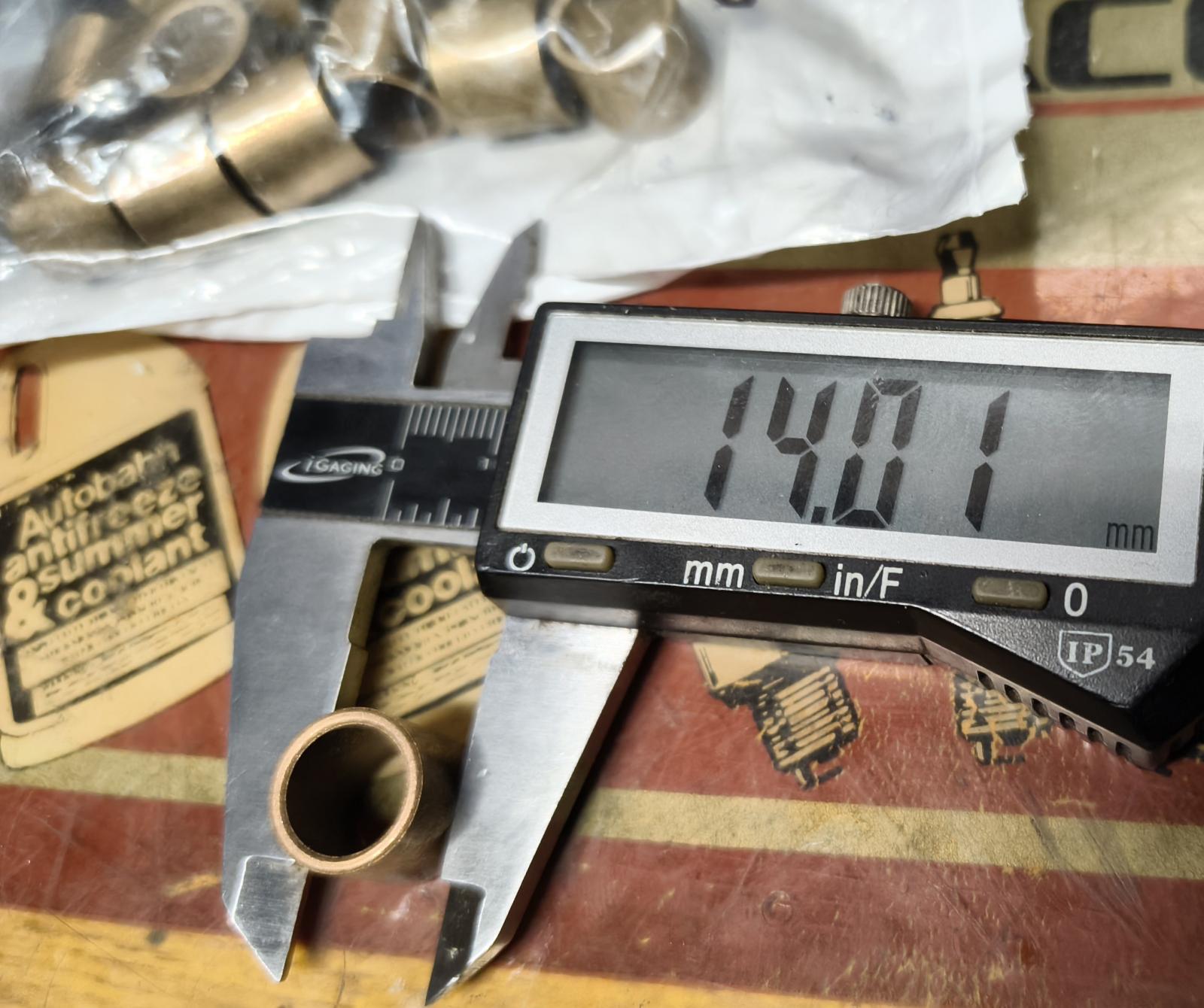

I took apart a 6V and 12V starter today and it looks to me it would take a 14mm od by 11mm id bushing to do a direct conversion without stacking. I have looked around online but no luck finding a suitable bushing/bearing. Anyone have any tips on supplier?

I have found the 11mm ID x 14mm OD bushing to make this work without stacking your worn out bushings
