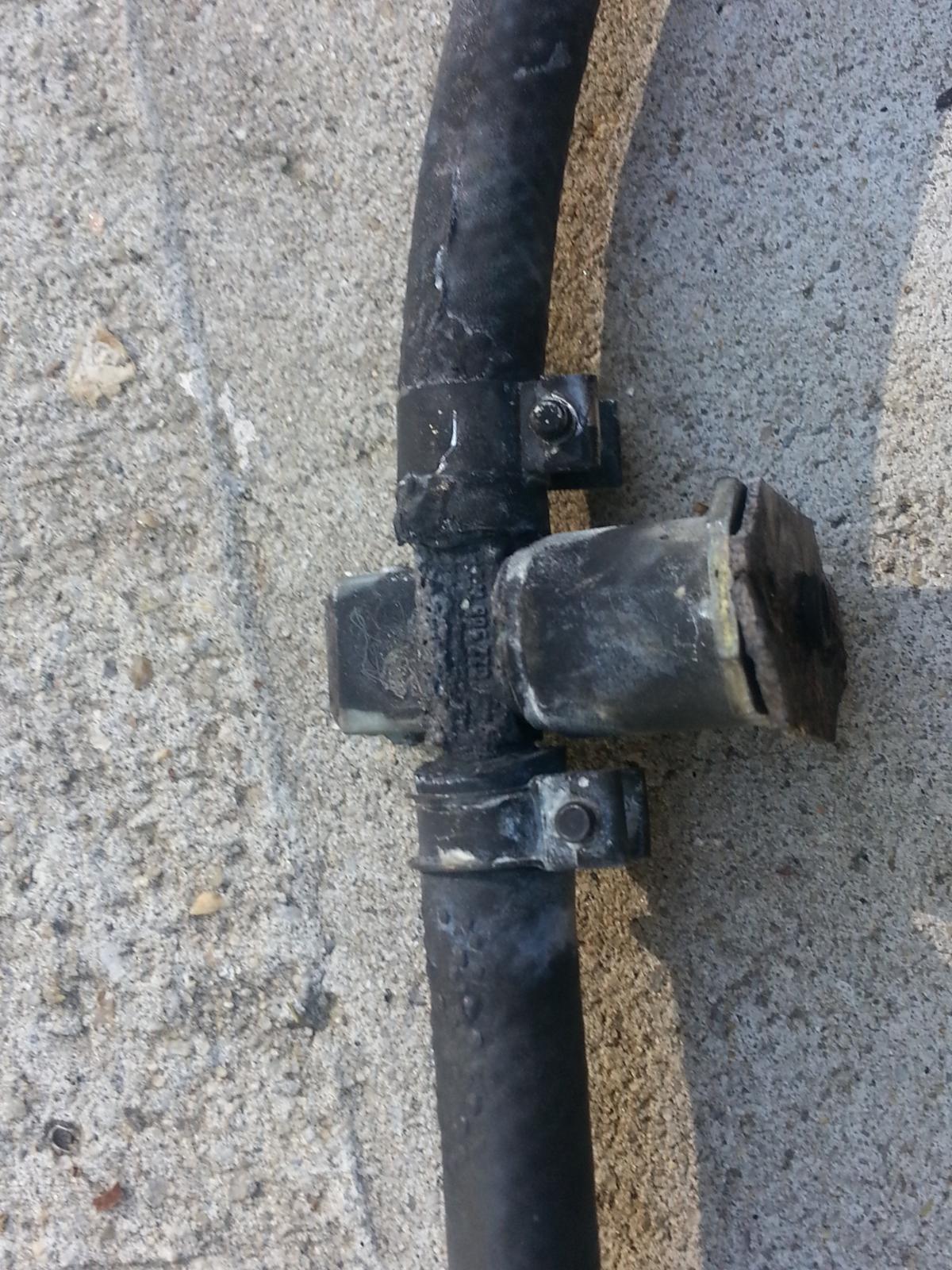

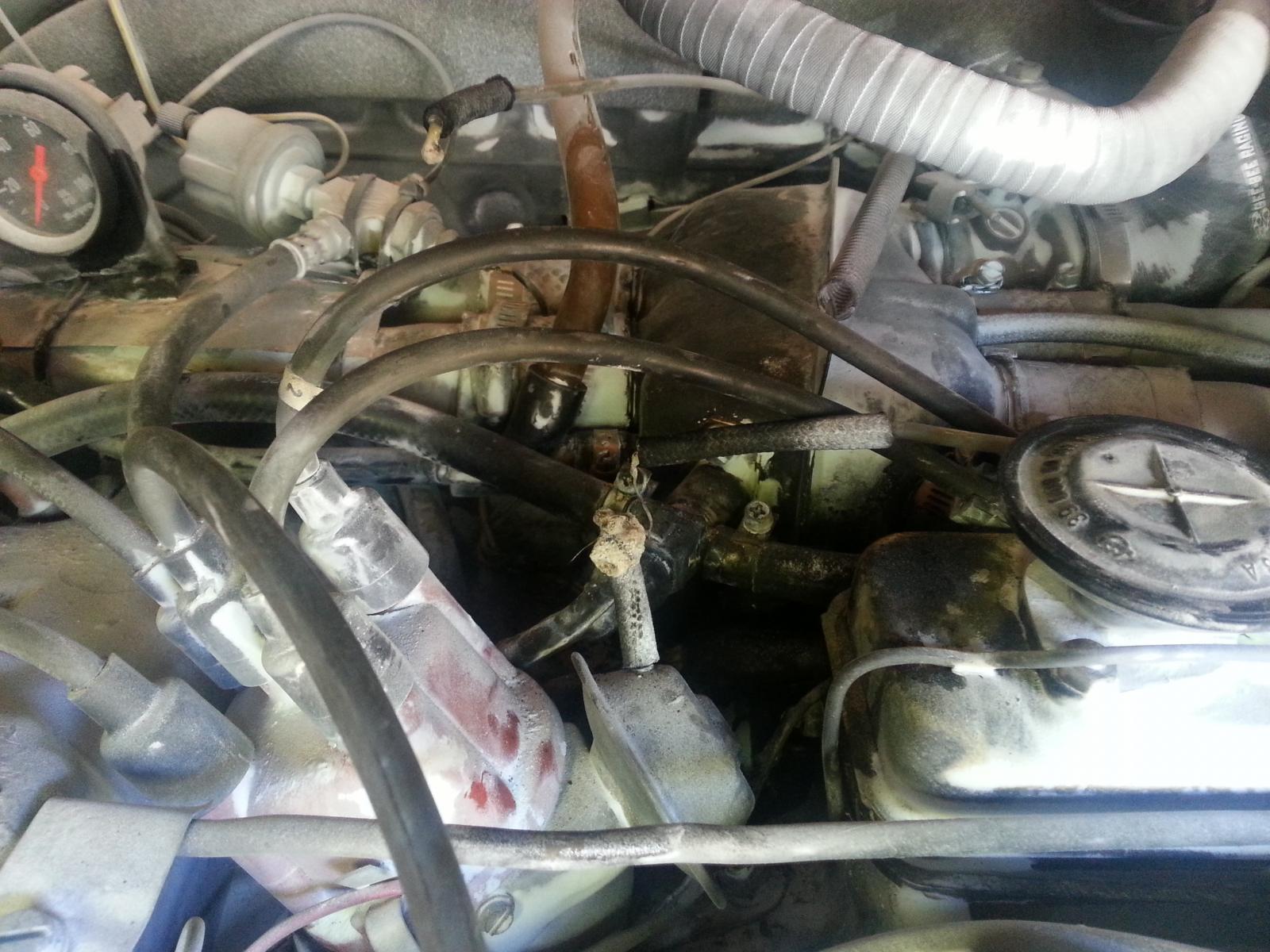

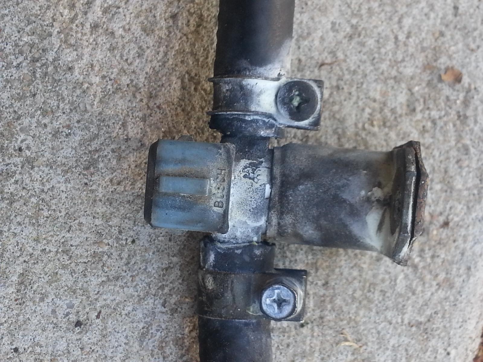

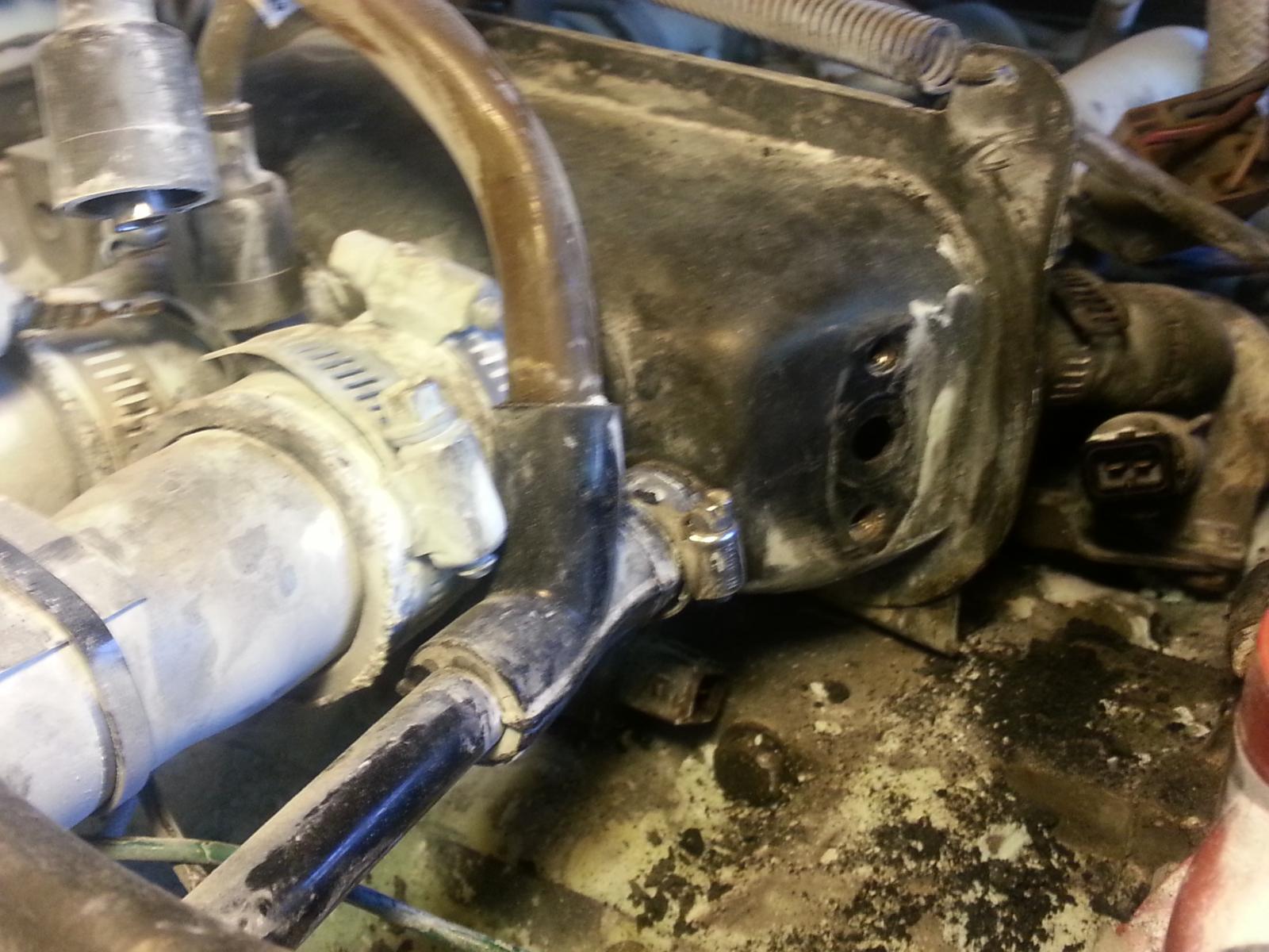

Confession, venting, and any advice or imput for what happened to me yesterday. Tcash, here is another one for the fire files.
Preface; Had the motor out in January to replace all fuel lines, re-route some wires, clean up connections and other general easy access housekeeping for the engine and engine bay.
Used Gates 30r14 hoses. Proper fuel clamps at all points. Have put a few hundred miles on the bus the last 2 months with excellent starting and great predicable performance. Have both CHT and custom O2 sensor with consistent figures as a trend monitoring.
Go out to start on a cool 50s morning in Georgia, bus fires right up. Run back inside to lock up and on my way back into the garage notice the bus is idling low, go to pop the deck to look at the motor and/or give it a blip of the throttle body only to find a steady fire blazing at the top center of the engine. OH SHIT...
Via the passenger side I run to the front, briefly think to back it out of the garage in case I cant get the fire out, but instead turn off the ignition, run to slider grab the fire extinguisher and go back in total disbelief, still at the sight of the motor burning. a Single shot of the extinguisher puts out the fire.
After the agent settles, I disconnect the battery and start trying to figure out WTF happened. As im still staring in disbelief, I can hear the fuel pressure making a slight girgle/hissing noise right around the cold start injector. I relieved the fuel pressure via the relief port. All I can figure is that the line had worked its back off the Cold start, or some failure of the injector itself at the housing.
I still had to be somewhere, so I poured two cups of water around the fire area to cool any hot spots and wash away any remaining gas and had to leave.
My bus is overall fine, the worst was my previously excellent condition Harness is now torched right in the middle, the vacuum T off the distributor melted, and a connector at the booster fan melted, but the wires were ok. My once clean engine bay is now powdery white, I lost a Cold start valve and while most likely fine the connector on my Aux Air regulator was a little melted, I have spares for both, and had a little melted insulation overhead
Once I got everything off, unfortunately no obvious failure points, although I figure fuel leaking onto the harness area under the plenum was ignited by vapors in and around the distributor, or ran down onto the exhaust and back drafted up. The fuel lines didnt show any fatigue, leak or failure point. The cold start valve while melted at the connector, seemed fine otherwise. The harness took the worst of the burning, with no damage to the Dizzy, plug wires, oil relocation hose, breather (thank goodness) or plenum. Car was running for less than 2 minutes
I have a spare harness I'm going to clean up today and reinstall, as well as all the other components, all I will need is new fuel line between the cylinder banks. My plan is to install it and secure to the Cold start off the car then install and hook it to the rails. I have been trying to blow out and shop vac out the powdery agent residue. Is this stuff anything I need to worry about scoring the metal or oxidizing if it clumps in unreachable areas? Or how much of it may get ingested when it runs again. Im due for an oil change anyways so that will come right after I get the engine warmed up. I'd like to not have to pull the motor again.
One observation is not only have a fire extinguisher handy, but know exactly how to use it. I wasted what seemed like forever, but really was only 2 seconds after I pulled the pin squeezing the housing not the trigger. I feel lucky it wasn't worse, but with good preparation both prefire and now in the rebuilding.
Any other thoughts? Im still not sure how I would have prevented this. I was on my way to a volunteer at Stop Hunger Now food packaging meetup, so I cant even say Karma got to me.
The line looks split in the above picture, its not...both lines at the Cold Start were intact internally when I pulled them off. My only real though was the clamp on one side is farther out on the barb than the other side. Maybe thats where the leak was

PostPosted: Sun Apr 10, 2016 6:34 am    Post subject: Re: Engine fire, even after everything is done right Reply with quote
I have seen this a couple of times.
I would be willing to bet that your CSV came "un crimped" and just simply gave up the ghost. a tell tale sign is if the connector or T section where fuel passes through was wiggly.
I bet the cold weather just shrunk the o ring in the CSV, and sprayed a mist of fuel which the distributor ignited
thankfully, you caught it and there was no "real" damage.

PostPosted: Sun Apr 10, 2016 6:41 am    Post subject: Re: Engine fire, even after everything is done right Reply with quote
Nailed it I think. It is loose and I did leave that out of my original description, but I noticed that when I got it off the plenum.
