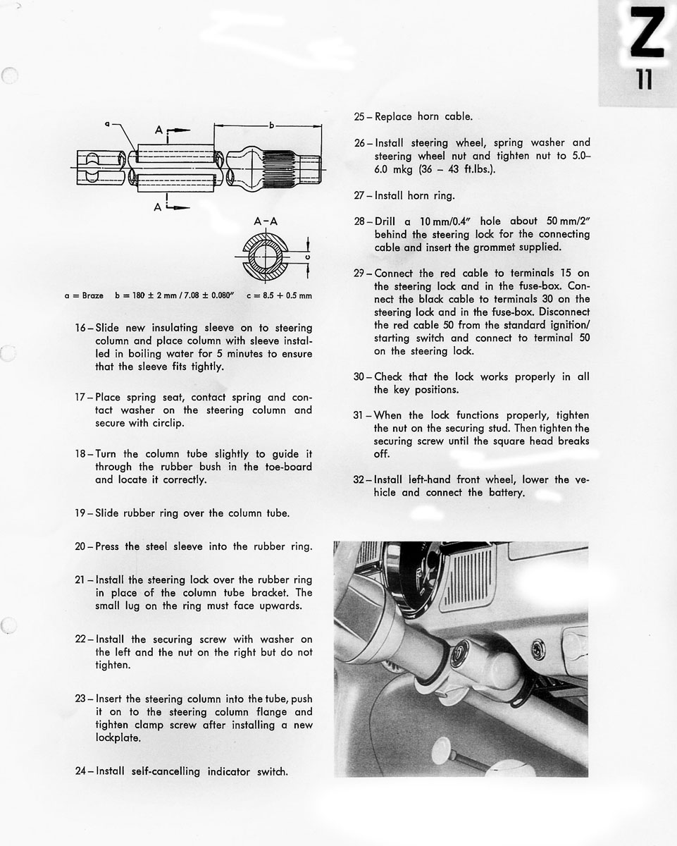

locking column was an accesory that could be ordered in usa. this means you are so close to being correct that you are more wrong than correct.
here is a 1963 deluxe with locking column from factory.

here is literature for Service Installation of steering column lock/ignition switch. Do you know definition of "Service Installation"??? this is 1960 edition. Shocked

1961-1966 if it had lettering around key hole. also 1967 only if no lettering. my 1960 original delivery to Berlin Germany did not have the locking column/ignition switch,so it dispelled all european delivery had stock/came with locking column electrical switch.

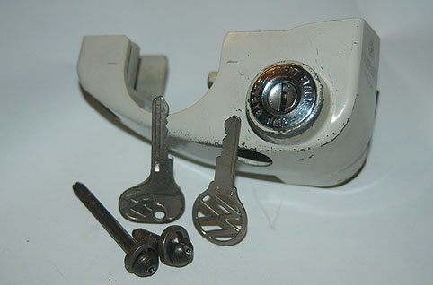

Thank you all for responding. It looks like the picture that Bill put up, but it has no numbers on the key outer ring so it must be a late 66. It has three wires that are cut from the back. It still serves a purpose, it still locks the steering column but it’s a different key then my ignition key on the dash. Should I change it back to original or should I just take it off and have a non-locking column and keep my dash switch?
I took some pictures
