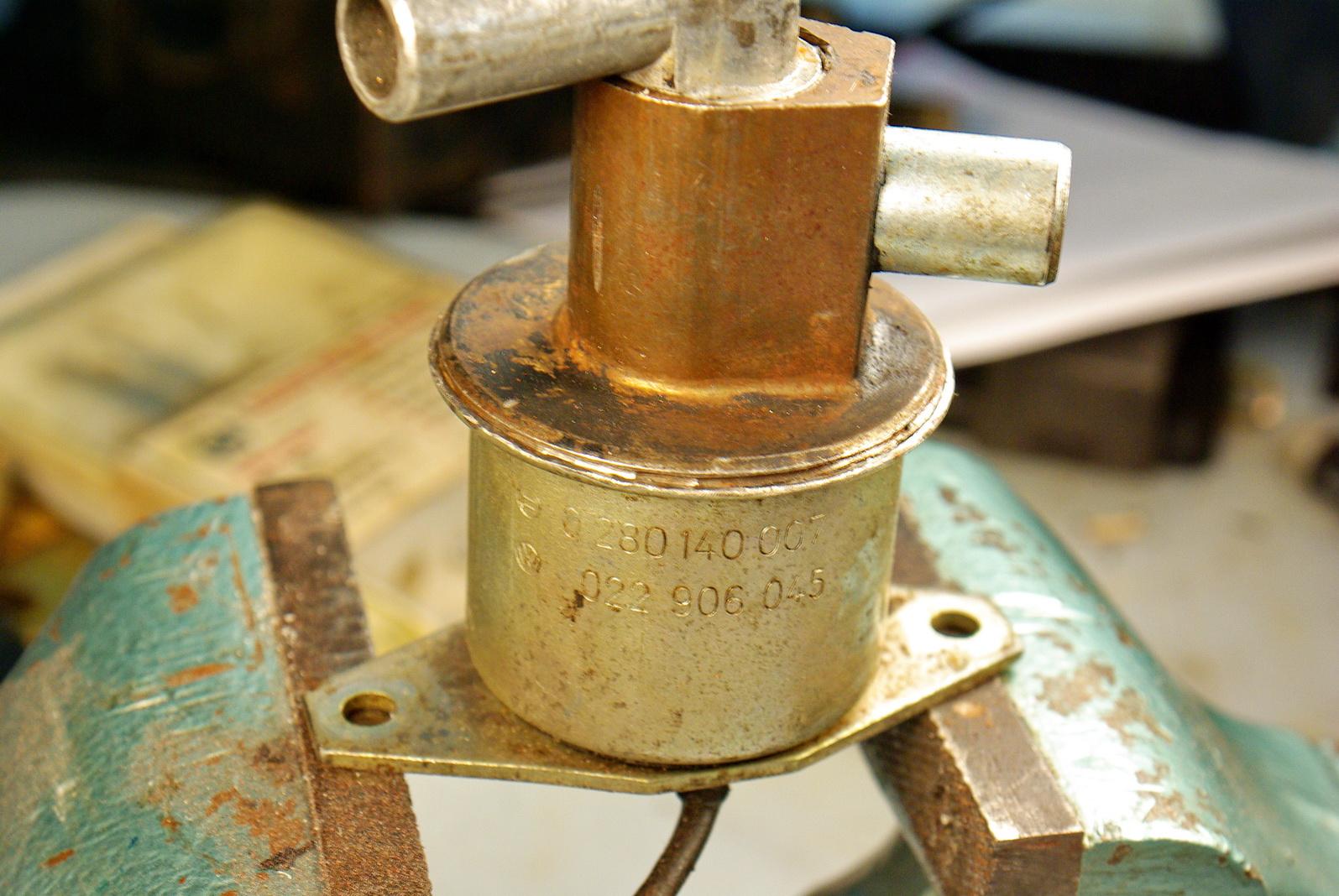

Here is a process to disassemble, clean and re-calibrate an electric AAR.
Background: My AAR had been stuck in one position for many years, gummed up with black deposits which I suspect are oil residue from the air cleaner.
1) Using a Dremel I cut through the rolled lip in the silver metal cover
2) These slots allowed me to pull back the rolled lip 1/4 inch in sections. This prevents distortion or cracking of the material, which turns out to be quite soft and pliable.
3) Remove the valve and thermal spring, Note the calibration adjustment on the thermal spring (in the photos this is show as a red dot)
4) Inspect the heating element, repair as needed.
5) Remove the calibration screw, and thermal spring.
6) Clean the valve. I used carb cleaner and Acetone. At this point you can rotate the valve by its stem quite easily.
7) Reassemble the thermal spring, using your alignment mark.
8) Place the valve in the freezer and adjust such that after a cold soak the valve is fully open.
9) Attach the heating element to a power source and confirm operation.
10) Loosely place the cold calibrated valve onto the heater housing.
11) Apply power to the heater, observe the action of the valve. Mine took 5 min to fully close from ambient temp.
12) Adjust calibration as needed and blow into the valve ports to confirm that the valve reaches a fully closed position.
13) Carefully hammer the rolled lip segments back over the valve, first confirming the alignment between the base and the hose ports.
14) Retest on the bench, and reinstall.

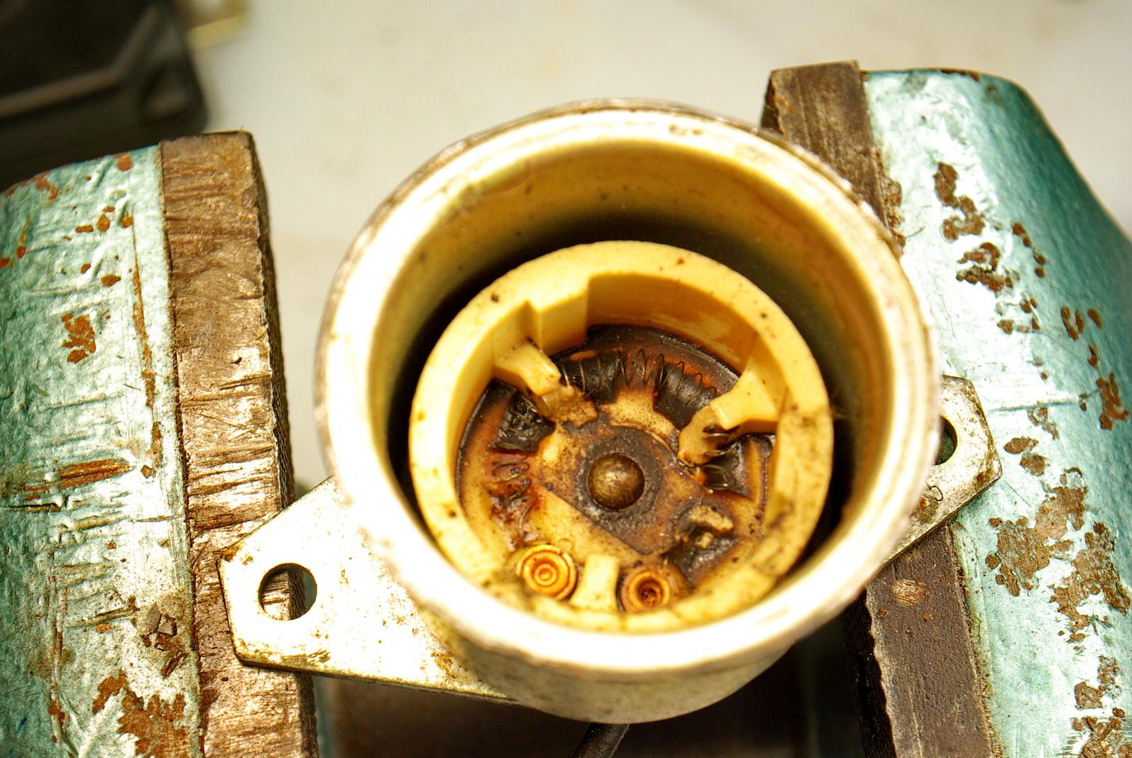

Nice photos. Someone just pointed me to this thread and I'm wondering if the area around the heating element was this clean when you first opened it up, or is the photo after cleaning?
It just seems likely that oil mist from the air cleaner over the years would have filled that chamber with oil. If it didn't, then I wonder if there's a seal somewhere, or is there some other reason that these get sticky over time.

The heater and related can were not cleaned, this is the way they looked when I opened the can up. I energized the heater with the can open and no smoke or other signs of burning were noticed.
Thanks for your questions, let me know how I can assist.

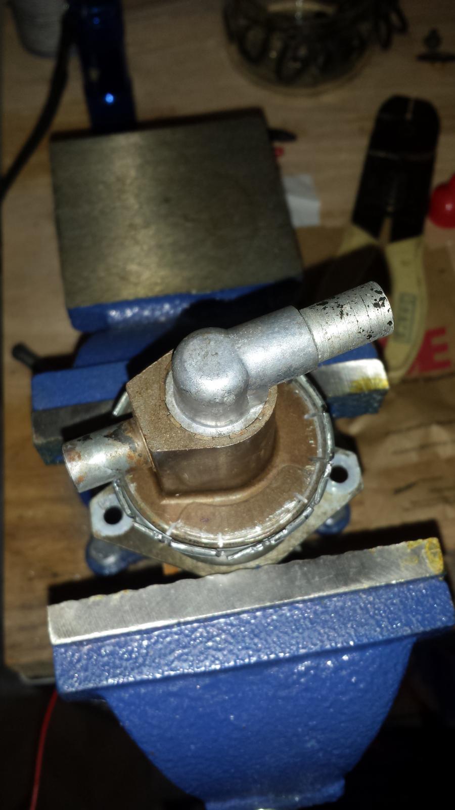

I took mine apart a little differently. I used a sanding drum on a dremel vertically to juuust grind off the outer edge of the lip so it looks clean. I then made a three little clamps out of .080 sheet metal to hold it back together. It does not look like factory...but is clean.
I think a full ring clamp could be fashioned and look better...to allow opening and cleaning, or replacing the electric coil or adjusting.

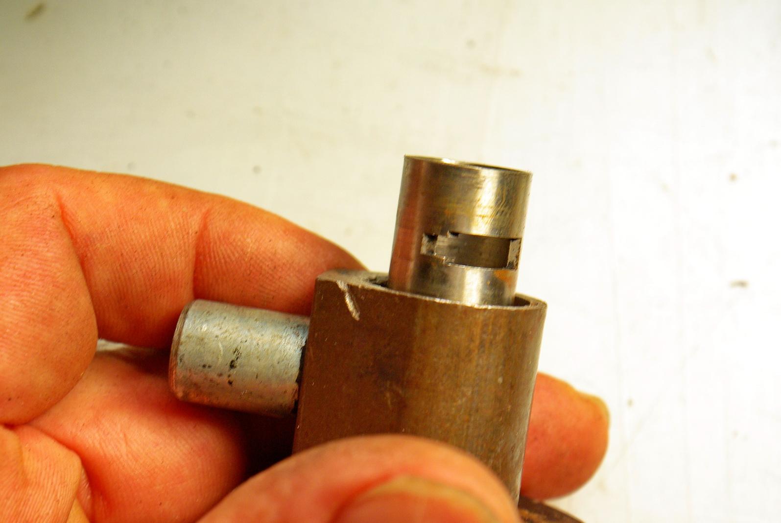

Ok…these are from some of my earlier experiments. I was able to rewire the heater coil in the AAR with the slotted crimps around the edge in these pictures and soldered the wires onto the brass pins. The resistance was about 15% higher than stock from my notes…but it worked just fine.
In short...no you cannot pull the valve out through the bottom after you de-crimp the base cup. If you want the valve out to clean it...you need to remove the top elbow...which you will see...is not a big deal.
An unmolested AAR for visual reference.
This one was my first. I slavishly slotted all around the edge with a Dremel and thin cut off wheels. What a PITA! It worked but I went through about $10 in cut-off wheels
Earlier I noted that I used a sanding drum vertically the edge. Sorry…poor memory. That’s how I’m GOING to do the next one. When I dug it out with my notebook…..I realized that I sued a cut-off wheel around the edge to separate the top of the crimp roll. Worked well.
You can see the nice little ledge it left for the top part to sit in. you can also see from these two pictures where the oil that dripped in from the oil bath air cleaner gets cooked around the wires.
That in itself does not hurt the resistance coil wire…but as it slowly covers the wire…the wire cannot cool off by radiating heat to the bi-metallic spring…and it burns in half.
Sorry for the blurry pictures….I did not have my macro lens on hand…and I was rushed..…but as you can see it has a coil and adjusting lock screw at about 5 o’clock in the picture.
And without the spring in the way…you will see that …NO…you will NOT pull the valve out through the bottom to clean it. See the tiny pin at about 3 o’clock…that must be turned to fit the keyhole at about 11 o’clock?
From this picture it looks like..IF...you could lever out the steel bushing from the inside...that the valve could be pulled out the bottom. I forgot to inspect to see if that busing is the bottom of the bore. I will check.
So…the spring must be removed, the valve turned….and the top elbow must be removed because the valve comes out the top.
You can see here the keyhole slot for the pin in the stem of the drum valve
This is the valve and bi-metal coil. Its stainless steel…non-magnetic.
The elbow is pressed into a machine fit recess and peened around the edge. It fits so tightly that I have to rap it back in with a rubber mallet.
But…I could easily install three small miniature machine screws with washers on the outside rim...where the red dots are….something around .050” diameter.
Combined with the tight fit and the screws in notches around the rim of the elbow….it would never move.
This one was held together in my parts box with some little crimp clamps. Temporary… but it gave me ideas.
Like making this two ring bolt together ring clamp….

Yes.....there is a roll pin you can see in the picture both of the valve alone and from the bottom side after I removed the spring. It keeps the valve from rotating too far around.
What I,should have mentioned....but you can see in the pictures.....is that the steel bushing on the inside that the spring is against....is notched.....like a wedge of cheese. You can see it in the pictures. Between this notch and the roll pin....the valve has a restricted arc.
If he did not remove the top elbow.....he did not clean the valve. There is no way to get it out without removing the elbow. Ray

The rotary valve that has the slot....that you see when you look through the port when you pull off the hose to the the intake manifold....is a hollow tube with an open top and with a stem on the bottom to attache the spring to.
At least on the 411/412...the air comes in from the air cleaner through the elbow on the top (yellow arrow) and goes out of the slot in the side to the manifold.
I cant remember which way it flows on type 3 but it works the same either way.
Here is the rotary valve in cross section. Its hollow. Its top is open to the hose to the air cleaner at all times. Even if the valve is fully closed...oil vapor from the air cleaner makes its way into the hollow center.
