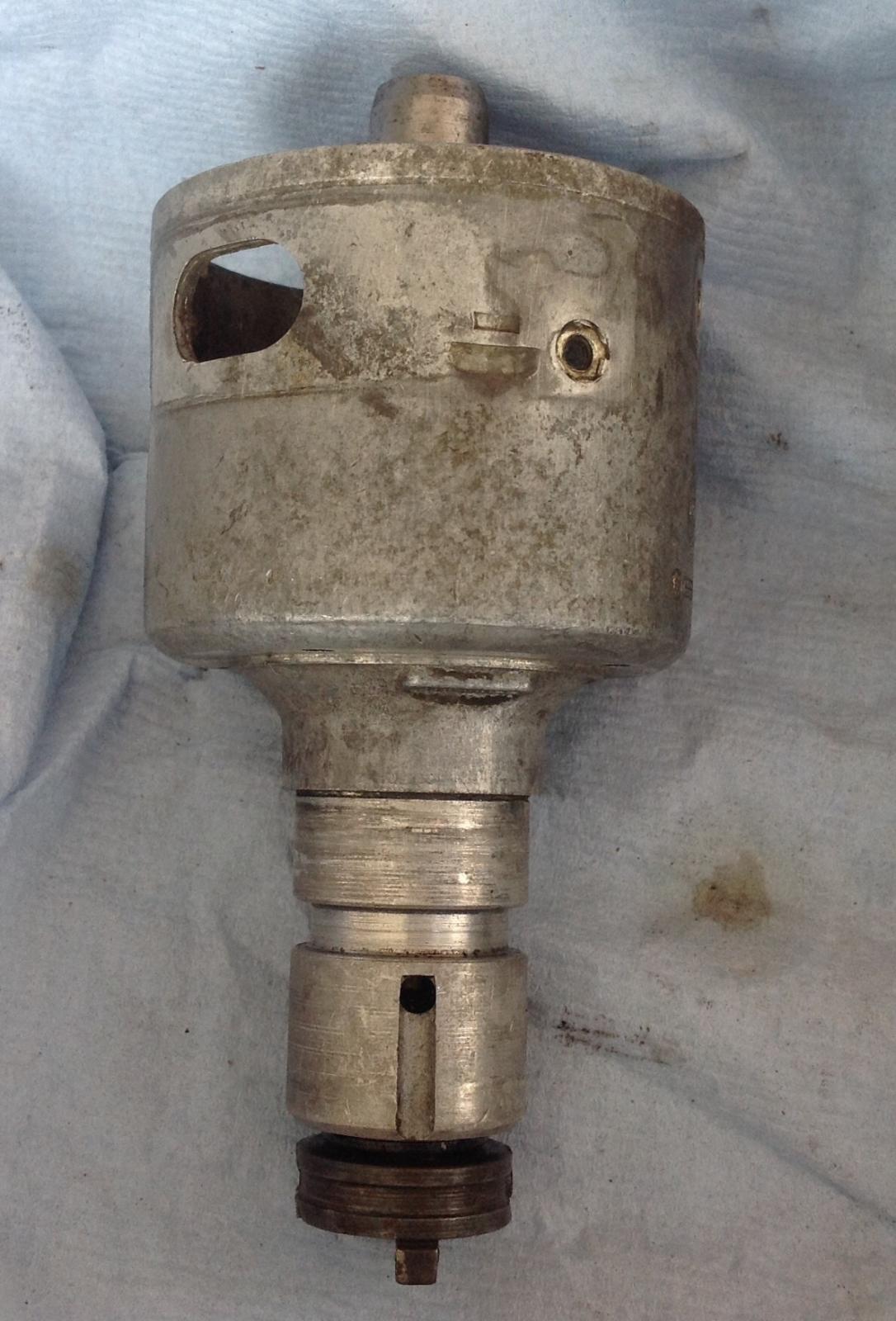

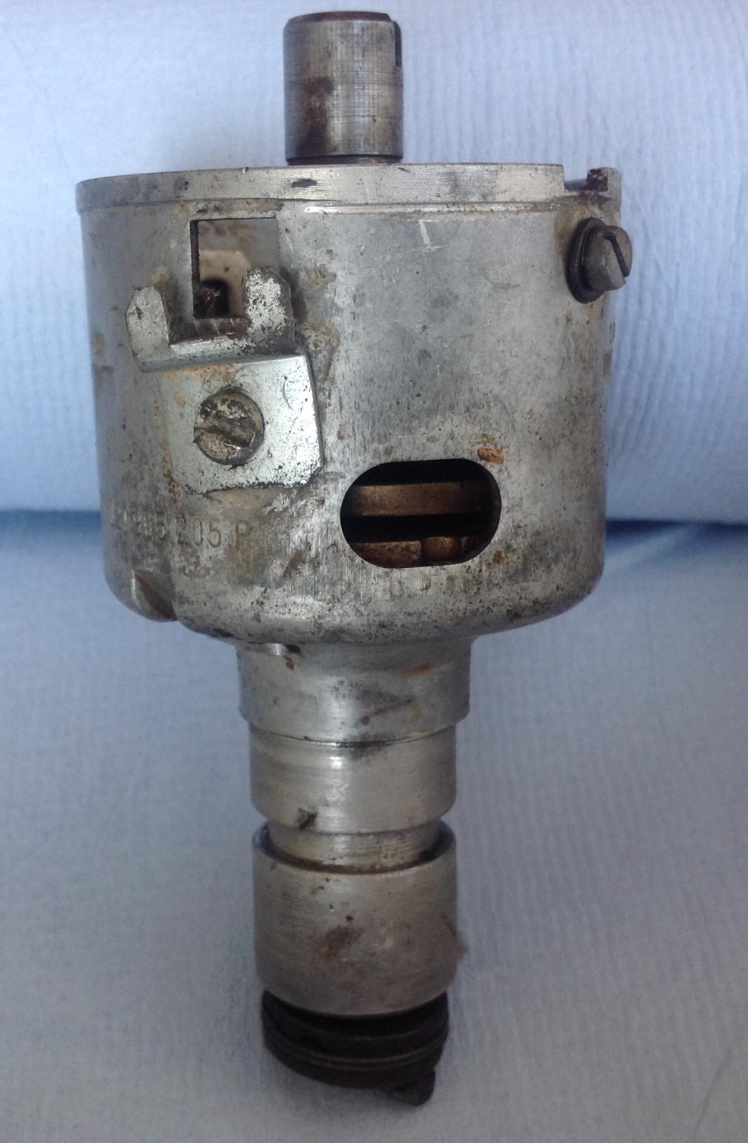

First step was to strip off the easily removable parts; ignition contact points, condenser, clips that hold the cap on and the plastic or metal 'window' that is level with the centrifugal weights low down in the bowl of the distributor.
Also remove the vacuum can screws and release the arm. Test the can holds suction for 20sec or so with your tongue.
That leaves you with this:
Remove the two screws that hold the points plate. It won't lift out at this point because of pressed tabs in the body of the distributor. The lower plate needs to rotate clockwise about 1/2"
If the distributor is full of crap (likely!) you can knock it around with a punch through the vacuum arm hole (pictured). Then the points plate can be gently levered up:

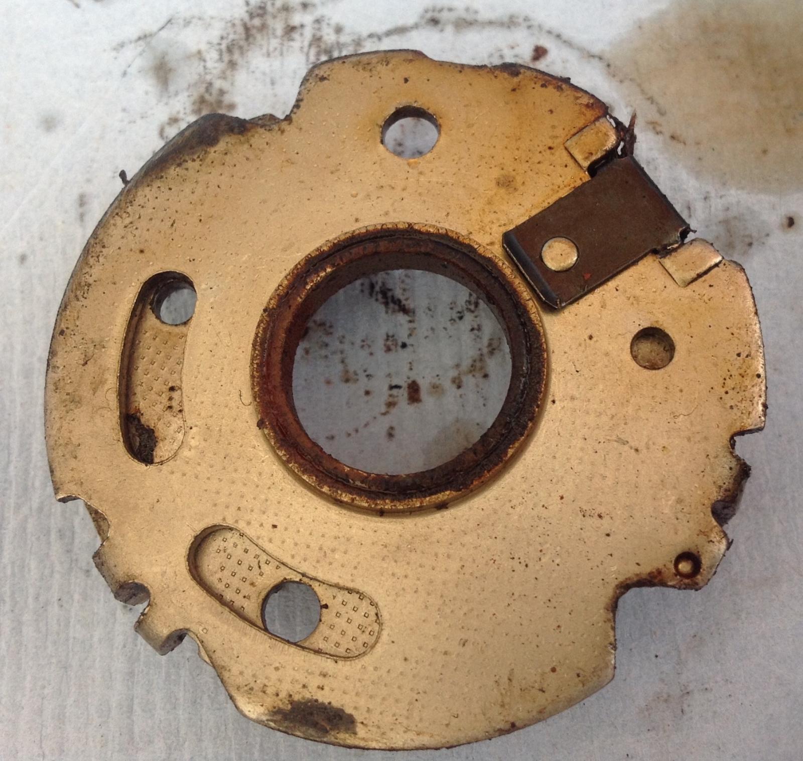

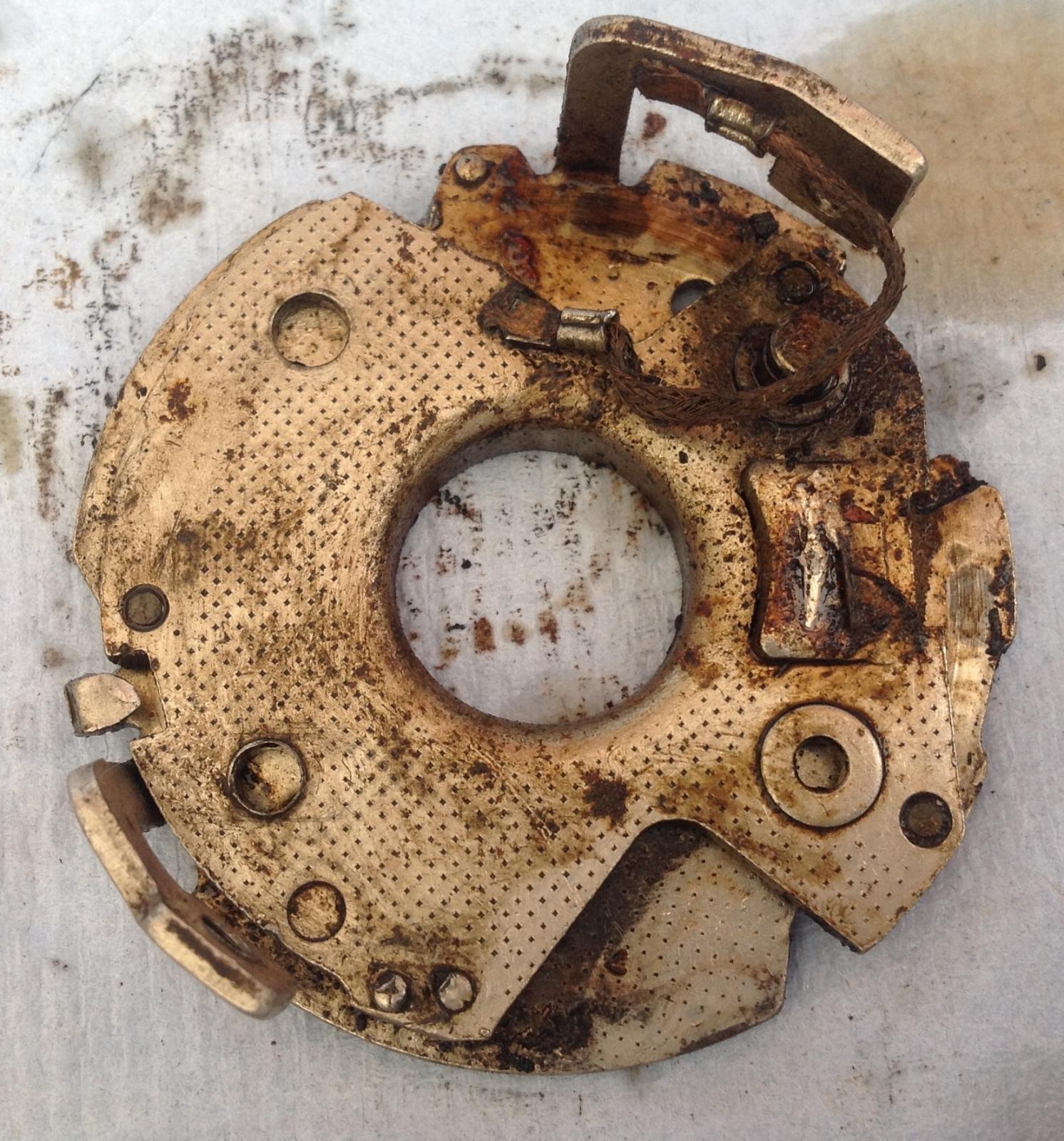

The points plates then pretty much falls out.
The two halves are held together by a spring clip that holds a ball bearing.
I've got a limited range of tools and cleaning products with me, so everything gets a preliminary clean with solvent, disposable detergent wipes and maybe a squirt of Gibbs protectant. I would prefer Gibbs and wire wool, then IPA, then Bosch distributor grease. Oil is recommended for the shaft and the fibre washers when you get to that stage.
The spring clip levers off, don't lose the ball! Push the plates apart but beware that the braided electrical strap should not separate! Clean up as you will, and put back together for now. The ball and clip are easier to replace upside-down!

PostPosted: Mon Aug 29, 2016 2:55 pm    Post subject: Re: 021 905 205P distributor refresh (pics) Reply with quote
If you're very lucky. Most times it's seized to the body. And if you try to lever it out, you can bend the bottom plate and you'll never get it straight again.

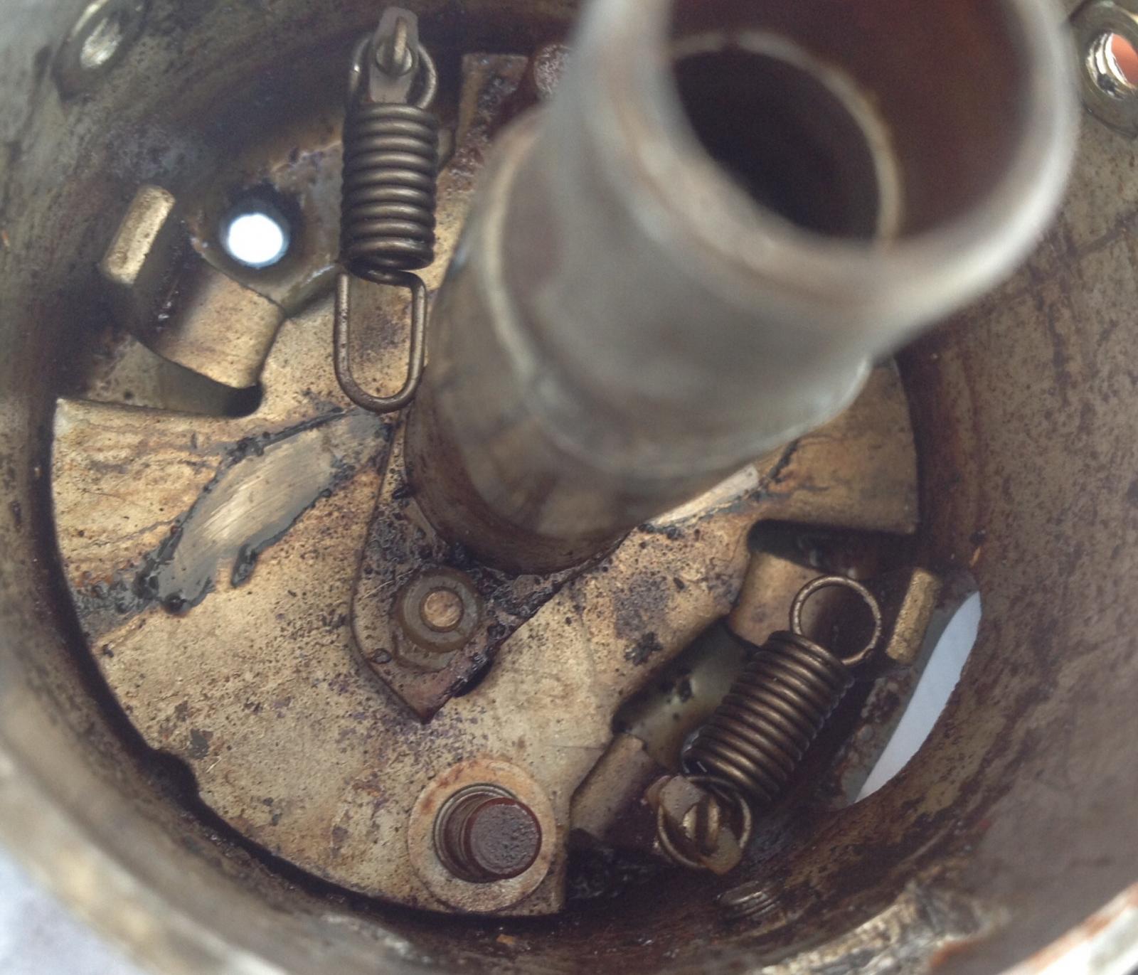

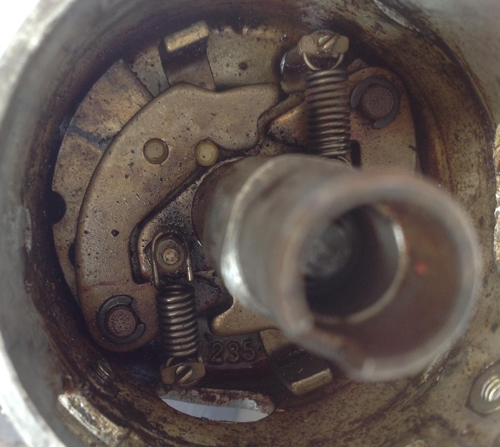

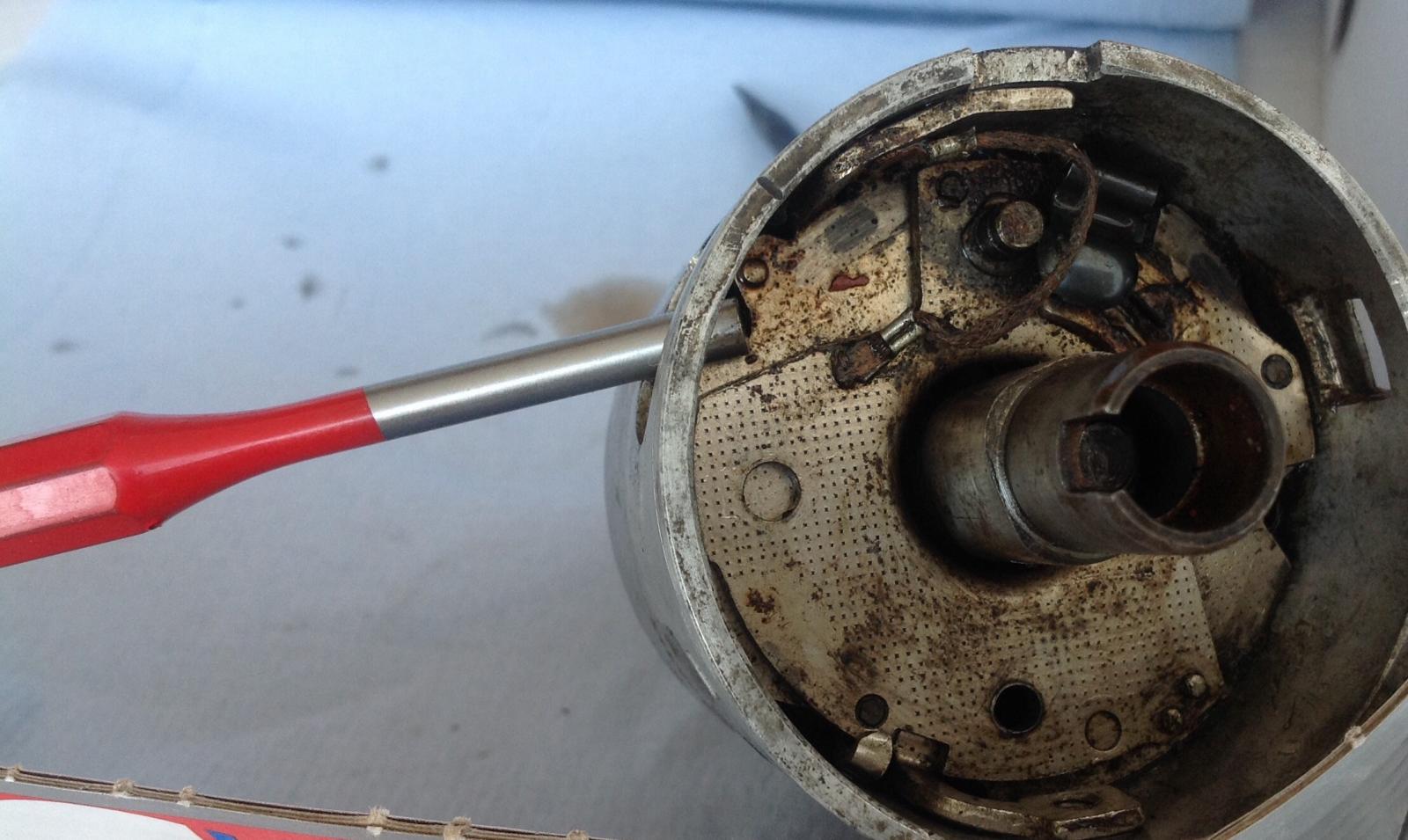

Then take a look inside the body of the distributor. In fact, take a photo, 'cause you'll want to see how the weights and springs go back together when the time comes! In fact, take two...
The weights are held in place by a circlip/e clip, and rest on little nylon washers. You could lever them up once the clip is off through the hole in the side of the body, but...

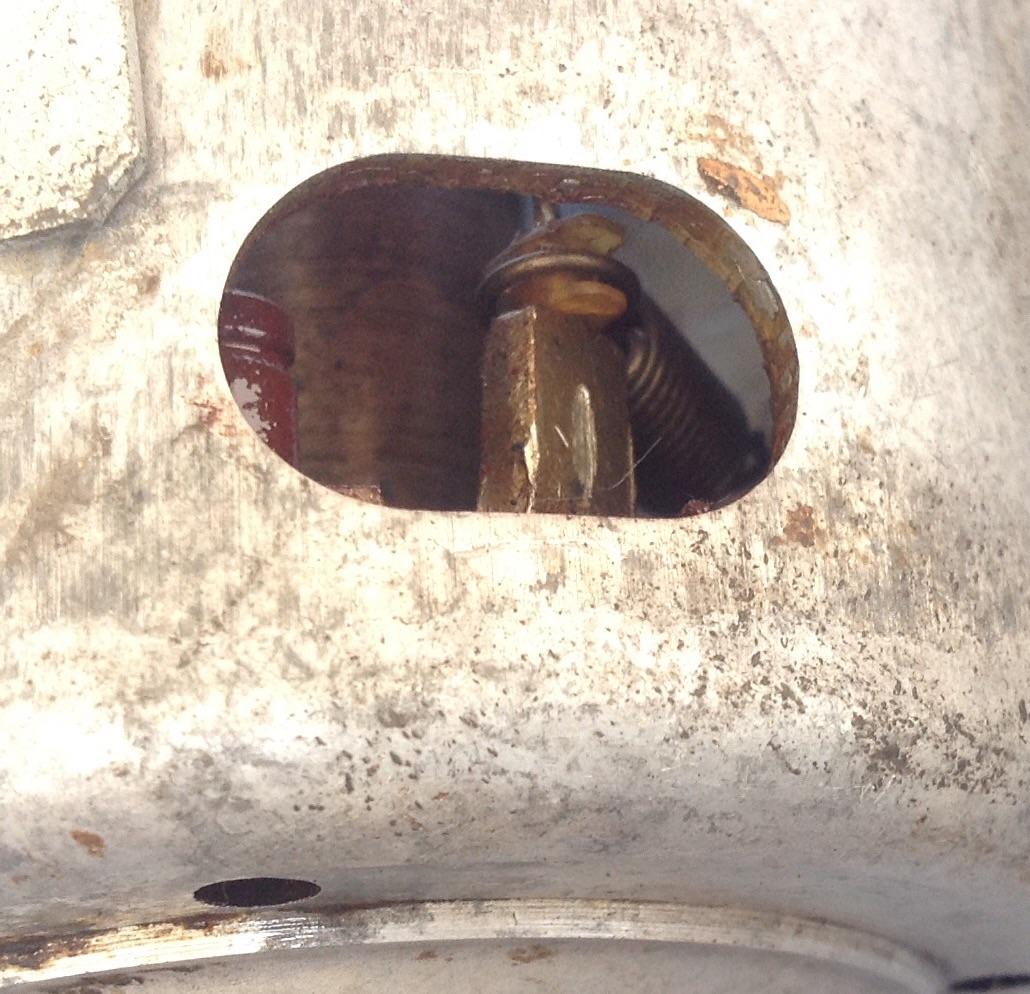

The springs stop the weights lifting off, and...
The springs are retained by a dastardly, fragile NLA plastic 'wing nut' arrangement at the outer ends. It is very fiddly, but you have to get at least one end of each spring free before you can take off the weights. Don't break these plastic clips! They do rotate on their shaft though, if that helps you. You can see one through the hole in the last pic...

PostPosted: Mon Aug 29, 2016 3:01 pm    Post subject: Re: 021 905 205P distributor refresh (pics) Reply with quote
You need to remove the pin on the drive and remove the internals before taking them apart. Be careful not to break any of the plastic pieces since they are NLA.

PostPosted: Mon Aug 29, 2016 3:11 pm    Post subject: Re: 021 905 205P distributor refresh (pics) Reply with quote
Were it me I would stop right now. The odds of getting both the springs off the plastic retainers is about a 1 in 10 chance. Making matters worse, the bearings are probably well oiled and broken in. When you clean it if you don't get the lubrication just right it will seize followed by I imagine a brass gear failure - followed by...
Usually it takes me three or four cores to get two good plastic retainers.
If you go for it, make sure that the springs stay with the same weights. Don't swap them.

PostPosted: Tue Aug 30, 2016 1:31 am    Post subject: Re: 021 905 205P distributor refresh (pics) Reply with quote

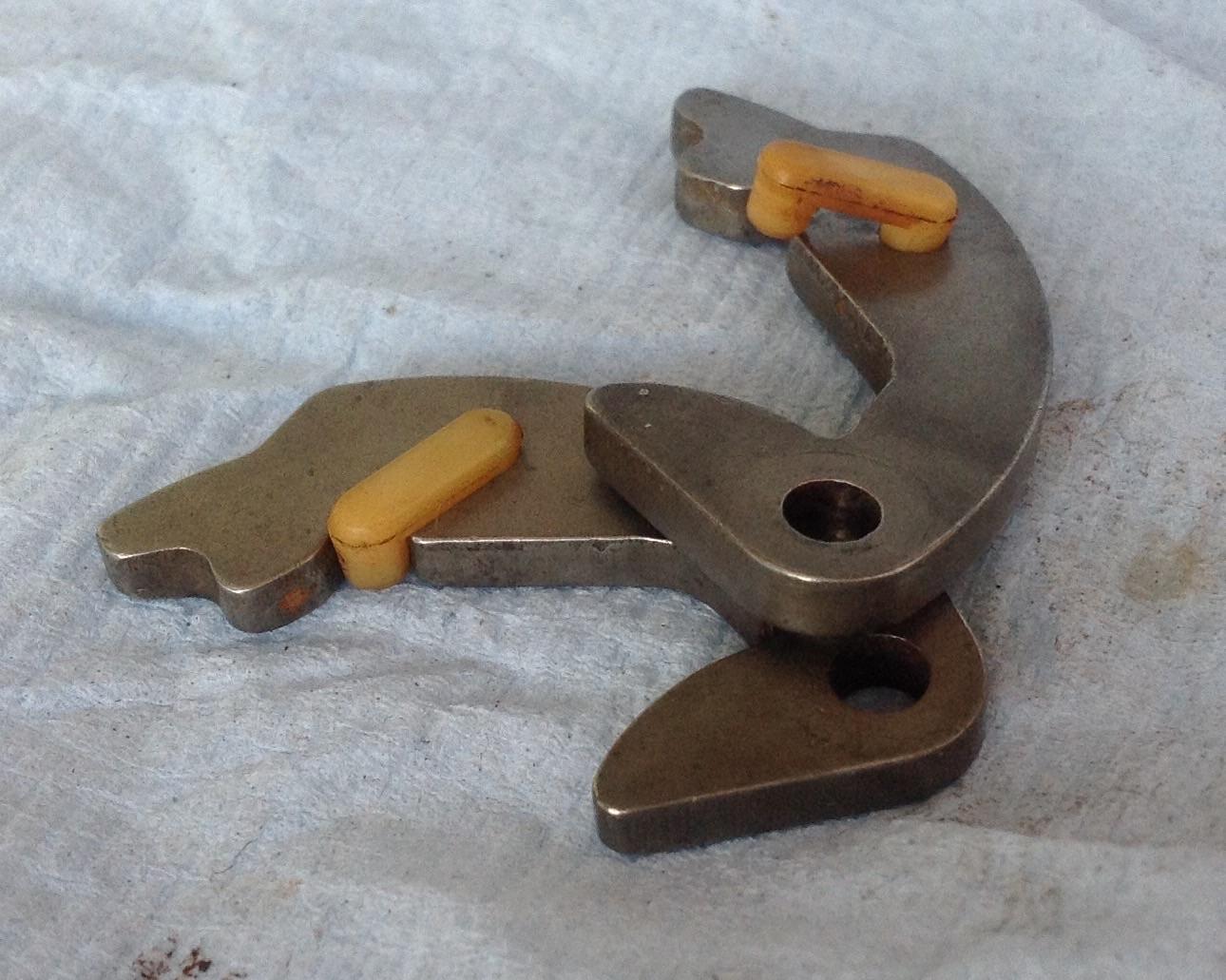

So, to proceed, I released at least one end of each weight's spring, and if I was in any doubt, left the outer end attached so as not to risk the plastic 'butterfly'. The weights lift out and there is a nylon type washer underneath, on the post. It may be that the weights are 'sided', so that they have to go back on their same post, but I made an executive decision (after I had dumped them in the solvent!) that they were both visually the same, and have the same serial number '3' stamped on them, so I didn't mark which was which. Also, they have a small plastic 'rider' that lubricates their movement, which probably shouldn't go into strong solvent. These are easily pushed out. I also quickly wiped clean the inside of the bowl, but all of these steps would be easier with the shaft removed, I'm just impatient!

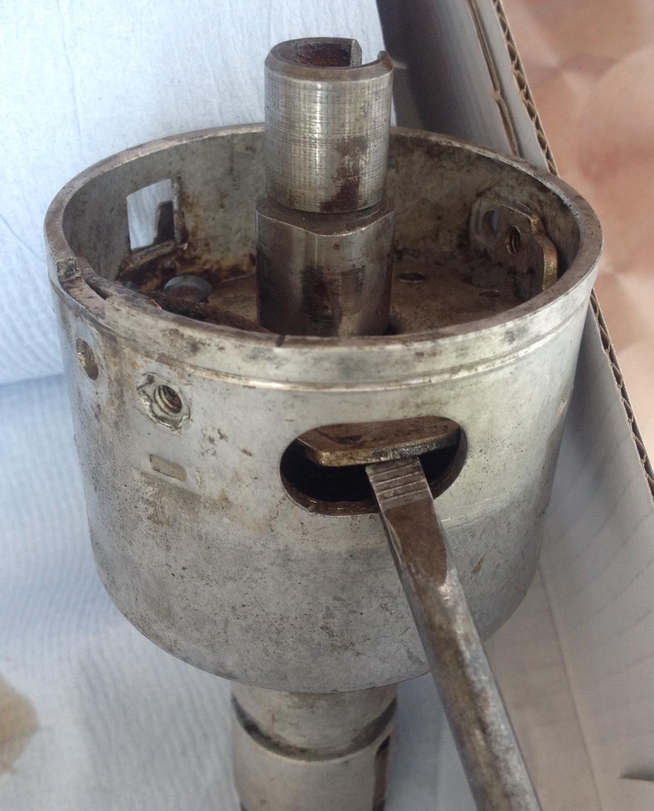

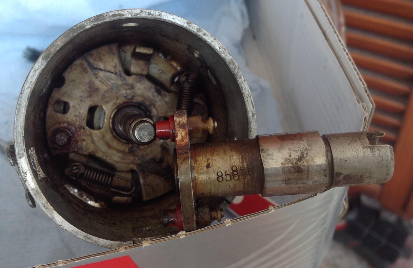

To remove the shaft it's pretty obvious. The pin is covered (?held) by a wire coil spring. The spring eases off and with a combination of punch, hammer, vice or press it apparently knocks out fairly easily. I haven't got there yet.

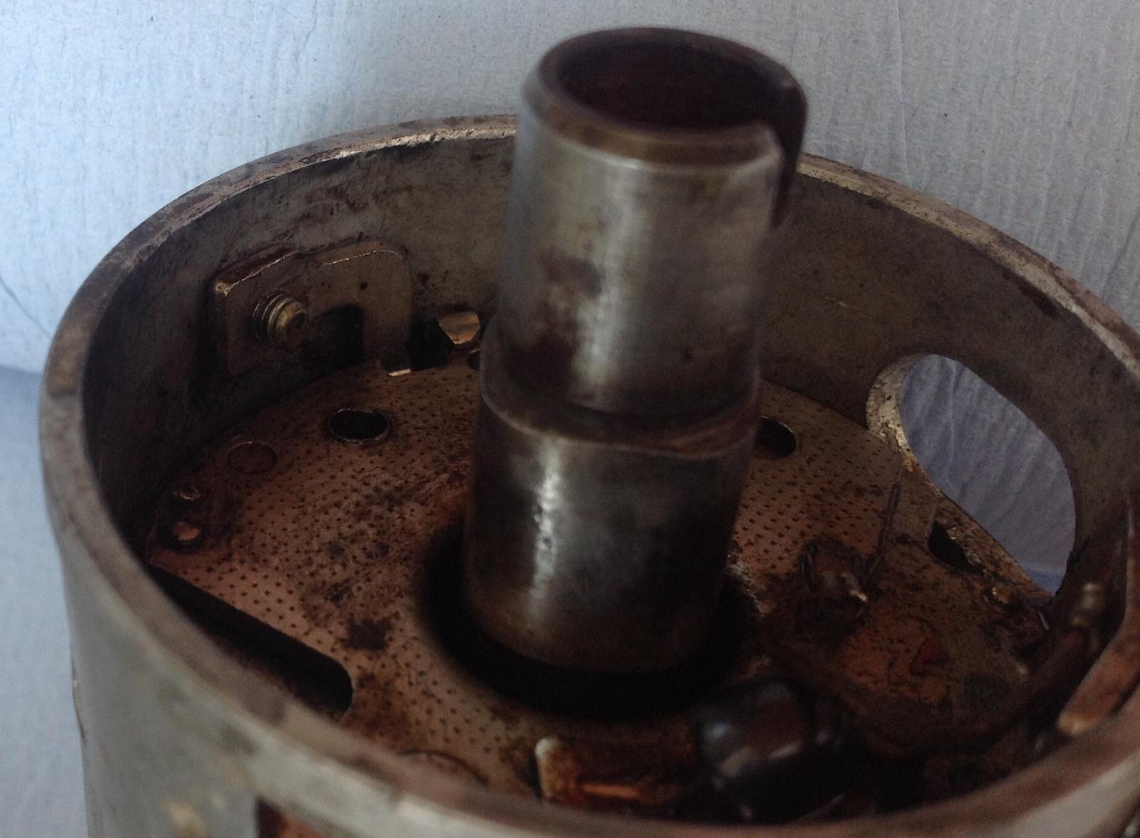

What I could tackle was removing the upper shaft. This is held in place by a dastardly 7/8 circlip, in the most inaccessible location imaginable, under the felt wick Evil or Very Mad . I really struggled with this, for many hours, and eventually fished it out with a dental pick fashioned into a tiny hook. In one of my cores, the wick has disintegrated and become enmeshed with the clip, and many hours of 'fishing' haven't got all of the wick, or the clip out. It's a bastard.
Pics show the circlip in position, and slightly dislodged on the way to coming out...
Once the clip is out, there is a metal washer underneath it. Then the upper shaft lifts out. Edit: there is also a metal shim/washer under the shaft.
In your excitement, make a note of which way around it is, as it can go back 180deg out of phase. Guess who didn't make a note? Embarassed
However, with three other cores, I established that if you look from the side, and have the small half of the drive dog to the left, the rotor arm notch right at the top faces the rear front of the distributor, away toward you. Now we know!
The top half of the shaft I've only wiped clean. Suggestions from other threads are to clean the polished part that the points cam rides on with 2000 grit and oil. I'll get there eventually, but that's as far as I've got for now!

PostPosted: Tue Aug 30, 2016 5:16 am    Post subject: Re: 021 905 205P distributor refresh (pics) Reply with quote
If you first remove the entire internals, if you could put a flat blade screwdriver between the upper section and the weights and gave it a twist, the clip would pop off.
Now getting it back on is the real trick. Wink
I'll tell you later.

PostPosted: Tue Aug 30, 2016 5:44 am    Post subject: Re: 021 905 205P distributor refresh (pics) Reply with quote
Yes, removing the internals first makes getting that circlip off so much easier.
I use a drift on the part of the shaft that is sticking up above the clip, hold the upper part by the lobe section, then one tap with a hammer pops the lower section out of the clip. Easy, fast, no problem.

PostPosted: Tue Aug 30, 2016 9:01 am    Post subject: Re: 021 905 205P distributor refresh (pics) Reply with quote
That. Is. Genius.
I thought about this all the way through a long hot bike ride, and I was so keen to try it when I got back, I didn't even take my gloves off!
Didn't even need the internals removed, the bubble wrap in my lap gently caught the distributor body.
Popped off a treat, as promised!
Top tip of the day! Very Happy
