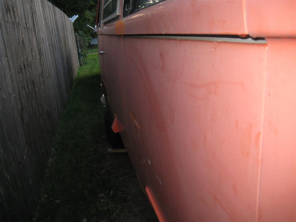

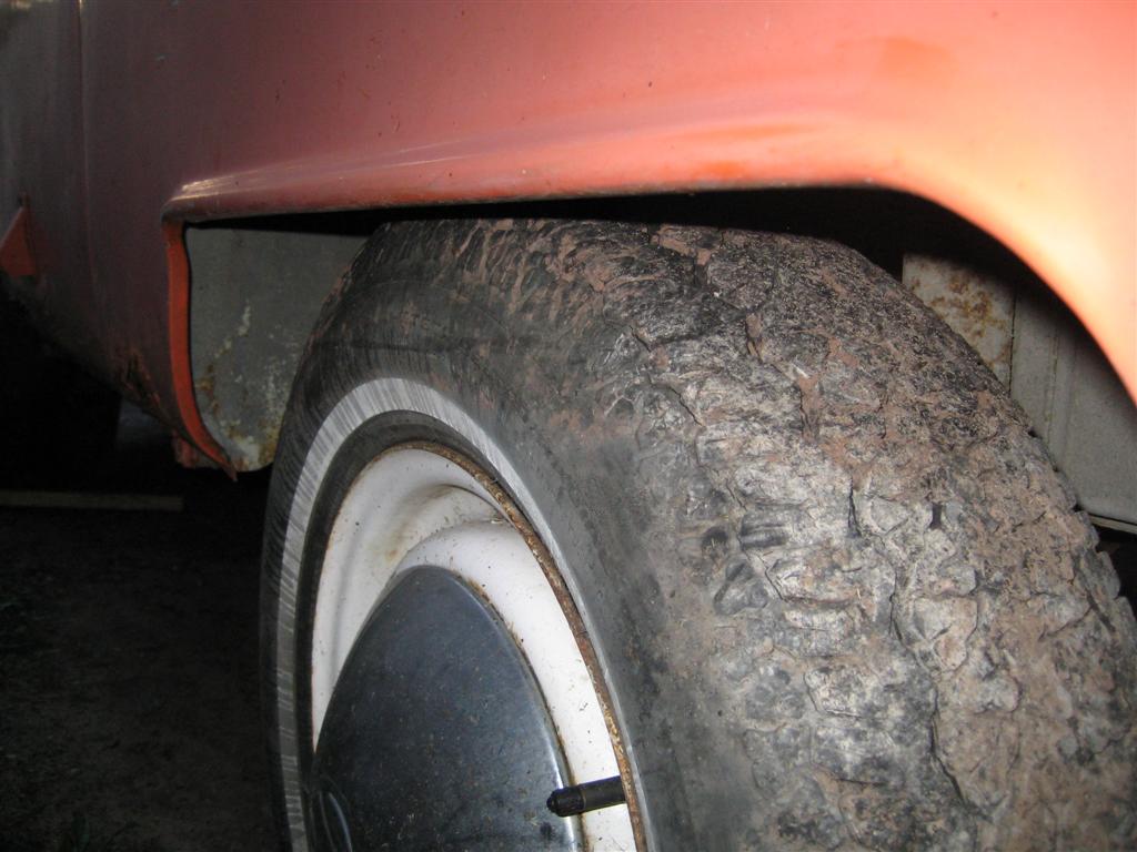

Sorry about the dark pic, but this is the only one showing the big dent in the front. The spare tire must have hit a tree or somthing. Then the PO tried pulling in out then added 1/4 - 1/2 of bondo!
It is pretty straight. I hope I don't find too much bondo, I think most of the previous body work was where there was minor accidents. The brushed paint job has see better days. I will have to get a nice coat of paint on her asap. I have a ton to do before that though.
I was impressed by the solid oe fenders and dry undercarriage. Very Happy

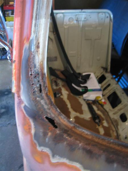

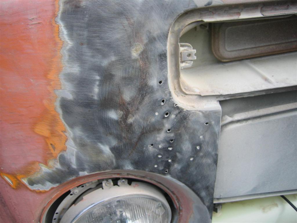

I found a donor nose for a great price, and will be using some of the metal and other odds and ends.
From my forums searches, are my only options for metal repair under the windshield a full nose, the 3 piece from Schofeild, or fabricated peices? I'm concerned that the 3 piece will not be big enough for the area that needs repair. I may be able to cut some solid pieces from the donor nose though.
The inside had no bad suprises. All nicely painted. Smile
I knew I was in trouble once the wire wheel hit bondo. Mad
See what I mean, how the rust traveled away from the windshield lip? I could have just bought a complete nose, but I heard how expensive the shipping was on top of the purchase price. Well, This will keep me busy this winter.
My donor nose. I'll be keeping this for other possible areas, like above the passenger headlight seen above. Anyone local need a nice front bumper from the donor? (on the house)

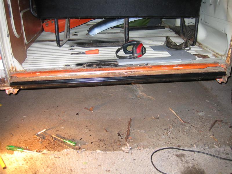

I recieved some body panels this week, so I started to get them fitted. I worked mainly on the lower rocker under the slider, then started on the panel in front of the rear tire.
Behind the rocker was in okay shape. It will just need a couple small patches. I will be coating everything behind the rocker with MasterSeries rust coater.
Here I just test fit the panel. Not ready for welds yet.
I'm anxious to patch up this big hole. The panel is on backorder from Bus Depot till December Sad Well, like I don't have enough other things to keep me busy.
