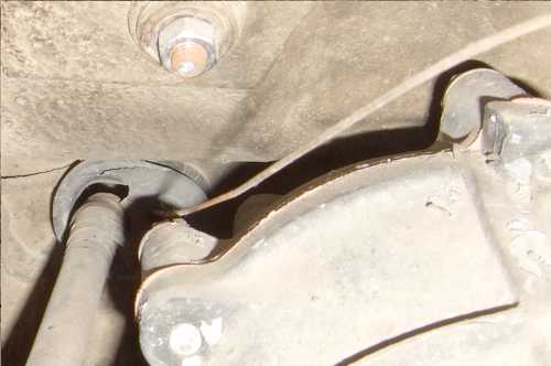

Am I correct in assuming that the accelerator cable should just rub across the transaxle between the tunnel and the back of the fan shroud in this year? Can I adapt a later cable conduit to this car so the pedal will depress a bit more easily?

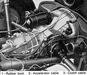

The later style tubes were used with the stranded style cables, I think I tried one once on my 62 but couldn't get it to work good. But then again, on my 62 the cable doesn't rub. (although I've seen customer cars where it did, even seen grooves worn from the cable)
factory photo:
My 62 and my 61-body/66frame Baja, neither rub. (looks like I need new rubber boots on both of mine though)

Well, I guess it's on my car (a '62), but it's for '66 and later cars..
http://www.wolfsburgwest.com/cart/DetailsList.cfm?ID=131721551
It's the Accelerator Cable bowden tube as displayed in this page from WWest
Note the flared end nearest the bottom of the picture.. This will mate up with the tube that goes through the fan shroud.
close up..
