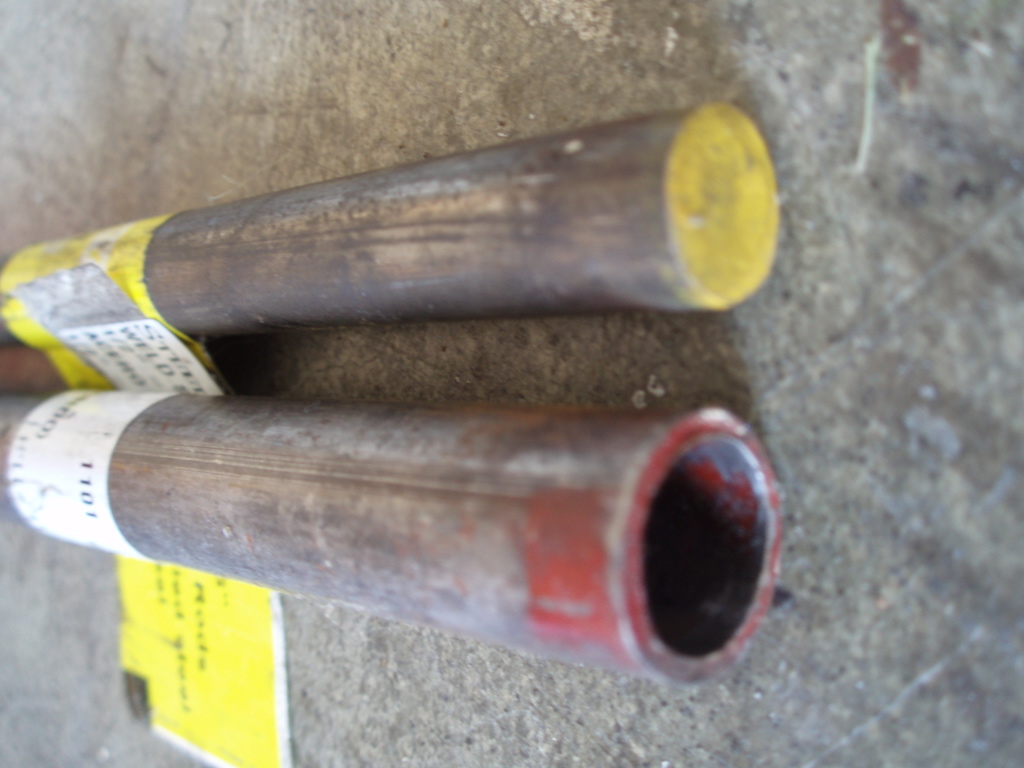

The telescoping pieces are made from 3/8 steel rod (you need 36 inches) that will slide into 1/2 steel tubing (you need 11 inches). These I got from Lowes. Cut the 36 inch solid rod into 4 equal 9 inch sections and make sure you clean and bevel each end. The hollow tubing will need to be cut into 4 equal sections each 2.75 inches long. Make sure the tubing slides easily over each rod...................

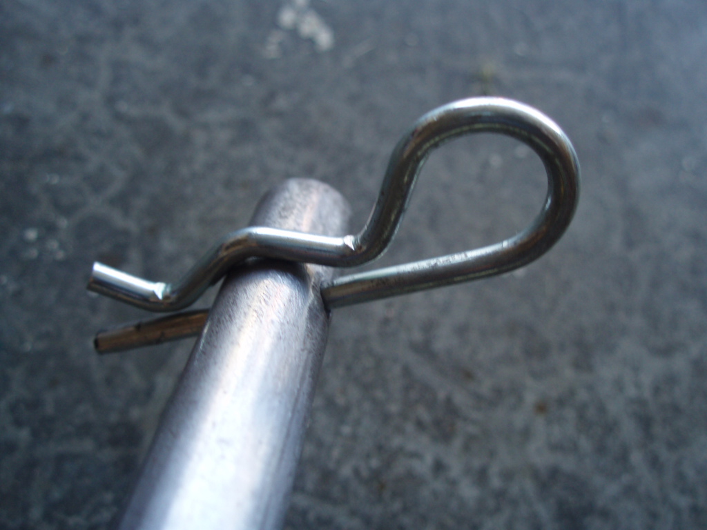

While at the hardware store, pick up a small 12X12in sheet of 1/16 in thick sheet metal for the gussets that will hold the hollow tubing. You will also need 2 of these clips to hold the assembly in the open and close position...........

This is what I do. When I park at night I pull the two pins and close up the deck lid. This keeps overnight rain, squirrels and other crap out of there. During the summer months, I pop it back open before I go to work and leave it that way all day as long as I know its not going to rain. If it rains unexpectedly, two pins and its down. During the winter, I leave it closed up all the time as the extra cool air is not needed.
It was just made to get rid of, what I considered, the hassle of installing/removing those aluminum stand offs which required aligning the deck lid each time.
