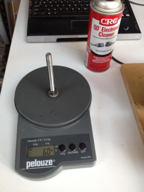

If anyone tries this and they screw it up the damage is on them. DO NOT as some threads and forums suggest move the board or bend the wiper to get a better contact. Replace the AFM if the board is worn thru or the wiper bad. You can clean it with a high quality electronic cleaner designed to quiet potentiometers. Do not seal the door with regular RTV - it gives off acidic fumes that can damage electronic equipment. Use special alcohol based RTV if possible.
With the AFM out of the car make sure the door swings freely and smoothly. Set the door so it barely opens about the thickness of a piece of paper with a weight on the edge of between 59 and 61 grams. Then leave the spring adjustment alone. You will not reset it again.
Warm the engine to at least 180F oil temp. Make sure your timing is set per TheSamba specs to 30 degrees BTDC at 3500 RPM with the hoses disconnected. Put the hoses back on when done. Make sure you have no vacuum or exhaust leaks. Hook up your meter so that it cannot have any dilution from air outside the exhaust. Make sure the EGR is functional if you have one hooked up. The EGR tube in the plenum must be clean and not coked up. Your injectors must be clean and have good spray patterns.
Set the wiper so it gives you 14.7 to 15.0 with no load at 2000 - 2500 RPM.
Set the idle mixture to 13.9 - 14.1
Check the mixture at 2000 - 2500 again.
Do these steps several times until the numbers are stable.
Take it out on the freeway at 65 mph flat. The A/F mixture should be low thirteens like 13.1:1 13.3:1. Speed up to WOT and it should drop to around 12.5:1. If you are too rich or too lean from these numbers use the slider to adjust it until you get to them.
Drive down the street, flat and level in 2nd gear holding 25 MPH. The mixture should read about 14.7 - 15.0:1. Speed up to 35 mph in 3rd gear. The mixture should be about 14.7:1 - 14.8:1.
Please note - max power is about 13.5:1 to 14.5:1 however you will overheat the heads if you set the AFM to this at WOT.
It took me two years to figure these things out and numerous AFM's including rebuilt ones. Colin spent years perfecting it too. My suggestion is, and it stands that working on an AFM is the most dangerous thing one can do to their engine other than perhaps trying to time an engine by ear. I would suggest hiring Colin to do this for you rather than taking a risk with your bus engine. All other things must be correct or one is adjusting the AFM to hide other problems.

Thanks SO much SGKent (and Colin) for taking the time to do these things.
After reading this post, I had to set up and check out some AFMs.
One came from my bus, and it was screwed down much tighter than your spec.
The other two were an OG Bosch (made in France(!?)),
and a rebuild from RAM products in Northvale NJ.
These two appeared to have never been opened, so I pry, pry, pried them open! Very Happy
before monkeymonkey-ing with the cog wheel,
I tested the 60g rod on them.
Both were the same in that they opened the door about 1/4 inch from closed, measured at the far edge where it would sit at rest.
The RAM one didn't close to seal, and had a bypass hole drilled in it, so it was probably junk.
One can guess that the spring would lose a bit of tension after 35 or so years, so this all seems right on track with the 60g spec.
So, should i give it a good hosing down with that spray in the picture?
It's pretty dusty in there.

lots of good questions. I don't know about the dielectric grease. I used just electronic contact cleaner that I got at Fry's a high end product to wipe the board. I used light compressed air to blow out the insides and made sure the 4 screws were firm but not so tight they would break the board. I used a special Electronic RTV to seal it but GE Silicone II is supposed to be better than automotive RTV if you can't find or afford the electronic kind.

I put the AFM on the bench and tested it for spring tension.
121 grams when measured at the edge of the flapper door as SGKent shows above.

121 grams is really stiff. You may have a bad TSII and someone compensated by leaning the AFM.
Re- L-jet
Rule 1) ECU controls how much fuel gets sprayed by how long the injectors are open and when. All 4 fire together. FPR controls fuel pressure based on manifold vs ambient pressure.
Rule 2) Pulse from coil tells ECU how often to spray fuel. RPM and pulse width set baseline.
Rule 3) ECU never subtracts fuel - it only adds to the baseline based on input from TSI, TSII, AFM and O2.
This is all in the Probst book on Bosch FI systems including L-jet.
You are essentially telling the ECU not to add fuel by tightening up that door. That implies the ECU is getting signals from somewhere else to go rich. Most common culprit is the TSII. TSI is in the AFM. TSII is on the 3-4 head.

TSII and TSI both tested perfect.
Seriously, i spent almost three days on this.
Been collecting L-Jet FI parts for 15? (!) years now.
It all came down to tightening that dang spring.
My other AFM behaves the same at the same setting.
WOT switch, you can see it on the LM-1.
You can hear it, too.
One if the reasons i converted to the 79 CA set-up.
VW went back to it. Might say something about it?
Jake said you needed to tweak the flapper door spring to get his combo to run right at cruise.
If his set-up is more efficient, it stands to reason that it would be moving more air, and burning it, and needing less fuel.
Right?
I'm super stoked to see this method with the weight on the door.
Everybody just says how the AFM is this mysterious device to be left alone.
Regardless of what is happening, the cruise AFM is right.
And the CHT numbers are super cool.
If something is wrong, hopefully it won't 'fix itself' in the next 10 days.
