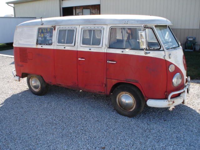

Like vws. Never had air-cooled. Did have TDI Beetle. Love the volksrods and slammed busses. Not practical for me. Found sweet 67' splitty behind a barn. One woman owned. Had new engine in 86. Parked on blocks in 88. Solid floors and crossmembers. Good glass. Most of trim is there. Can grab generator and move engine over a few degrees. Fan area still full of pack rat nest. How do I open it up to clean? Do I need to remove engine to get the fuel tank out?
Plan is to repair body panels. Repaint flat red/white. Remove rotted camper interior. Build my own bunk/camping area. Remove hubcaps. Install all-terrains. Go camping.
Anyway, I am excited. Here are some pics.

Nice find - looks pretty solid. Is that silver metalflake vinyl on the front seats?

Nice find, and welcome!. I'd give it a super deep cleaning in and out before deciding to tear/throw anything out. Patterns and such. Cool

Nice find. First off, it is probably best to pull the motor to get rid of all the critters that might have been hiding in there. Yes, you do need to pull the motor to get the gas tank out. Be careful when removing as the necks can sometimes be weak. I replaced my old gunked up tank with one from Wolfsburg West.
If you get to the point that you have a bad urine smell from the rodents.....Go to Petsmart and get Natures Miracle, Urine Destroyer. My bus had a bunch of mice nests and it was the only thing that got rid of the smell.
Keep the pictures coming.
Good Luck.

If that's OG paint, save it. Don't repaint it.

Pull the engine, take all the tin off, clean all the crap out of the cylinder tins, shroud and oil cooler. Might be a good time to toss some new oil cooler seals on there - it's easy.

It's not original, but the titan red underneath looks easily accessible under that respray. Check the forums for paint removal/og paint. Do a little searching, researching, and reading before deciding to toss that camper interior. Nice find. Good luck.

Nice find. I wouldn't be so fast to chuck that camper set up. Looks like an original period american camper conversion. Maybe a Riviera? Anyone?

Pretty sure it's not original paint. Cool find, though.

Don't be in a hurry to toss that camper interior (post more shots of that interior and the Alabama Camper tag), clean up everything first, get rid of rodents and any other occupants, buy brand new quality brand wheel cylinders (6) and master cylinder, new rubber hoses (4) and brake shoe set (front and rear set) from a reputable source like Wolfsburg West, etc. and read up and install those first! Make sure the Bus can STOP before it GOES! Order new braided German fuel line, a fuel pump rebuild gasket kit (read up on how to properly rebuilt this), clean up or replace your tank, pull the motor and clean out the rodent debris as mentioned earlier. Buy new correct points(for your particular model of distributor, condenser, new ignition/spark plug wire set, and probably a new battery.
Nice Bus, you're gonna have fun in that! Bring it to the BNNTA camping event next Sept for us all to see!

those wooden valances for the cargo door curtains totally kick ass
not a fan of the period paneling though
nice layout very unique just freshen it up
take your time, don't trash anything, read all the faq's
