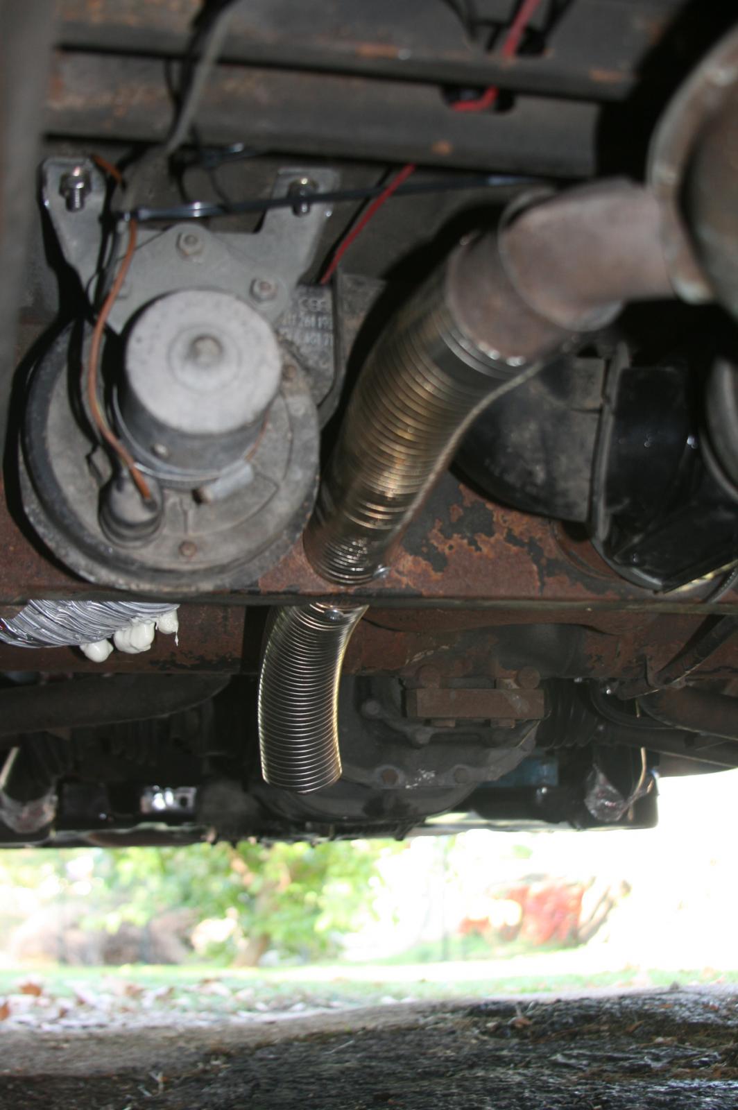

I picked up 3 complete BA6s at the junkyard over the summer for $20 each and I decided to install one of them. My bus didn't come with one originally, so I had to get creative with installing it. Below are some pics of my install. If you have any questions or need more clear photos, let me know. Also of note: I know my bus is not very clean and some parts are rusty, I'm working on that. It was used as a work vehicle for some 10 years and now it needs some TLC.

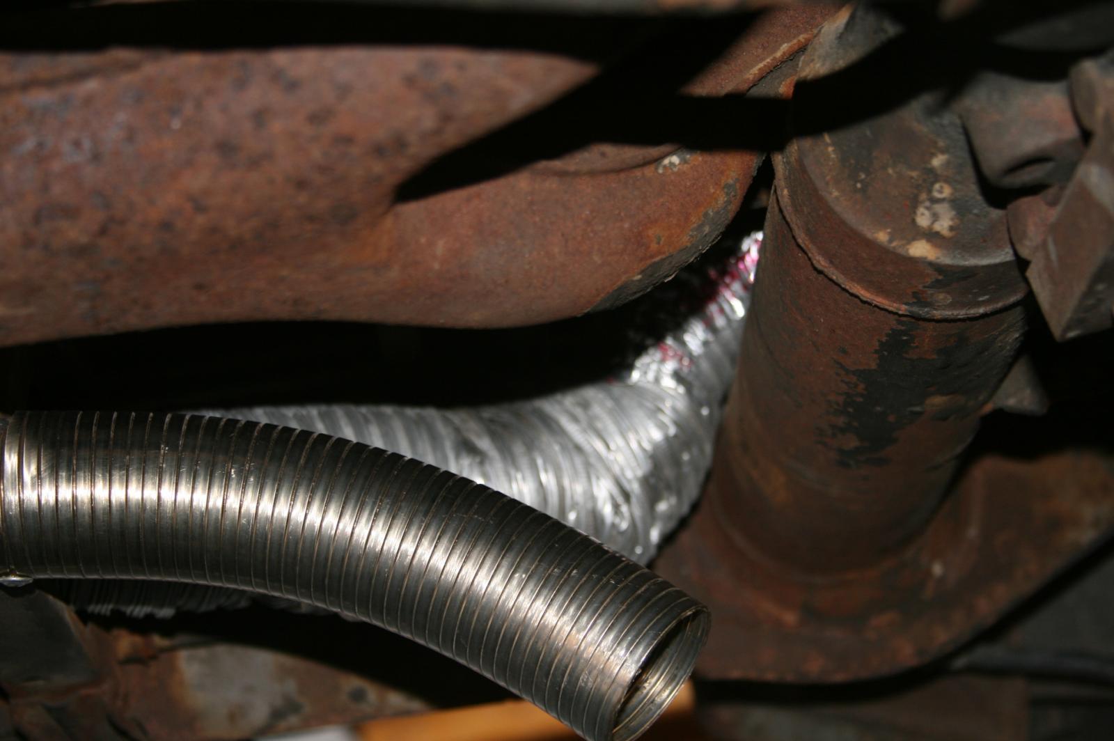

Here you can see my exhaust solution as well as how I mounted the recirculating fan. I used an extra mount for the fan that goes above the engine and I mounted the fan to the floor with some stainless steel round hex key bolts. The exhaust works well, it only cost $12. It is 1 7/8 stainless steel exhaust repair kit from Auto Junk. In between the crossmember is a 1 7/8 connecter. I ran some sheet metal screws up into the pipes to keep it secure. I have a NOS exaust pipe in my basement. When I get some more dough I'll probably get an 'L' piece made and use it.
Here you can see my recirculating duct (blurry in the background). I used a piece of 3 1/2" aluminum dryer vent tube and had to crush it a little to get past the suspension part.

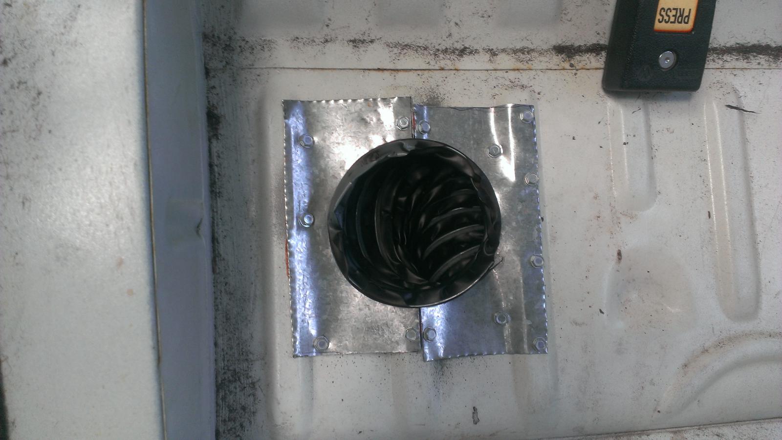

I took a piece of galvanized metal from a stove pipe and cut it to the right size and put it through the hole I made. The aluminum duct attaches to the other end with heavy duty foil tape.

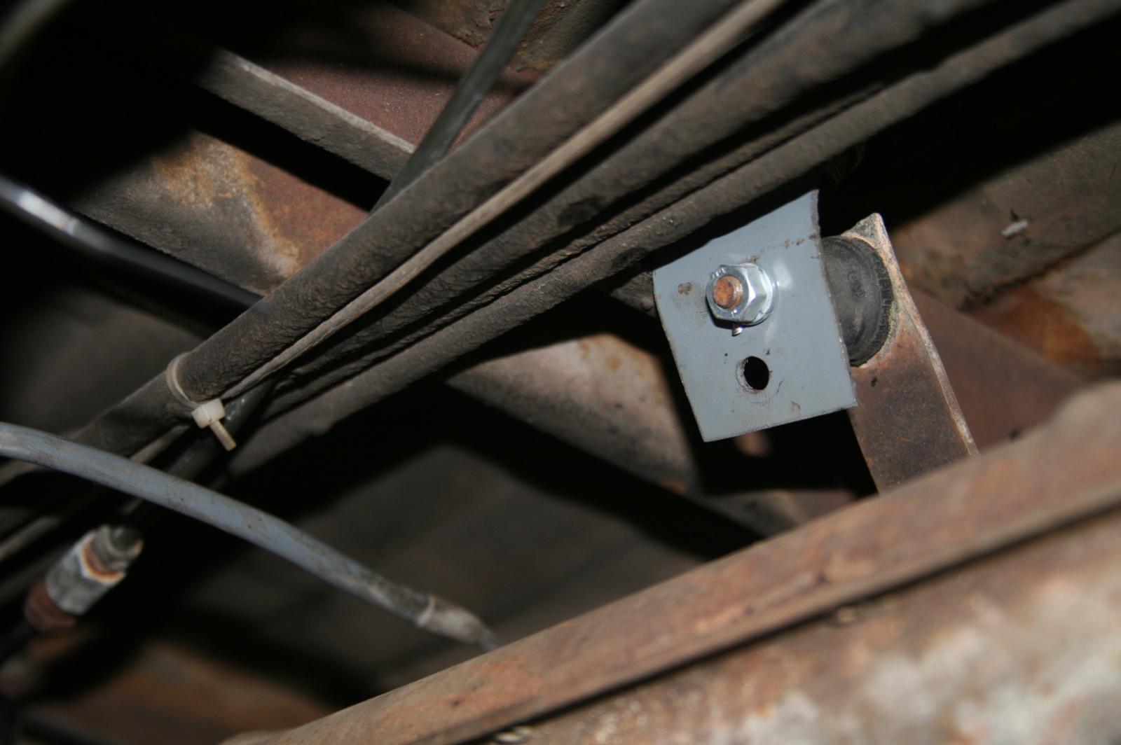

I made brackets out of some sheet metal that I was originally going to weld in, but I decided to bolt them in instead in case I ever want to take the heater out.
On this one the heater was too low so I drilled another hole and moved it up.

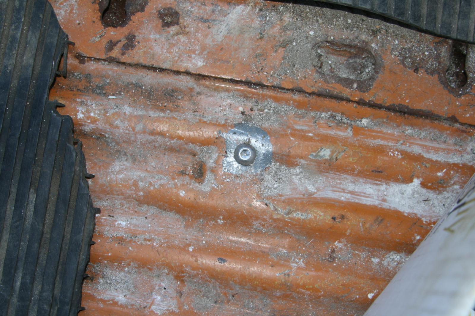

This is what you see on the top side of the floor. You can't hardly tell they are there.

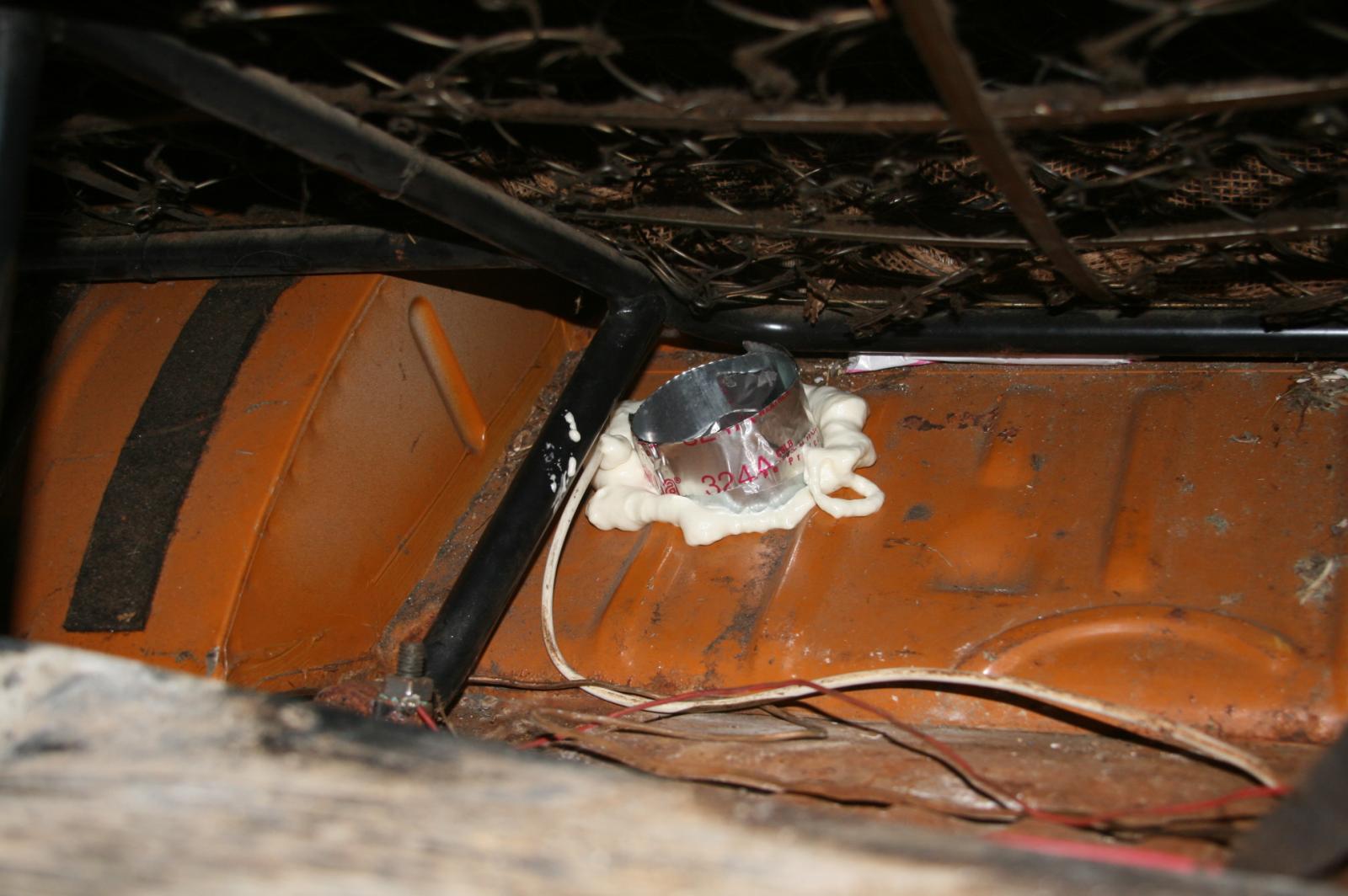

To install the temp sensor I used a 1 1/8 hole saw to cut a hole in this piece of duct. Then I fashioned a small piece of metal with a notch in it for the sensor and JB welded it on.

It works great. I'll post some temperature readings when I get a working thermometer.

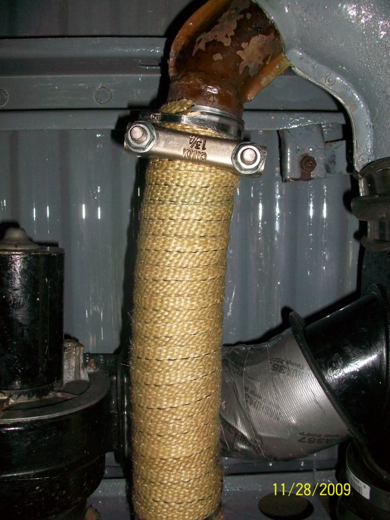

I wrapped my exhaust to try and not fry that hard to find (wait, you have 2 extra!) rubber duct square on one end and round on the other.

Excellent idea. That rubber duct concerned me as well, but i noticed that right after running it, it wasn't that hot. Maybe because the rubber is so thick and its probably vulcanized too. VW wasn't concerned about it it seems. I will probably wrap it anyway.

Your rubber mounting grommets look in good shape. Were they original? If not, where did you source them from?

Yep they are original. I had 9 of them to choose from because I got 3 heaters, so I chose the best 3.

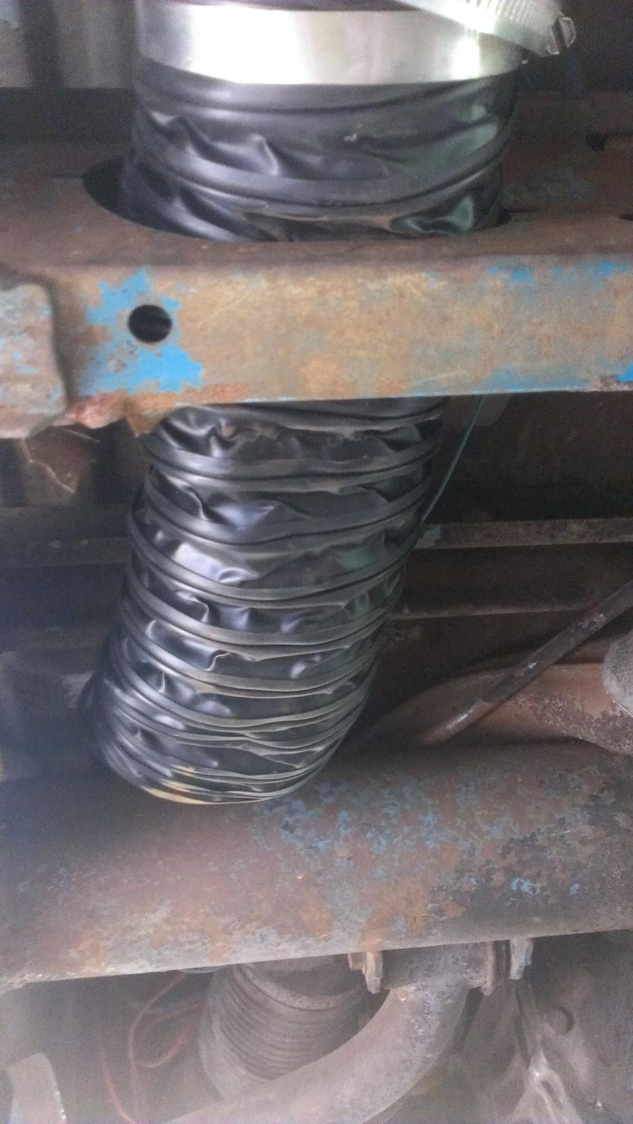

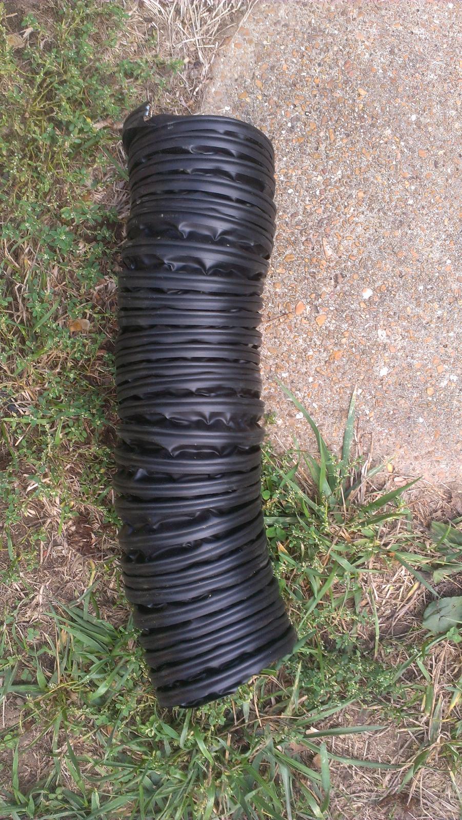

Well I am installing another gas heater in another bus. The aluminum dryer duct did not work out so well on the other bus because it got little holes in it while installing it and then it sucked in some exhaust fumes from the heater and that kinda wasn't so great. Not only that, but for the life of me I couldn't find 3 1/2 inch aluminum duct anywhere this time around.
So after hours of searching on the internet for some 3 1/2 inch duct hose I finally stumbled upon Gates 23856. This stuff is awesome and perfect for this application. The rubber is tough, and the ribs are made of a stiff but soft metal band that is easily bendable.
It fits like a glove up under the torsion tube and can easily be made round again. Also it goes perfectly onto the opening of the recirculating fan with a nice tight fit. Best of all, I found it on amazon for $6.00. 6 feet for $6. I don't know if that price will last as a lot of them I see for sale are around $30.00.
I also came up with a more professional solution for mounting it in the body. I cut a round hole in the body 3 3/4" in size, pulled the hose through, then took a square of galvanized metal and cut a circle 3 1/2" in size and then cut it in half. I then put silicone on the back side of it to seal it to the body and then took the 2 halves and 'clamped' them around the hose and then zip screwed the metal to the body.
All I have to do now is run a bead of caulk around the hose to really seal it up and then fashion a hood to cover it so bits from the seat above don't fall in. I'm very pleased with it though.
