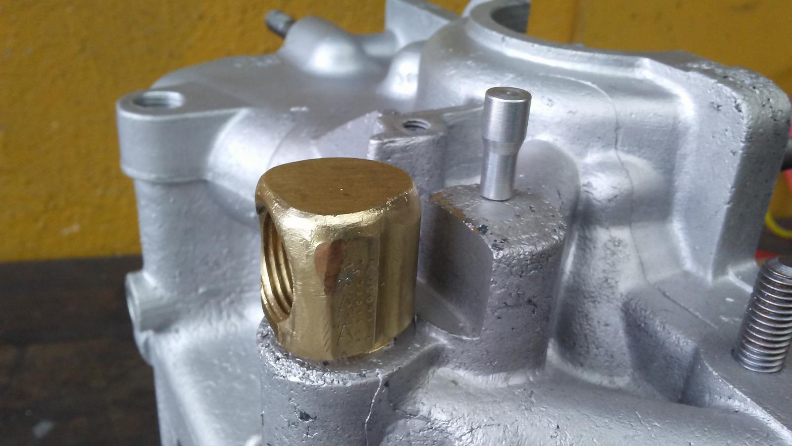

His stamp was on it - .020 on the mains, indeed a fresh line-bore so many years ago. Dancing
I had him braze on a pickup tube extension,
and open up for some 90.5s.

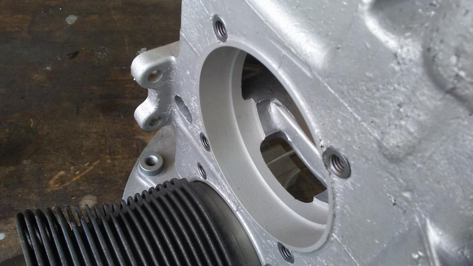

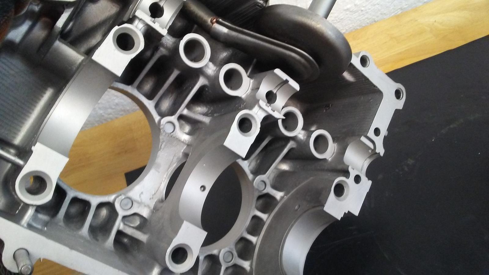

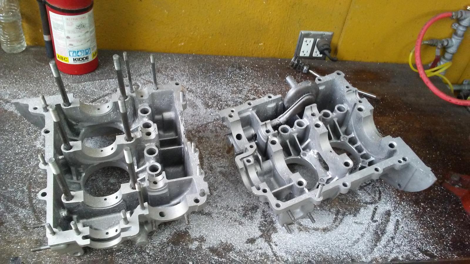

Because the case was so very crusty, especially inside,
And,
My friend William told me about a guy in nearby Watsonville who just geared up to do vapor-blast..
Figured I'd try the guy out and see.
No big risk doing a 'junk' case, right?
They got the inside clean, which was the most important part.
There was a ton of crust and crap, dirt, etc. loose in there.
At $250, this was by far the most expensive part of the build..

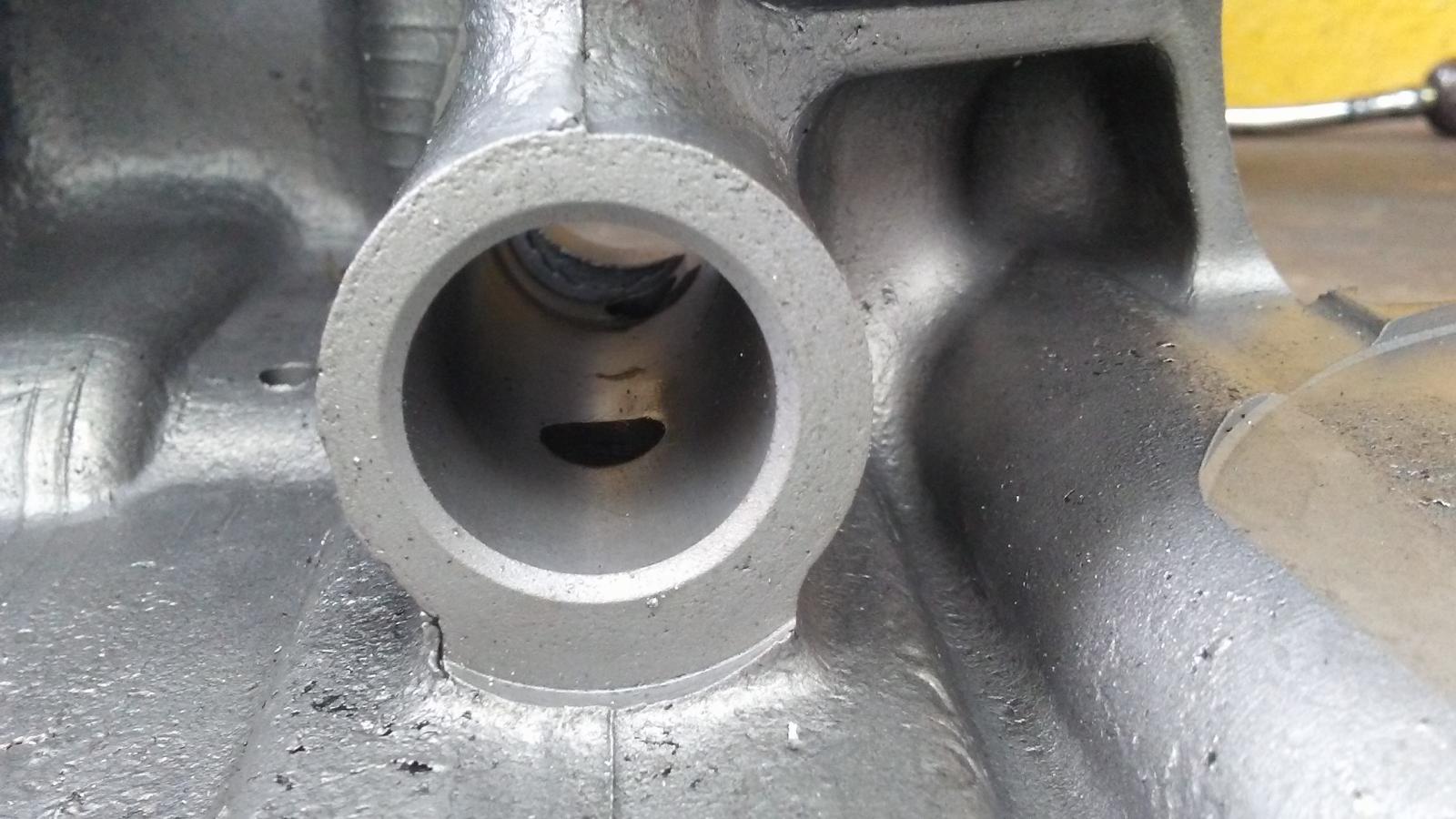

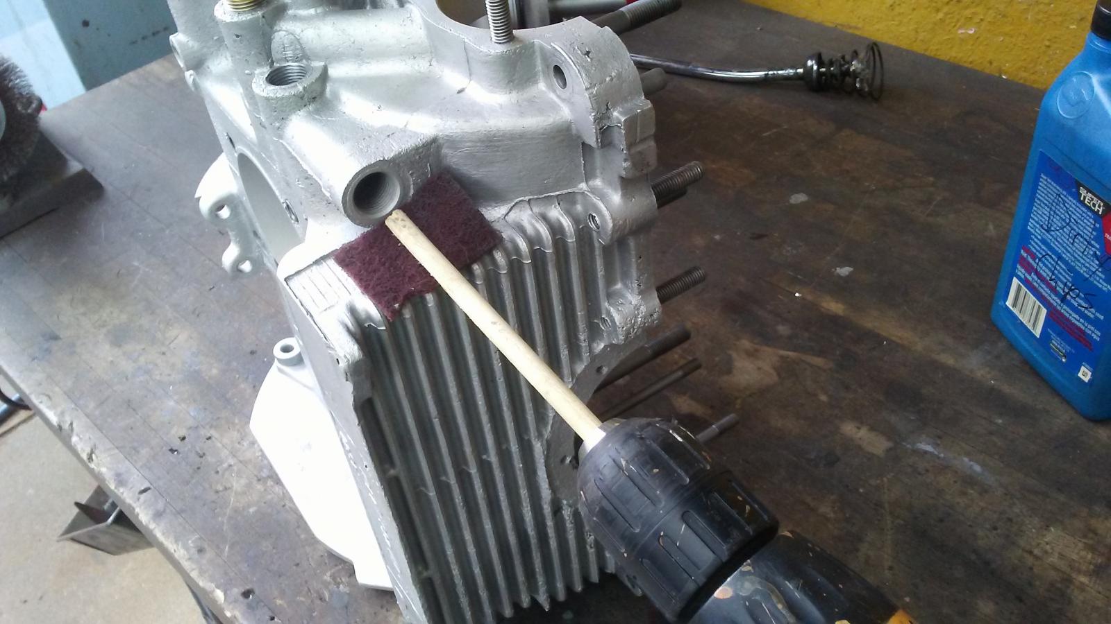

I'm also in the process of restoring the bottom of the case - the sump plate area.
Because this thing sat in the mud for several years,
There was some pretty good corrosion going.
I'm only started in on this, and the pookie is drying as we speak,
but here's how it starts:
Bottom of sump plate is all eroded away.
First, the M6 studs are all removed,
And a sort of 'form' is made using some gorilla tape.
JB Weld (or in this case a Devcon copy) is 'flowed' into all of the crevices/pits.
The stuff is relatively liquid at first,
So it levels out and sinks in;
Trying to prop up the case with the bottom plate almost perfectly level; to get it to lay flat as it hardens.
It soaks in, and gets low in spots,
So follow-up applications are done, to get it all 'high', so it can be sanded down.
I also took a small pointy X-Acto knife and dug the stuff out of the stud holes,
While it was about 3/4 set up,
So it wouldn't be a PITA and in the way once hardened.

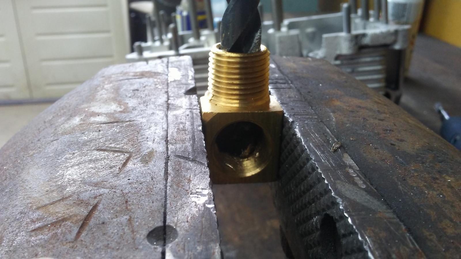

Also had my kid help me tap some galley plugs..
More in days to come..

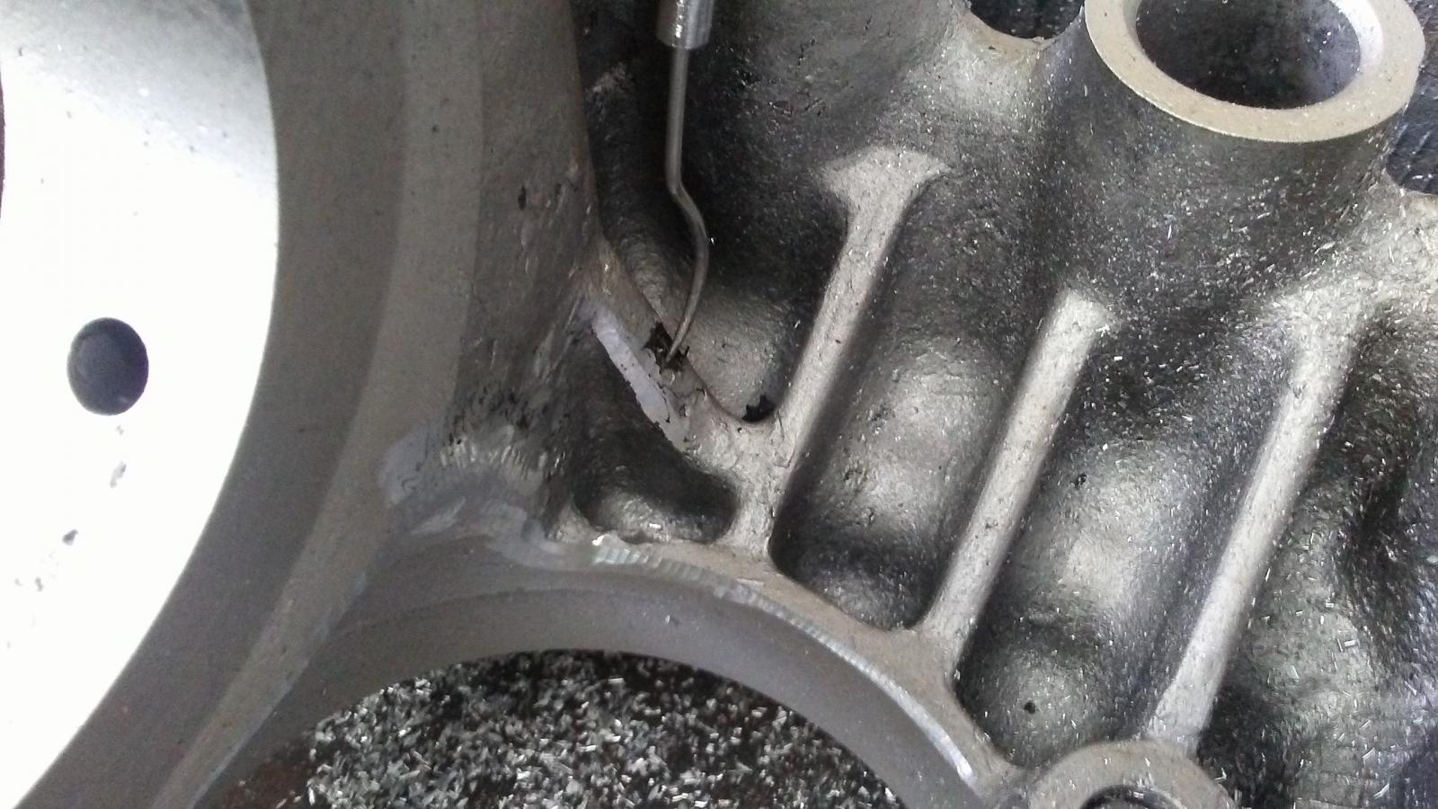

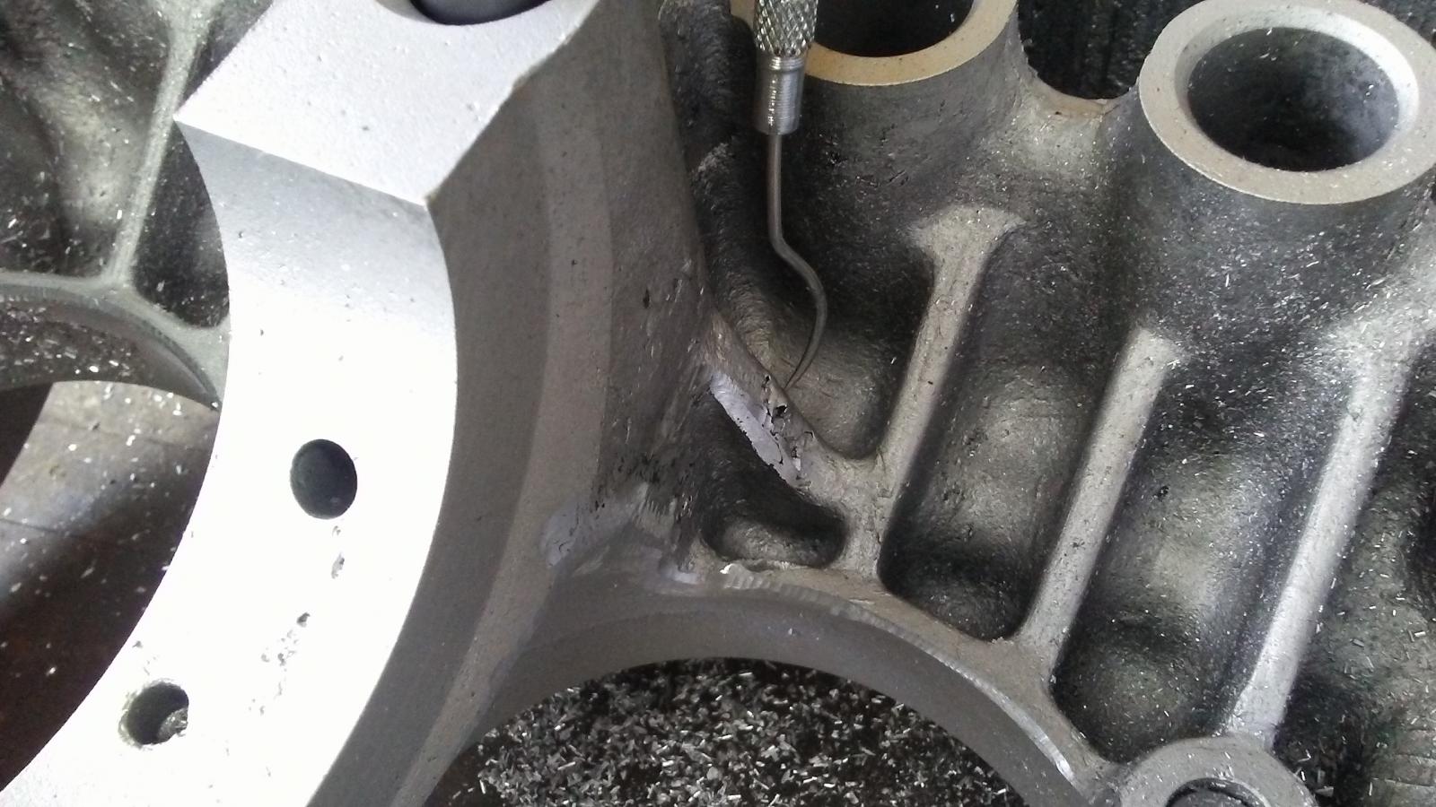

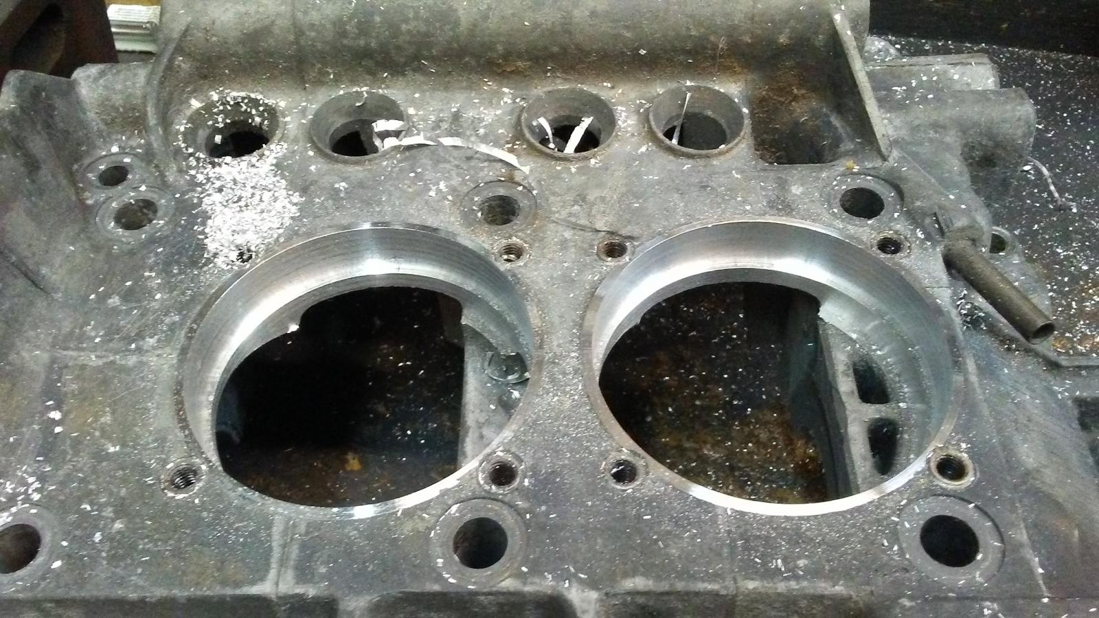

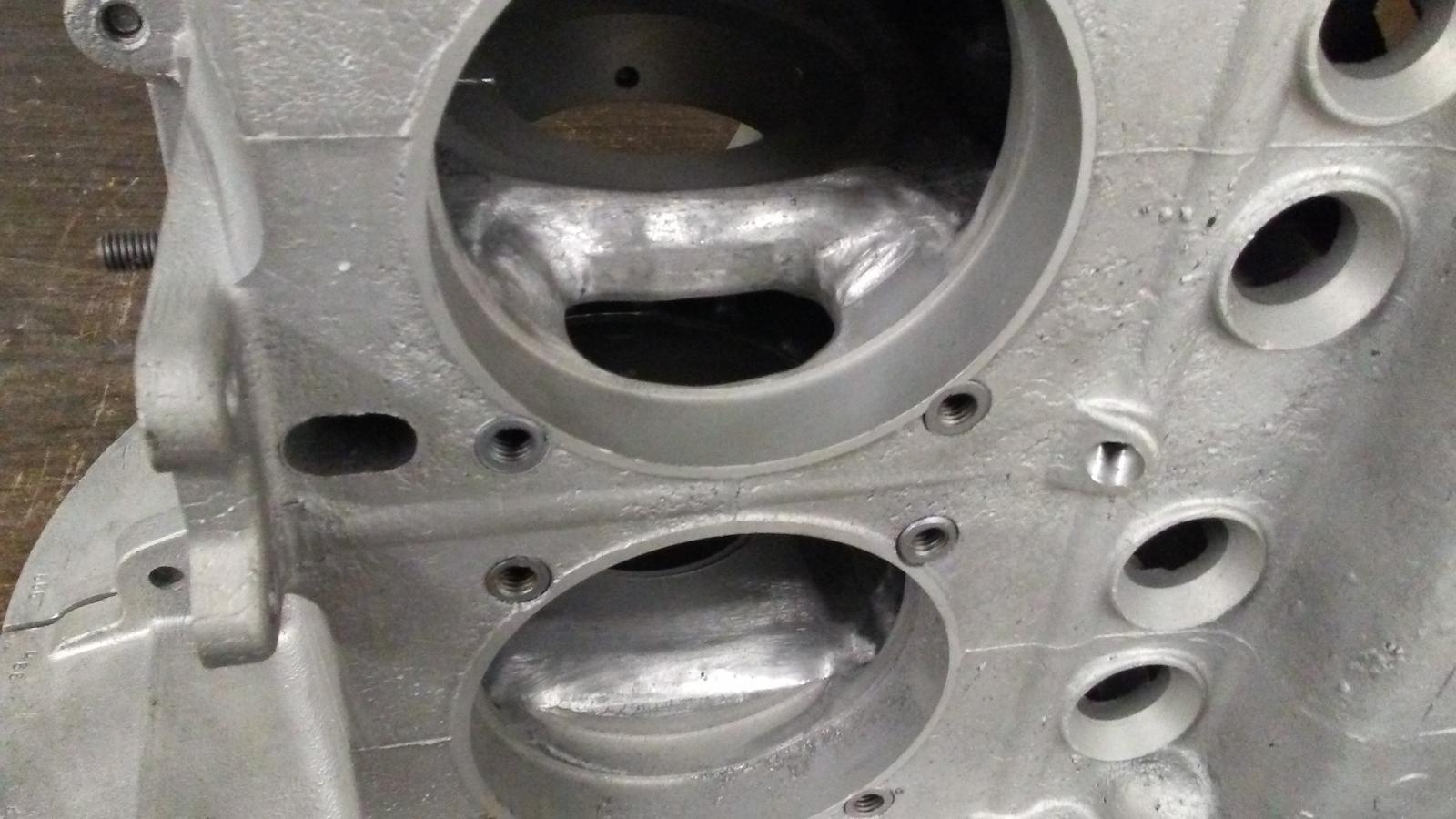

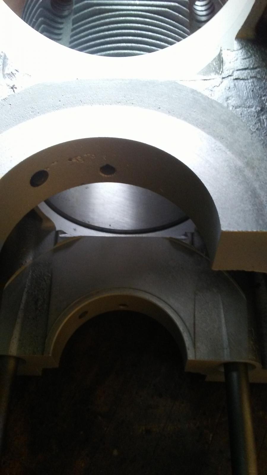

jpaull wrote:
Nice job on the case!
When you set up the case on the mill are you using just the mating surface? I have a similar mill and curious on set up.

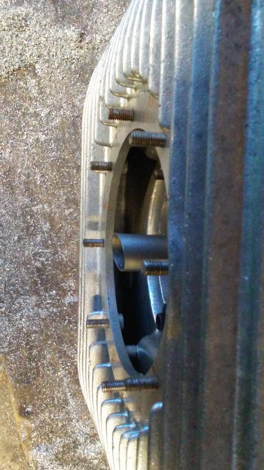

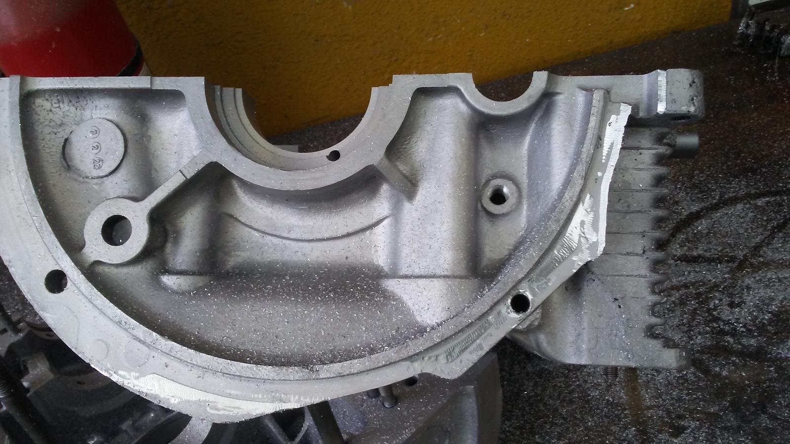

OK,
Glad you asked.
That's Jim's set-up, but I will answer what I know about it.
You will see that he is using a fixture to mount the case to the table.
It's something he had made years ago; a precision-ground big 'box' with open ends.
It is deep enough that the case-half studs clear the table, and the right size that it supports the case well at the parting flange.
He is indeed measuring off of the parting flange.
Any variation (error) on the part of mother VW between crank bore centerline, and case centerline, will have to be dealt with in other ways.
Sometimes they got it dead nuts, other times it's a few thou.
Never had it so bad that juggling rods, pistons, and cylinders won't solve the issue.. There's always a few thou to be found here and there, especially nowadays.
See also that his hold-down allows quick/easy change, for switching the other case half into place..
Also note the number of flycutters for the different operations,
And their heft/girth.
All part of the way he gets that beautiful chatter-free finish..
Something else to note, is how he left material at the bottom of the cylinder spigot.
He wants an example of every cylinder in-hand to fit the depth of the main plunge cut.
So much variation in these numbers these days..
Notice that the clearance for the 'sleeve' (?) at the bottom of the cylinder stops at the right depth, and there is a 'step' where the material below the cylinder is retained,
And the meat is left in the case as much as possible.
I have seen other people's open-ups where not so much care was taken,
And another operation was not done,
And the cut goes all the way down,
Not retaining as much material in the case.
The case-savers have been clearanced well below the deck surface cut.
Well below..
I had hell with some 94s here, done by another shop, because they cut the case-savers with the same pass/cut as the deck.
They were flush as a result..
What ends up happening, especially with 94s,
is that there is some 'deflection' or 'stretch' when the head studs are tightened.
The case savers are drawn towards the heads just a bit,
And then the cylinder base is now sitting on the case savers, and not the case deck itself.
I have also had case-savers turn a bit when tightened.
This all happens as the case is being final-assembled,
And there's sealant in the way so you don't see it,
And the tops of the cylinders are now not flush with each other,
And the heads leak,
And it sucks and blows big black donkey balls.
So make sure your case-savers are clearanced like Jim does here,
And not just cut flush with the deck like everyone else does..
I'll try and get more details on this op next time I'm there.
This guy has done thousands of motors,
Gets to pick his customers these days,
and is likely to retire soon. Crying or Very sad
I'm lucky to be able to get back there and see these things, and bug him with questions.

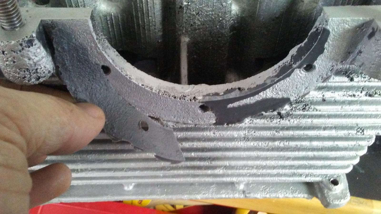

PostPosted: Mon Jan 15, 2018 9:29 am    Post subject: Re: Heater Beater 1776 Reply with quote
So much for my JB Weld experiment.. Rolling Eyes
I guess that's what I get for using JB Weld on anything, right? Laughing
It just peeled off by hand.
Maybe something to do with the 'peened' nature of wet blasting?
Might need to scuff for some tooth..
Also,
That JB Weld was an older tube that had been opened before.
Might not be fair to pass judgement if it was old and stiff/crappy.
Drat, that I had that pickup tube brazed on already!! Brick wall Brick wall Brick wall d'oh!
I coulda set-up an operation to just mill this all flat again..
Was also thinking of making a tube to hand-sand this all,
Or gluing sandpaper to the sump flange, and rocking it back and forth to sand,
or..?
There's a couple other of these rotten-bottom Type 1 cases here to be done the same,
And they aren't making new ones anymore,
So it looks like it might actually be worth tooling up to do these?
What has this world come to?
If I was on crack, this would all make sense why I was bothering with all of this..
Might just scuff it a bit,
And glue the sump on with some RTV, or maybe 518, and call it done..

Here's the obligatory 'flow enhancer' full-flow fitting mod;
A regular 90 brass pipe fitting from he hardware store becomes a super hi-po racing low-profile stealth performance part!! Dancing Dancing
Always learn something, every time I do another one of these motors, even still..
Look at the pic above
See that plug right next to the 90 fitting;
That tapered aluminum plug?
It goes ight there.
Jim just taught me this - that's a restrictor plug.
it keeps too much oil from flowing into the tiny #4 nose bearing(!) Exclamation
I had always drilled/tapped that sucker, and it seems that might just be a fool thing to do..
Apparently, it needs restricted.

After the tapping operations,
There are a couple of holes where burrs remain as a result.
Used a piece of Scotch-Brite on a slotted wooden dowel,
In the relief plug bore.
And also in the rear lifter bores..

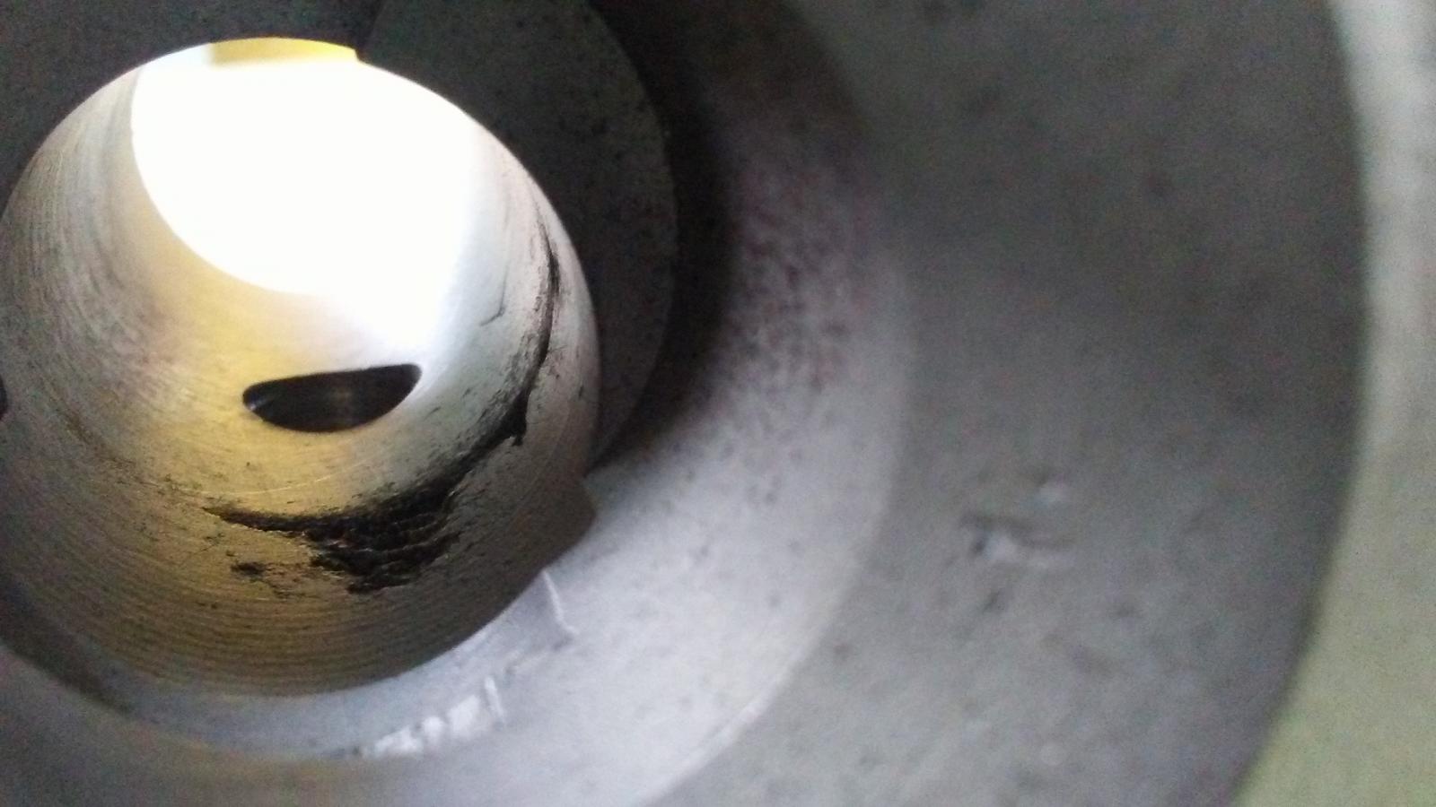

Check out the porosity (water damage?) I found in that lifter bore.
Lucky lucky it's not in a spot that matters.. Shocked
Here's another view of how Jim opened up my cylinder registers.
Check out how he leaves a step right at the bottom of the cylinder.. Cool
Next, I started in on opening up the 'windows' between the adjacent cylinders.
Especially with a counterweighted crank, this has to help.
Here is 'before', on the right, and 'started' on the left.
While the die-grinder was out, I chased down any burrs and casting flash.
These crappy mag type 1s even have flakes of material that can be picked loose..
A few hours later - (You could literally do this forever)..
For a 1776 with dual Kadrons, I'll call it plenty.

Here's another odd thing about this case..
Jim says this is common among off-roaders; the case/trans bolts are loose,
And the car goes over rough roads,
then the case 'frets' against the trans, wearing these grooves in it.
I took and smoothed out the edges of these grooves, in case my trans fits a little different.
Will hopefully prevent the grooves from not allowing the case to seat clear 'home'..
After die-grinding for hours, the parting surface could have gotten burred or nicked.
(Could have happened before, too).
So the cleanest/best of my files (lightly) chases and burrs or damage, to make the parting line flat.

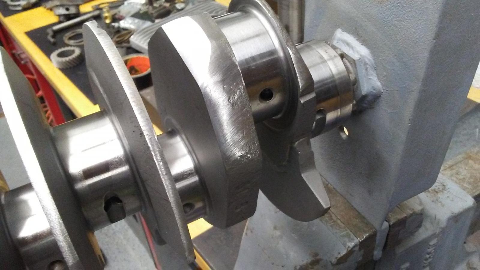

Here's another place I just cheaped out way too much..
Jose at DPR always used to have 10/10 balanced counterweight cranks at the Bug-O for $100-$125..
It's just too hard for an old cheapass like me to pay $250!
So I took the bait here: http://dprmachine.com/promotions/
And ended up here:
Embarassed Rolling Eyes
Even worse,
I spent almost double what the crank cost getting the whole ting spin-balanced at Ed's Crankshaft in Newark..
Look how they had to pile up the weld to get the (USA Kennedy) pressure plate in line.
Some of the crank webbing was shaved down:
Here, we have some factory (DPR?) balance drillings above,
And Ed's balance drillings below.
So,
A bunch of extensive/expensive spin-balance work,
For a crank that is on it's last trip thru here on earth.
All to save $100.. Rolling Eyes Rolling Eyes

found a good picture of Jim's ace open-up from the side.
Shows the case-saver relieve-ing..
Also an 'after' shot of case porting..
More to come later as this all gets cleaned up and sorted out.
