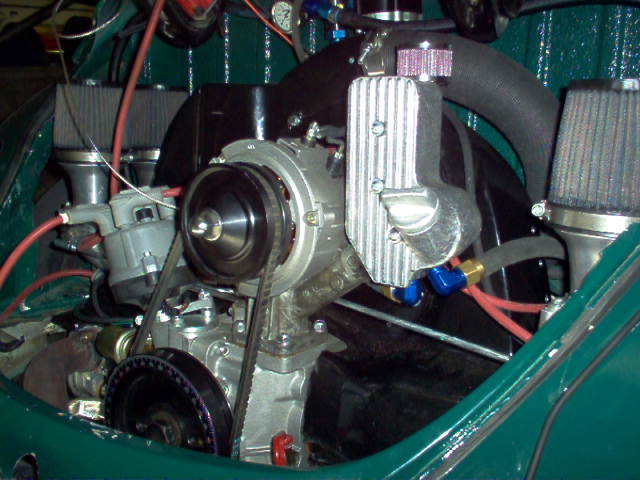

How is that CB breather. I hear that it is like the Berg breather except $150 less and doesn't look as cool. Does it come with inlets/ outlets? If so how many? I need a breather, and this is the first CB that I saw. Any info or additional pics you could give would be awesome.

PostPosted: Sat Oct 08, 2005 11:16 am    Post subject: Reply with quote
well i like it. it does the job and it internally baffeld. plus its a simple install. i did modify it for the larger #8 breather lines.

Thanks for all the replies everyone. I really like the look of the CB breather that attaches to the alternator stand. It looks a lot more like part of the engine, plus it keeps me from having to mount the box on the firewall. As long as it clears my linkage, I'll probably be going that way...

Yeah, I run one cheap EMPI box and also the CB unit. I like the CB box but it took about a week to make it stop leaking. I needed to use sealant along with the o-ring for the cover. Mine is on a 2276 with 10 to 1 compression.

I have a CB unit ready to put on, but I can't decide how I want to plumb it - physics suggest all lines should go above what the max level of oil is going to be, and unfortunately it's hard to know that. The top back hole seems like a good place to put a breather relief filter. THe gasket looks crappy too. Too bad they didn't opt for a channeled gasket or a full O-ring. This thing is like an O-ring sliced in half, so it is flat on one side, and radius on the other. Goofy.
