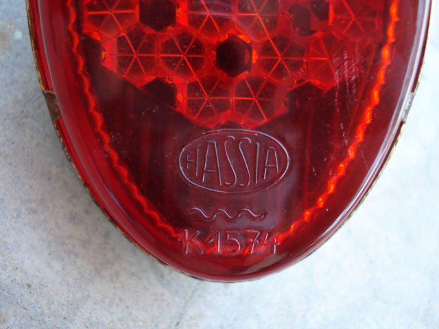

PostPosted: Wed Apr 09, 2008 4:12 pm    Post subject: Reply with quote
for the snowflakes, would hassia lens or hella be correct for a 55?
ITMC-El Presidente
OG 55 bullet 3 fold....
http://www.thesamba.com/vw/forum/viewtopic.php?t=150858&highlight=thebuckets++++fold
kafer53
Joined: July 24, 2004
Posts: 904
Location: Ontario, Canada
kafer53 is offline
PostPosted: Wed Apr 09, 2008 5:56 pm    Post subject: Reply with quote
They would both be correct. They were both period manufacturers of the glass lenses.
Is one less common than the other?
I'd say Hassia is less common but not 100% sure.
