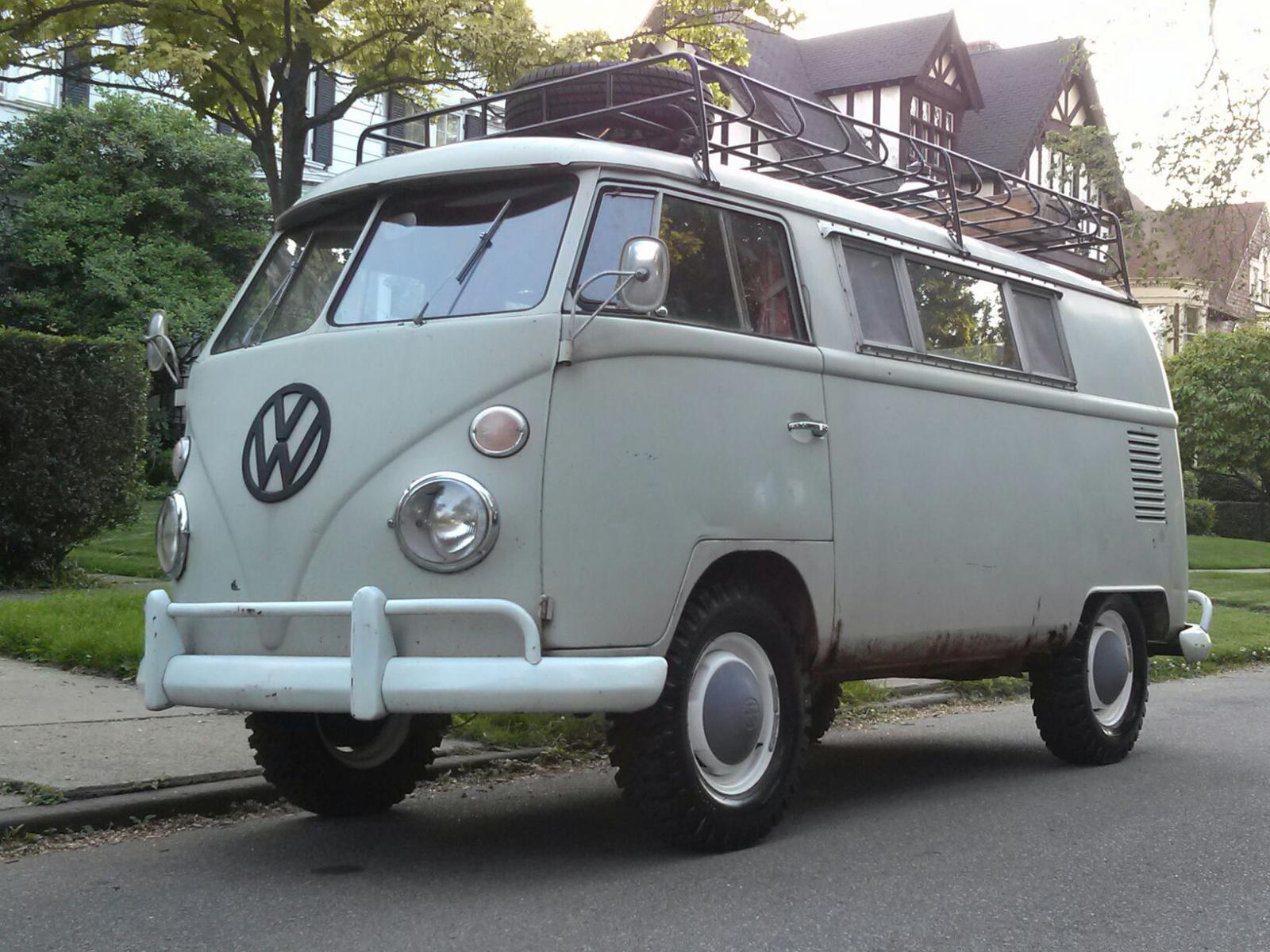

Good morning - Today is June 1st, my name is Pete and I thought I would share with you my latest travel adventure!
I quit my job in march, and decided to drive my bus to Alaska!
The bus had a few leaks, and a slow motor - so I took it all apart - and it's almost back together again! I'm leaving on Wednesday (Thursday at the latest) and in the spirit of a previous thread, I hope to arrive at the arctic circle in time for the summer solstice. (14 days driving - 270 miles per day)
I didn't want to start this thread until the bus was actually running - but I got the motor in and running last Thursday, so I feel like the trip will actually be a success!
Not much is left mechanically - Tightened up the front shocks, adjust the front wheel bearings, and possibly adjust the steering gear box - everything else is new or rebuilt. Not much should go wrong! Hah!
Here it is in the garage
I think this was just after the new front windows were installed.
Thanks for reading!

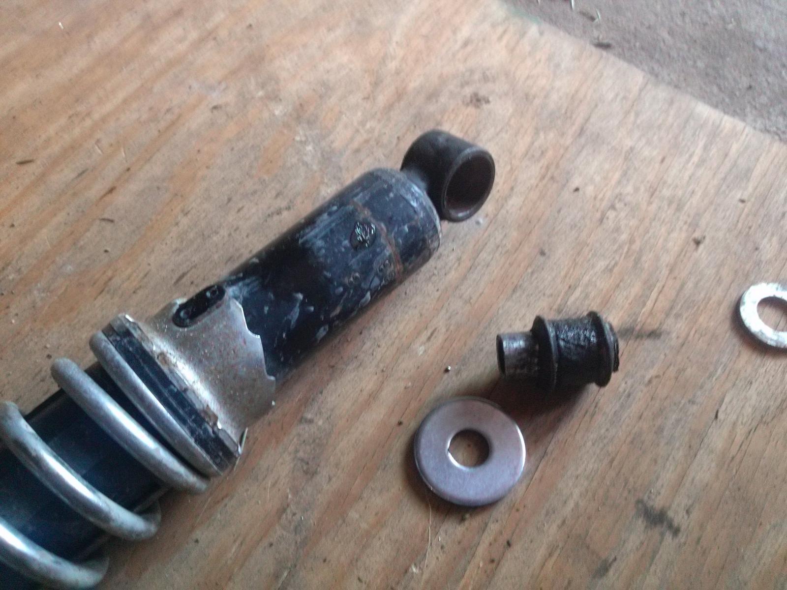

Here's the progress today -
One of the bushings came out of the coil over shock - so I reinstalled it with a proper washer. I shortened the shock bushing to get better shock alignment and I installed washers all around! I also tightened up the front wheel bearings and refit -the refrigerator cabinet -
these projects always take more time than you think - however we all know if we don't have time to do it right the first time....there's always time to do it over!!

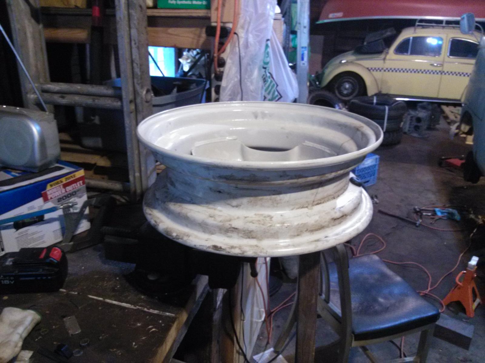

I was able to reclip the spare tire rims by myself with help from the proper tool and a 2x4 (thanks to Munk's motor) for the clip anvil tool!
Had the spares mounted - G78-15 Bias Ply - I may actually throw these on the front and use the snow tires for the rear - then have two more snow tires on top for spares.

I would not mix bias ply and radial tires unless in a pinch. I've never driven on bias plys but I cannot imagine they act the same as a radial.
