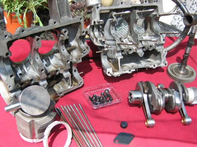

This build is for Tom Newport’s dune buggy to compete in the September 2012 USFRA (Utah Salt Flat Racing Association) AKA Bonneville Salt Flats speed trails. In 2011, we took Tom Newport along as part of the Bruch/Anderson race crew and the salt bug bit him badly.
Newport is modifying the buggy with a new roll bar assembly, lowering chassis, fuel system, gearing, etc and adding safety items. I’m building the motor (BvilleTom) to what we would ultimately aspire to be a crisp, strong street motor, not an all out hand grenade type, which would be a whole different animal as well as a large budget deal. I’ll try my best to get pictures of most everything. Some methods to my approach may seem different. However, my approach is old school and usually the reason is because it works and doesn’t cost an arm and a leg. I have been doing this successfully for a living as well as fun since the late 50’s.
This 36 HP case is a 1958 that was a very good factory rebuilt unit (A001122x) with major internal Windage modifications, boat-tailed webs, 8 oil drain back holes in lifter web area, general smoothing of all surfaces to help get the oil away from the crank and back down to the deep sump. The crankshaft is a 356 Porsche 74 mm modified by Ollie’s , Lake Havasu City, Arizona as are the Porsche 356 push rods. The rods are balanced end for end and total weight and the fillet radius from the shank of the rods to big ends are ground out and blended smoothly together. This is where they usually fail because of the sharp edges. The camshaft is from Mr. Motorhead and is his #2 which I degreed at 0”, .010”, .020”, .040” and .050” to get figures to compare to any other 36 cam. This cam is closest to the early Porsche Super cam. (Intake Opening) 17 degree, (Intake Closing) 45 degree, (Exhaust Opening) 49 degree, (Exhaust Closing) 7 degree = 242 degree duration intake. 236 degree duration exhaust and all at .040” or 1 mm. Valve lift is 325 intake valve and 302”exhaust.
The full flow case oil in drilling is 29/64” drill ¾” deep and topper with ¼’ NPT elbow. 21 mm VW ported oil pump with .004 gasket.
This engine build had been started by three different people so some things are being compromised to get everything to fit. The case has been decked on both sides, has 8 mm inserts installed, bored out for big bore 40 HP piston and cylinder and the cam thrust cut for a Porsche long bearing cam. Newport has a 36 HP cam so a way to keep the cam’s end-play in check had to be made. I added .063” to the oil pump drive tang and made sure everything is free and not binding.
Pictures will be posted soon.

PostPosted: Sat Jun 30, 2012 11:05 am    Post subject: 1602 cc motor photo Reply with quote
This photo is shows the oil drain holes and boat tailing the main webs for minimum windage.
Bvilletom

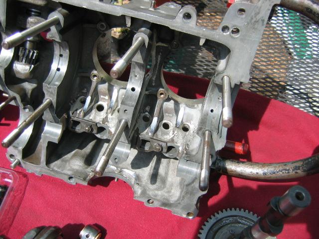

PostPosted: Sat Jun 30, 2012 11:24 am    Post subject: 1602 cc motor Reply with quote
I having problems learning this picture stuff . This case is now together,end play, set oil pump on and now into cyl & stud clearance issues.

PostPosted: Sun Jul 01, 2012 2:48 pm    Post subject: The build continues Reply with quote
Now I'm into the piston and cylinders. The clearancing of the cylinder to studs is a real bear. Everything connected to cylinder, stud lengths , sheet metal & spacer construction as well as fitting is a very time consuming & frustrating job. I'm aiming for 1 mm deck with Wolfsburg West (W.W.) new heads. I think I have had this thing together and apart 100 times already. I have tried upper VW sheet metal from 36, 40, single port & dual port 1.6, to find some that will seal up & center on both the generator & fan housing, and still mount on the dual port W,W. Okrasa heads with minimum cutting and bending. The single port 1.5/1.6 upper tin is what I ended up with fitting the best.
The cylinder spacers fabrication I did differently this time. They were very accurately cut out of 1/2" aluminum plate by a water jet machine. The water jet cutting of spacers I would highly recommend. Then I hand made the notches for the 8 mm studs to fit the cylinders, followed by a mock up with heads to see what I had to cut off the flat ends to wind up with .040" deck with W.W. Okrasa heads. I had a machinist remove 1.50 mm.
Another challenge is that I want to be able to change intake manifolds without ripping sheet metal off & fan housing, etc. When you read the W.W. installation instruction, they want you to install the manifolds & upper tin together. If I do it right, I will modify the tin to let me change manifolds, Speedwell, to W.W. or to turbo, etc.
One of the reasons I'm writing up this build is that some folks think that you just buy a W.W. kit, Porsche crank & some big bore cylinders and just bolt it together; instead it seems to be one obstacle after another. I see another one now where I need 4 internal 8:1.25 hex nuts for the two center W.W. 8 mm short head studs!
I think it is time to work on the heads for a while now.
