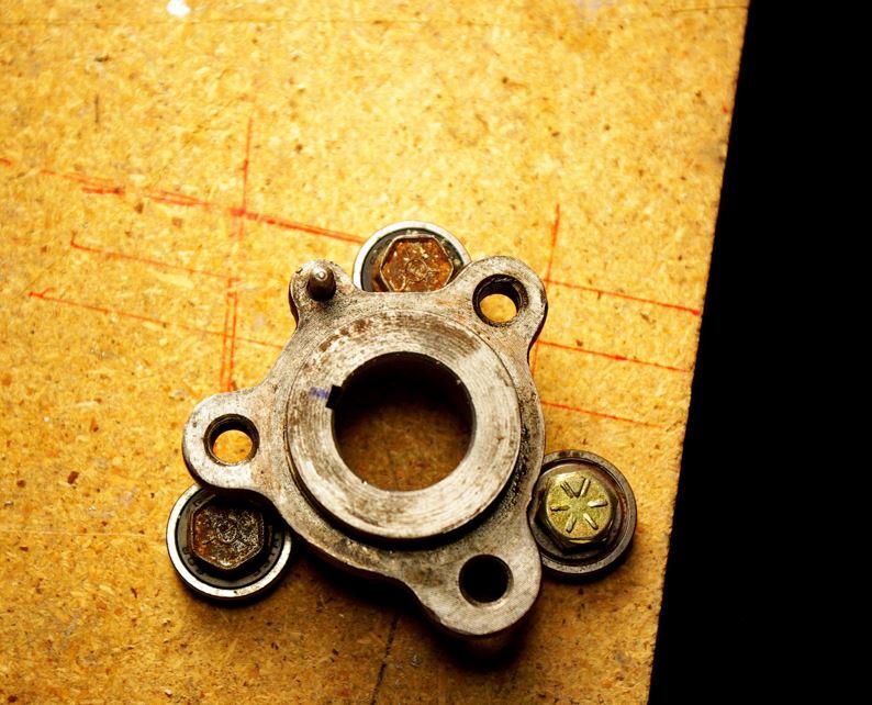

This method uses a thick, flat particle board workbench top and three inline skate or skateboard bearings mounted to the board around the fan mounting hub at 120° apart. Two are in fixed holes and one is in a slotted hole so the hub can be held tightly and accurately with no play.
Are these bearings radially accurate? Yes!.....more accurate and with less radial and axial tolerance than just about anything in our engines and transmissions (except good wheel bearings).
These are standard 608 ball bearings. Mine happen to be 608Z…..meaning they have a dust shield on one side. They are also ABEC 7 class. Even the basic ABEC 3 skate bearing from WalMart is more accurate than anything in our engines….so no problems.
These are mounted on 5/16” bolts with washers and nuts. You need to mount these close to the edge of the board or workbench so you can work underneath if you need to.

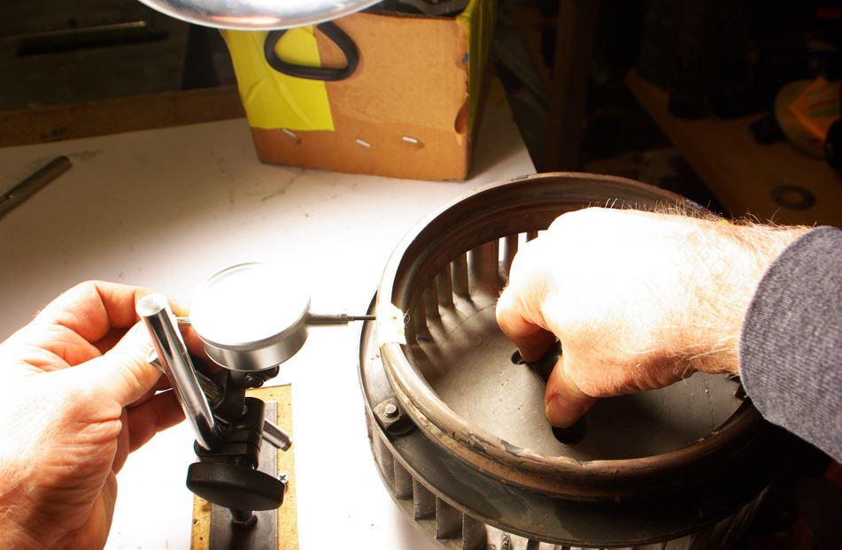

With this method…the first thing you want to do….is find out how accurate the actual aluminum fan section is by measuring along the ring where the “0” and timing marks are on 411/412/914 cars….just so you know if there is some wobble you are seeing that is not part of the pulley alignment.
You probably cannot correct anything on it but it’s worth knowing….well unless you bolt it to the hub…just one hub…and put it in a lathe and skim the rim.
Since this was the only measurement I was going to make where I actually turned the fan and just watched the needle variance…I did not want surface noise and any chatter to causing wild gauge fluctuations…and as noted did not have my wheel probe…so I made a low friction probe “skid” out of a slice of Torlon (hard as a rock and nearly as slick as Teflon). This actually works as good or better than the wheel.
So this is the low point. Yes…the needle is actually on “0” but I had some angle on the lens on ist tripod so you have a little parallax.
The total out was .003”. This gauge is calibrated in .0005” per increment….so the 6 grads = .003”
This was also quite linear. It went pretty much straight from the low spot to the high spot in 180°…with only a few lumps from dings in between. So….it would indicate that either the aluminum fan ring was out .003” or the fan ring is straight and the crank hub is out….or a combination of the two.

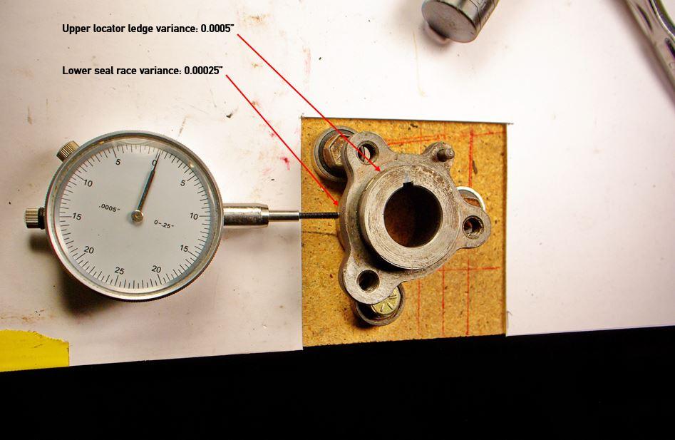

So…let’s check the hub where it mounts to the fan ring. Since I did not want to dismount any of my stands for this quick check…I stuck the gauge to a ring magnet and stuck that down with a square of 486 adhesive. It was fine for a quick check.
I first measured the seal race area that the ball bearings are running against. I then moved the gauge up higher and re-zeroed on the low spot corresponding the low spot on the seal race. The low spots of both the upper fan ring boss and the lower seal race boss are in about the same sector within a 10° radius.
So there was right at 0.00025” of run out on the seal race…and 0.0005” run out on the fan ring boss….so a total of 0.00075” of runout in the hub total….which puts about 0.00225” in the actual aluminum of the fan ring. Not too damn bad for machine work. That is actually not fare from the oil tolerance in the crank main bearings.
Perhaps this helps to answer the question SGKent had about how concentric the hub is.

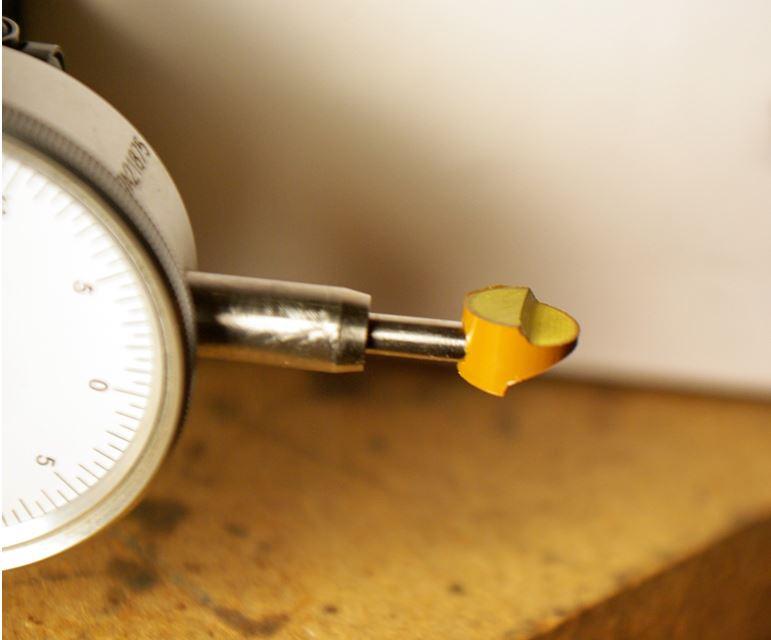

You really “should” use a dial indicator wheel probe…but mine….had a run in with some condensation and was damaged. Obviously I did not have a stainless wheel or that would not have happened.
But…..if you are using a square edge wheel you cannot accurately measure in the valley of the pulley. I elected not to measure from the outer edge of the fan pulley because it has enough small dings and chipped paint that I did not want to measure “noise”.
You can use a long needle tip probe of about .062” diameter or smaller. I made a long probe with a 4-48 gun screw I picked up from the hardware store.
This aluminum fan section had a high side and was out a total of right at .003”….and tapered off between 0 and .003”. Not bad! This has no real effect on the belt pulley because we will set that concentric to the hub.
The indicator stand set up:
The arm and post bolted to the plate. Make sure you are on the fan centerline and have the gauge perpendicular/tangent to the pulley.
Everything’s ready and cardboard around it to reflect light
