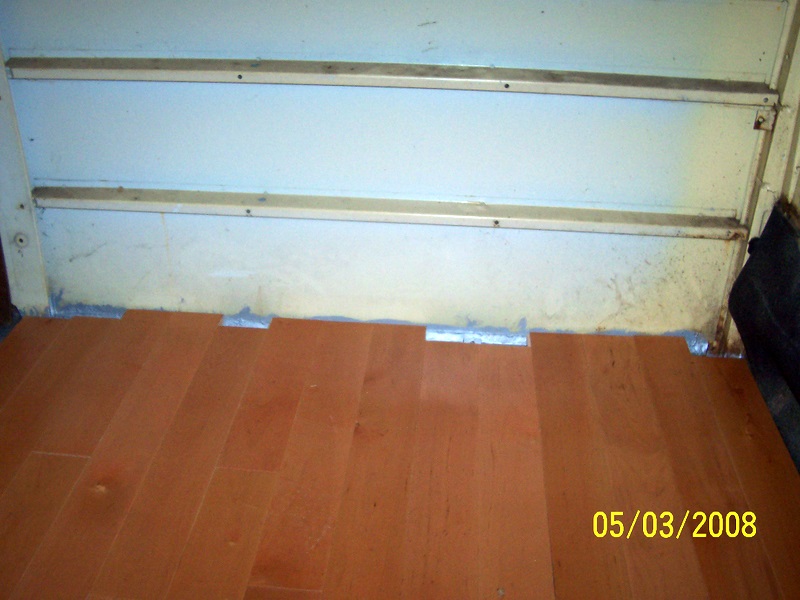

OK, I put in my wood floor. My dad had this leftover after redoing part of his house so free is good. Also, it matches pretty good. It's Cherry hardwood which has some orange in it that matches my Panama Brown.
Wanted to pick yer guys brains tho...
Here's the floor. Nothing is glued or fastened in yet. I put down this sound deadening stuff from HD it's a fiberboard and only 10 bucks for a 4x8 sheet. Definitely noticed a difference in cabin noise and radio sounds much better.
Question: Should I put some kind of waterproof barrier between the wood and the subfloor? and between the subfloor and the metal? That fiberboard looks like it could absorb lots of fluid.
Question: What should I do along this edge? I was thinking just trimming the old panel to fit but I dunno what would hold the panel at the bottom. Trim?
Question: I would dig some storage space under the seats. Thinking about fabricating a cabinet under there....suggestions? pics?
Question: What about the vent that comes out between the 2 front seats? It's about half blocked. Should I just put a cap over it? or leave it open?

It may already be sealed. I just installed a fiberboard 'wood' floor in my bus as well. It came from our basement when it flooded. If it's a good wood kit, it should be as simple as glueing it together. Of course, a good coat of polyurethane for floors wouldn't hurt. BEWARE, if it gets wet underneith the wood (you spill lots of water, or your basement floods) it curls up and ruins your floor.

Looks great, not too sure about that underlay though, looks like it would hold water forever.
Consider trimming the left edge a hair short of the interior panel so you can lift the floor up easily incase it needs to dry out.

I think you need more trimming.
About home floors, the rule is 1/4 " space at ( concrete ) walls.
Otherwise you might get bulging from temperature and humidity variations.
I recently worked on my VW Golf 2 floor.
VW uses rock wool in 20 mm thickness ( 3/4" ) under the floor mats.
I replaced some with 15 mm rock wool home insulation. This is a safety approved material.

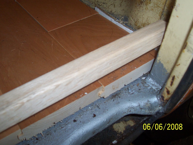

Here's what I ended up doing...
I did one long board on the drivers side wall. Probably should have done one long one on the front edge of the floor but it looks decent.
Cut a piece of plywood and wedged it between the bench and the flooring then put some shims between the bench supports and the plywood to make it all snug. Nothing was nailed or glued down for easy removal.
This edge is held in by corner molding that can be easily removed for sweeping and floor removal. The molding spans the length of the sliding door opening.

That's a good fix at the door. I like it. I still need to do it.

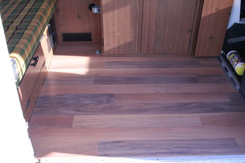

Here's mine
And, finished

The door area needs a threshold.You can purchase an aluminum 90deg. bent one that will fit over the hardwood and hide/protect the vertical edge of plywood and the flooring itsef.Screw it down with 1/2 stainless and your'e done.The floor looks great by the way!

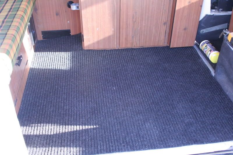

I still need to finish the edges but
I also cover it with this carpet. Which I can take out and shake off. Vacuuming it does nothing.

The carpet was at Canaidian tire for like $70. It is rubber backed so it doesn't slide or fray. It also came with enough to carpet the front cab section, between the seats and for a large mat to put on the ground in front of door.
I just used my old carpet to trace the new ones

PostPosted: Tue Jun 17, 2008 10:33 pm    Post subject: Reply with quote
Not sure we are thinking the same thing. I just took out the old carpet. Put it up the new carpet. and cut. Nothing rocket science about it. The reason I did it this way is so when it gets all dirty and sandy. You can just take it out and shake it. A vacuum cannot get as much as a good old fashioned shake
