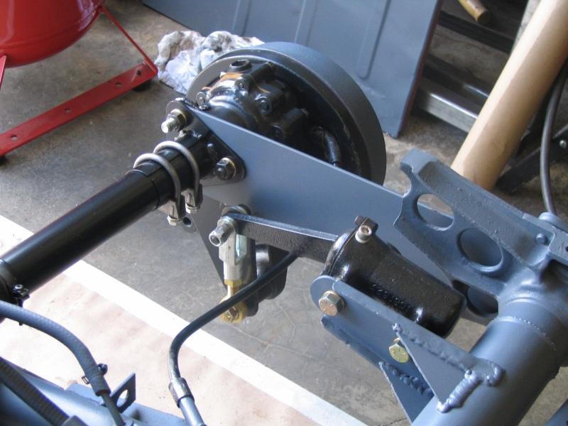

i have a question about your trans adapters. where and to what extent must the spring plate be clearanced?
i'm going to set up a big nut trans into a 66 for an old school class 11 type bug. thanks.

3/4 of an inch or so. I ended up cutting out 1 inch by the time I got them even (hey my first time).
Here are some pics of my install.

if you notch too far, you could always add limit straps

nice work hag.
next time, hide the bags of body disposal mix, er, mortar mix, before you take pics.

great pics. thanks.

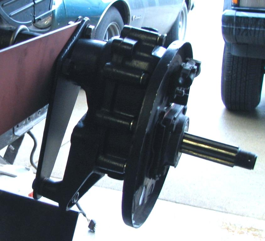

I wasn't able to locate any adapters at the time I wanted to build my set-up. I welded a large bracket to the axle tube (outside side of spring plates) and backed it up on the other side of the spring plates with a "sliding" collar/flange tightened to the axle tube with U-clamps. Do you guys see any forseeable issues with this setup? I don't plan on any harsh off-roading, but I wonder about wheel hop and torsional stresses to the spring plates???

The only problem I see is the clamps may allow the axle tube to rotate under load. There is a tremendous amount of torque on these axles with the reduction boxes. What I would recomend is using a couple more bolt holes on the reduction boxes, and bolting them to your existing bracket to prevent the rotation.

question: would one lose lift by making the spring plate come down lower than the center axis of the axle-shaft? or would one still gain the same amount of lift regardless. just a thought by looking at both adaptor designs.

You still get the same amount of lift with the first adapters shown, you just have to notch the spring plates to allow them to drop farther.

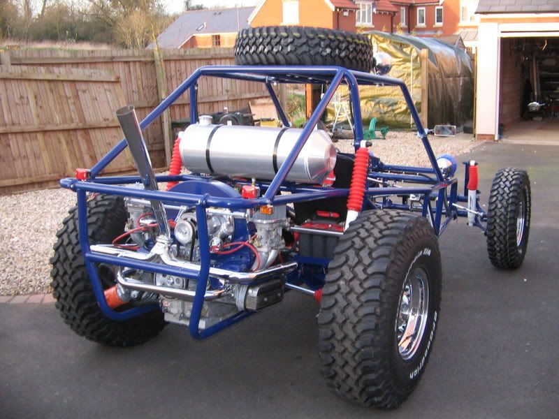

Here is a pic of a baja I built using the adapters from Bugzyla

Nice Baja!! Good to see you guys in the UK building Bajas.

Cheers, your adapters helped.
I also build rails here in the UK.
