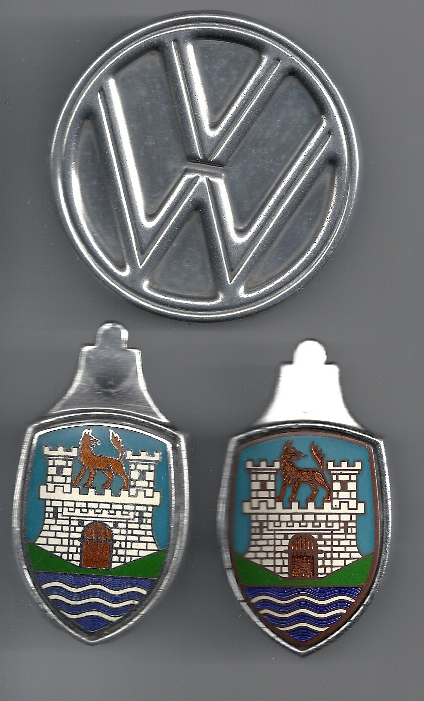

Here are the badges I will be putting on my Zwitter. I will be painting the lower surfaces to match the color of the car (Pastel Green) The lower left badge is the one I will be using (4 bricks).
I've not ever seen the paint in the badge. Is that a special "Bill" touch?

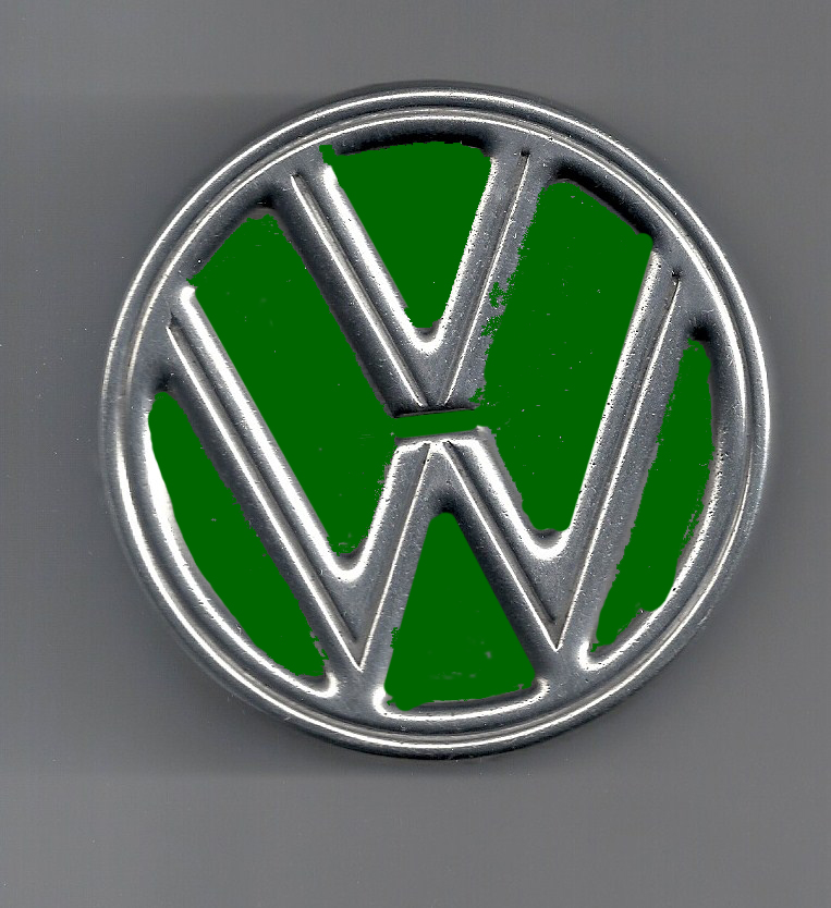

PostPosted: Tue Jan 17, 2012 9:44 pm    Post subject: Reply with quote
Mine came painted. And it didn't look custom, It was identical to car paint albeit very faded and worn off. It will look something like this....ok no critics on my photo shop skills or lack of...and I wasn't ging to spend all night looking for pastel gruen Very Happy

PostPosted: Wed Jan 18, 2012 11:32 am    Post subject: Reply with quote
There is some documented evidence that I have seen that dealers would paint the flat sections of the solid badge to make it appear as a more cast emblem, not a pressed "beer can" piece. This was done at a time when the competing US cars were coming out with tons of cast emblems and trims and chrome and dealers were trying to sell against them.
I have see s couple solid emblems with what appear like original body paint applied to the flat sections. There are also some period pics out there and I want to say someone had an old dealer prep sheet that specified this.
