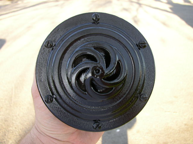

PostPosted: Mon Mar 06, 2006 9:01 am    Post subject: Reply with quote
Does the exterior look like this style of horn? (excluding the Chrome finish of course)

PostPosted: Mon Mar 06, 2006 10:17 am    Post subject: Reply with quote
no it is the swirly type like splits have.nothing like that chrome one.

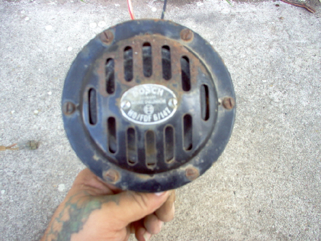

PostPosted: Mon Mar 06, 2006 6:07 pm    Post subject: Reply with quote
'53 should have the vertical slot horn with the oval badge. I restore these, although new or repro tags are not available for them. If you have a good tag keep it!.. With a contact clean and a tune, they really wail....

PostPosted: Mon Mar 06, 2006 6:17 pm    Post subject: Reply with quote
Thsi one would be correct for a '53.

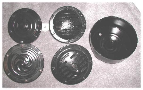

PostPosted: Mon Mar 06, 2006 7:04 pm    Post subject: Reply with quote
Not my hand, not my tat Eric. Laughing {I dug that pic out of the gallery}
While we are sharing horn pics:
Clockwise from upper left: The "Mercedes" horn, the vertical slot horn with no badge (I think these were used on some stds, and the type2 "working buses"), the (rare) horn cover, the vertical slot horn with the badge (missing on that one, I'm looking for a nice one, anyone??), and the "swirl" horn.
