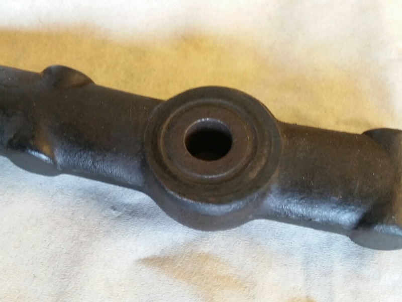

I have the new bronze idler arm bushing. It is pressed in, but the pin will not easily fit. I could press it in but then it would be too tight? How tight does it need to be? Or should I ask how loose can it be? I have a drill press so I could sand down the pin until fits which still goes to the previous question. Also the flange on it seems a little thick. So any advice would be appreciated

Measure both parts with a caliper and let me know what you get. The bronze also has a tendency to mush a little at the end of the tube and needs to, be, chamfered. The flange should be thick. You will need a castle nut with, cotter pin and a wavy washer.
Give me a day and I will set up some rebuild photos in my photo bucket that will show you what uou need.
Once you get this together.....you do not need nearly the suggested torque. Just enough to make it tight and crush the wavy washer. Then mark a point jn the castle nut with a dremel or file....pull out the pin and drill a hole in it for a cotter pin.

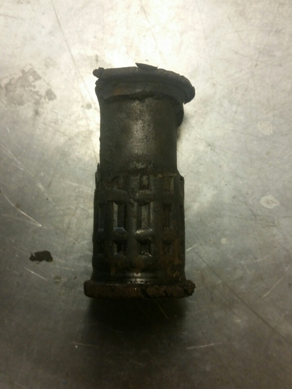

The stock high torque is what was responsible for crushing the end of the original bushkng tube. Then you retorque....then it gets loose again and the process starts over. Its likd 20-25 ft lbs with a wavt washer and cotter pin.
Also I have pics to show how and where....to install a grease fitting once the bushing is pressed in.
Dont sand the pin. If anything....the bushing is off. Ill tell you how to lap it. Ray

On the stock bushing by the time it gets to this point...the overly soft rubber....gets mushed to the side and it shreds.
After many years of driving and adjusting when your lower flange wears down enough that the pin edge is resting on the idler arm...its time to replace the bushing.

I measured the square head pin and the round head pin this morning. They should both work just fine.
Square head pin specs: Step distance from head: 2.205"
Diameter: .7060"
Round head pin specs: Step distance from head: 2.22"
Diameter: .7055"
So the Round head pin is .005" smaller diameter. There is enough slack in the stock bonded rubber bushings for both pins to work interchangeably. I checked the fit on two stock bushings this morning.
The Bronze bushings are just a few thousandths tighter or possibly they were made by whomever after only the round head bushing was measured.
Also I would hone the bushing to fit your pin with just a very slight tight push fit...a lot like a piston pin. It will quickly wear to fit fine.
Do not sand or hone the pin. I would doubt that you will any longer find a new one if you need it and bronze bushings start appearing larger in the market at some point.
The last new one I found was at a VW dealer in Dallas in about 1997. It was $49. If you don't ding up the threads and if you keep them greased...they should last forever.
Thats why I bought a new one at that time. I had several but was having what appeared to be tolerance issues. One was very scored up....and one was badly rusted and the others had lots of patchy low spots from rust. So it was hard to get a really "like new" size on this part.
I had the money, the pin was available and I got to see what the real tolerance looked like.
It was around that time that I found out just how sloppy the original bushing was as well as how soft and easily damaged the bonded rubber was.
I found that even the lightly rusted pin would have been fine. 90% of the issue was with the stock bushing.
I found the bronze idler bushing by accident. I was buying a new bushing to put with the same pin and went to a now closed VW parts in Dallas. They kept lots of parts in cardboard skinny bins like the dealer. They pulled out the bin with the idler arm bushings....for both super beetle and type 4 (same part #)...and laying in the box were several stock bushings and one bronze bushing.
A quick check with a caliper showed the bushing would fit perfectly. I asked what it was and they noted that it had come in with a designation for last two years of super beetle. Installed it and never looked back.
But you will have to chamfer the outer ends after installation to fit either pin. Ray

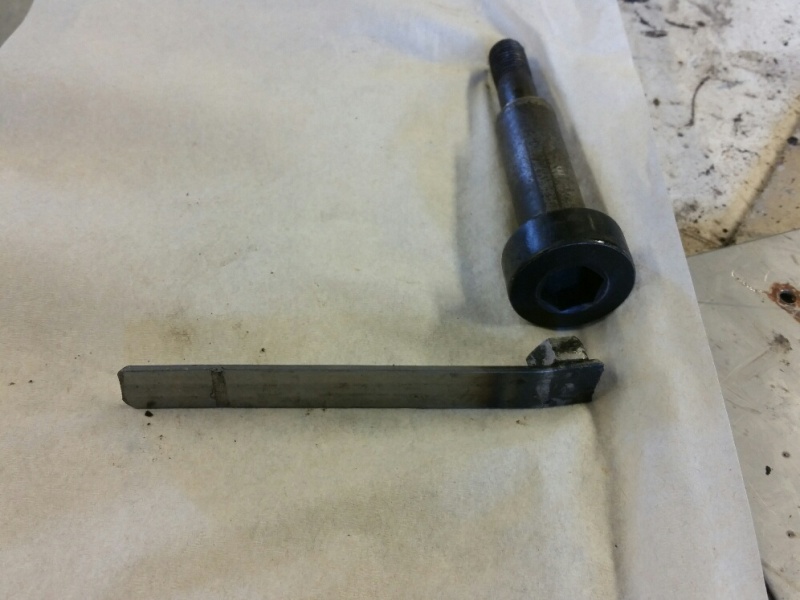

Oh...thats very important! You need to drill a hole through the bolt head or at least one side of it....so you can insert an Allen key or small rod....to keep the bolt from spinning.....or else you WILL have problems at some point in either loosening or tightening the bolt.
There is a 15-17mm allen key recess in the top of the bolt....but it is impossible to reach because the gas tank is too close.
If the bolt spins and you cannot loosen the nut....it will be a frustrating day.
In that case....you will need to remove the steering damper, remove the bolts holding the idler arm bracket...and drop the arm down enough to get either an allen bit and wrench on the bolt head....or....as you can see the vise grip pliers marks on the bolt head in my picture....you may have to use pliers to hold the bolt to get the nut loose.
After that...I drilled a hole in the head and use a 4-5mm Allen key to hold the bolt head still. Just stick the key in and turn the nut and the bolt will turn until the Allen key lodges against the body or gas tank and locks the bolt so you can take the nut off or tighten it.
Also...about torque of the nut: After you switch to the bronze bushing....since the bushing does not flex or compress like the old bushing....you really only need enough torque to make up the nut and hold the arm firmly against the bronze face. You should be able to turn the lever by and with a maximum of about 15-20 lbs of torque.
This means you only need about 20-30 lbs of torque on the nut. To keep the nut from unlocking itself.....use a castle nut and drill a hole in the large bolt and use a cotter pin. Best mod you can do, Ray

PostPosted: Wed Jun 10, 2015 10:28 am    Post subject: Reply with quote
I found a washer for the step pin and coould get everything together with a perfect fit, feels super solid!
Reflexions after doing the bronze bushing operation:
-I was suprised that the bracket only was fitted with 3 bolts since it has 4 tapered holes - I kept looking for the 4th bolt quite a while.
-It was easy to get the bracket out, just remove the nut at the pin to undo the idler arm and loosen the 3 bolts for the bracket and it falls straight down.
-I made a small tool from a nut and a piece of iron to hold the pin at the upper end when tightening:
Yes this bushing is shot!
Another idler arm (not the one in my car) shows Heavy wear from the iron part of the bushing (the bushing is shown above):
/Lars S
