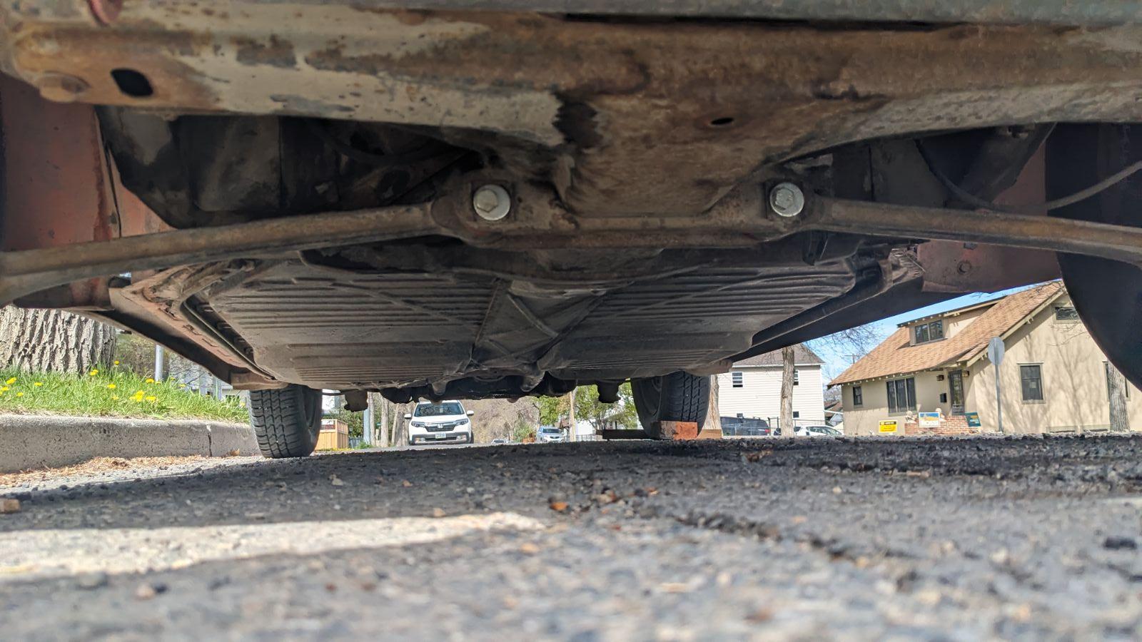

Hi could someone check out these photos and point out the good jack and stand points for the front of the
OTTO 1303

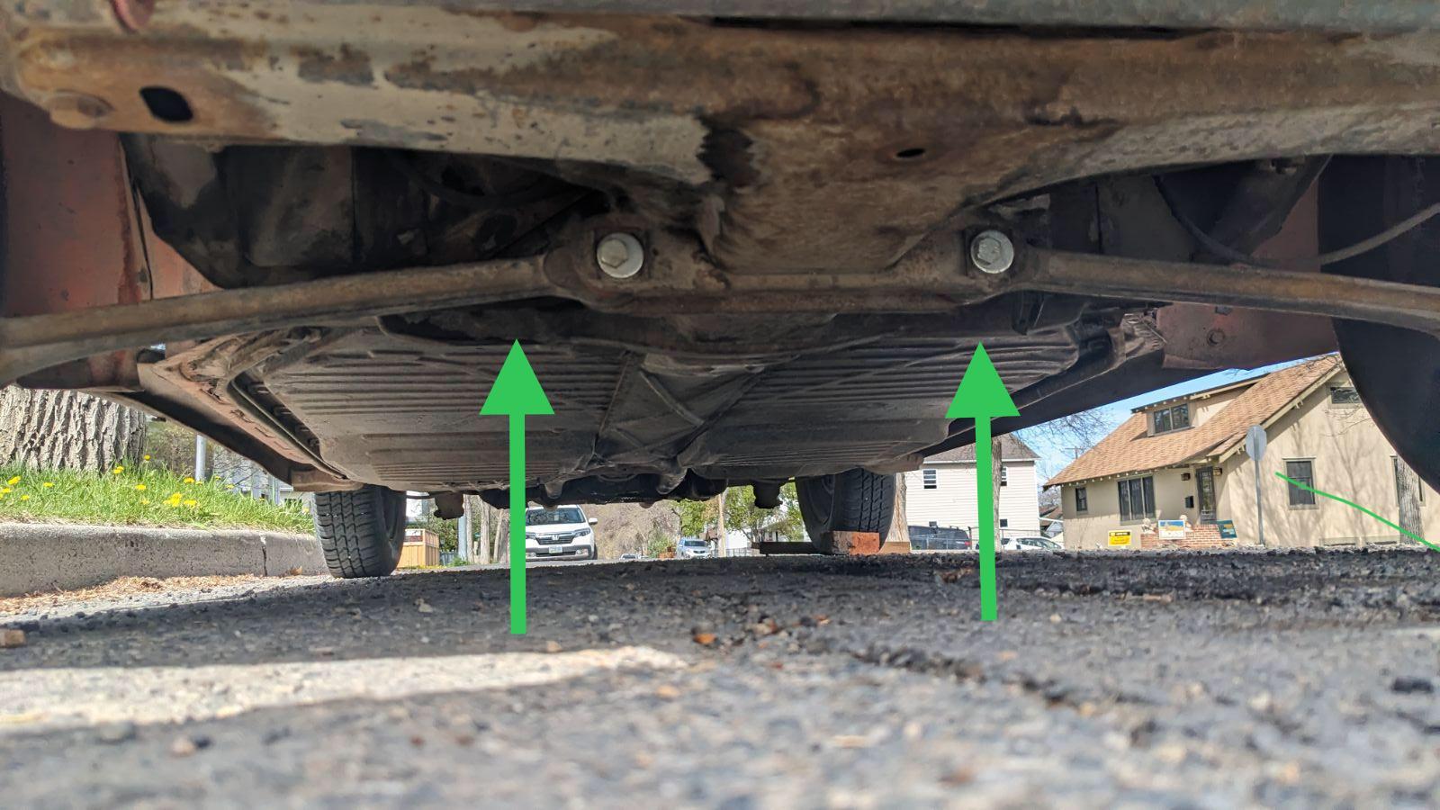

Jack and stands can go under the front cross member (green arrow) below Napoleon hat

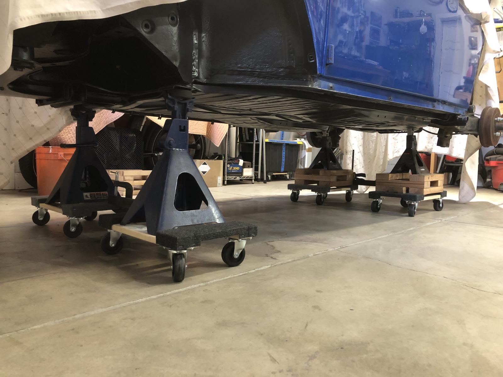

If not enough room for jack and stand, I have placed jack under the body bolts at the outside of the crossmember, jack up, and place jacks under the crossmember (green arrows)
You can see where mine are placed

I like to put the stands under the hard point of the pan to body mount…and use hard rubber hockey pucks for protection.
