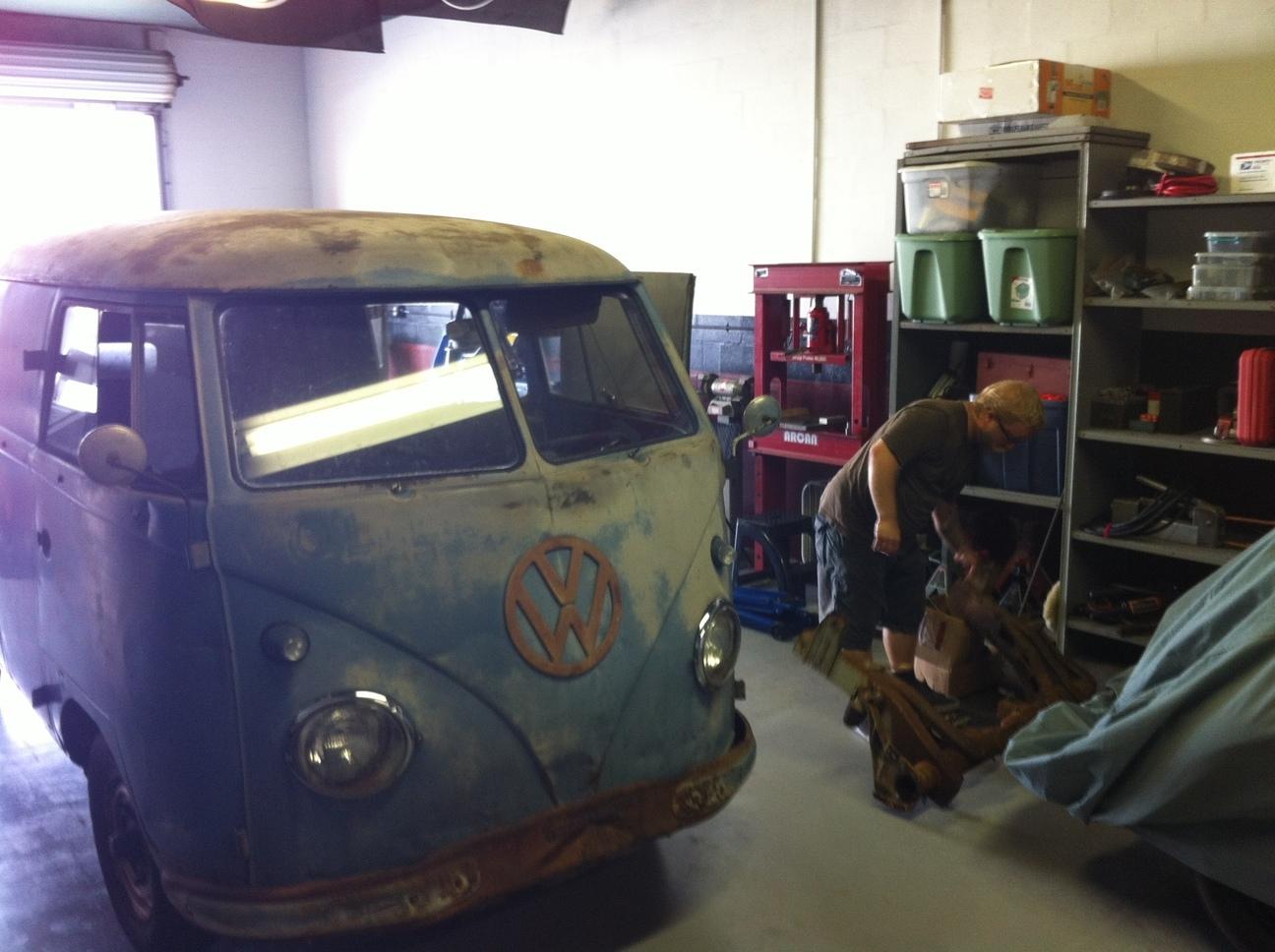

I decided to start a build thread for my brother's 1957 double door panel. All work is being performed at my shop, Independent German Auto in Merritt Island, FL.
The bus original came out of Texas but was purchased a few months back in Florida without any running gear. As far as we can tell the bus has been off the road for a long time, perhaps 20-30 years. It's in pretty good condition, considering it was a commercial vehicle, and has never been painted or had body work performed. The bus has all the typical lower rust but nothing too severe. It looks to have had logos for 2 different businesses in its past, unfortunately they have been sanded off leaving primer over most of the upper parts of the bus. The plan is to convert the rear end to IRS using modified early bay control arms/bearing carriers, early bay ball joint front end, and a 1956cc stroker motor. The suspension will sit tall with stock bus 15" rims and Super Traxion tires.
I've done a few straight axle conversions and IRS swaps using beetle parts but I liked the idea of using the early bay window parts with larger brakes, ball joints, etc. We plan on having the bus ready for Bulli Brigade in November. For the purists, all parts can be swapped back if desired with no consequences in not much more than a weekend.
We've been working on the bus for the past six weeks on and off as time permits when I am not working on customer cars. Here it is in the beginning.

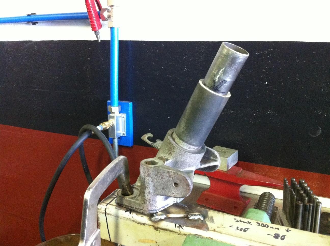

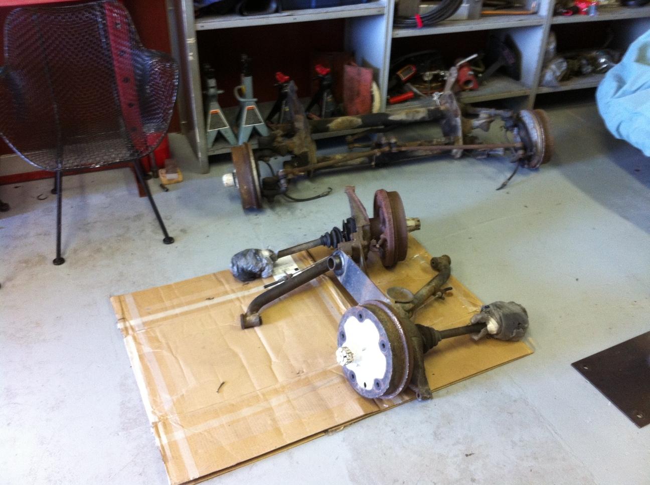

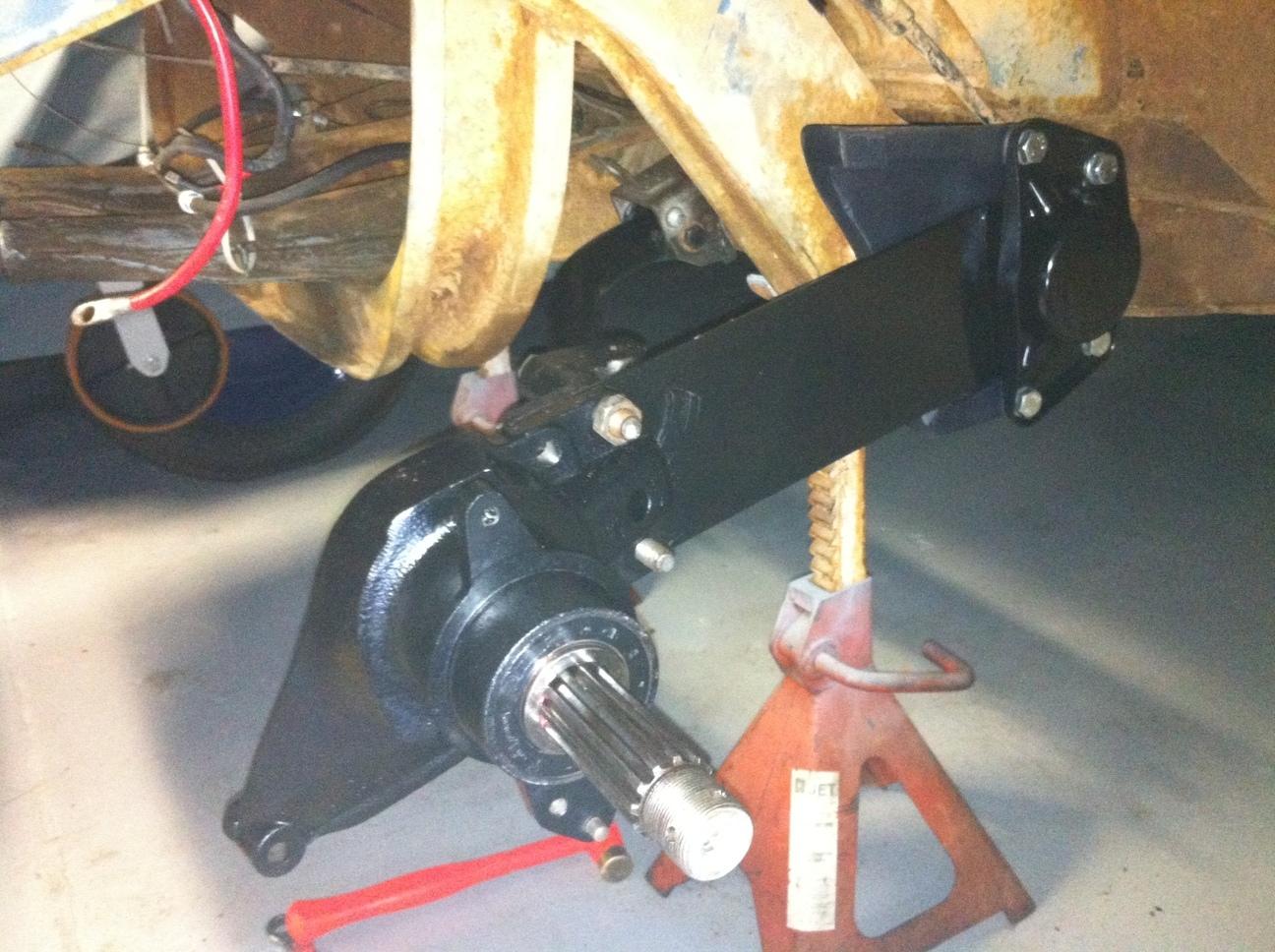

Mounting the bay window rear end components wasn't too difficult. The early bay spring plate up to 71 fits on the split bus torsion bar without any modifications necessary. The early bay torsion bar is too long and doesn't work. However, the splines are the same both inner and outer when compared to the split-era parts. So you use the 68-71 spring plate with the split bus torsion bar. Some new rubber doughnuts and everything is ready to mock up.
When you mate up the bearing carrier to the spring plate with the early control arm you will see that the arm is too long and basically winds up at the center of longitudinal engine support. Solution is to narrow the control arm. In this case 80mm shorter would move the pivot point just outside the engine support.
First thing we did was make a jig that mounts the base of the control arm and uses 12mm threaded rod to plot the line where the pivot needs to be relocated to. You can't see it in the picture but there is a 15mm sleeve that locates the arms base and a rail that the base butts up against. Then all you have to do is clamp it down. Jam nuts can be moved up or down to set the height of the bushing carrier/end of the arm. Pretty simple.
I had a piece of .120 wall 1.5" DOM tubing bent at both ends to 60 degrees to form the new arm. I sleeved and rosette welded them for strength then tig'd it all together. Pivot bushings were also changed with new OE VW bushings. Nice and strong!
The pivot boxes were carefully cut from the doner 71 torsion tube we bought earlier and fit perfectly up against the split bus torsion tube. After measuring, checking and then measuring again, the pivot boxes are tack welded in place to check fitment. Once everything looks good and square they are thoroughly welded in place.

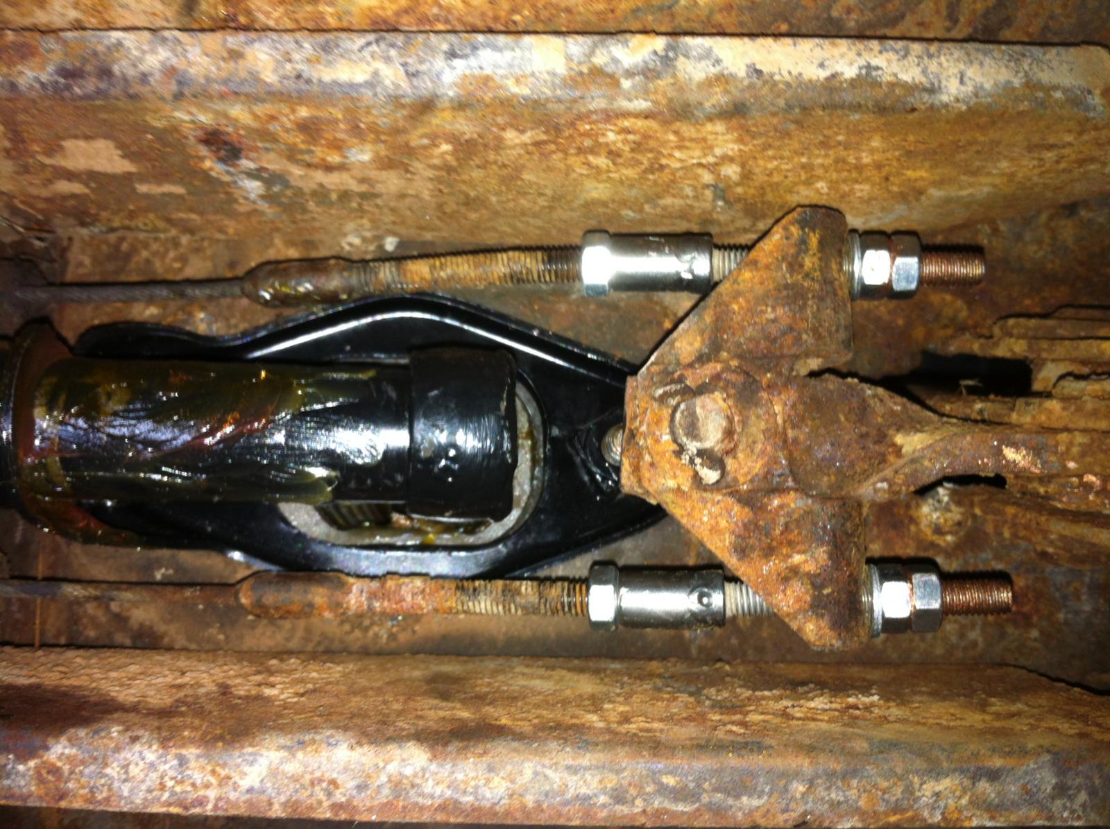

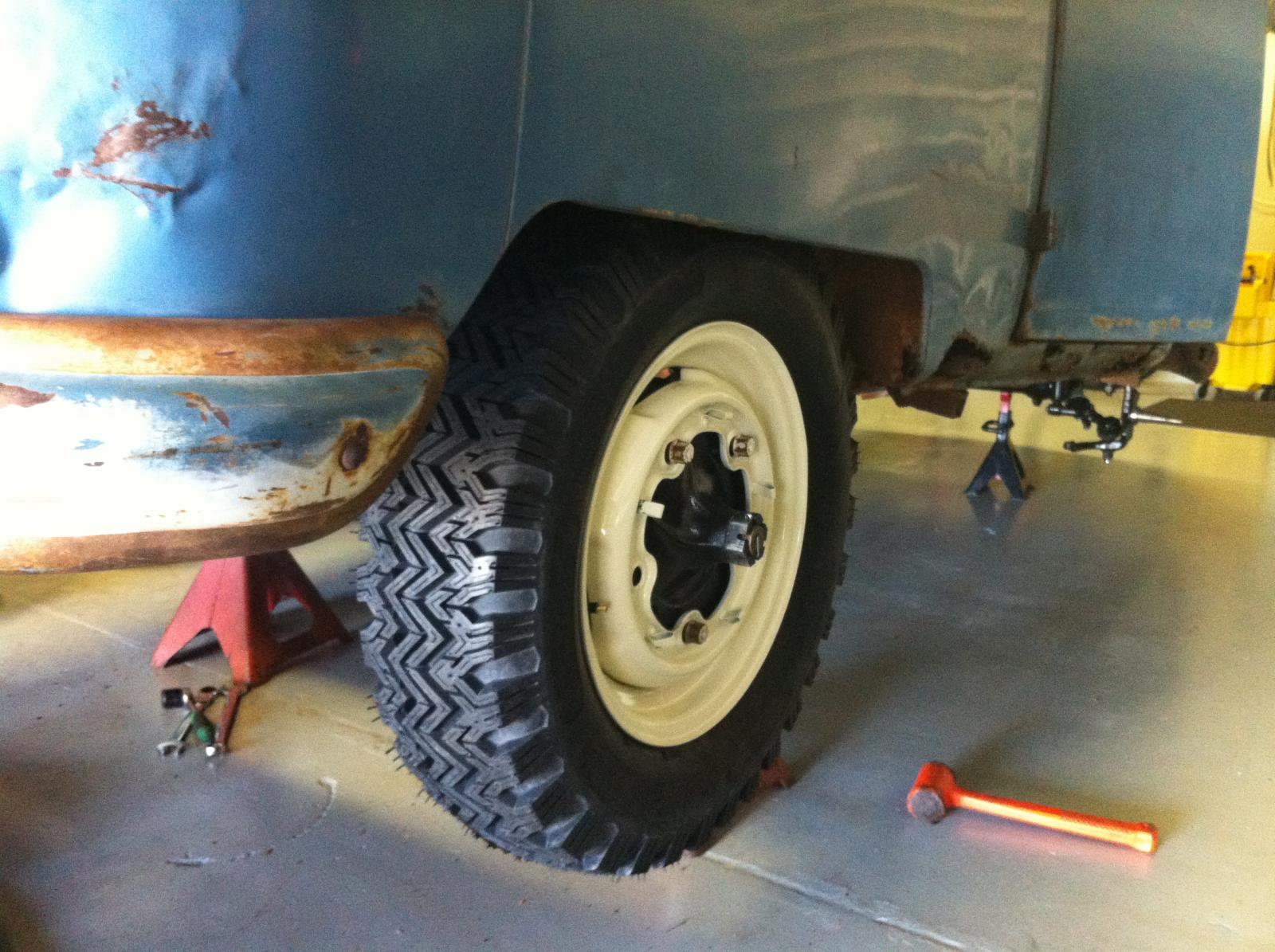

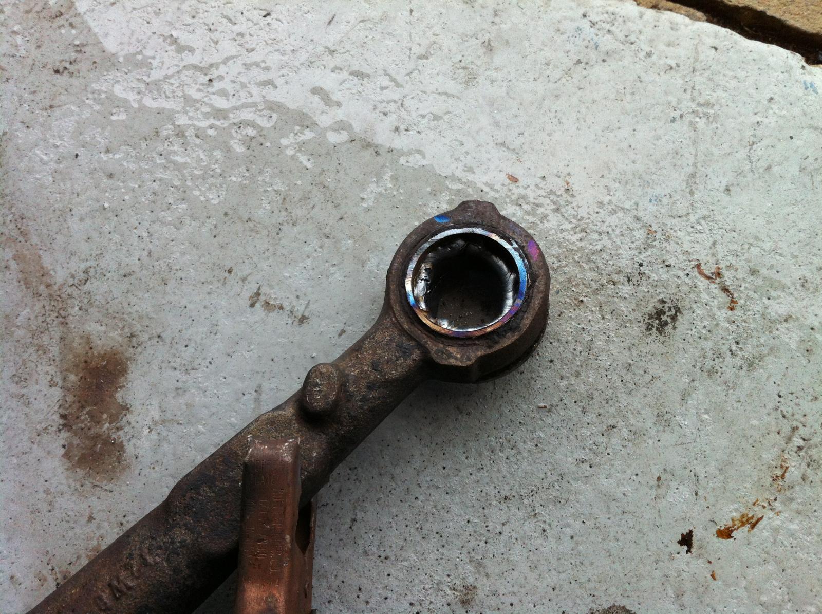

More progress. We purchased a super rusty and clapped out 68 Westy to use for parts. This thing was way too rusty to justify fixing. You couldn't even open the rear hatch without it falling off and the roof is nearly separated in places with huge gaping rust holes.
We are going to use the front ball joint beam and brakes to complement the IRS rear end. Since we are using big meaty tires the added height will not be an issue. Also the rear end can now be raised or lowered without affecting the camber and the ride height can be set as desired. The front camber is also adjustable with the ball joint front end. Just another benefit of the bay window front end.
As usual the Westy's front end was in need of nearly everything. The ball joints were toast as were two of the four tie rod ends. The only thing that was still in good shape was the center pin. It looks like it was done recently. Late bus ball joints absolutely suck but can be removed fairly easily if you have a welder, grinder, and a pneumatic air chisel. This is probably better suited for the Bay bus forums but oh well.
Cleaning years of accumulated crud off the beam with the needle scaler.
Removing uprights from arms with the big Kukko separator.
Ground down backside of ball joint. This allows center pin to be pushed through only leaving the outer shell.
Welding around circumference shrinks outer shell which can then be tapped out with the air chisel. This is how some shops remove valve seats.
Rebuilt rear carriers and front arms cleaned and ready to go.
Partially cleaned beam.
Painted beam. Not a show car just a driver.
Fresh and ready to be installed. Should be like new. Hopefully, the steering box isn't too worn out.
More progress to come soon. Bulli-brigade is just around the corner.

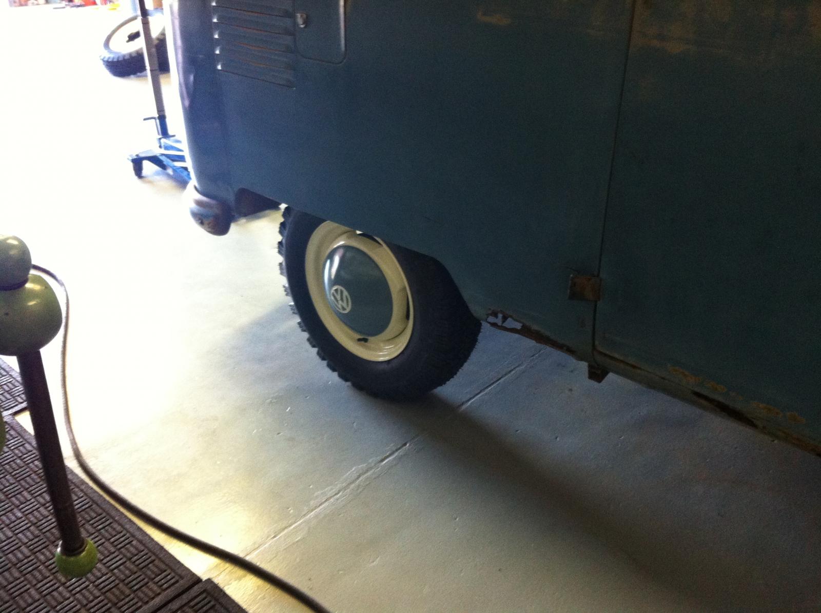

........Joe wanted the use stock wheels and hubcaps so we didn't change the bolt pattern.....

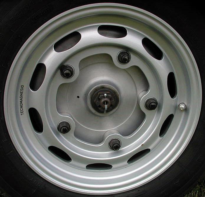

Those are nice wheels. Kind of like the Technomagnesio wheels only aluminium
I put stock steel painted Porsche 912 4.5x15 wheels on his last bus. It was an O.G. paint dove blue 65 conversion camper lowered of course. That thing drove awesome. Not too low just right. Stopped on a dime.
exactly what i was thinking Smile
regards
Uli

I'm waiting on parts for a customer's car so I thought I'd post some more updates on the bus. Good news, the mystery motor that came with the 68 Westy started right up and idles smooth after I adjusted the valves and cleaned out the carburetors. End play is minimal. We'll probably run this engine for a short time while I build the new engine. It appears to be a 1600, with a 38amp bus generator, dual Kads, and dog house cooler. It's based on an AE case, a little ratty looking but not bad. I'll likely do a leak down on it if we decide to run it.
So at this point all the rear brakes are together but the parking brake cables are about 75mm too short. Luckily I saved the compression springs from the Westy's brake cables. So I plan on making a cable extension and swapping the split's compression springs with the bay springs after I remove about an inch or so. Unfortunately, I didn't take many pics.
The first step is to make the cable longer. I used a short section of 8mm round stock drilled and tapped to 6x1.0 so the end of the old cable will thread into it and tighten up with a jam nut. The small piece of round stock is welded to a 60mmx6mm bolt with the head turned down.
Thread the extension to the beginning of the cable under the brake lever and tighten it up with a jam nut. Now the cables are the correct length and it didn't cost anything. The longer compression spring is inside the rear drum. Just spread the last coil of the spring open and twist it over the cable. After the old spring is removed first, of course. Here's what it looks like installed under the front floor.

Joe ordered tires from Specialty Tires of America. They are Super Traxion 205/75/15. They also make a 215/75/15 in the same tread but those were currently unavailable and they told Joe that they weren't planning on making more anytime soon. Coker Tire had 3 in stock and that was it. The next size down was the 205/75/15 which is still over 27" in diameter.
So far so good they fit with plenty of room both front and back. You don't have to deflate the rears to get them under the rear fender lip either which is a big plus. Even heavily loaded there shouldn't be any issues with rubbing. The one thing I like best is that the sidewall has a vintage look and isn't all jumbled up with print like most modern tires. They look right at home on an old bus. Stay tuned much more to come.
