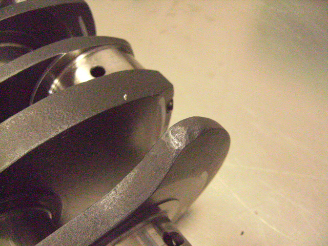

I'm building a 2276cc and I want to reshape the counterweighs and rod throw arms for better aerodynamics and also to reduce the rotating mass. I'm going to be doing it myself and would like some ideas on how much material can be removed from the rod throw arms. It seems to me that there is alot of extra metal not used, probably since one forging is used to produce more than one size stroke. I'd like to remove this extra metal and then reshape the throws so that they have less aero drag when the engine is running. It's an 82mm CB Super Race Crank.
The last pic shows what I have in mind, the black shaded areas being completely removed and the silver shaded areas laid back to round off the overall shape.
To keep the crank somewhat balanced (atleast closer than doing it blindly) I'll weigh it (in grams), reshape one counterweight and then re-weigh it to see how much metal was removed. Then I'll remove the same amount off the opposite side counterweight. I'm also going to make templates to keep the same shape on all the counterweights as close as possible.
I'd really appreciate any thoughts on this before I bust out the grinder!

In Mini Cooper circles, this is called 'wedging'.
http://www.aptfast.com/Flyer_HowTo_Dir/HowTo_Folder/Crank_Preparing/Crank_prep.htm
I like that they mention "effective crank counterbalancing". Theres way more weight in the rod throws than there is in the counterweighs. I didn't mention it in my first post but part of my goal is to reduce the weight of the rod throws, so that the counterweigh's mass is closer to what the rod throw weight is. Seems like that would help with crank flex.
It'll definitly make its way to a balancing shop when I get that far with the build.
Any Ideas on how much is safe to remove from the rod throws?

I would think that you would have to understand your complete rod/ring combo, pin, + a couple grams worth of oil weight first. Then be sure you crank throw weight would not be less??
I send my stuff to a local machine shop, but I use jewelers scales to match everything first. Then the shop will match that bob weight on the crank and balance everything.
If I had the money, I'd rather leave the crank alone and go w/ a dry sump if your worried about crank drag that much.

VW cranks don't use bob weights when balancing; the rod throws and counterweights are all 180 degree apart from each other, so the weight on one side of the crank almost exactly equals the weight on the other side. Balancing just gets the weight of the counterweights and rod throws on one side matched to the other side, the weights of the rods and pistons have no effect on the crank's balance.

Makes sense. I didn't think about the 180..
So then this makes it much easier for the home builder to balance everything. So the rod throw eight is the same.
That being said, then I could see that a more efficient crank design or grind to cut through the oil may pick up a few hp as long as it doesn't damage the integrity of the crank.
theastronaut
Joined: November 19, 2007
Posts: 1640
Location: Anderson, SC
theastronaut is offline
PostPosted: Tue Jun 22, 2010 8:15 am    Post subject: Reply with quote
The crank/flywheel/pressure plate/crank pully still need to be sent out for balancing. There's no way you can do it at home.
I'm keeping mine closer to balanced by weighing how much I remove from each counterweight edge and then removing the same amount from the opposite corresponding counterweight. That way it isn't as much work for the balancing shop.
The rods and piston/pins/rings can be balanced at home if you have scales that are accurate and have the correct resolution.
Yep, that's my goal.

I had a guy send me a link to a topic on Aircooled Technology's Forums. Jake took 4 pounds off a stock non-counterweighted 66mm Type 4 crank for use in a SCCA car. The engine runs between 6800 and 8500 rpm on the track and had 8 hours of dyno time. The total estimated run time was about 25 hours. The engine was torn down and had no signs of crank flex.
I should be able to take around the same weight off, maybe more because my crank has counterweights that will get reshaped.
