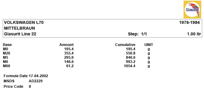

PostPosted: Sun Nov 30, 2008 4:48 pm    Post subject: Reply with quote
Glasurit lists L70 Middle Brown as a 1976-84 color, not sure why. But here are their formulas:
.....and there isn't another brown in the VW color range that is close enough to get away with.
http://i197.photobucket.com/albums/aa28/in2vws_com/VWcolors/Browns.jpg

PostPosted: Sat Mar 01, 2025 11:18 am    Post subject: Re: L-70 medium brown color match Reply with quote
From the Glasurit website https://coloronline.glasurit.com/
Type in Code L70 and let it search. This formula is from the 22 line and is just a small amount.
Test it before ordering a bunch!
