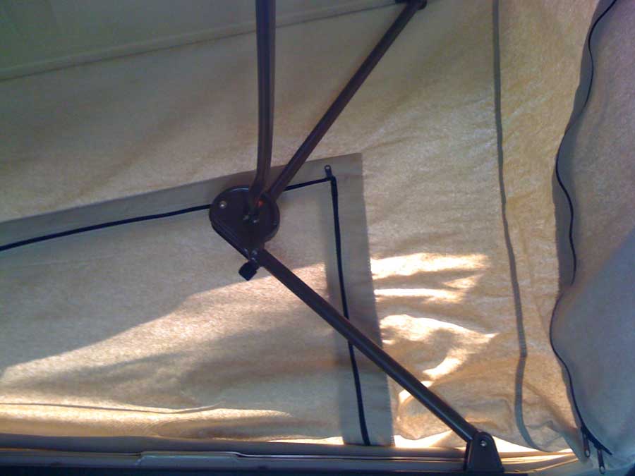

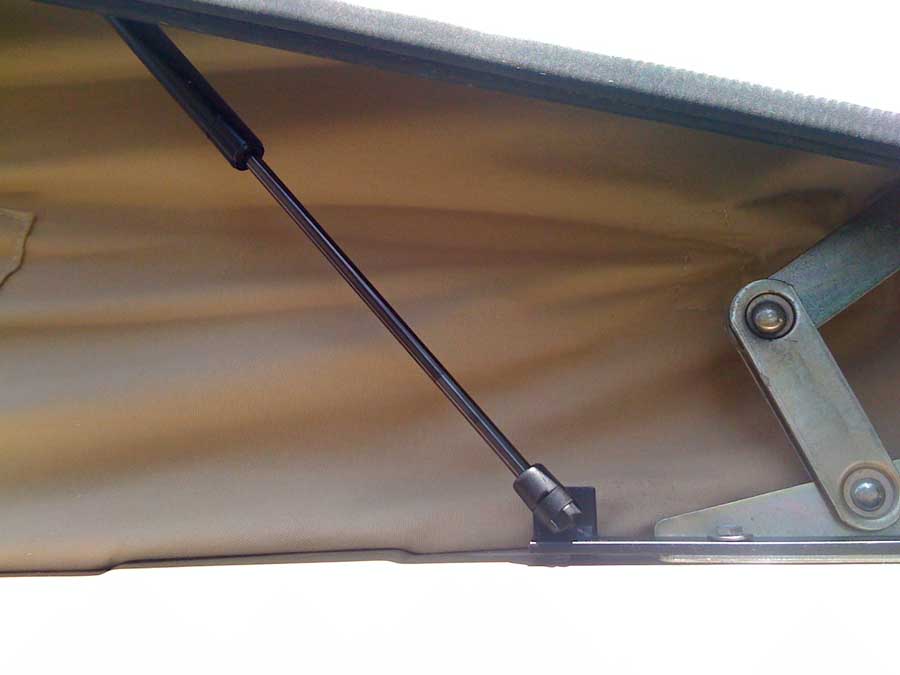

Today I received and installed the pop top shock kit from username Jackbombay..
http://www.thesamba.com/vw/classifieds/detail.php?id=798951
It was too easy, no blood, no sweat, no cussing.
They work Fantastic.
I can raise my top super easily even with a surfboard on top, which used to take considerable effort.
Closing is equally easy, both with and without the board on top, pulling the lid down (very easily), it stops wherever I let go, allowing me to adjust the canvas before latching, without having to hold the top up with one hand..
This is one of the most gratifying upgrades I have done to my Westy..
HIGHLY recommended.
here are some photos to show how the top stays wherever I leave it, even part way open, and even with the weight of a surfboard on top..
inside
outside
hardware open
and this is all you see with the top down
note, because of the position of my surf rack, I mounted the shock 1" lower on the pop top than the instructions recommend.. everything still works perfectly!
