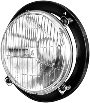

I use the Hella 500 lights. Pop the cover off and position it in the grill where you want the holes to be. Use a sharpie to mark it.

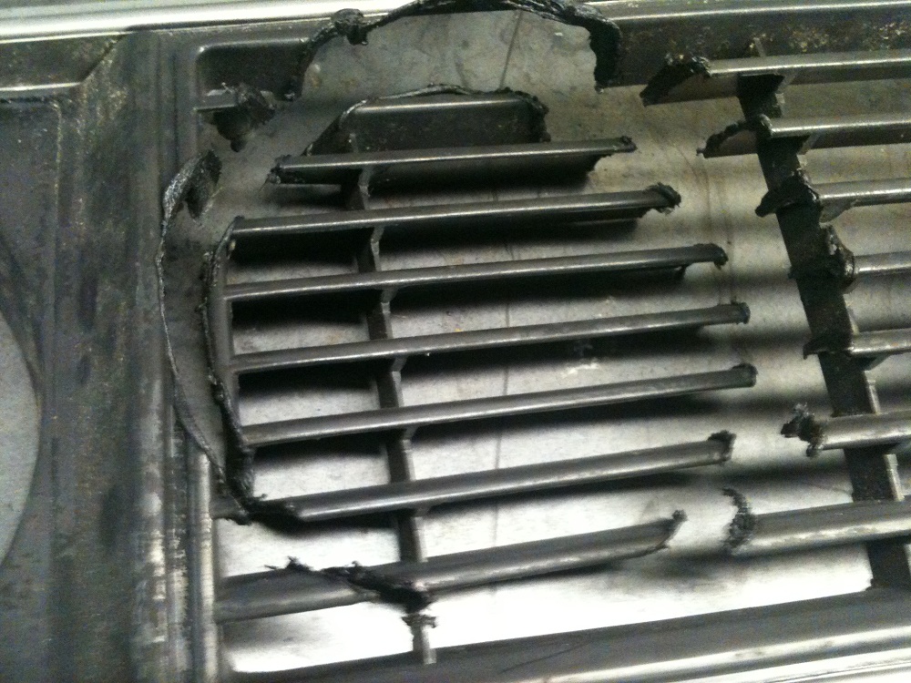

Use a scrap piece of metal bent to the same radius as the lens cover and heat it with a propane torch, then push it through the grill where you marked it (you need to re-heat it often).
Use 180 grit sandpaper and a file to smooth it out.

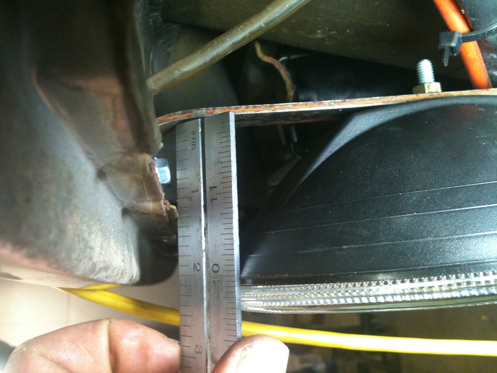

cut 2 pieces of 3/4" flat stock to 11.5", then bend a 1" 90degree on each end facing the same way.
Mark where the center of the hole is and bolt the flat stock to the top and bottom of the opening using self tapping screws. Then take the lens out and drill a hole in the back of the housing, this hole needs to be marked on the piece of flat stock as you hold the housing into position.
I use a bolt with large fender washers to hold the two together. You can see I also am fixing a few chips in the grill with epoxy.
It takes a little bit of adjusting to get just right but is very easy to do in any direction.

For a closer match to the overall look of the SA Grill and the ability to have a completely aimable H4 headlamp, I have been toying with the idea of trying the Hella HL00243. It is a 5.75" H4 with a mounting ring that includes adjusters.
The included bulbs are 24V, so they will need to be replaced with 12V H4's, but the total cost will still be about the same as a set of premium quality fog/driving lights.
The wiring can easily be set up to only use the inner lights for high beam (like the SA Grill) or for full time high and low beams in tandem with the stock outer 7" lights.
